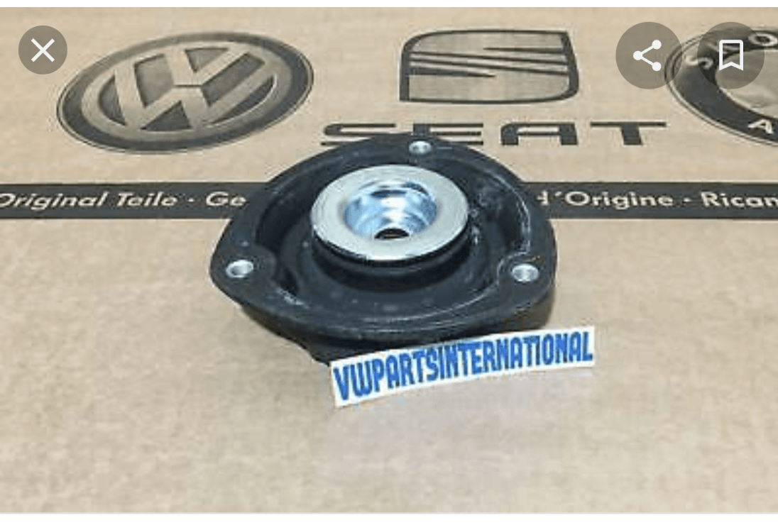

Thanks for the response. I'm not so very well-versed on all of the suspension parts so I need to ask: When we say top-mount, are we talking about the part in the photo I attached? I might consider replacing them if they're not too expensive, assuming the new ones will do fine for a couple of years before they start to squeak too. Really don't want to have to grease some parts every three or six months.

I think that’s it. I don’t think replacing them will sort it. It’s a common fault that can only be sorted by greasing. Mine went for over five years and didn’t need doing.
