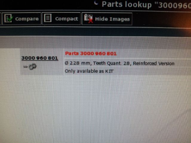

Have you got
3000332001 or 3000426001 on the box as the part number?
Its the 3000332001 just checked the prices of the clutch kit by itself and you can get if for a couple of hundred or less :(. If i had know the kit came with a sachs clutch i would of just bought the flywheel for 150ish and bought the sachs sre clutch, so the ecs clutch is slightly over priced i think.

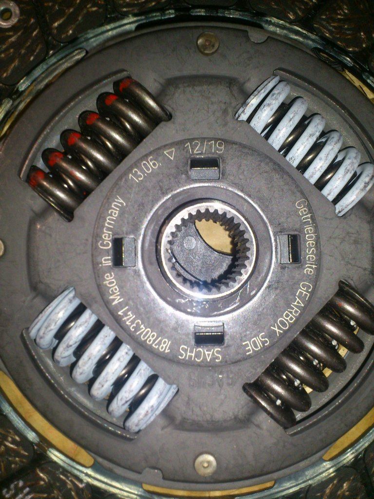

Dual mass clutch plates dont ned any springs at all (sometimes do) as the dual mass take it all up
Unless ecs replace the springs with uprated ones? I know jag do this with there 2.2D xtype
Guess you cant be sure unless we spoke to ecs or some one at awesome who knows alot about em?

Have the springs got another spring inside as it looks in the pic
(just zoomed in on a laptop)
aye they do bud. the partnumbers you gave don't match the one on the box i will get it for you when im back home. forgot to write it down.

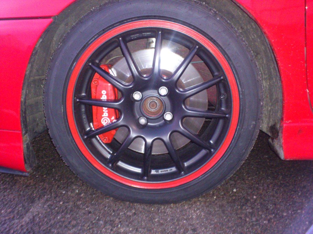

New wheels in t1r's look how close to the brembos forgot to put deter caps on the wheels :(
