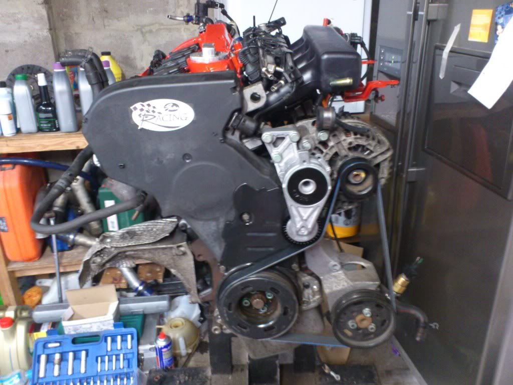

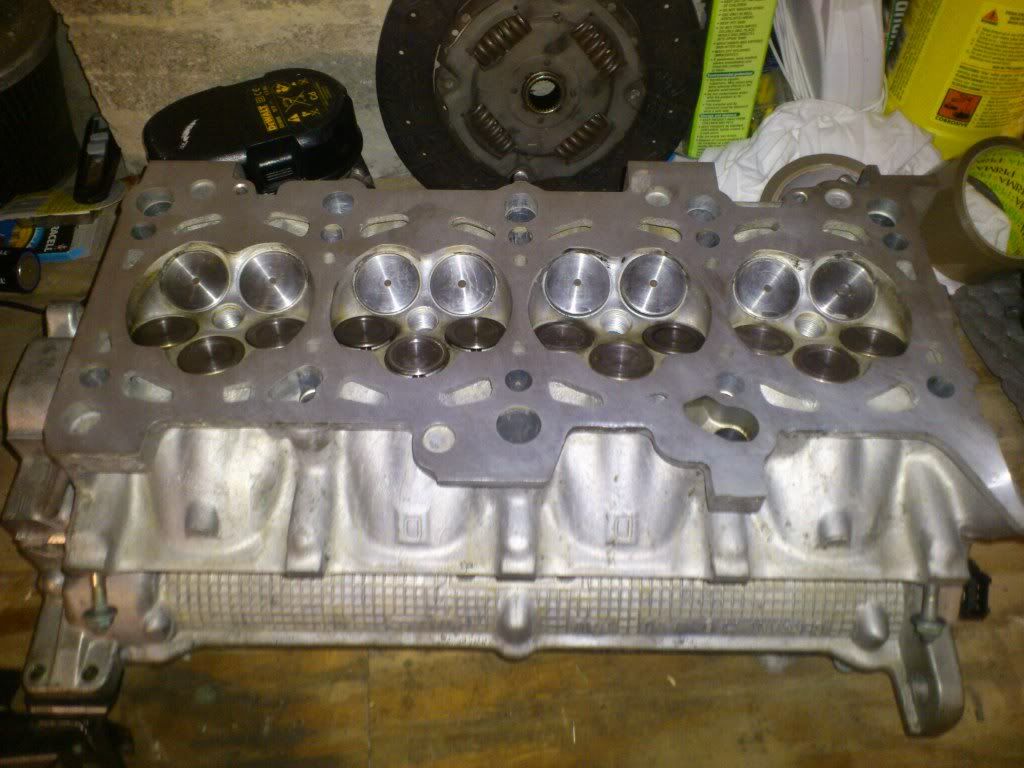

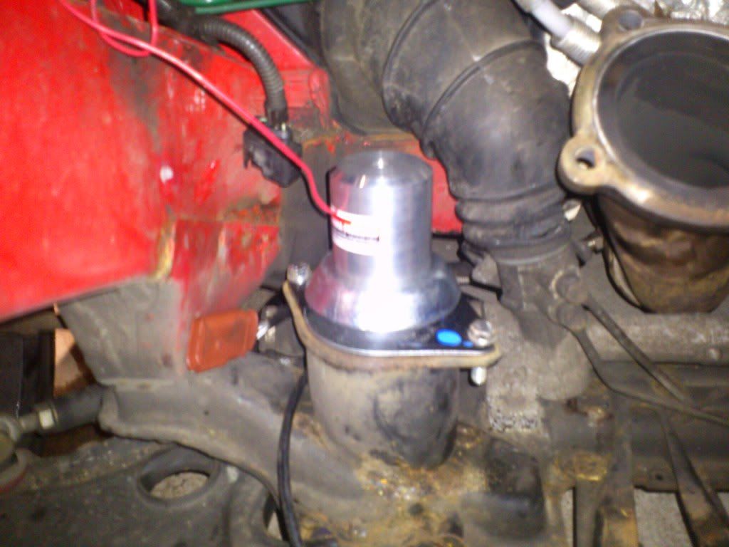

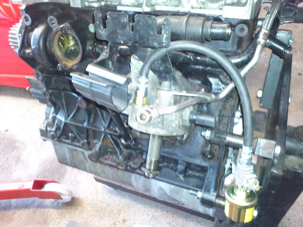

pics of engine
Nice gates racing belt ;)
I think i may remove the cover and spray it gloss black.
Head all cleaned and rebuilt
Mounts

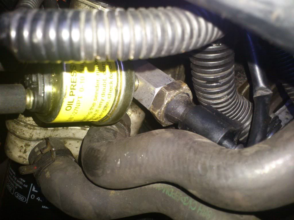

42 draft design adapter

Yeah tell me about it Berg, looks like the car will be sitting on the axle stands for another 3-4 weeks whilst i await the arrival of my ECS stage 2 clucth and fly wheel kit :). didn't think it would take so long to be delivered :(.
The 42 Draft design adapter is good for just oil pressure but no good if you want to fit temp as well, as i have now found out. the temp sender needs to be a lot closer to the flow of the oil to pick up the temp.
i've just ordered a M10x1 t-piece from ebay so i can plumb both the temp and pressure senders in alot closer to the flow.
In the photo youve posted above, is that the spare blank port your running the 42 draft adapter from?
Do you think theres gonna be enough space in that area for your pressure & temp senders and t-piece? had a look at mine and it looks pretty crammed lol
Bought one of those t-piece myself to fit my oil pressure gauge as im now gonna have it T'd off the standard pressure sensor on the right hand side as theres more room

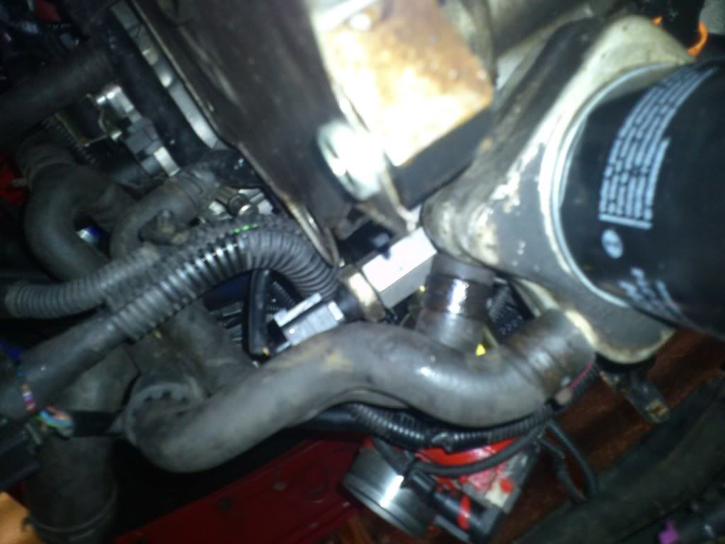

I reckon it will as long as the pressure sender is at 90 degrees pointing towards the radiator if not I will plumb the pressure sender where u said. And put the temp back I the spare.
Aug 22, 2011
557
aberdeen

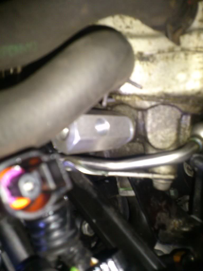

Ok fitted t-piece for oil pressure senders. Plumbed it in where the stock pressure sender is as berg said above slightly more space and keeps the temp sender in the flow of the oil. Pics
