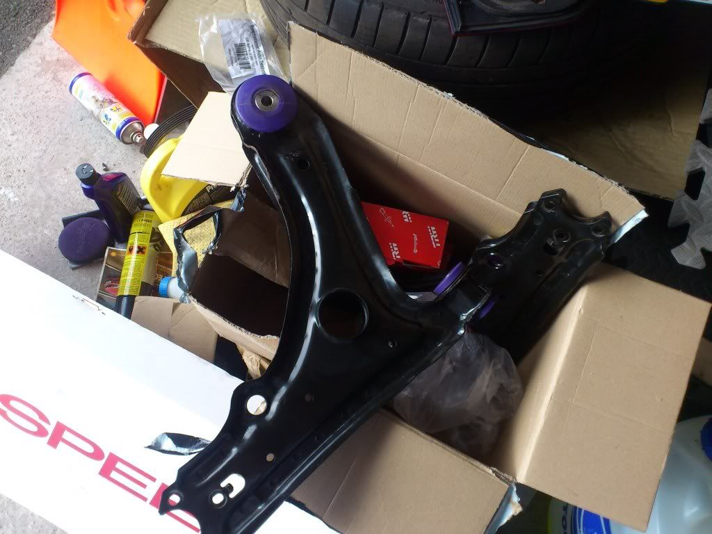

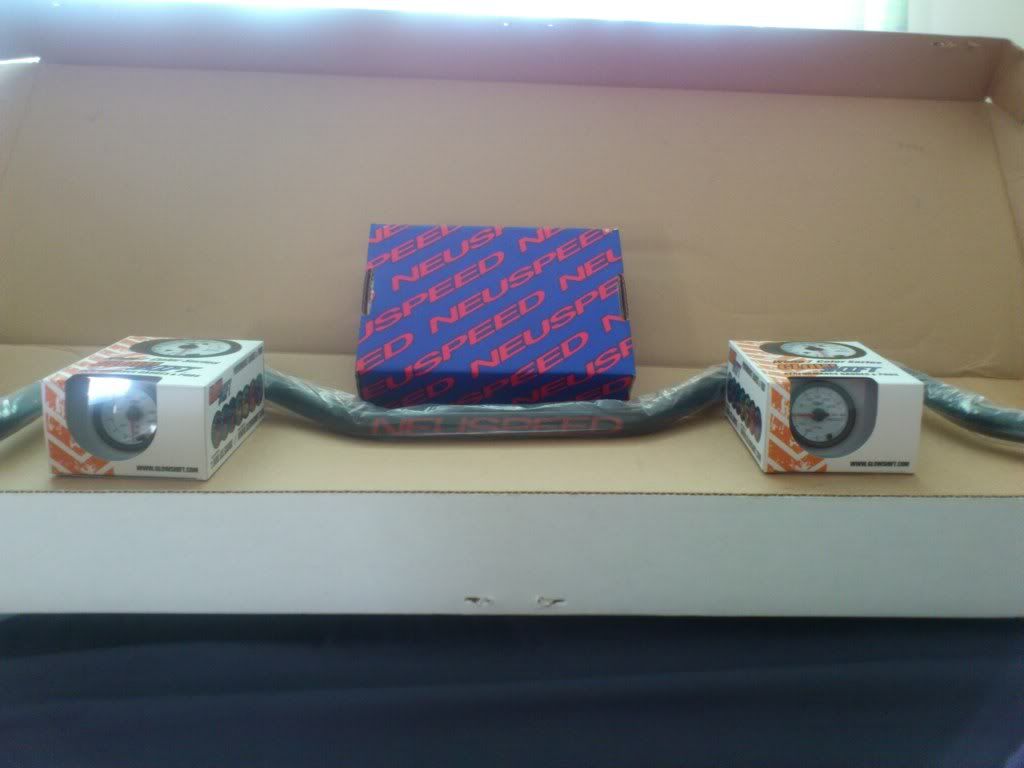

Ok Not updated here in a while. I have just fitted a 50mm drop H&R sport cup kit instead of my crappy coilies. poly bushed front wishbones (Thanks to Chambers_cupra on here) and also fitted a neuspeed 25mm Front arb with adjustable drop-links.
What a difference.

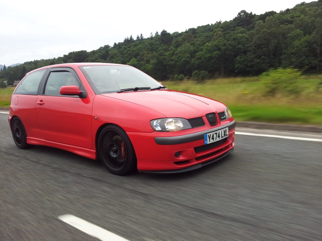

Any way here is a couple of pics on the way down to Crail yesterday. i ran a 14 sec dead on the 1/4 mile. Need more grip of the line and i think a wot box is needed also :D
and the new stuff I fitted

Yeah chears bud they fit fine and the Neuspeed ARB makes one hell of a difference :) handles like a dream now :)

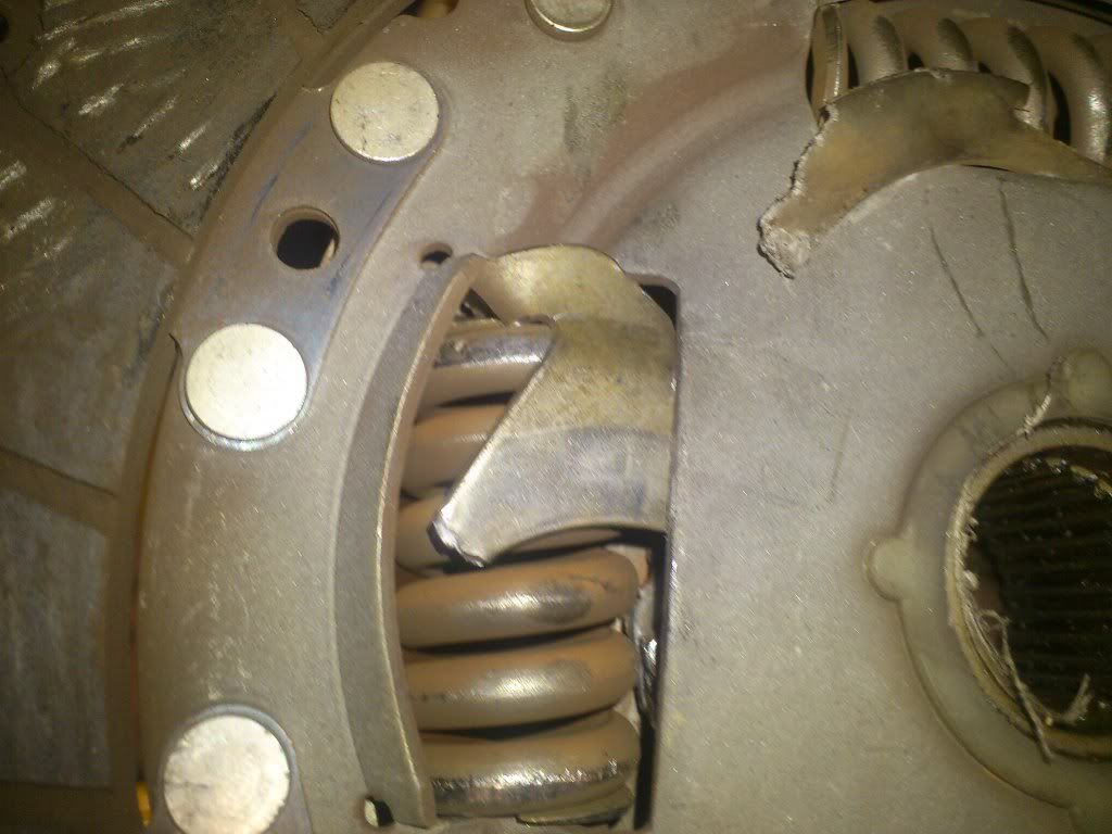

bye bye clutch

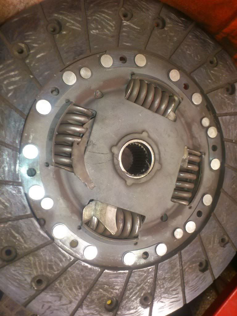

Ok so on monday night at 30mph in 4th gear my clutch decides to pack in.

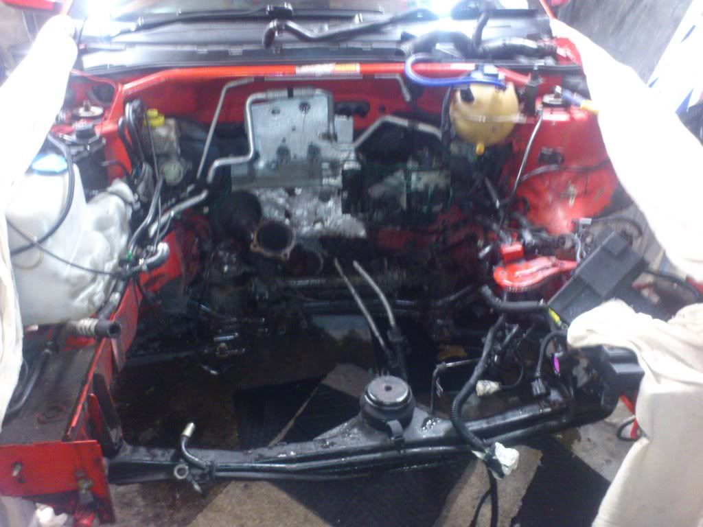

My plans have been brought forward a month so Engine and box now all out the car. Found the rear driverside engine mount f**ked so full set of uprated mounts on the cards also now.
pics of the clutch:

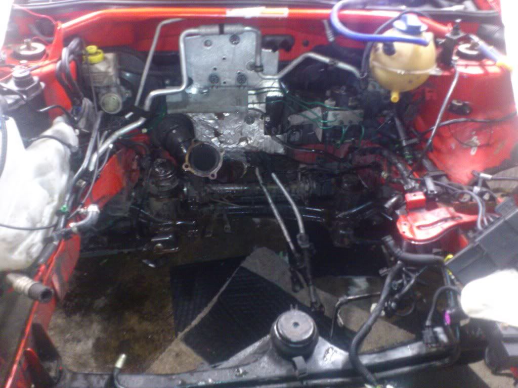

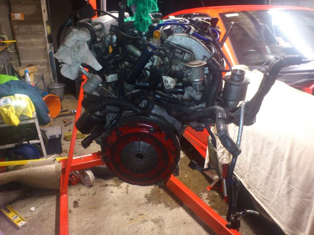

Engine bay as it stands, next job to remove all aircon, carbon canister and to clean and protect it.

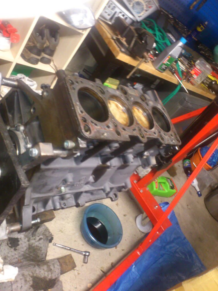

Umm well nee clutch and fly gonna go for southbend setup. Umm ie rifle drilled rods new piston rings valve stems the whole works really :). All the aircon now removed.
Anyone know how to remove the aircon part in the bulkhead under the header tank. I have disconnected the pipes just the bit where they go left.
And is there any guides for removing the carbon canister?

I also would like to know how to remove the gold coloured part of the aircon from under the header tank
As for the carbon canister, follow all the pipes from it, block off the 1 to the tip & throw the rest in the bin

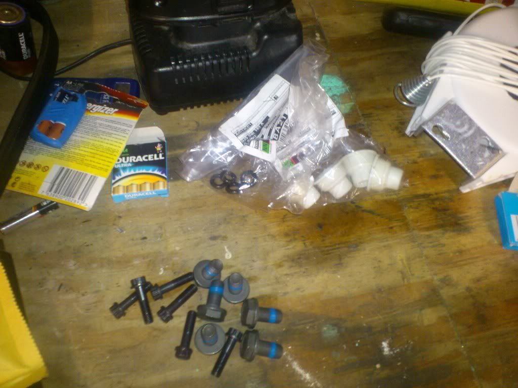

ok New TT short shift fitted to gearbox.

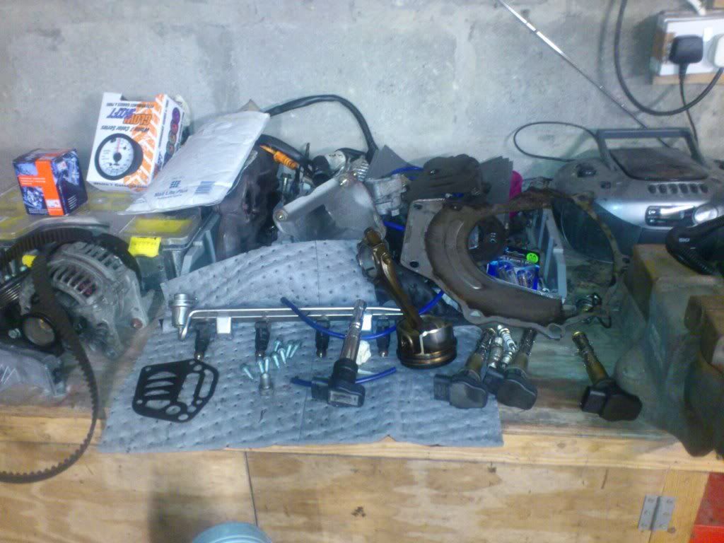

Heres some current pics of he engine and all the parts haha. I'm in two minds whether to buy a new toyosport FMIC.
new clutch has also arrived.
I have replaced all 8 exhaust valve guides in the head as the ones on cylinder 1 and 2 were worn quite badly the other two cylinders weren't to bad but just replaced out of practice. all the valves have been cleaned and relapped the lifters have been split emptied and cleaned and i have had the head skimmed. Just waiting on my Rods and gates performance belt now to do the bottom end then put the car back together
