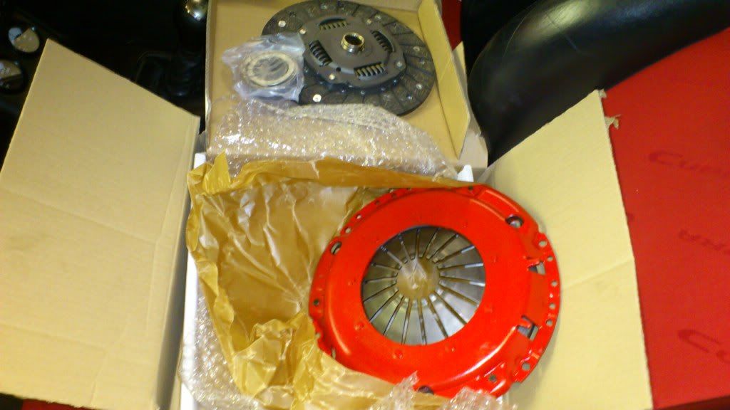

Clutch fitted

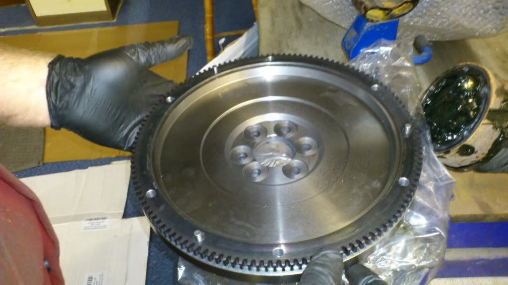

Ok thats the VR6 kevlar stage 2 clutch and g60 Lightened and balanced flywheel fitted. wasn't the hardest of jobs but took a full day. some pics below.

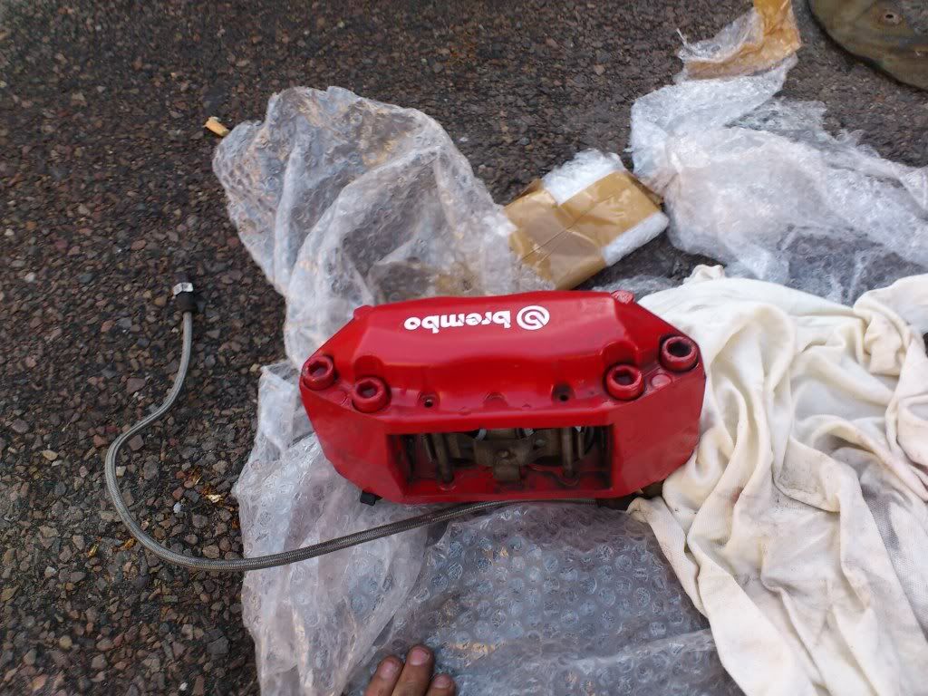

Just ordered a set of Brembos from a Ibiza cupra R so they should be here in a week. Then its time to take some logs and send them away to Rich at viper tuning to get the map sorted out for my car. Cant wait.
New clutch and Fly
On the job
The old knackered duel mass and clutch
The center section of the clutch was knackered it was rattely and horrible the fly had about 2 inch of movement instead of the normal 1cm or 2.

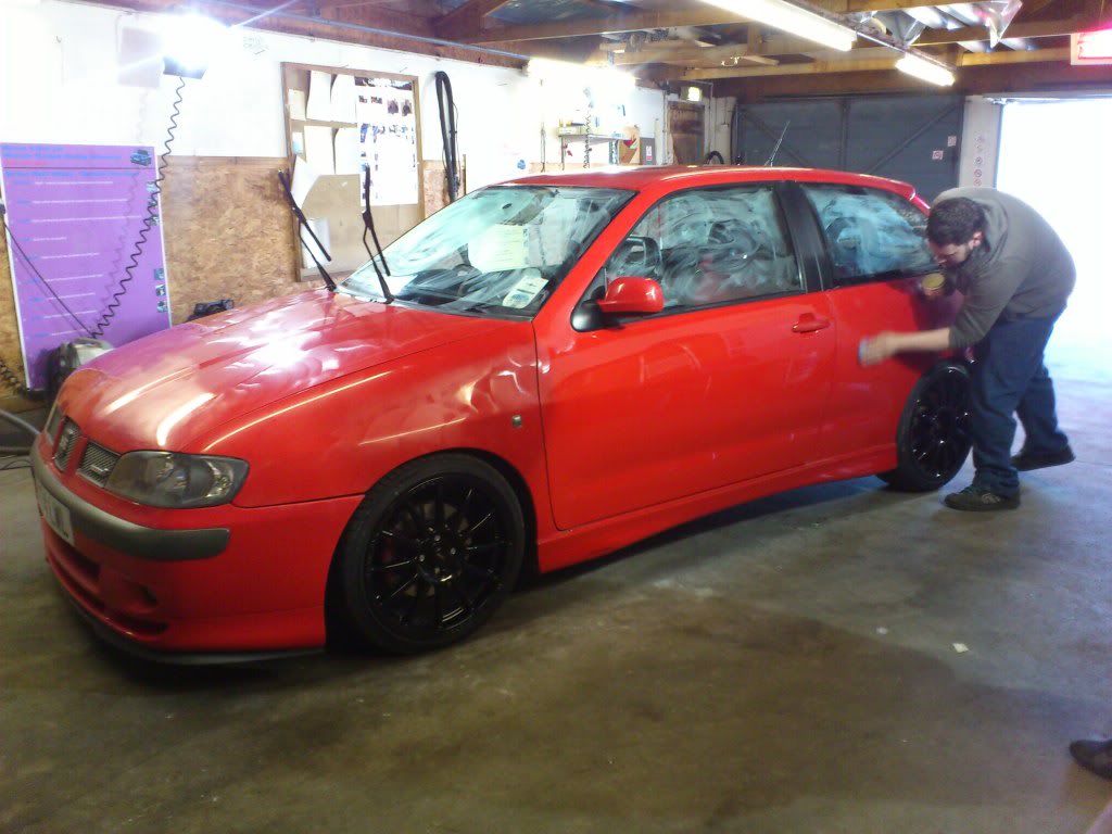

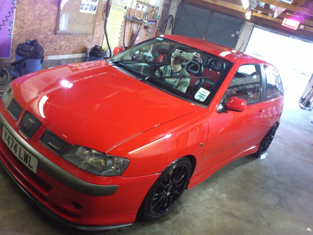

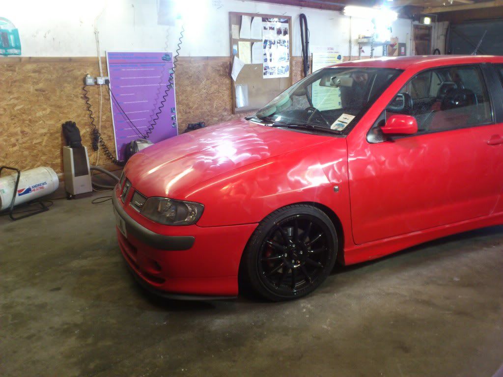

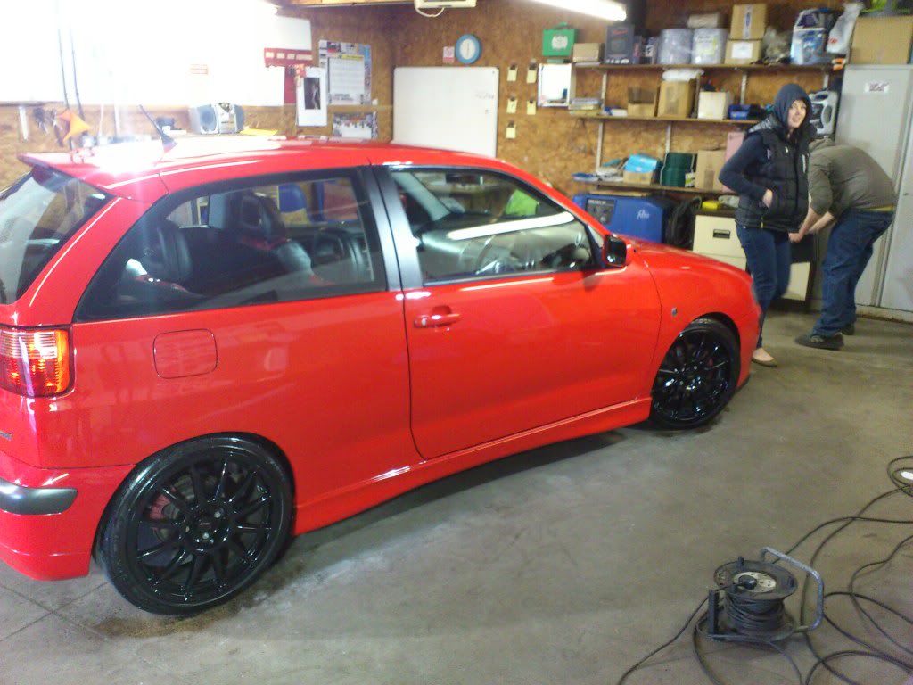

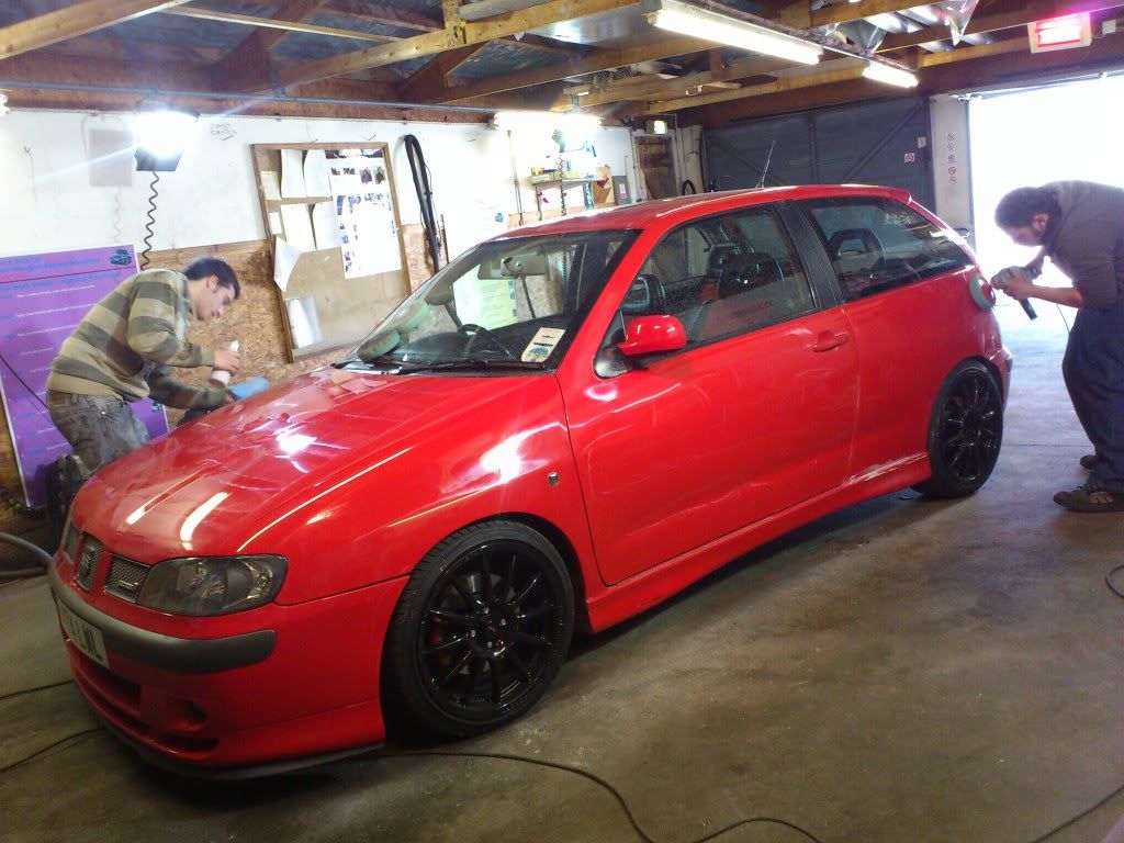

ok this saturday i got my mate to do full body buff on my car. he went over it all with the orbital buffer with hard cutting compound and then the finishing compound and then got polished and waxed. pics

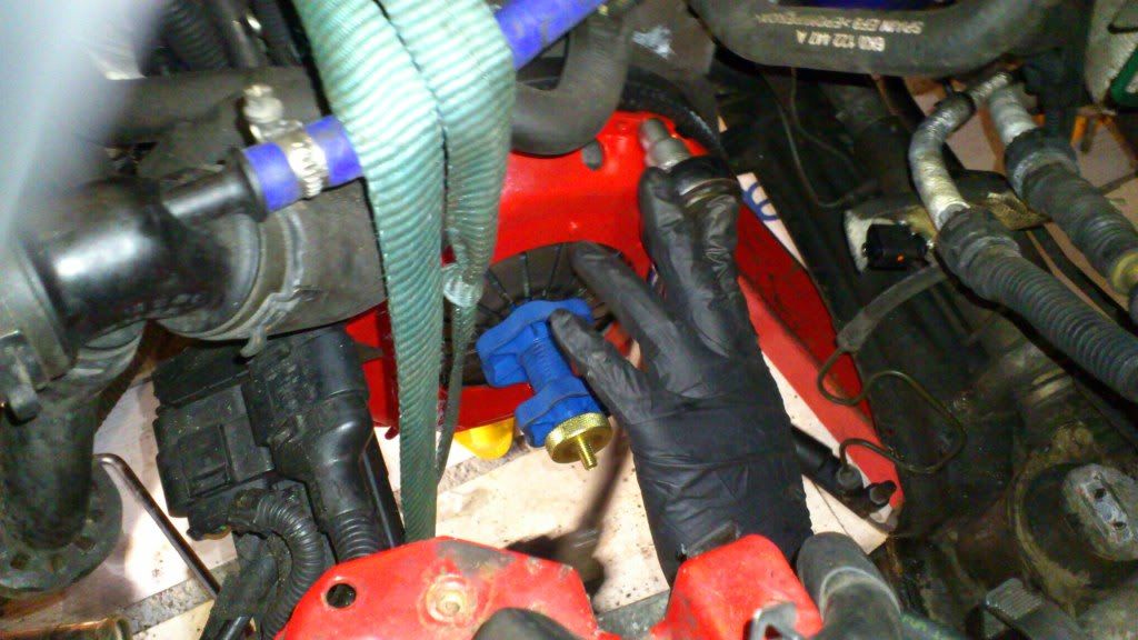

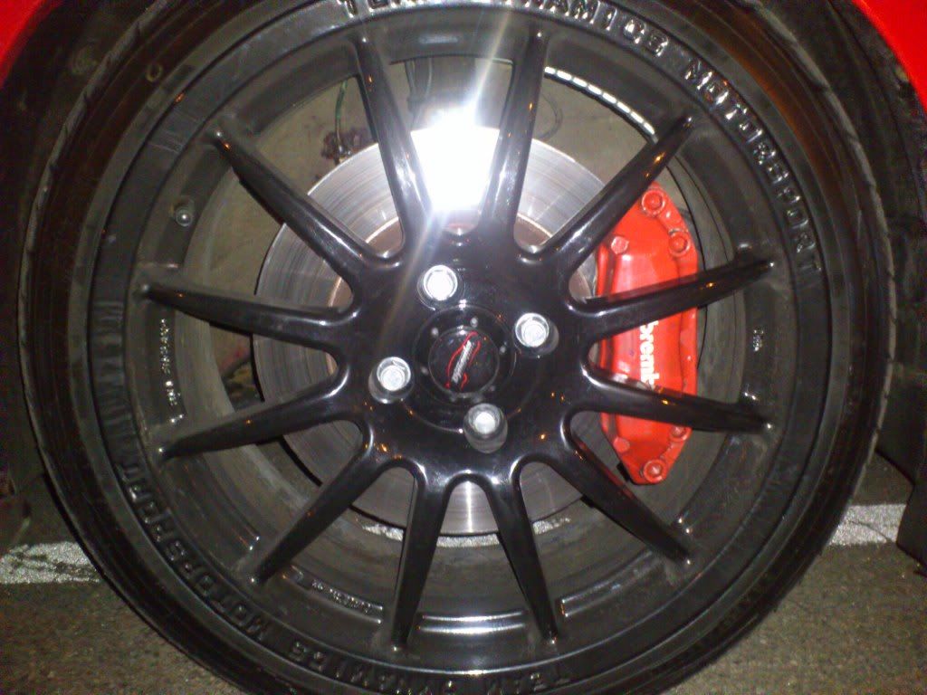

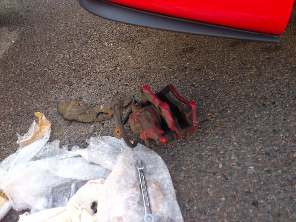

Brembo fitting
brembos fitted
unfortunatley i seem to get a very viliont judder through the brakes once they've heated up. one second they are perfect and excellent then next time i brake they are juddery as hell :( any idea's?
