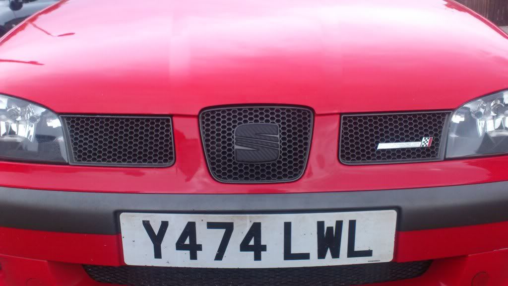

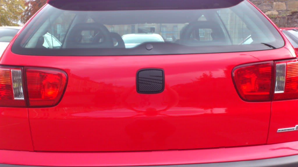

My wrapped badges now;) done iday

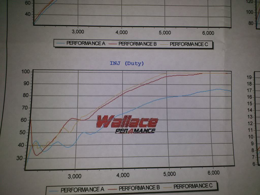

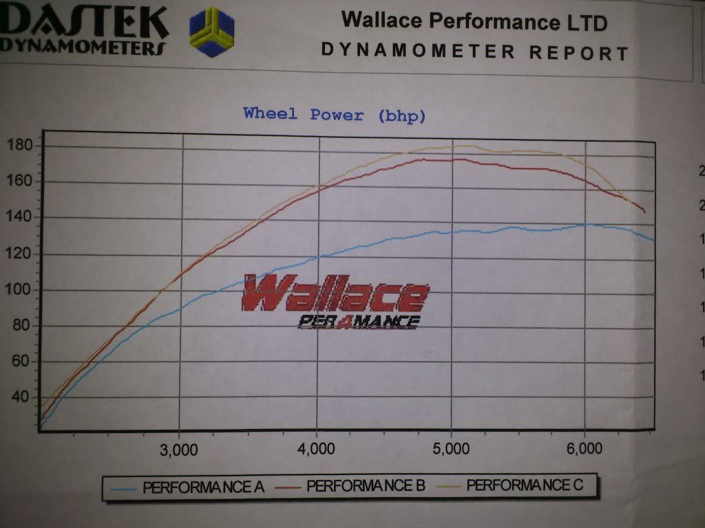

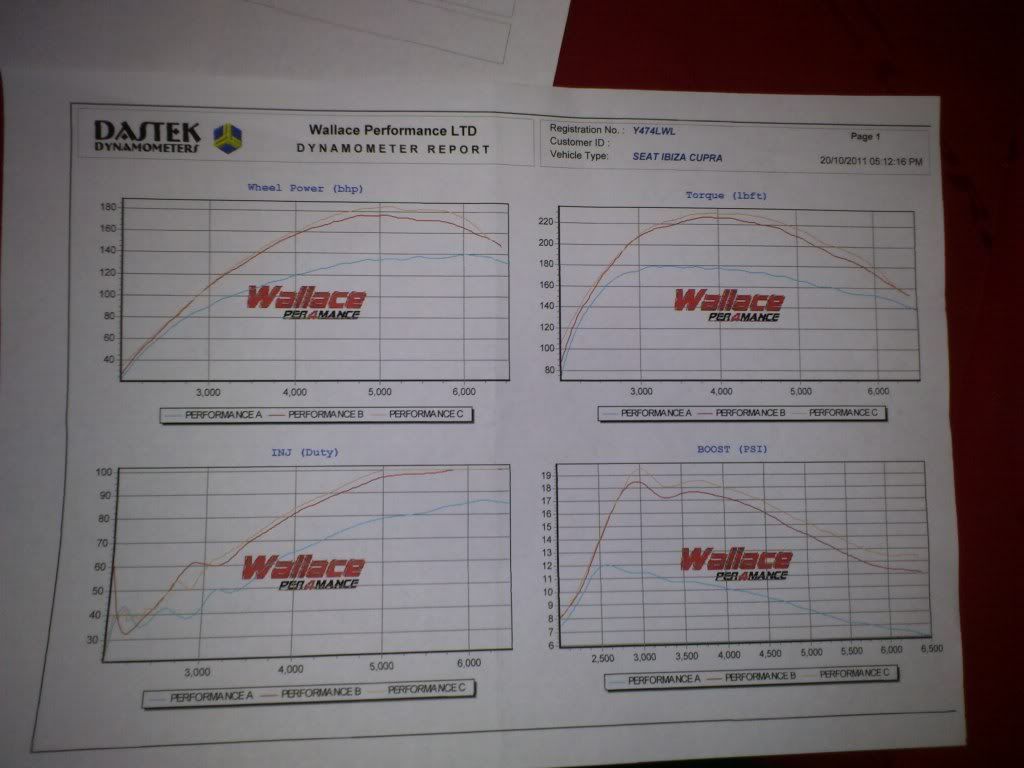

Print outs of the stage 2 map. As you can see from one graph the injectors ar maxing out at 500 RPM.

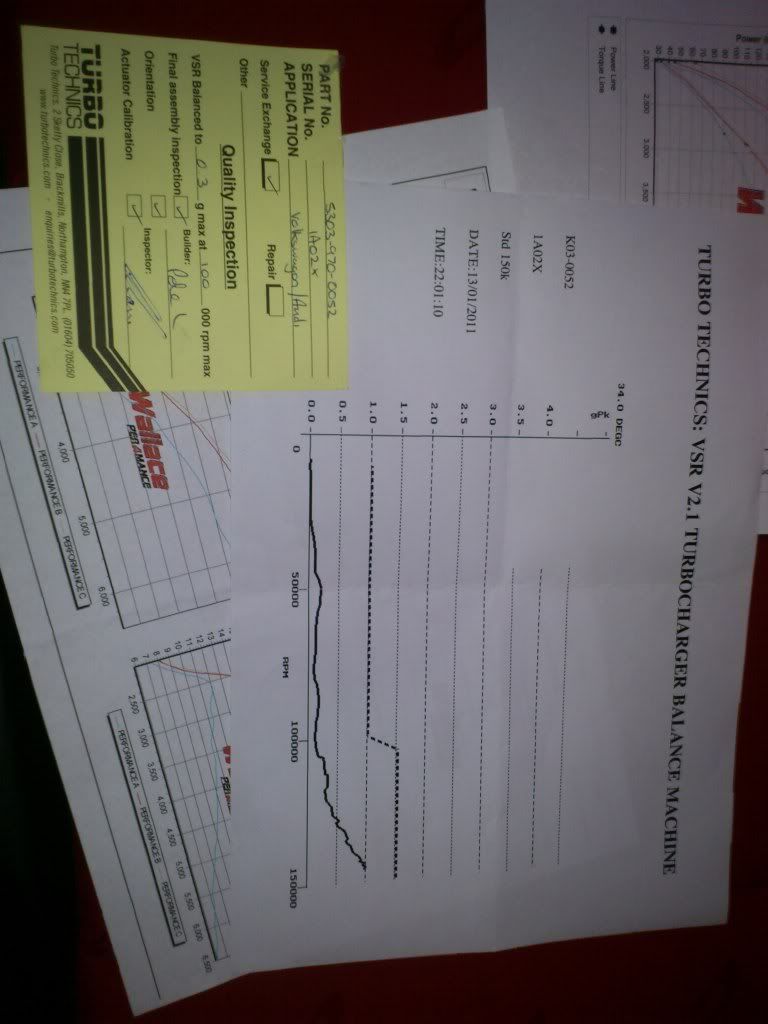

Print out of the test carried out on the brand new K03s

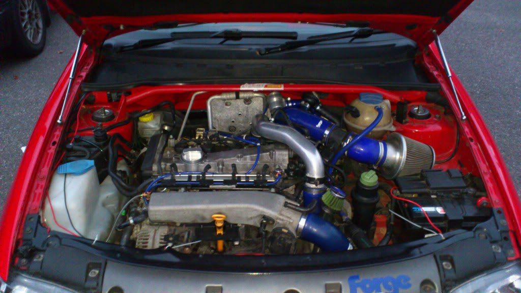

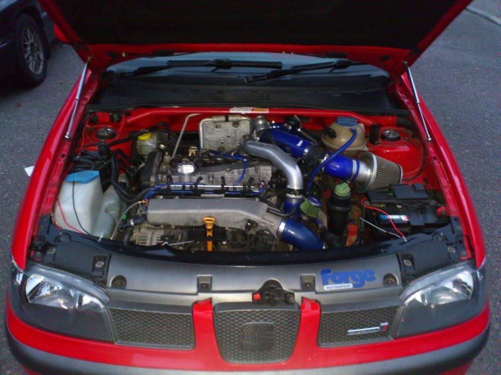

some pics of the engine bay etc.

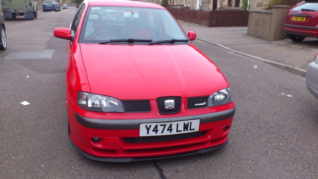

Looks great mate. Looks familiar as well, is this from fife way???
I think it used to run on d90's.

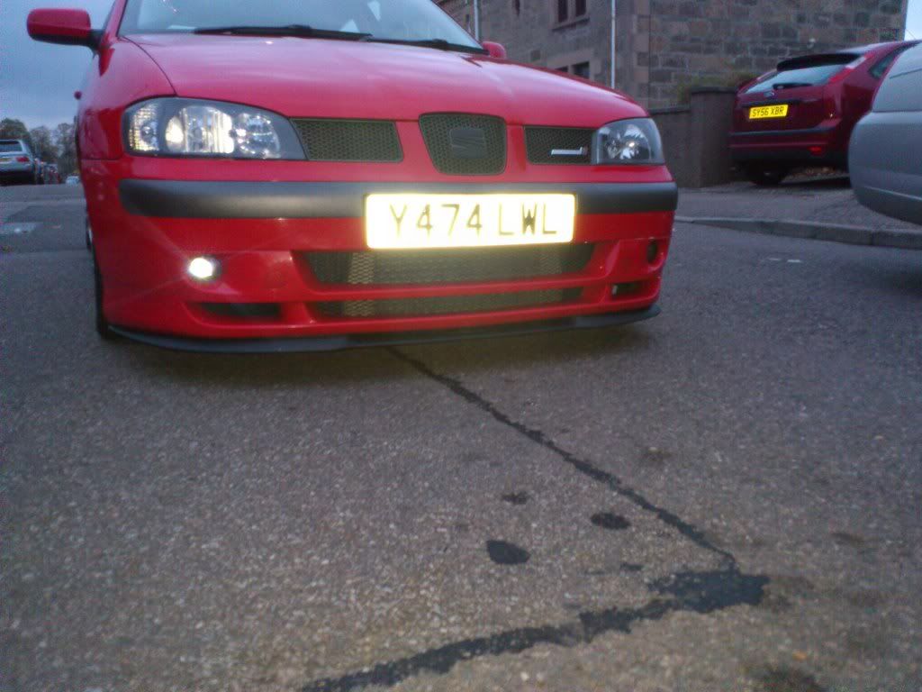

Hi mate, Aye it use to be in kirkaldy on d90's got a FSH and was clean so i jumped at it. now just making it better. had the rear arches sprayed and rolled the rust has been totally removed. LCR splitter on it now aswell really finishes it off

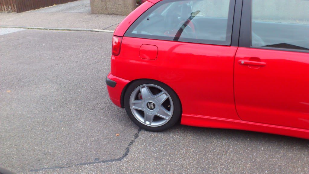

couple of extra pics also
just want to get my wheels powder coated Anthrasite and get the brembo's or wilwoods on the front then i'm finished on the look. maybe a light smoke on the windows also.
I thought I knew the car lol. The lad that owned it was a detailer I think so it was always clean. It used to have pressed plates as well which looked cool. Last time I saw it it was up for sale at a bargain price. My mate was going to buy it lol.

you shouldnt be maxing out on the injectors at 180 bhp something not right there
air+fuel= more power , increasing the size of the injectors won't make more power if the turbo can't flow any more air , its a good basis for k03s hybrid or k04 but on stock turbo its really overkill mate and in regards to 3" maf housing again your car won't benefit from with stock turbo
Ah i get ya mate. I understand how the engine works. I was mixed up with how the injectors flow the fuel. i thought it didn't really matter on the size as the car would only demand how much it needs. However the injectors work via a percentage increase yes? so half throttle means they will flow at half there cc.
Yeah i thought this as well. as you can see from the graphs i put up. they are maxing at 5300rpm. i think this is due to the fuel pump not flowing 100%. so new fuel pump then hopefully can turn the map up a lil. my map is currently set at timing:3 so there alot more potential to unleash.

I knew I had a pic of the car somewhere. This was it with all the wee extra bits on. Looks superb imo.
It does look nice there :).i'm not the biggest fan of the D90's think i'm gonna get the standard alloys powdercoated or get a set of Rota Torques.
What you don't see on that pic is the rear arches were begining to bubble. I've had that sorted and the arches rolled slightly so there is no more scrubbing. also put on a new LCR splitter that one had been ripped off before i bought it.
