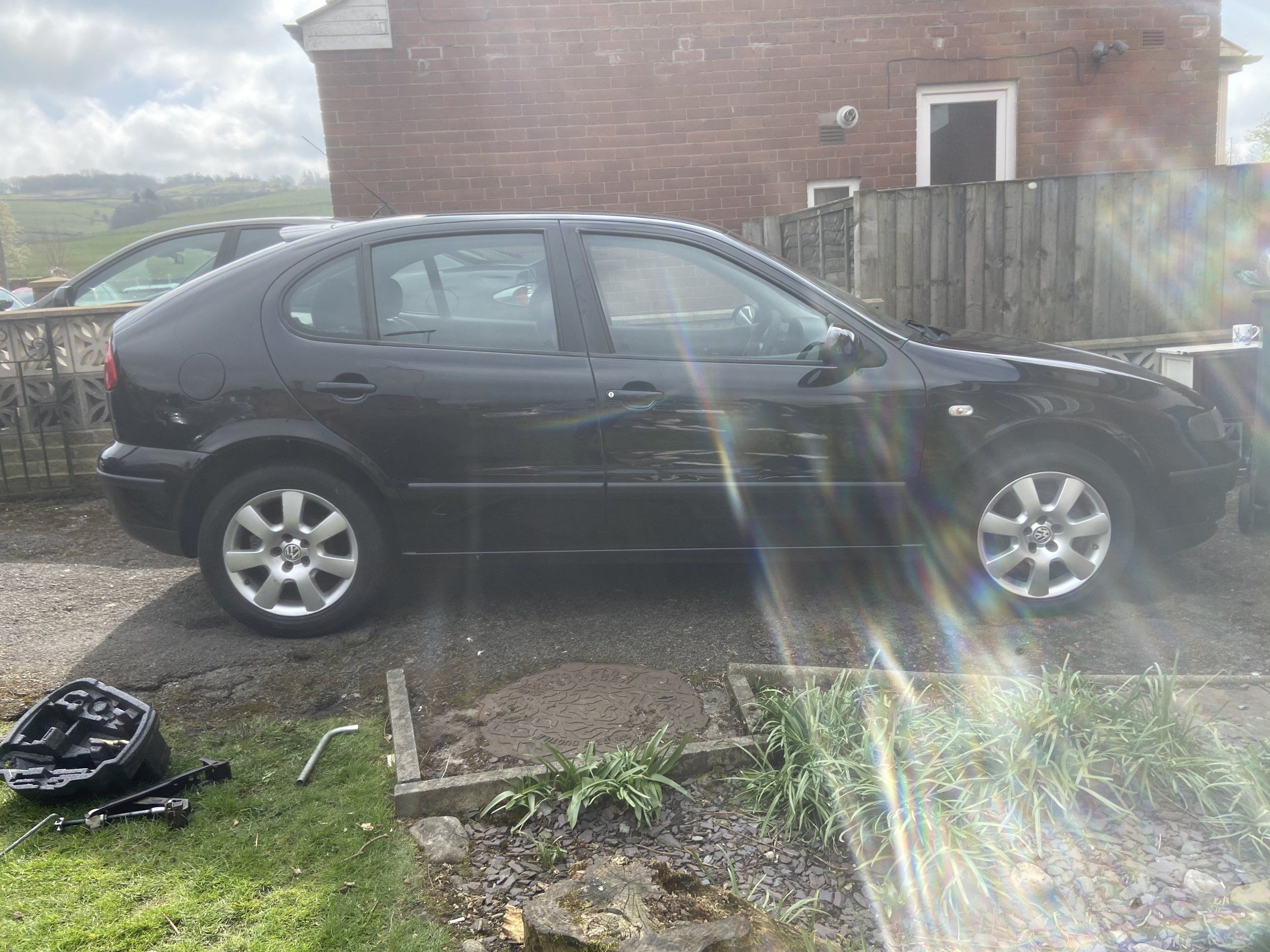

Hello! Basically I’m just going to dump a question or two I have here incase anyone can help. Bought a mk1 Leon 1.9 tdi (pretty sure it’s the S so the slower of the bunch) and want to put some effort & money into it as it’ll be my first “proper” car. (Just as a heads up I’m in Manchester so any recommendations on garages these ways are appreciated)
- the brakes have rust behind them on what I’d call maybe a disc shield / cover (it’s been a long week lol). What would be a good option to swap out the whole unit? Should I just buy everything I need and driveway fit them or has anyone got a garage in the North of the UK that they could reccomend for brakes?
- the clutch is stiff as a nun on Easter Sunday, I’ve been told a bleed might help but is there anything else that might help? I’m guessing a new clutch tbh...
- would a remap be worth it? I’ve had a google an see a few offering 90 to 130 and wouldn’t mind slowly swapping out some crusty engine parts over time anyway as for the best part of 16 years the previous owner obviously had a skill for parking under heavily bird populated trees.
some final questions so I don’t have to make any more posts:
- mid range coil over recommendations around the £500/£700 mark
- rear bumper recommendations (mine hides the exhaust and I’ll be needing a new one of those)
- any tips for a new owner?!
