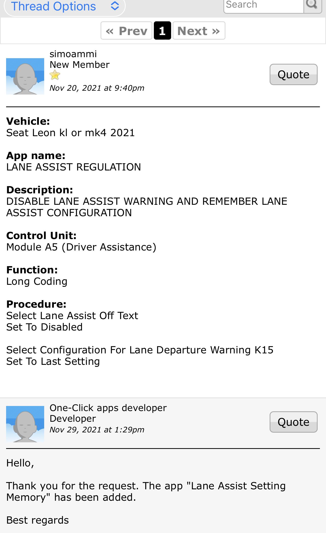

Hi! Does anyone know how to disable the lane assist warning light? It activates still everytime I get in the car, even though I’ve disabled lane assist permanently. The warning still displays

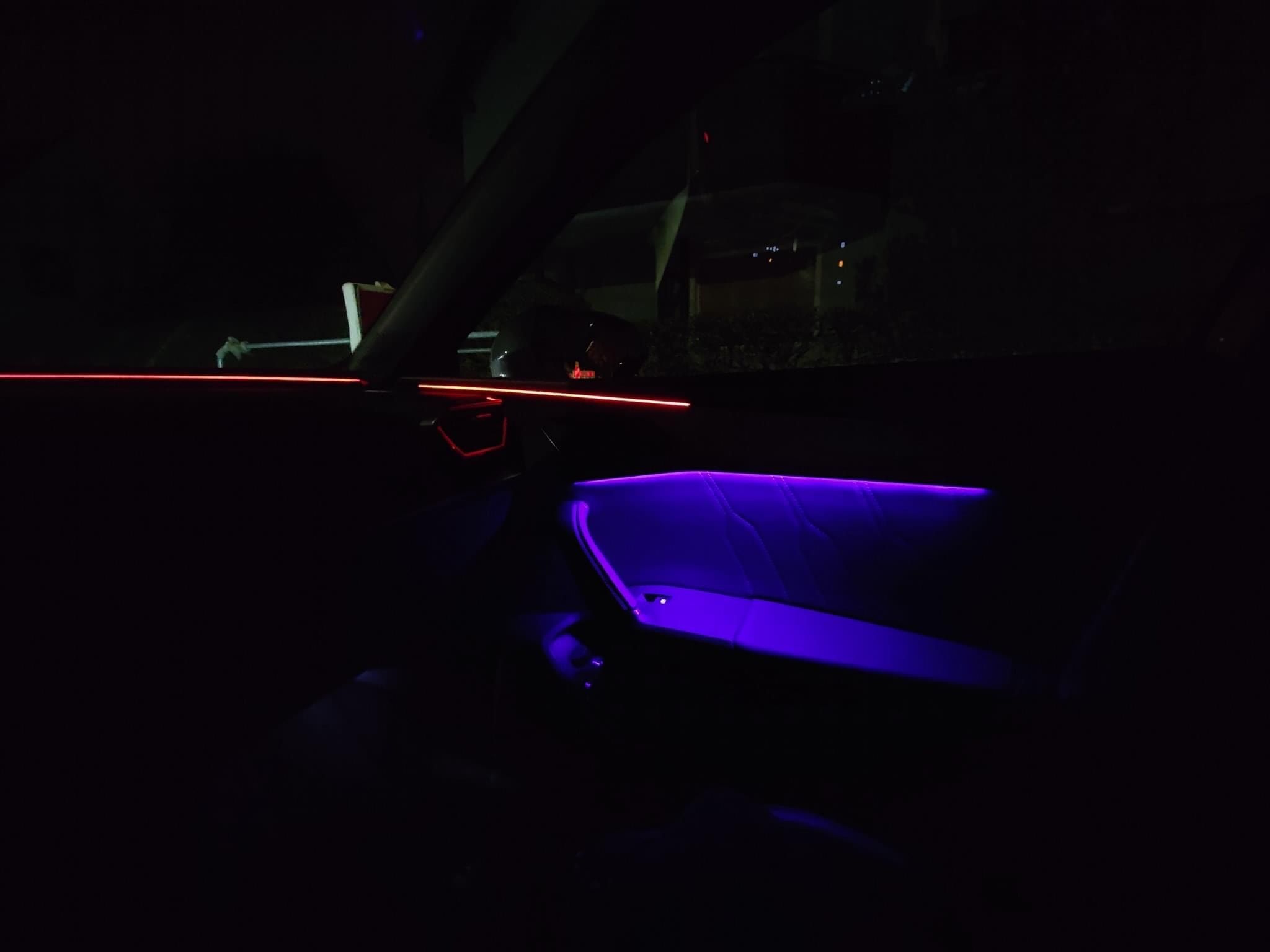

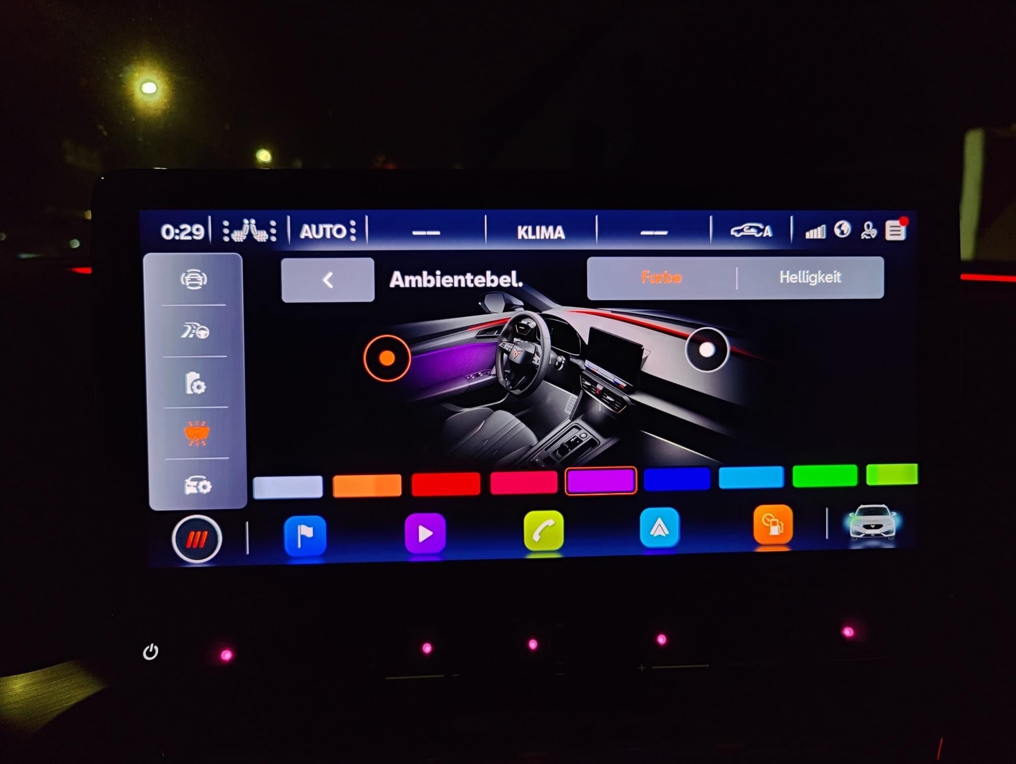

MQB-coding & retrofit on Facebook succeded to code the purple color.
However so far he has to use a vcd or vci diagnostic tool to make it work.
As per his say, for now, it appears to not be possible with obd or vcds.
Might be a Swap code thing which is beyond obd and vcds. VAG holding the upgrade keys to its chest. I know there was displeasure posted up on getting stuck not on the colour they were on after obd tinkering.
I think some modules are unlocked such as the ones above, some do require a password but this might change in the future.

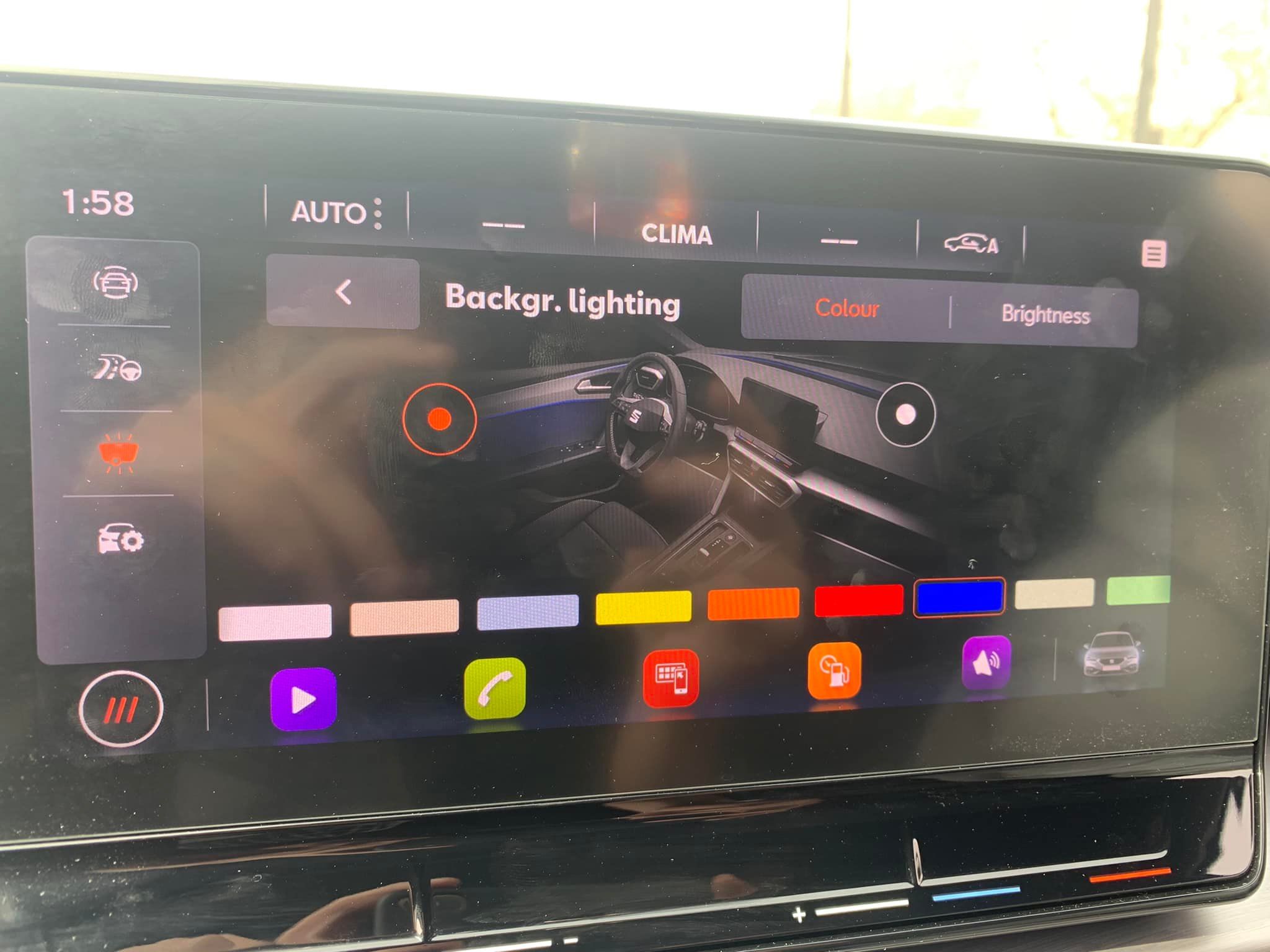

Is coding extra ambient light colors (specifically purple) not possible? I already have the wraparound lighting option, its just that the colors are quite limited.
