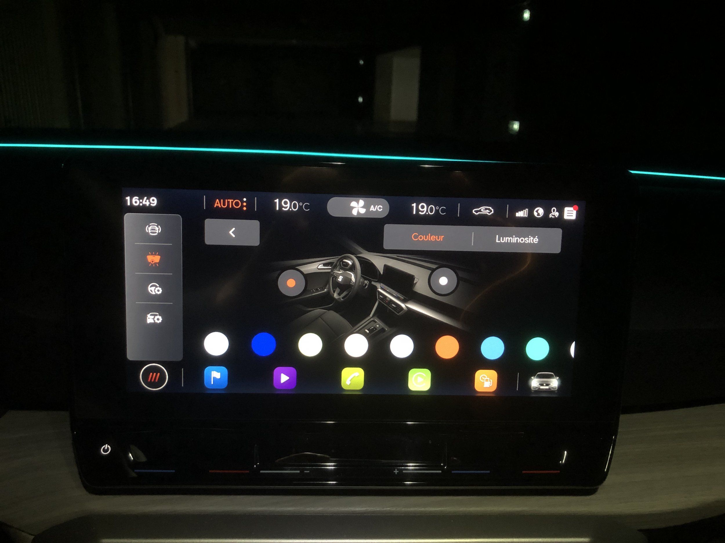

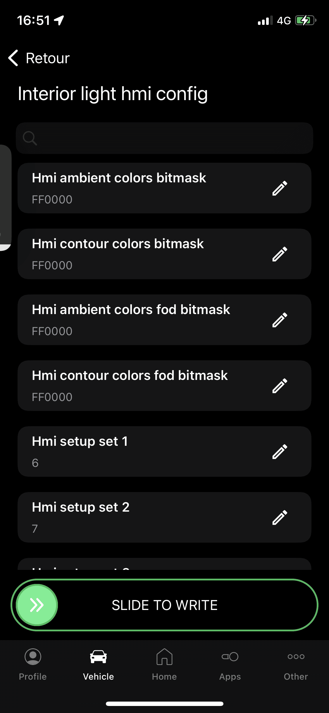

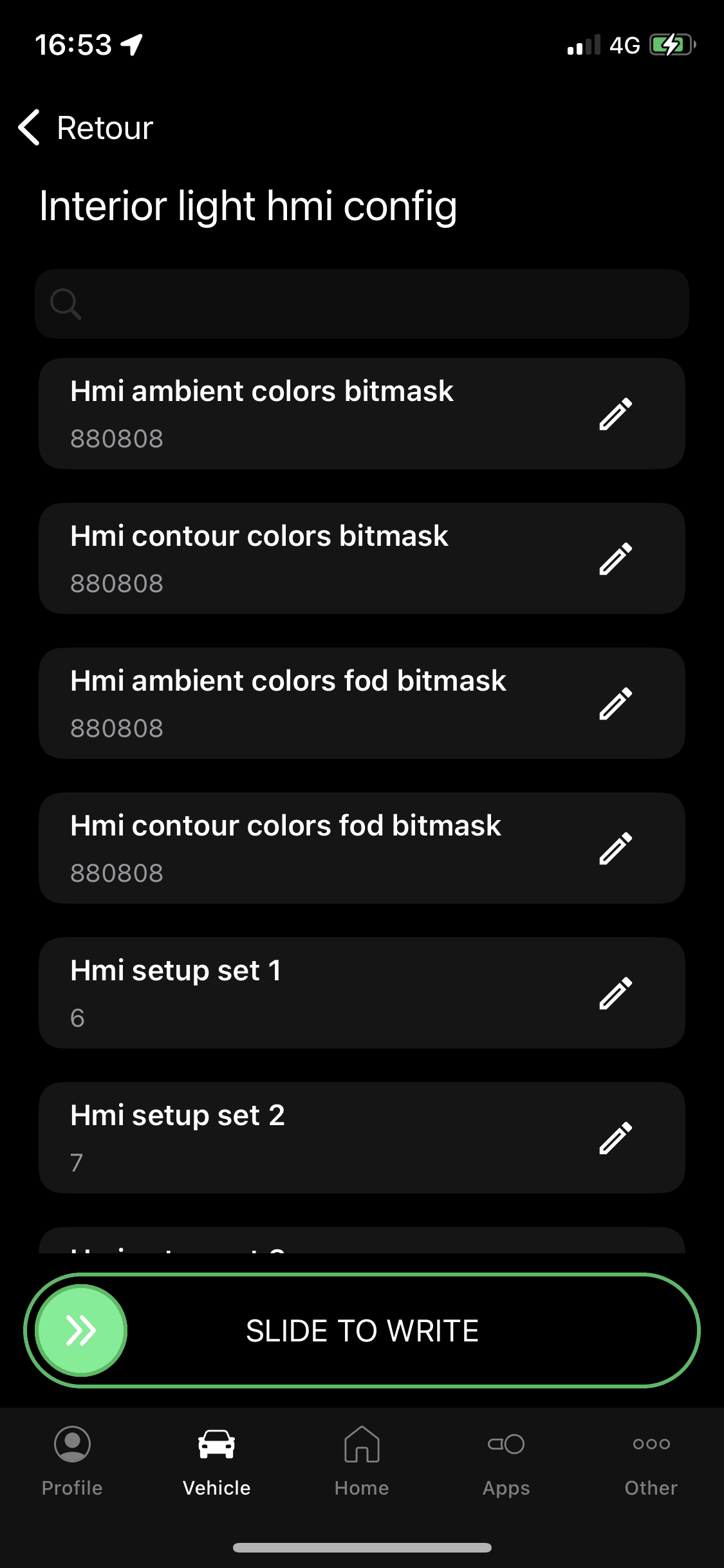

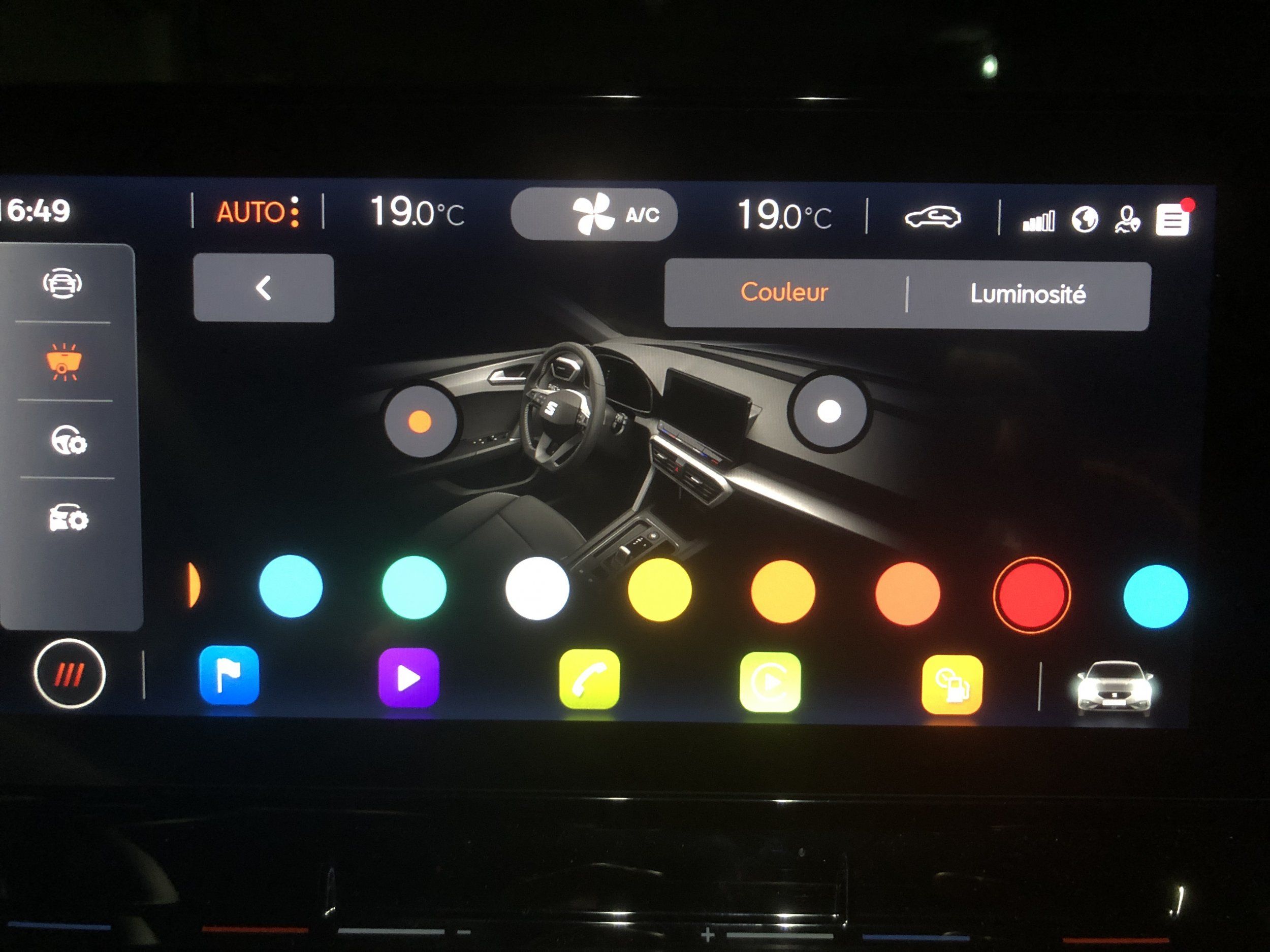

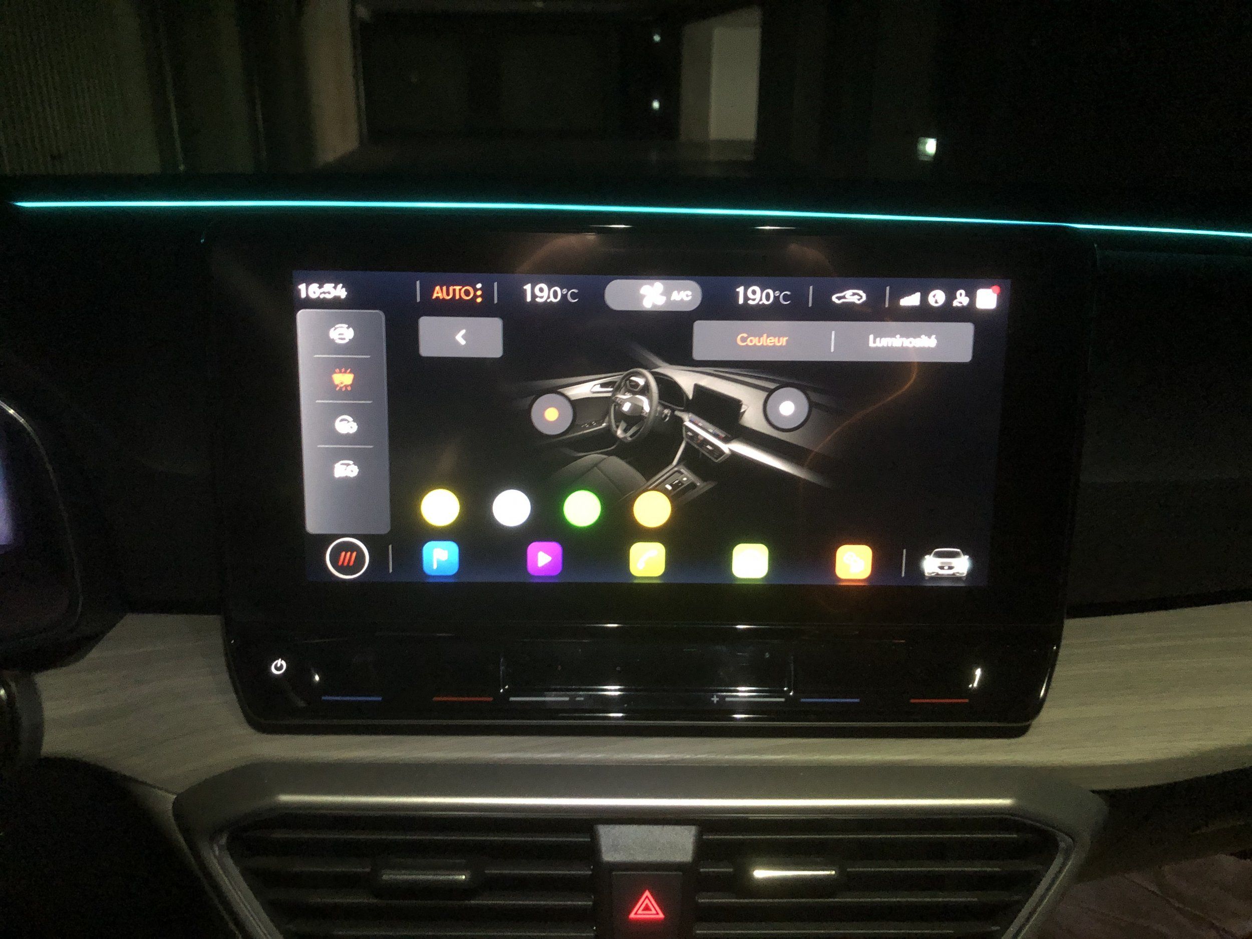

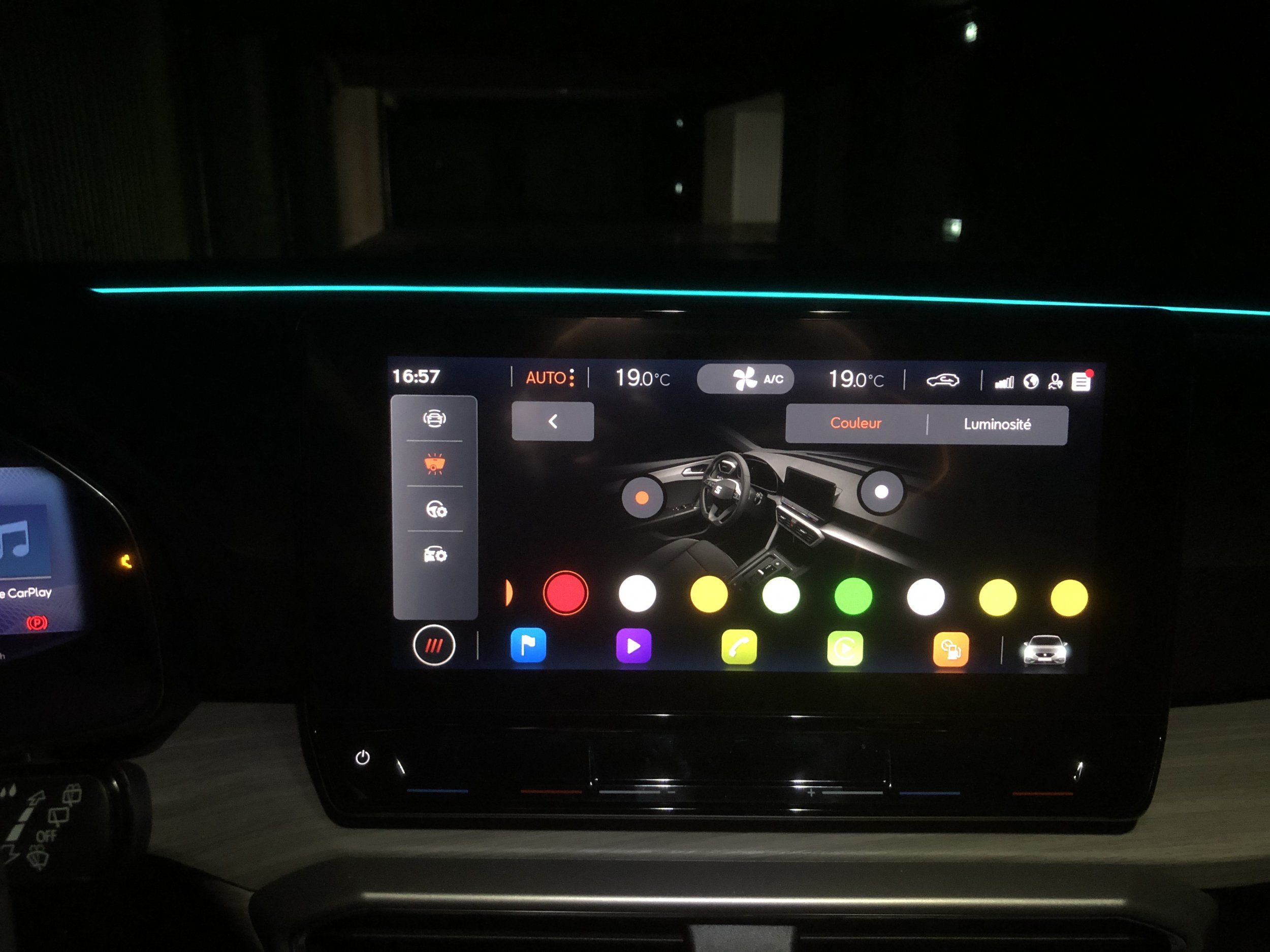

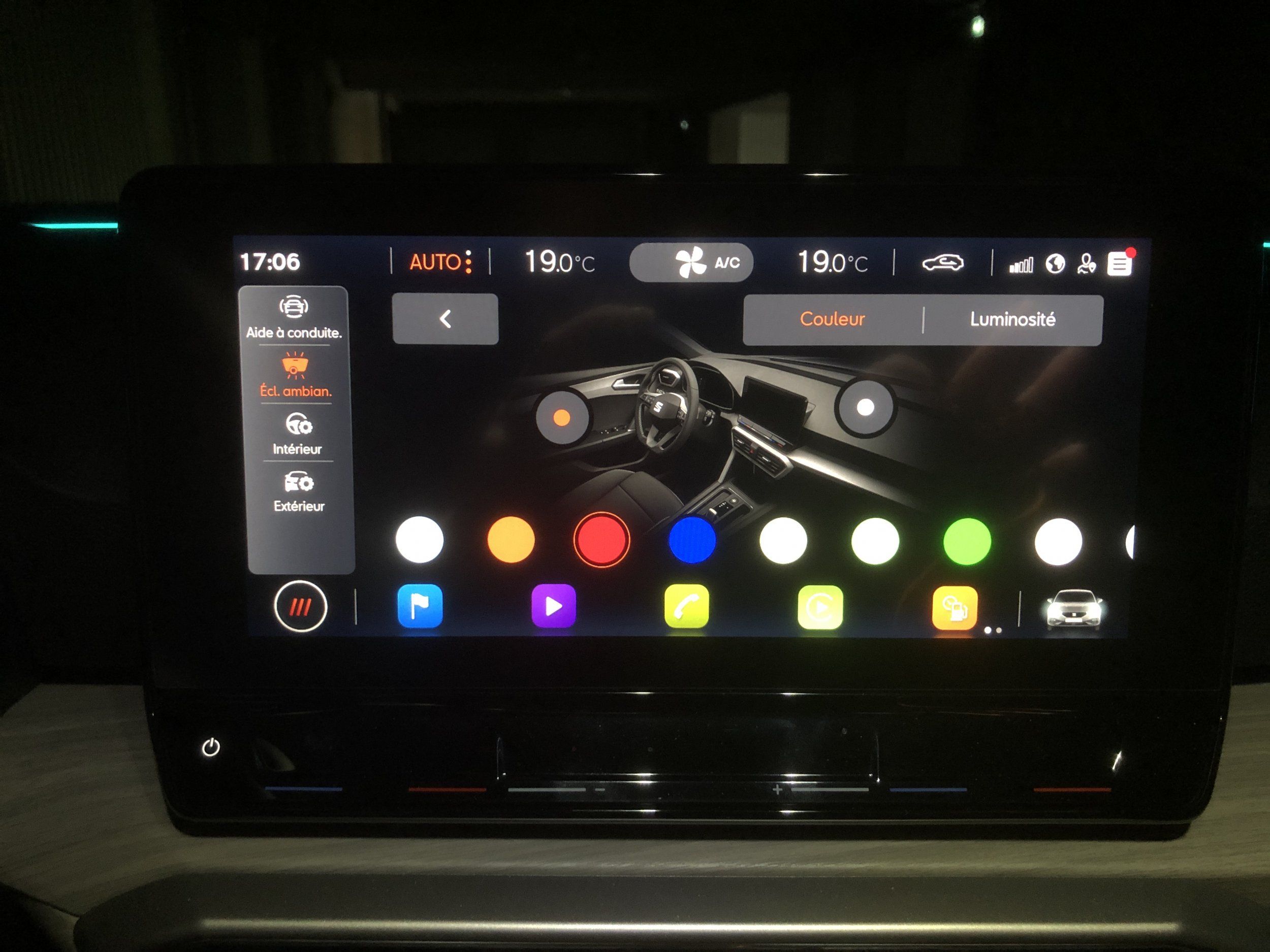

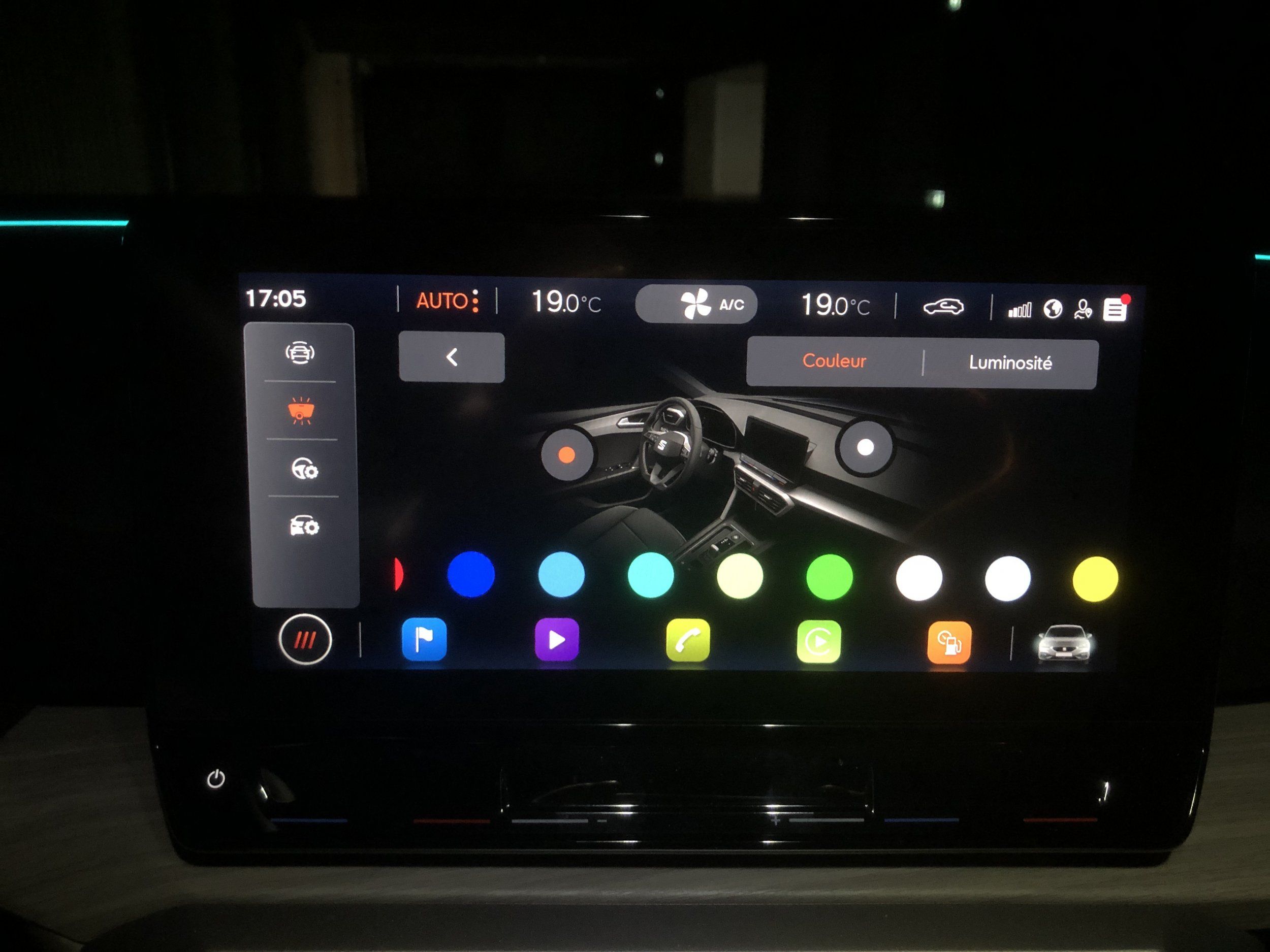

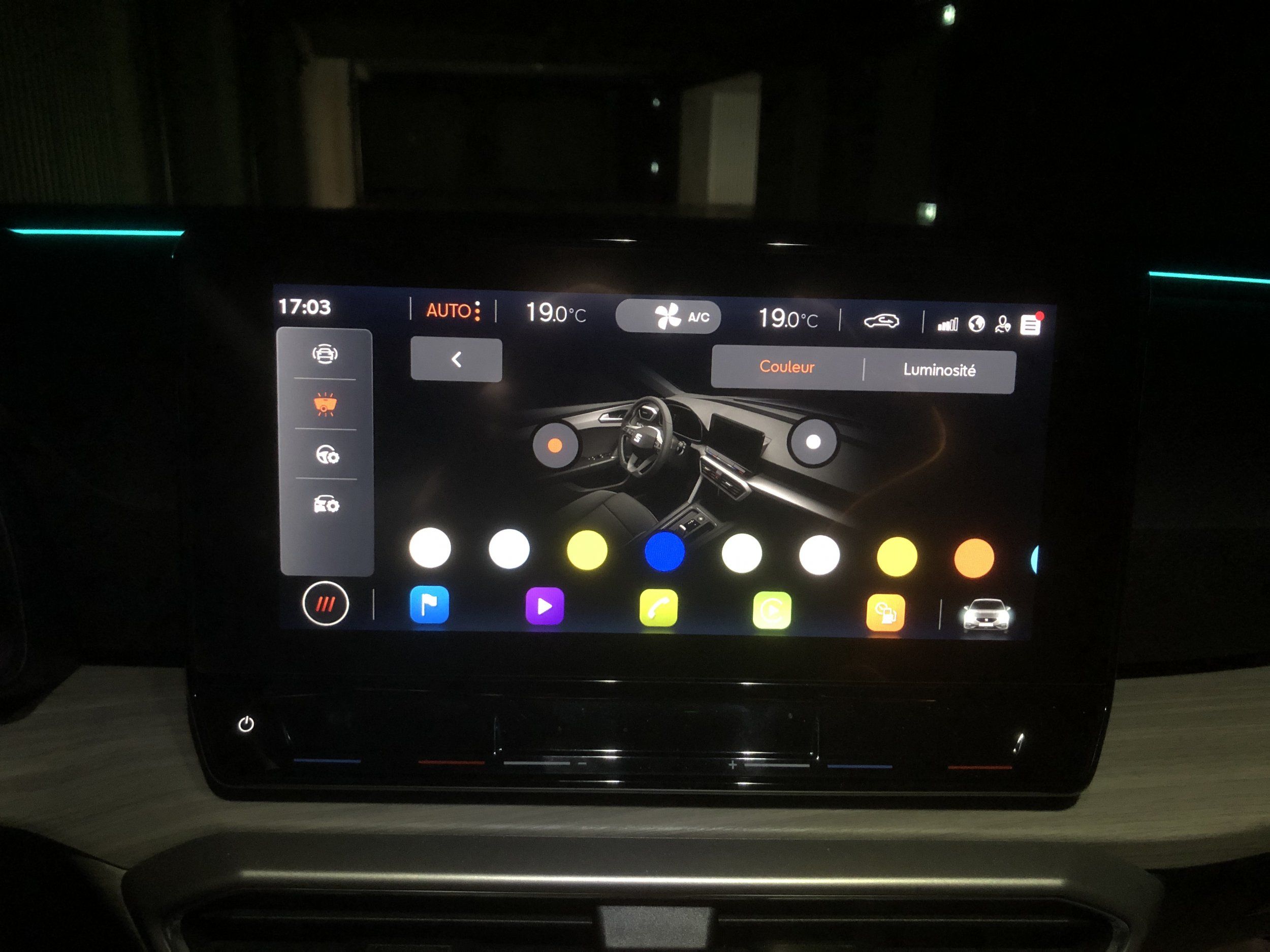

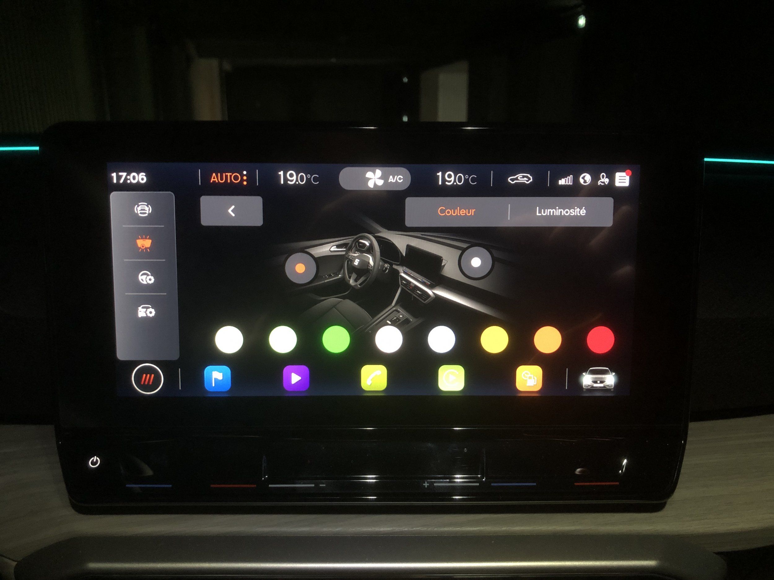

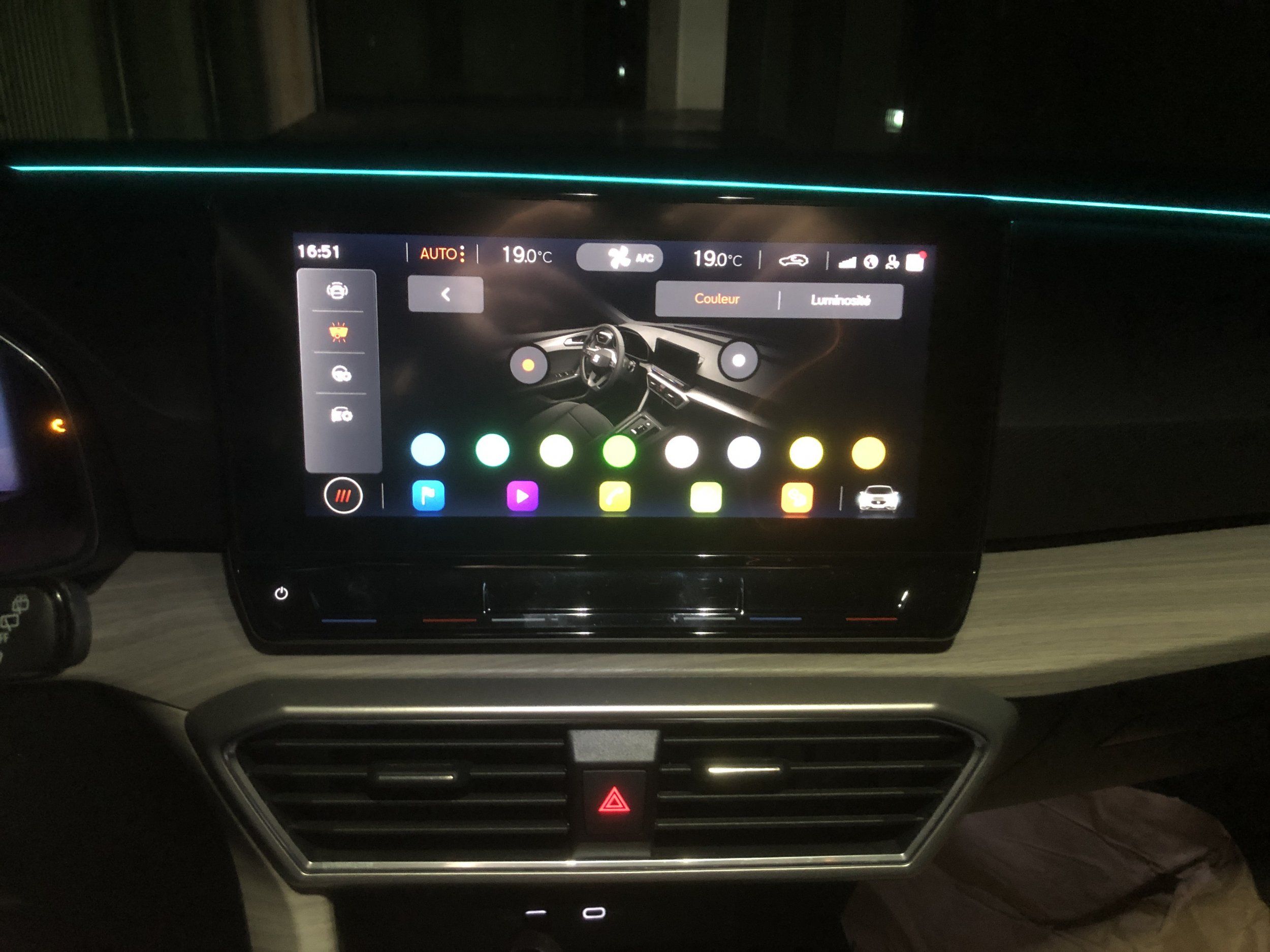

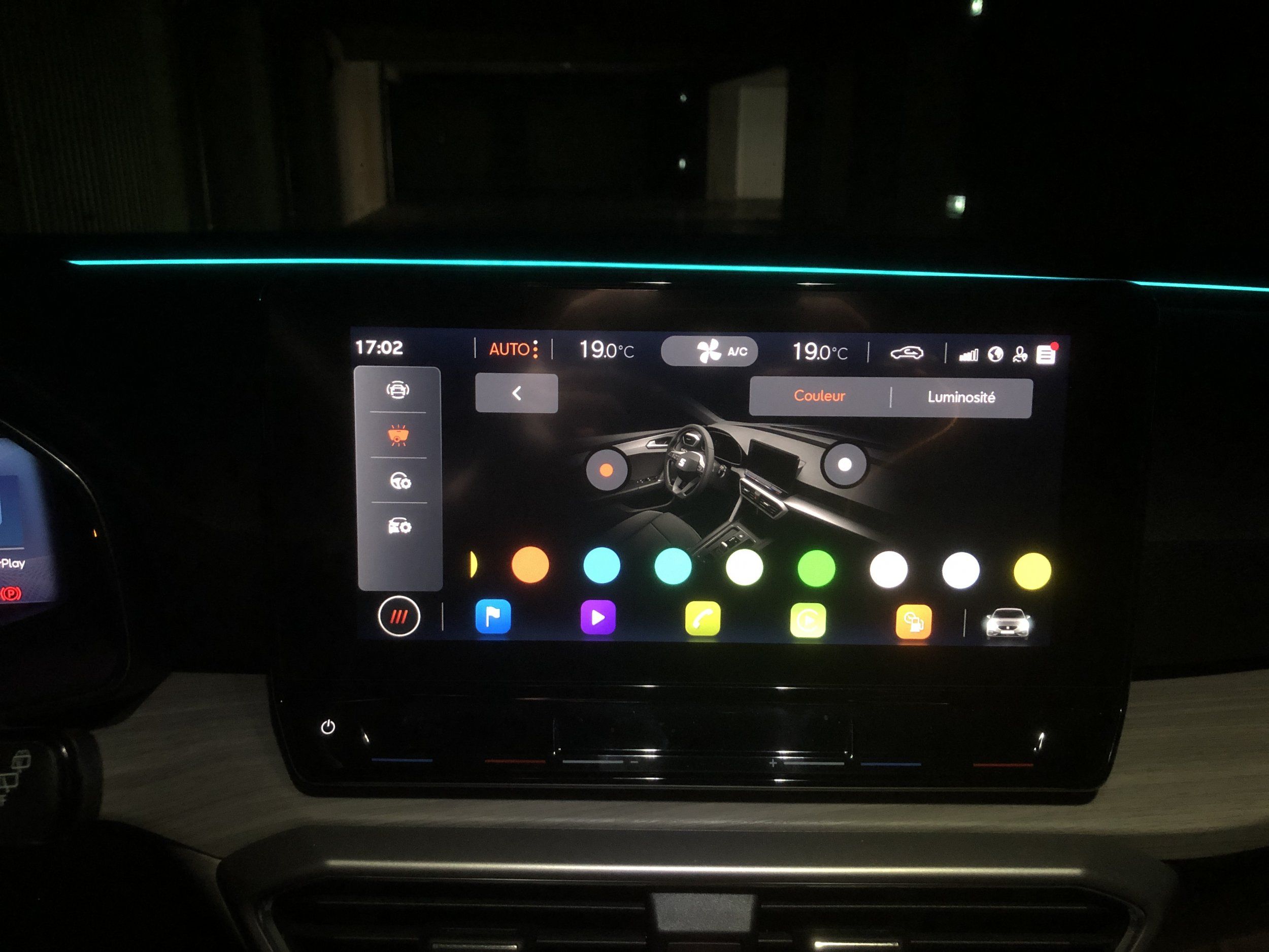

So tried some codes for the ambient light:
(as a note: The photos seem to show for exemple many whites, but they are indeed different white/grey-white/grey/very light blueish.)
7F34CD > 15 choices, I think 2 duplicates in the yellow but other wise different tones for all colors.
880808 > (this is the hex code for a red) only 4 choices and no blue or red.
DC143C > many choices of different yellow/orange tones, no blues.
FA32CCA > 14 choices, many white/grey, blue, yellow/red/orange but no real green.
FF0000 > (red hex) only 8 color choices, no red
7FFF4 > (here I tried beginning with 7F and adding a 4digit green hexa code) 20 choices, some duplicates.
So far, from what I'm gathering, codes beginning with 7F give the biggest number of choices, but also with some duplicates.
I'm sure there's something to find here in order to have access to more choices and no duplicates.
I wanted to try to new codes, so didn't go over all my previous one for the dark red. But I'll eventually retest them all
