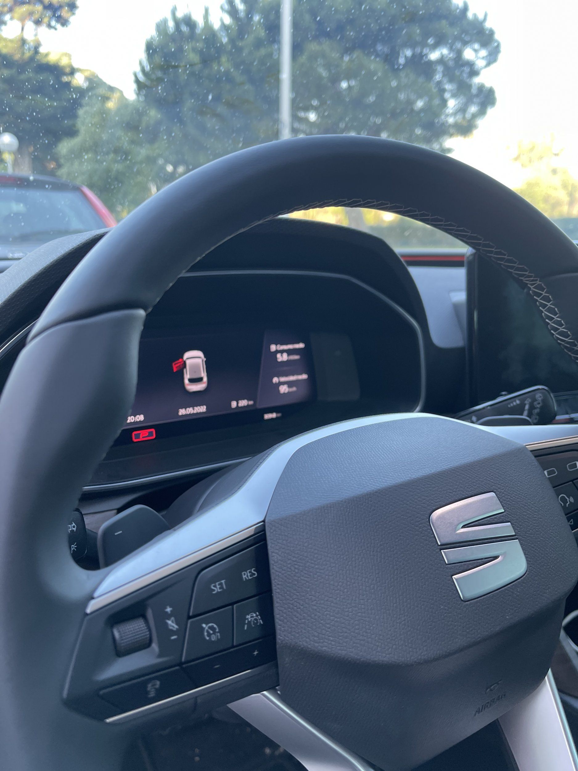

Well, the retrofit travel assist club has another member 😄 Got my new steering wheel 2 days ago and did the retrofit yesterday. Tried it out on a relatively long trip I had to take (600+ km) and worked like a charm!
What is the steering wheel part number with shift paddles?
