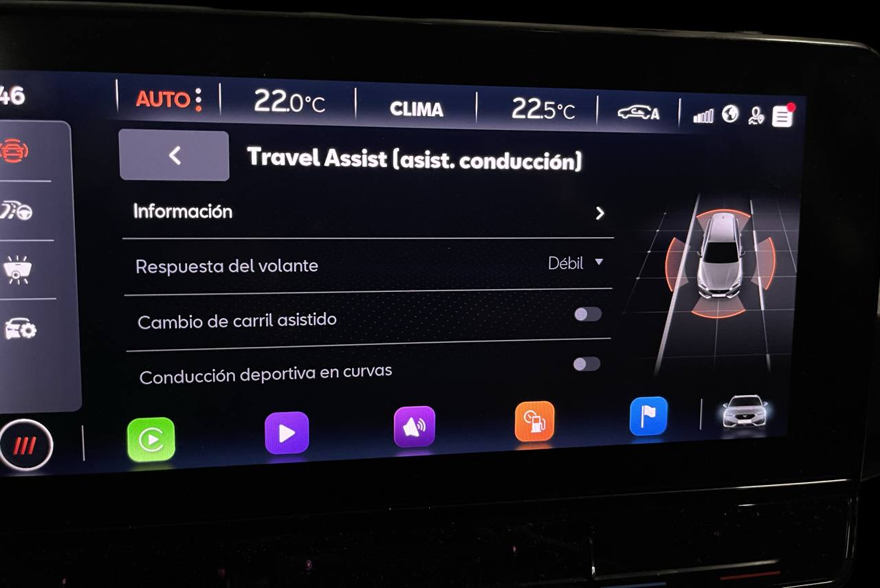

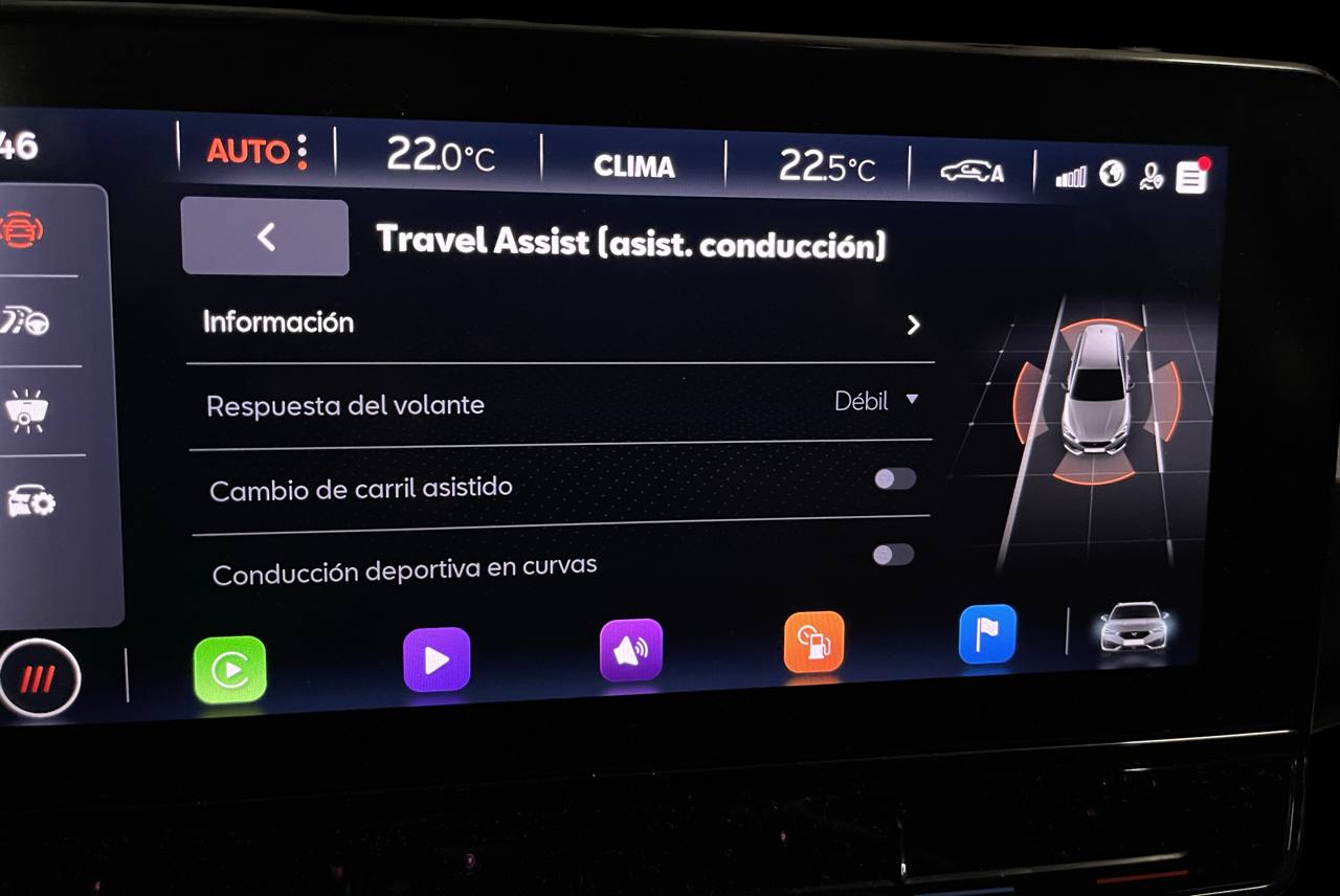

How can I activate this travel assist submenu? I have heard that it is the version of travel 2.0
Reactions: klez and OmerG

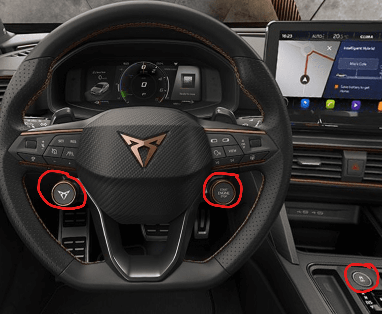

Here you can find a picture of a capacitive steering wheel. Check the button with the lanes (underneath the Res button).

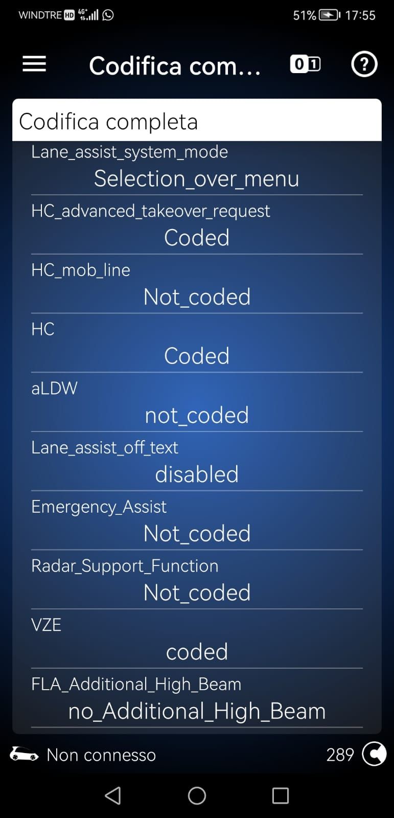

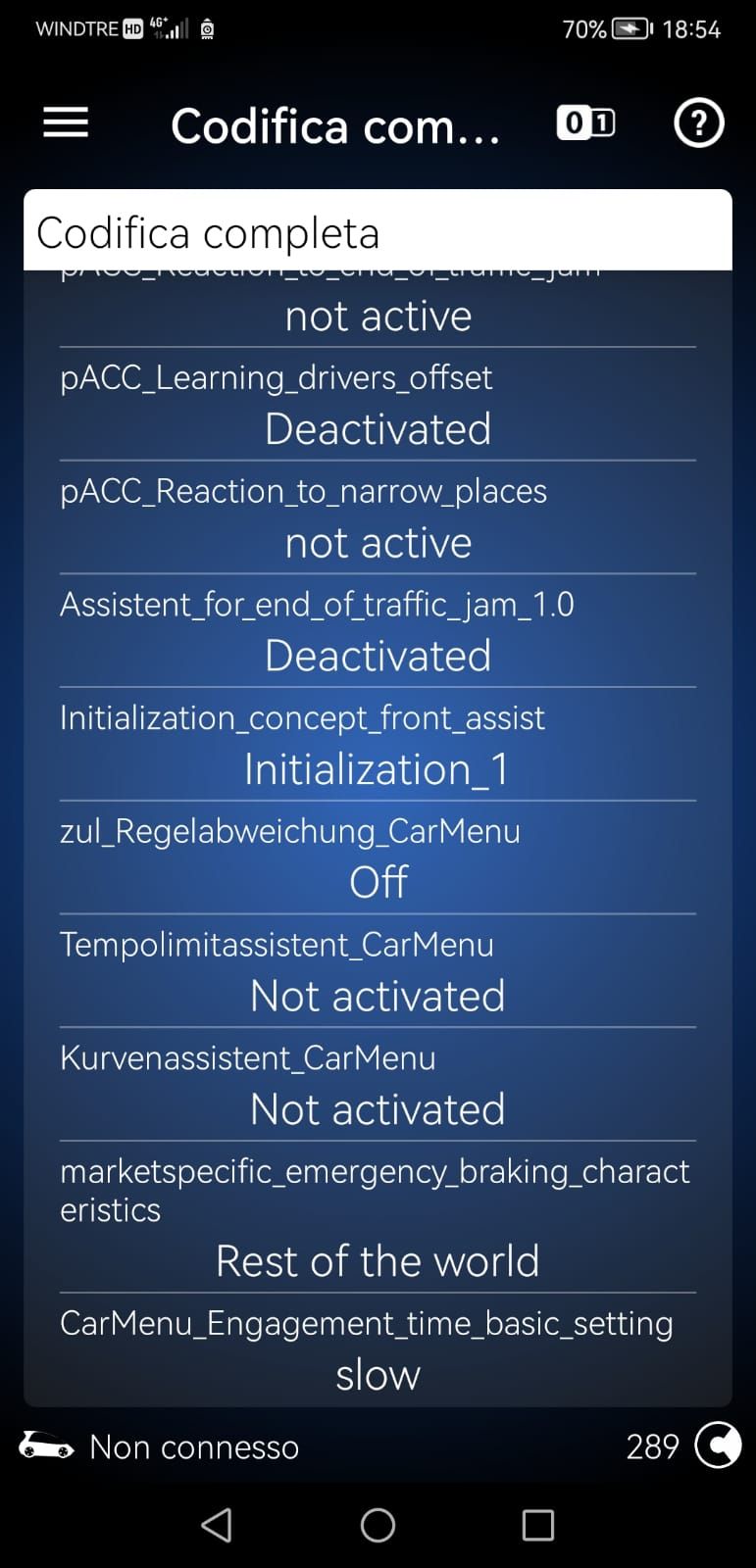

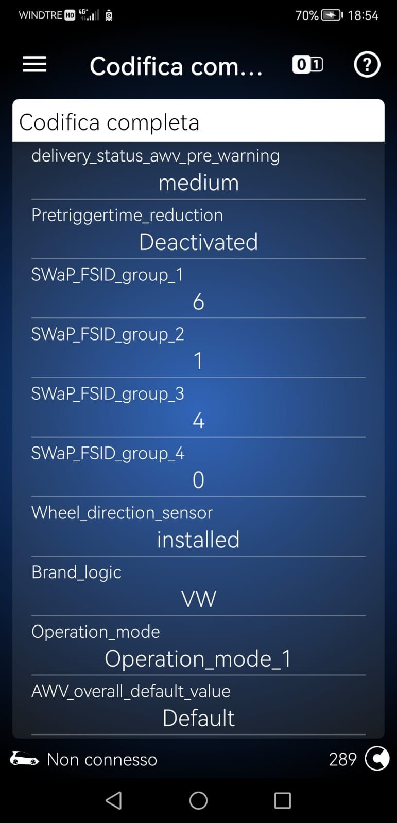

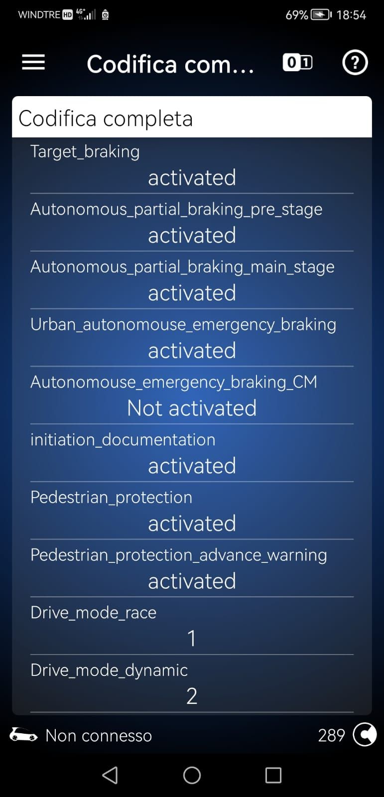

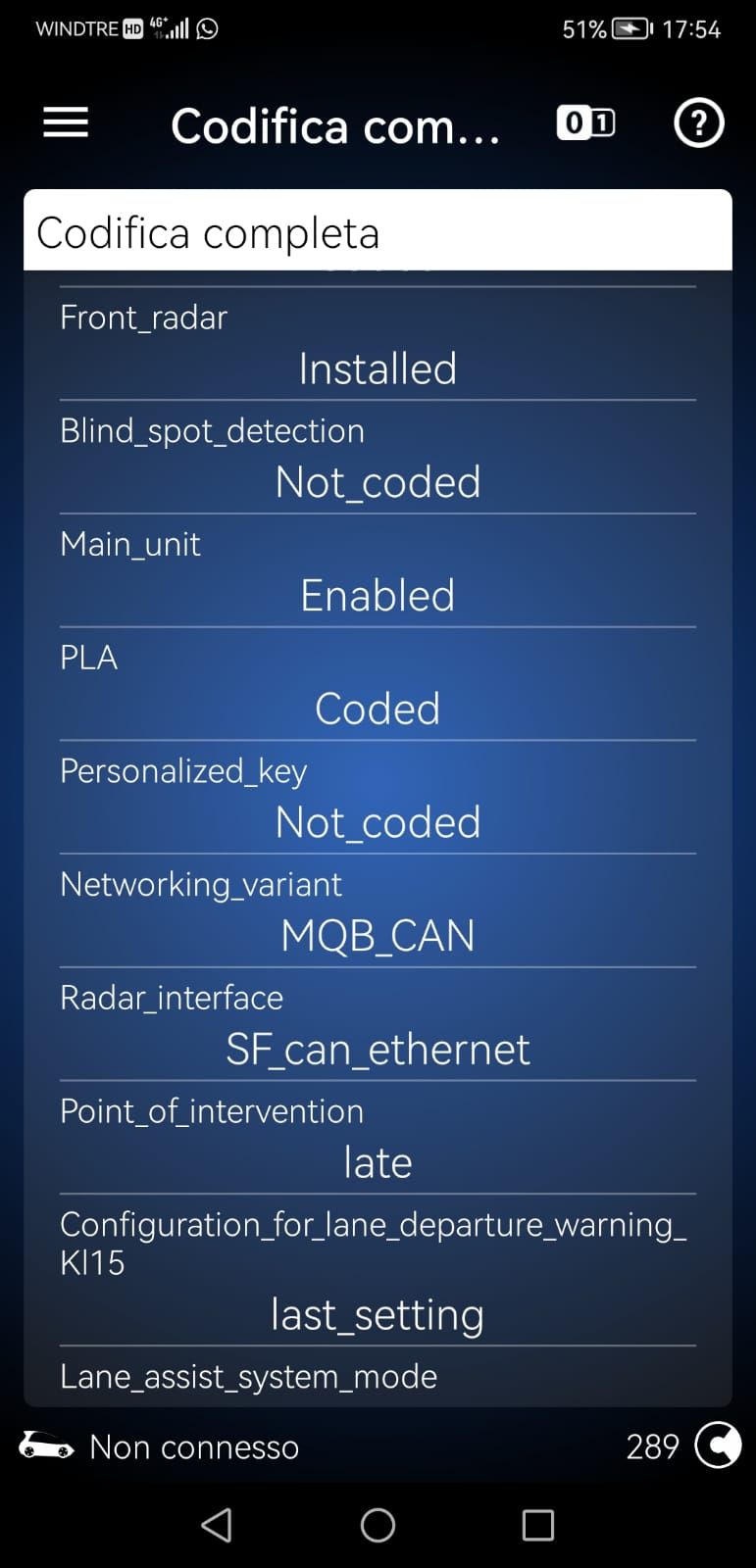

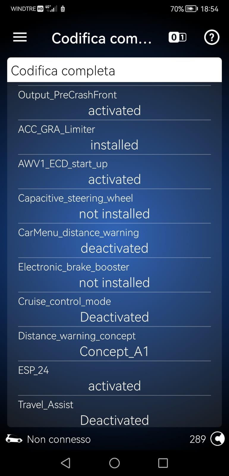

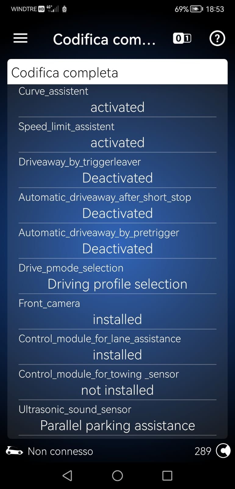

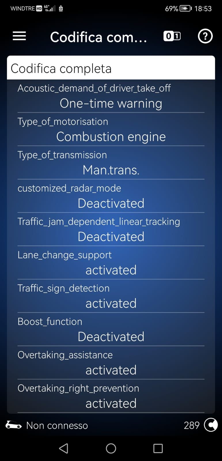

Hi all, I'm wondering if it's possible and some of you have already done this coding
My Ateca is a FR 2.0 TDI 150 HP year 2022
thank you
Control unit: A5 Driver Assistance
System description: MQB MFK 3.0
Software number: 2Q0980653D
Software version: 1401
Hardware number: 2Q0980653
Hardware Version: H16
these are the values in mine in A5 in attacchment

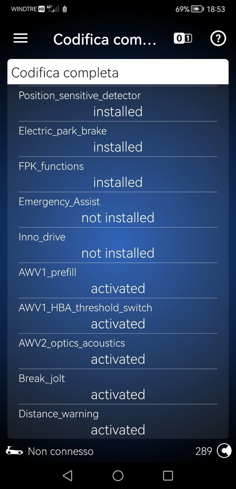

and this in central 13
Backups
Control unit: 13 Adaptive Cruise Control
System Description: ACCCONTIMQB
Software number: 2Q0907572AA
Software version: 0396
Hardware number: 2Q0907572D
Hardware Version: H09
