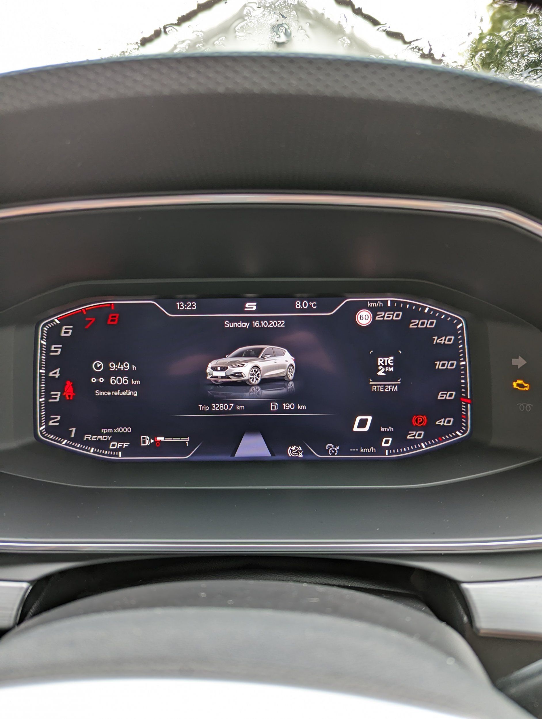

Hi guys,

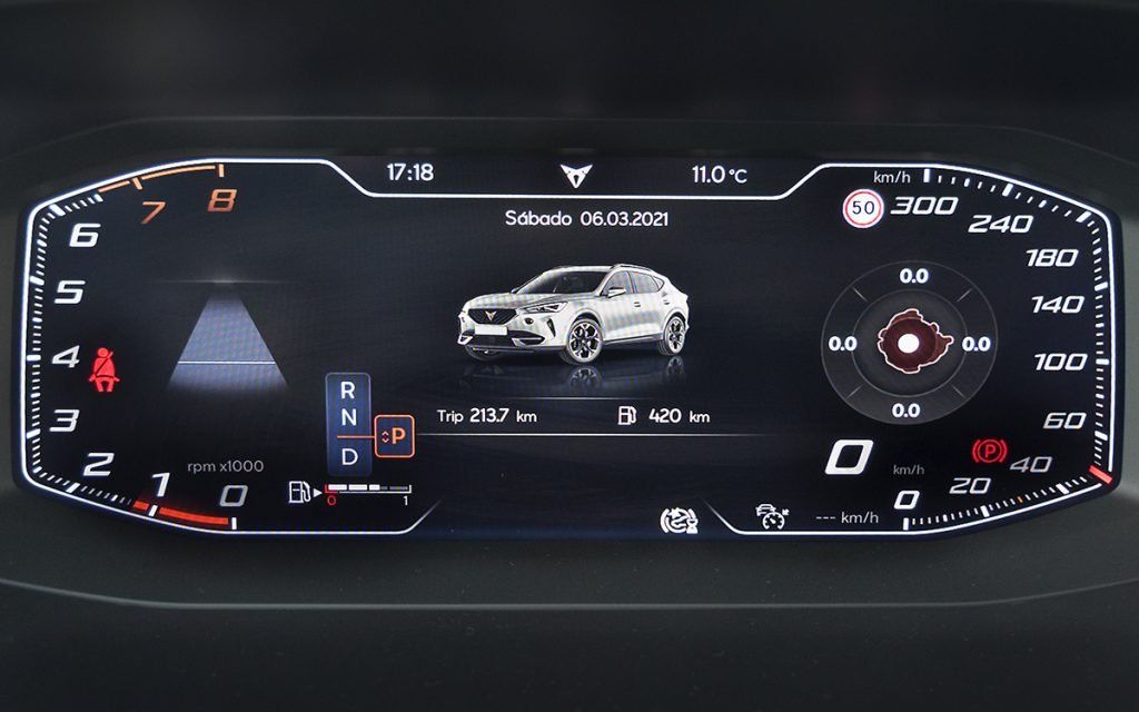

How do you activate this view for the Virtual Cockpit?
I have activated the Cupra view but can't find this one.
It is the Formentor view.
Thank you.
Tell
Full Member
Yes, it is a default view on Formentor.
I want to activate this view on Seat Leon Sportstourer FR.
If it's anything like mib2 there is a set of images that can be deployed across the range so you can make your car look like another model. Question of hitting on the configuration. I changed mine into a Cupra Ateca from a standard Ateca as part of a mib2 standard v mib2 high conversation on missing images.

So the thread talks about the model images and then I got @BoyRacer to give me their VCDS dump so compared with the Obdeleven. Might need a bit of hex arithmetic to parse the long string. 10 was the key code for the Cupra brand of the Ateca.
So I suspect the Leon 4 infotainment unit has a load of preloaded images in it some for other models and may be the Formentor in it's mib3. Just needs looking at to check... whether its there is another thing. Might be dependent on the exact mib3 model and firmware.

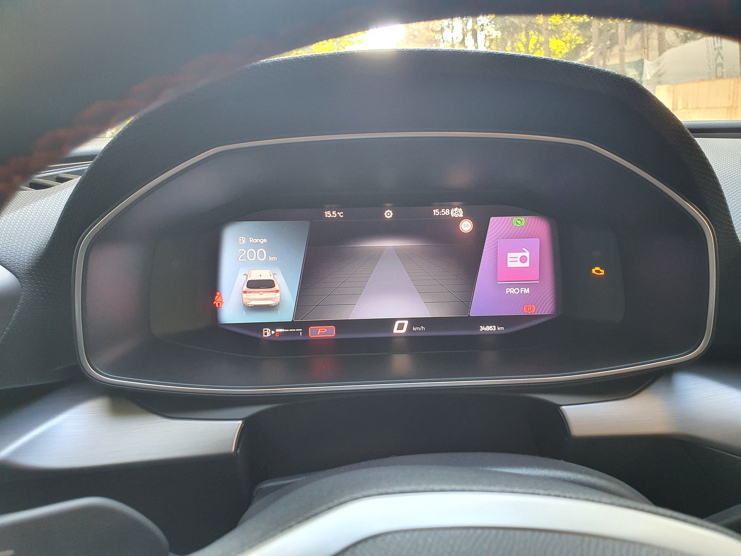

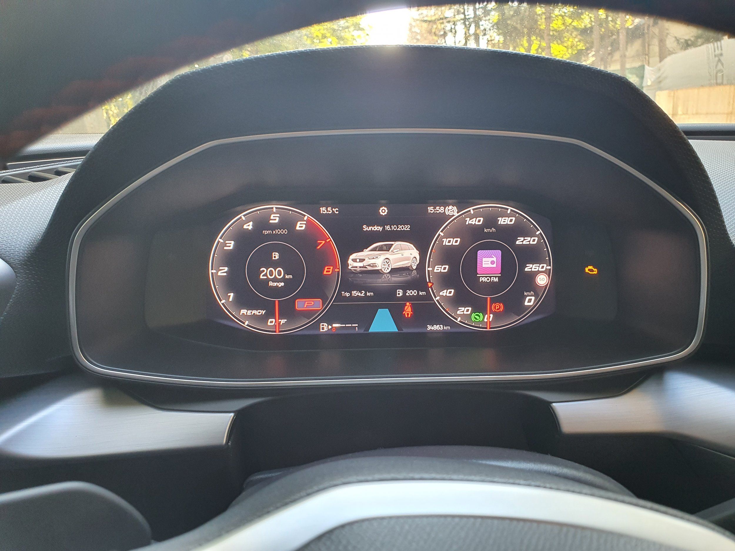

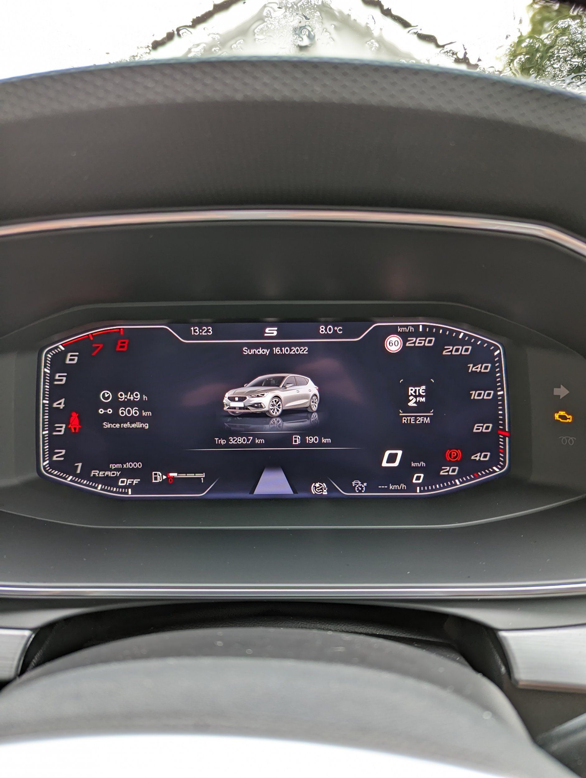

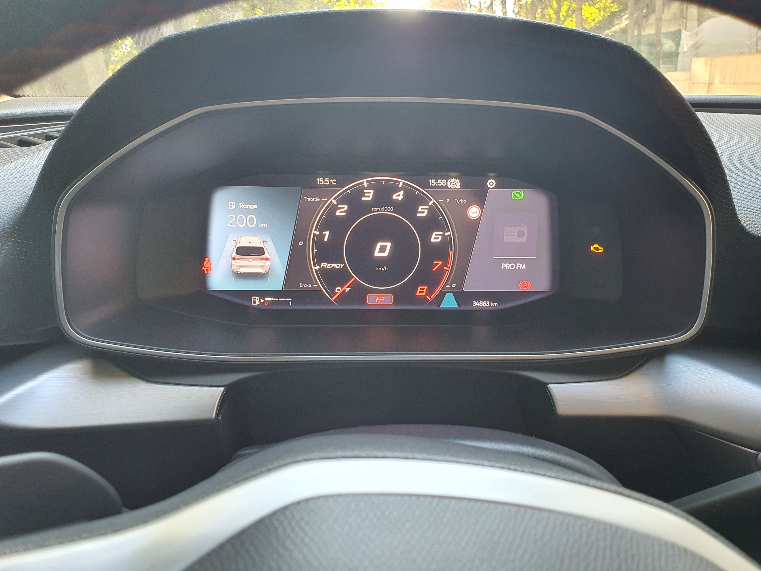

I mean, other than the picture of the Formentor, it's a default view on the Leon too. I'll take a picture of mine later
I have the first edition of Leon FR, i don't have this view.
I have activated all the cupra views following the instructions on this forum but this view is missing...

I have all the updates done at the dealer, i have the 1896, i don't understand why it can't be activated... Even the older Ateca/Tarraco have this view...
