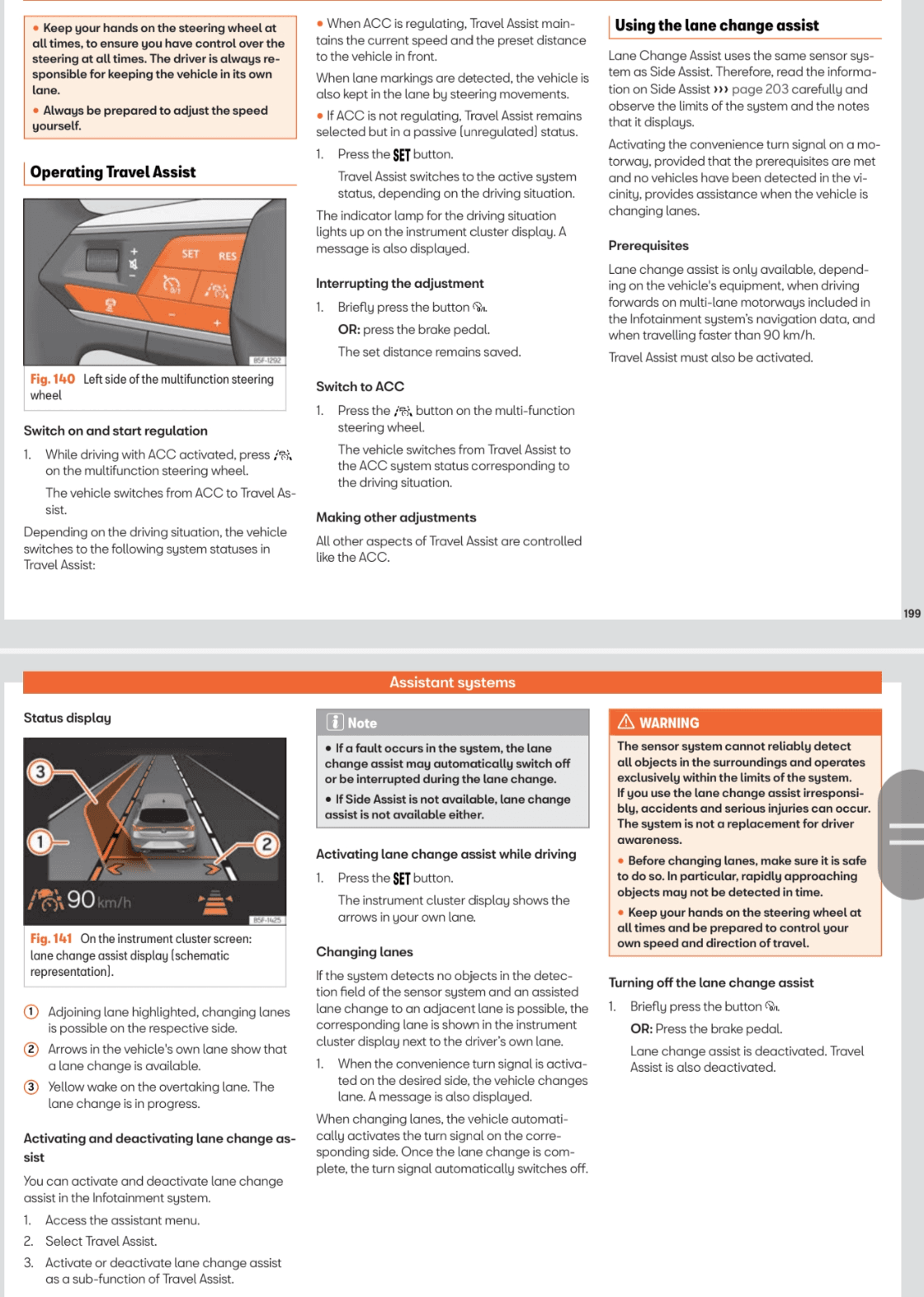

Seems like in the new car manual, there is an option for lane changing. You have to select it in the car travel assist menu for it to work, but i don't seem to have this option. Does anyone have it?

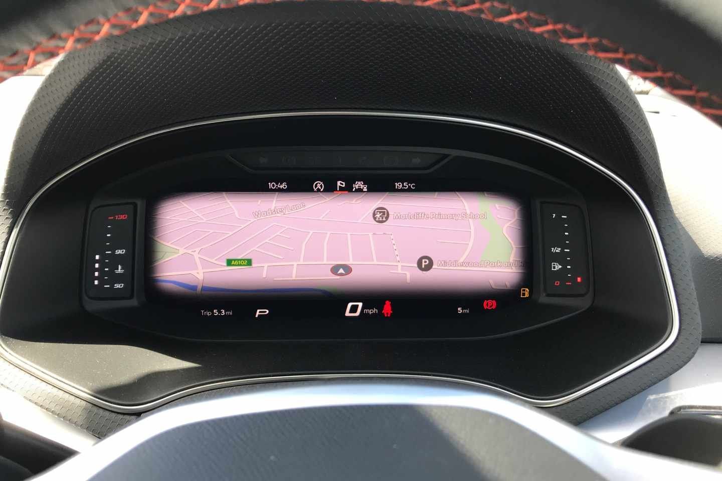

I've recently been driving an Arona as courtesy car and I've noticed that you can make the map show up on the entire digital cockpit display. Is this something that you can do on the Leon too? Attached picture as example.
Thanks in advance!

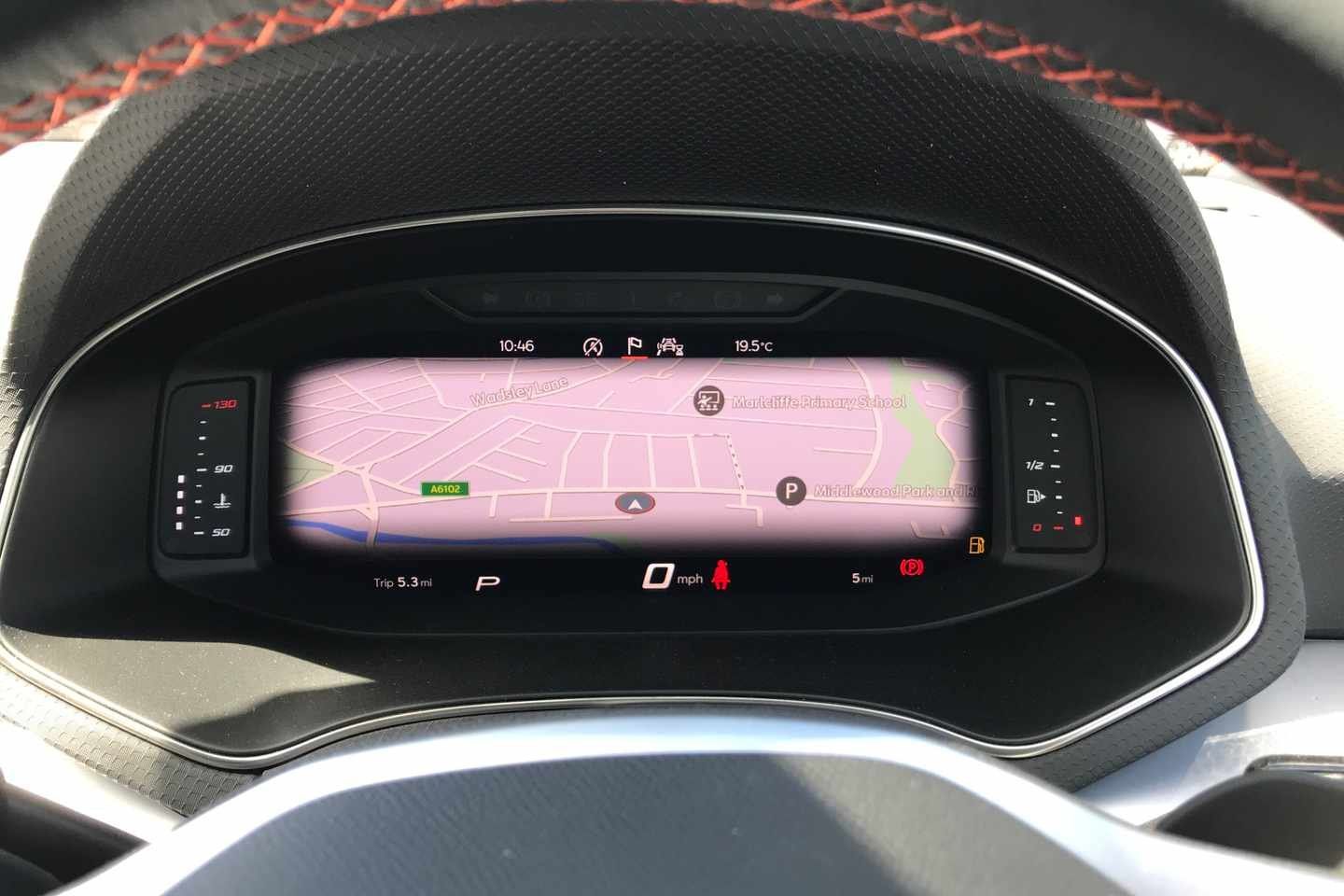

Thanks in advance!View attachment 33723

Yes, also on the Leon.
Reactions: verde
Press and HOLD the view button in the second view option (after the one with circular displays) and it will display full size map.
Reactions: verde

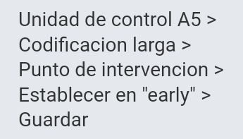

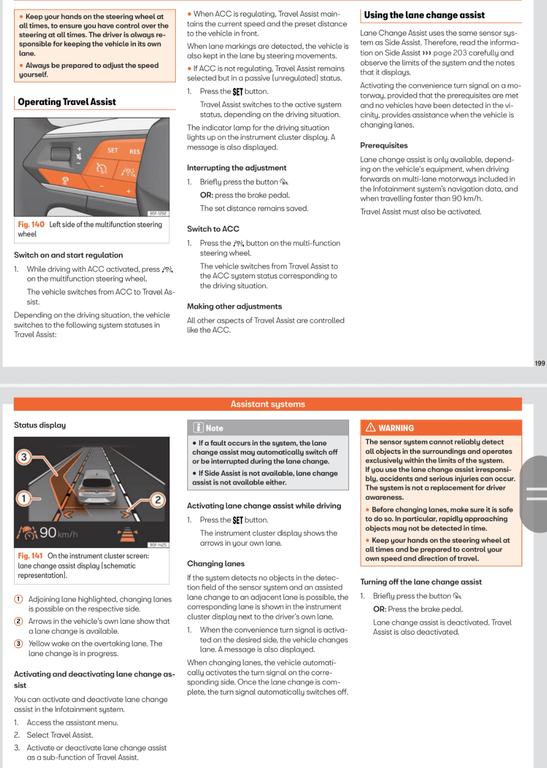

Hello, exactly what is the difference of putting early instead of late as it comes as standard? I don't understand what Lane Assist looks like Travel Assist (removing the message every two times three to take the steering wheel for example on straights that doesn't move much, it goes from 10), why is this encoding done?? Thank you very much. All the best.
