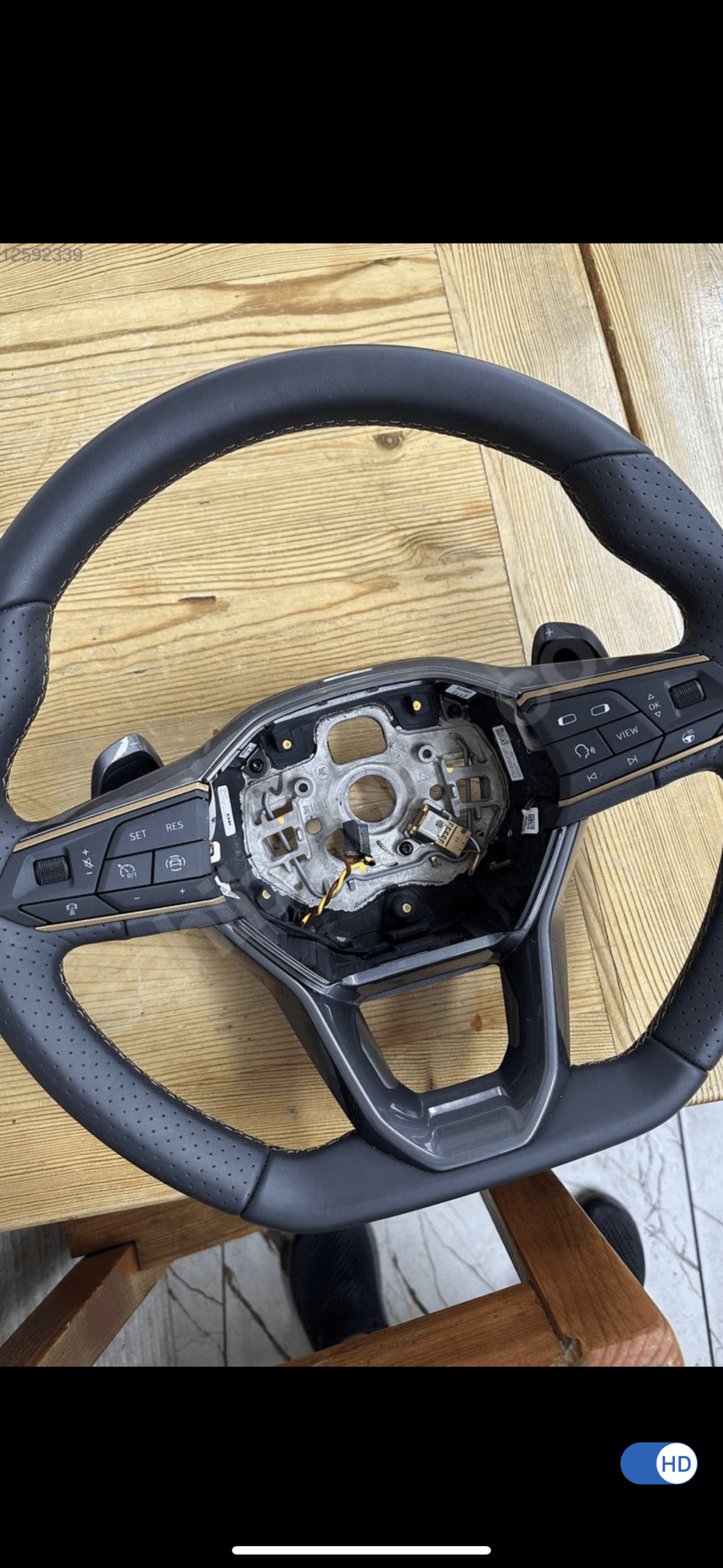

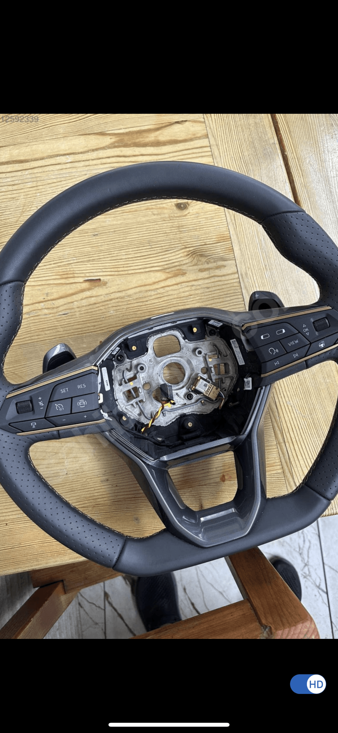

Is it able to retrofit this Cupra steering wheel for ACC on my Leon FR. I wanted to retrofit capacitive FR steering wheel but its twice as expensive than this Cupra steering wheel in my counrty do you guys any idea? Mine Leon FR only have Lane Assist, dont have blind spot and acc so travel assist I dont know which package of driving assist.View attachment 38182
Hello. That steering wheel is not capacitive friend.
So then when I buy the capacitive one will ACC and Lane Assist work? I don’t have Blind Spot Assist and it is too expensive to retrofit in my country due to exchanges. I only wanted to ACC and Lane Assist works together and shows on the screen the other vehicles in my front(not behind couse of blind spot) and maybe next time I will buy the module for Unlimited Drive

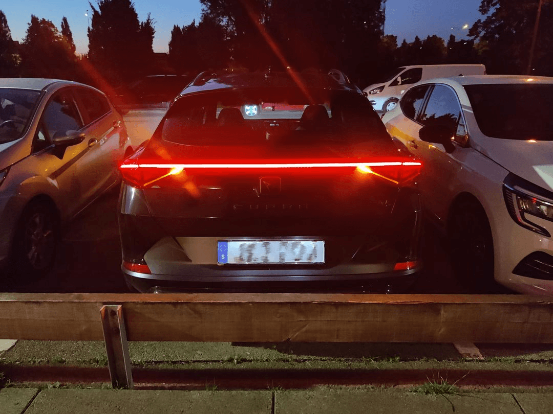

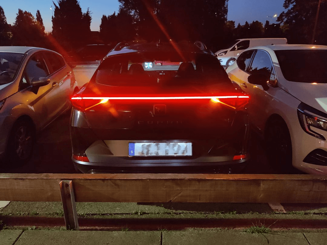

Hi Guys,
do you know if there is a chance to turn off the lower red LED lights? I would like to modify the lights so that only the upper part lights up red.
Something like you can see in the photo

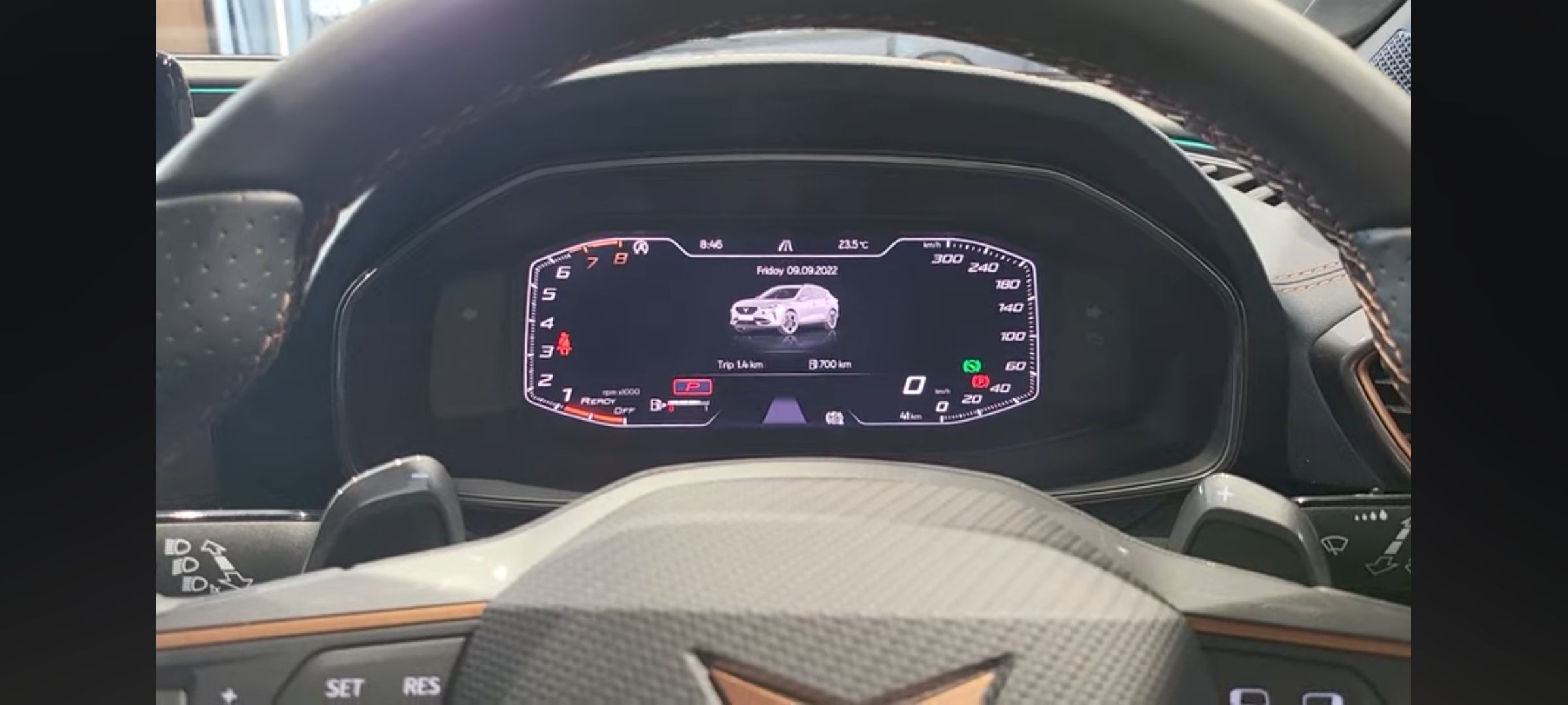

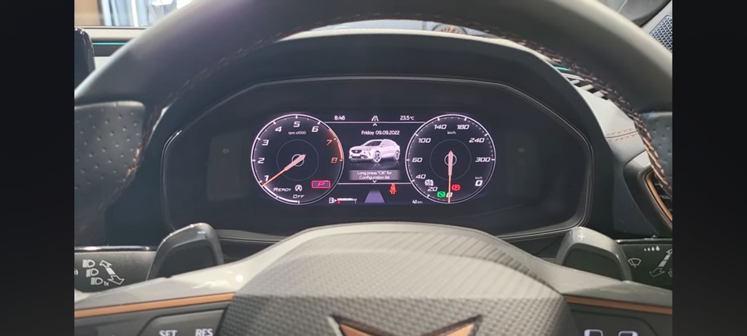

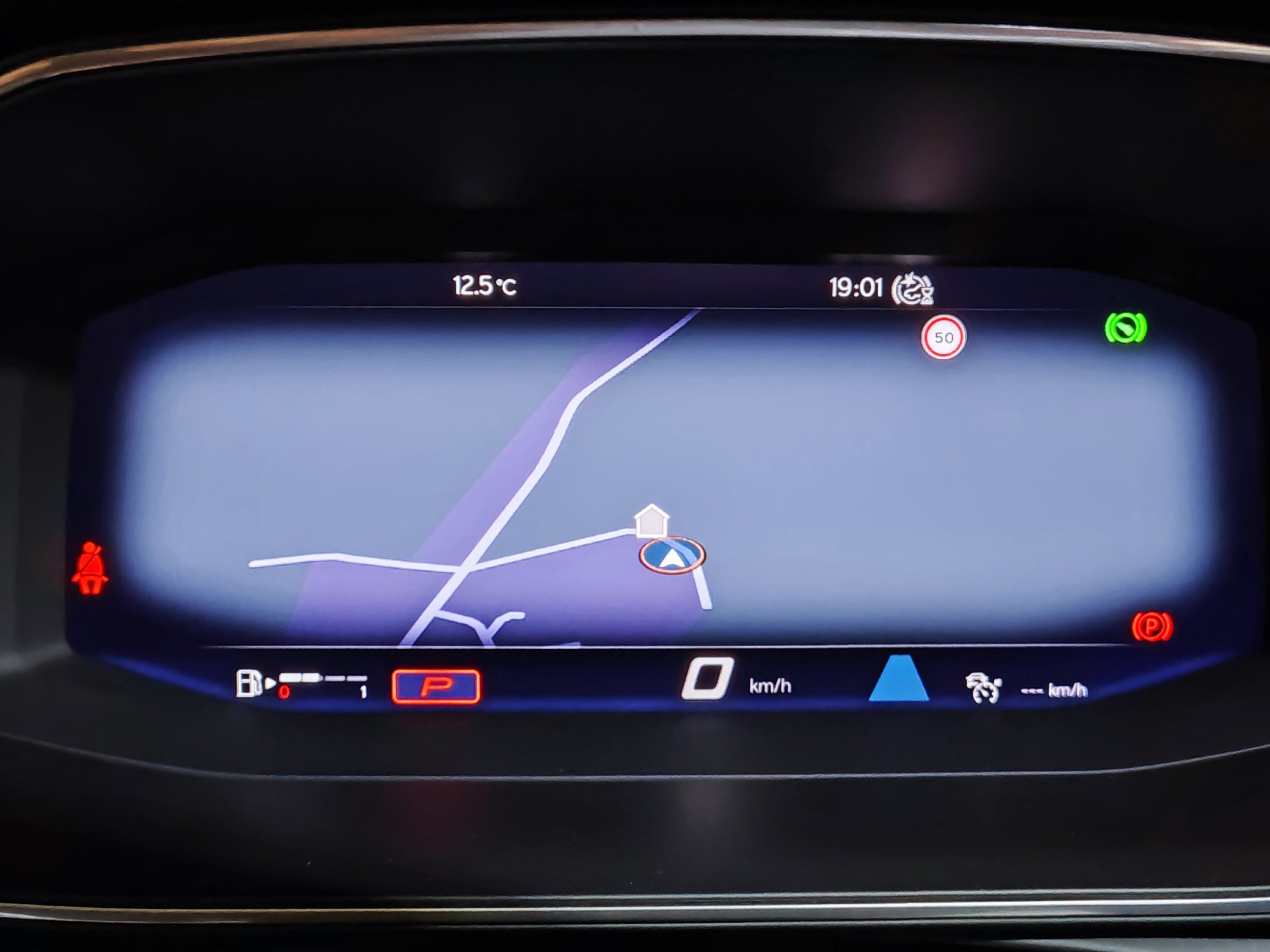

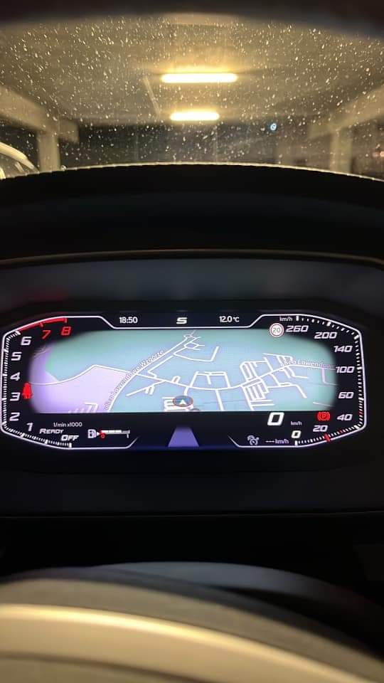

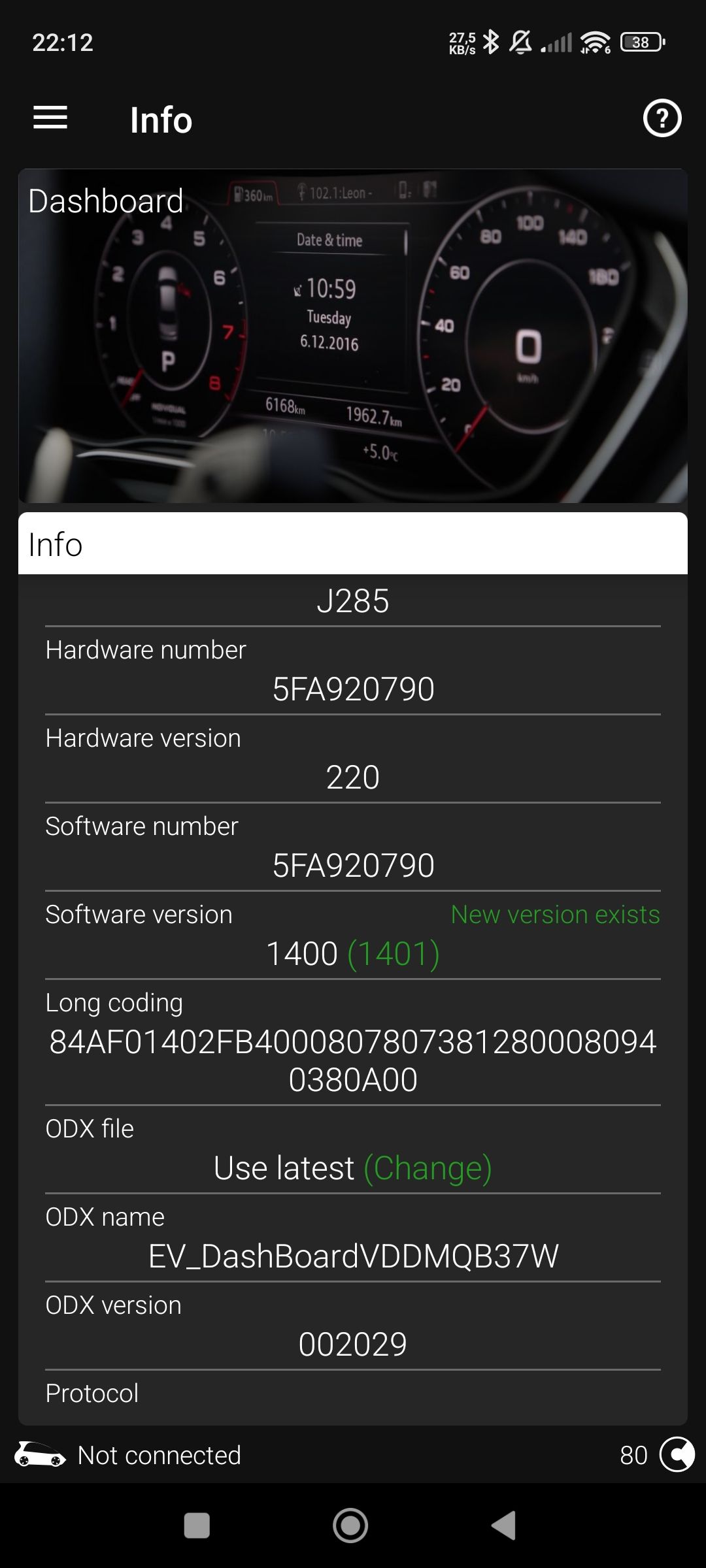

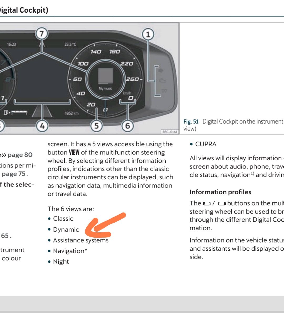

Hi. I see that many people have this view with clocks outside the screen. I only have round ones. I would like to have such a view too. is it possible to code it? I have OBD11 and I have no problem with operation. I already installed the Hitch trailer and DAB antenna myself. I also have an active Cupra VIEW etc. I only miss this view on seconda and last photo. I have 5FA920790 cluster. I saw 5FA920790A for sale.
On the view with the round clocks, spin the thumb wheel in the steering wheel so the image of the car is in the middle. Then hold down the thumb wheel until a new menu pops up. From there select view and choose your views that you want active.

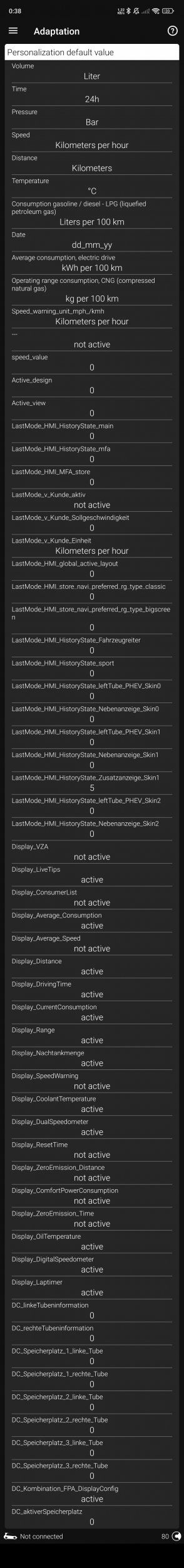

I don't have. First is show service, second is clear oil service, third is show engine code, four is set clock, fifth is copyright, sixth is info audio and close. Could you see what you have in adaptations in these places? maybe I changed something too much
EDIT: Okay, I know everything now. In adaptations in active views I have the same thing as you have in the service menu. I don't know why I don't. I turned off all active displays and it agrees with the cupra instructions. View 1 is the round clocks, view 2 is the one I don't have even though it is attached. View 3 is driving assistants, view 4 is GPS, view 5 is night view which I don't have either, view 6 is cupra view. There is no more. I don't know why my clocks don't have this. Just like I don't have a G-meter (it is included in the coding) and the power only shows in the view from Leon 3 (car version 4). The car is in the beginning of production on August 2020. It's not worth spending money on one view. In Poland it costs about 500 euros.

It's either somethingthat's been coded or it's not available in your country then - it's a standard menu (at least in most places).
my car comes from Denmark. I only changed the country and language to Polish. could it be that this view is not available in Denmark? Here in Poland, people have this view and this menu. neither was wireless AA, but it was very easy to do. I will try to convert the region back to Denmark. I'll see what happens. and maybe I will try to change the brand from Seat to Cupra.
