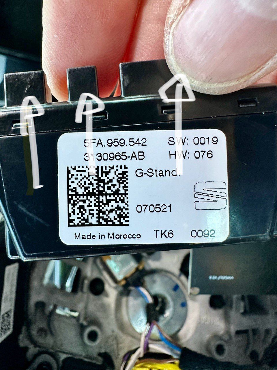

@simoammi Thank you very much. I installed the steering wheel number 5FA419091EL (I have Leon Xcelence), I did the coding according to your instructions and everything works. Cost 100euro 😁

- Disconnect battery iff you want or keep igniton off.
- Release the airbag
- Disonnect the airbag
- Replace the TKL module
- Put airbag back
- Reconventie Battery iff you did so
- Drive
Hi Antera! thank you for your explanation, the original module has 3 cables and in the photo it replaces only one. Is it still OK? Is it left original for the two missing ones?

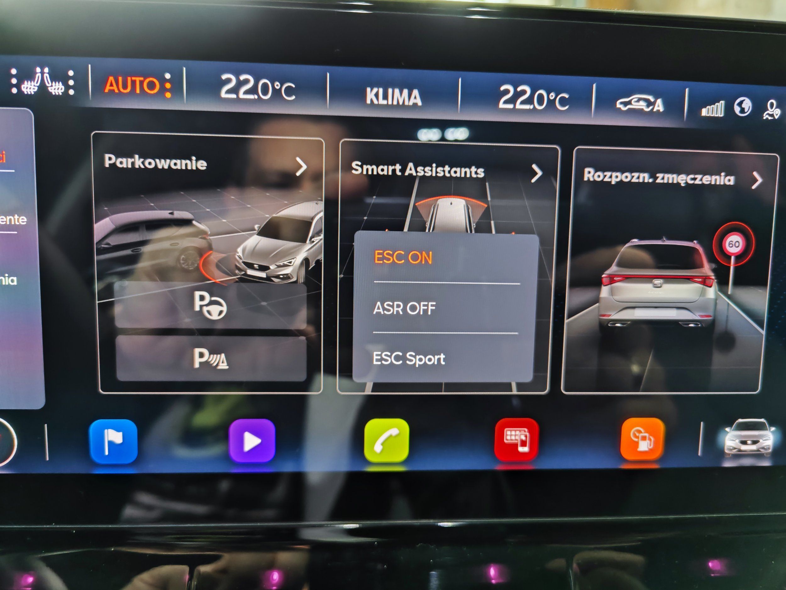

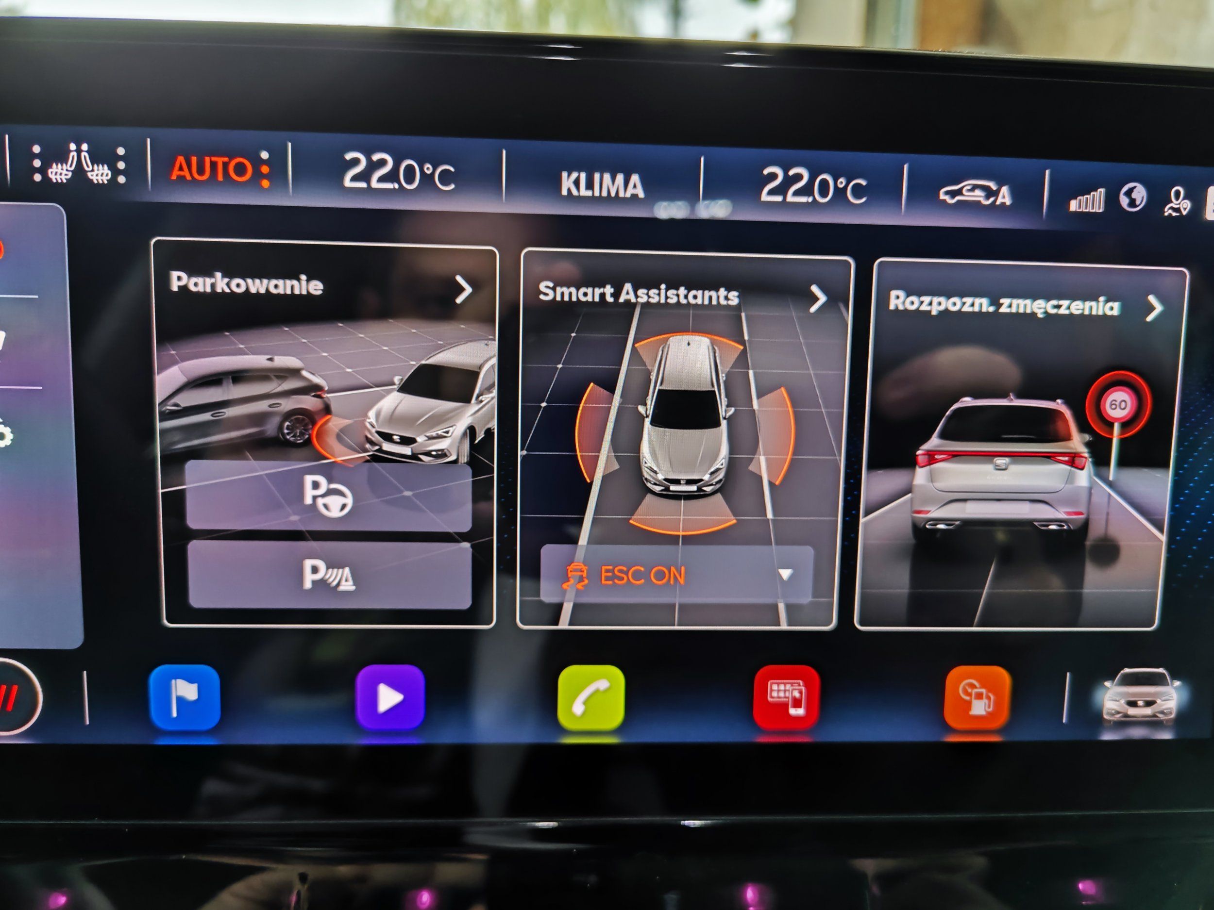

Hello ! Is it possible with obd11 to have this menu for Esc and Tcs ?
Yes !
the coding is this:
control unit 03 brakes ,
long coding you move to the bytes, drawing 0101010101
you go to the bottom moving all the way to the right, count 6 going back to the left and you find an entry starting with A, mine was A2
Remove bit 01 and put in bit 02 - the entry becomes A4 .
Scroll to activate.
finished

Yes !
the coding is this:
Scroll to activate.
finished
Thanks again.

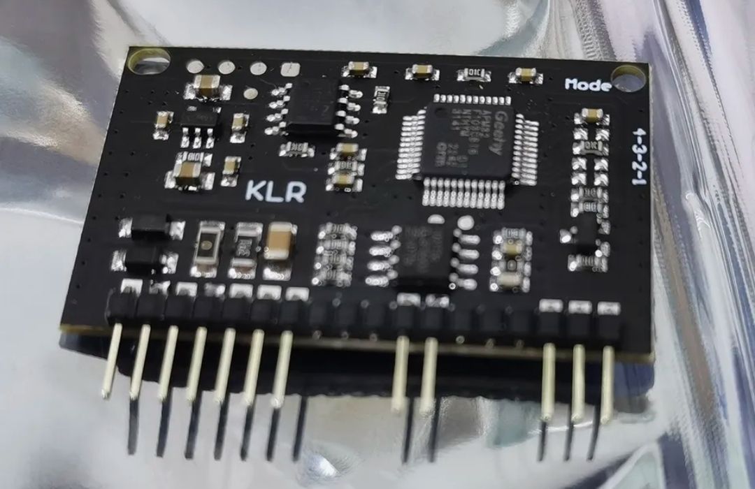

P.S. I ordered a KLR module for myself that has outputs for all three plugs.

I see you managed to encode, great!
I bought this, but it didn't work and I returned it... the seller told me it was right for my car...
The steering wheel worked normally but it told me to keep my hands on the wheel
I took this exact one from the auction you provided. so the one from this auction with an output of 3 didn't work for you and you bought another one now or Is the one from the auction you are giving is correct ? someone wrote in the comments that it works with Seat Leon. It hasn't sent yet and I have a chance to cancel it.
the seller says it is correct for my car, but it didn't work. i fitted the capacitive steering wheel after purchase, it was from an ateca, so maybe the decoder is different
ok now I understand. I have the Excellence and I also bought the Excelence version, only with the TA button. In that case, I'll wait for the shipment and let you know if it works.
Its the same steering wheel. No Difference. De module works perfect without any issue for a while now
This one i hace:

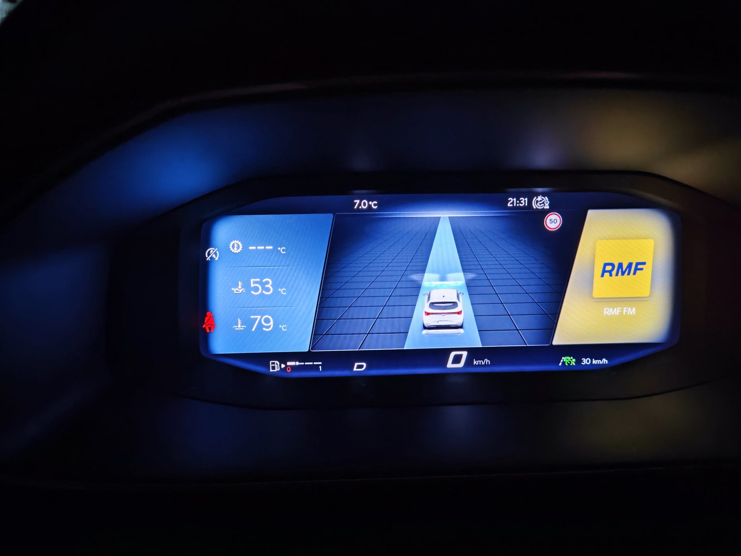

Hi Everyone,
I have been having a play with OBDeleven with my car (FR First Edition) and have managed to code some things and thought Id share what I have found and create a thread where people can share there findings for us all.
I have managed to code:
Cupra Display
Lane Assist Point Of Intervention (Have yet to test, but should keep the car more central rather then let it almost drift out of lane before kicking in)
Lane Assist Set To Last Setting
Lane Assist Warnings Turned Off
I know a lot of people find lane assist is already to sensitive (its already set to lowest from factory), so I might have found a solution to this too. So you can turn it off and it will remember this setting each time the car is turned on etc, so now you can make it sensitive for the motorway and only turn it on when you want it.
Cupra Display:
Module 17 (Dashboard) -> Long Coding -> View Activation -> Set All 16 Views to active -> Write To Car
Lane Assist Point Of Intervention:
Module A5 (Driver Assistance) -> Long Coding -> Point Of Intervention -> Set To Early -> Write To Car
Lane Assist Warnings:
Module A5 (Driver Assistance) -> Long Coding -> Lane Assist Off Text -> Set To Disabled -> Write To Car
Lane Assist Settings:
Module A5 (Driver Assistance) -> Long Coding -> Configuration For Lane Departure Warning K15 -> Set To Last Setting -> Write To Car
Let me know what you guys find :D
