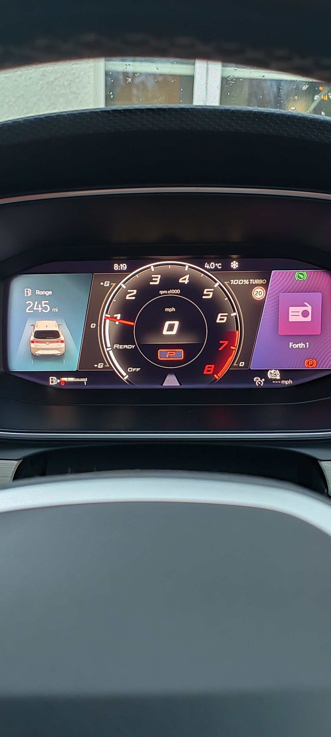

I have tried cupra view but no luck, I have active view 7 and 8
I have tried cupra view with vcds activated view 7 and 8 but no change
Is there any security access code?
i think you have to activate it in dashboard it self. In classic view(circular) you have to press and hold ok button while it shows the car in the middle otherwise scroll up or down to show the car then press and hold ok button, then you see active views(sth like that i don't remember) and you will see cupra.
Reactions: Leon xLux st etsi
Exactly this. Also worth noting that the Cupra view's max RPM is 500 higher than the Seat version..

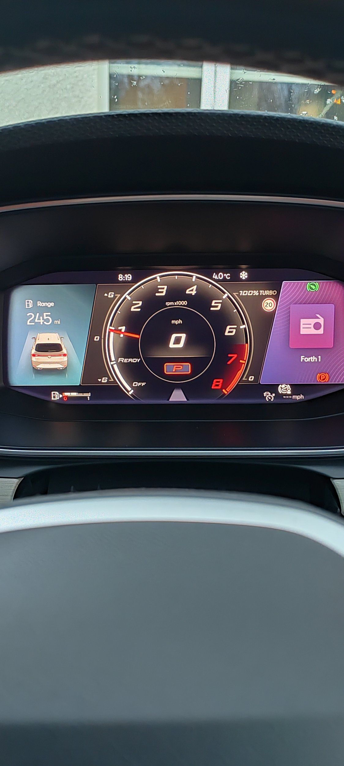

Thanks for help, amazing! It works now perfectly ??
Thanks for help, amazing! It works now perfectly ??View attachment 39387
you're welcome man. It happened to me as well and i saw a video on internet that someone entered that menu to enable it. But i can't figured that how to eneble torque and power info, other things (transmission temperature, empty volume of the fuel tank, g meter, lap timer and useless offroad angle) are enebled.

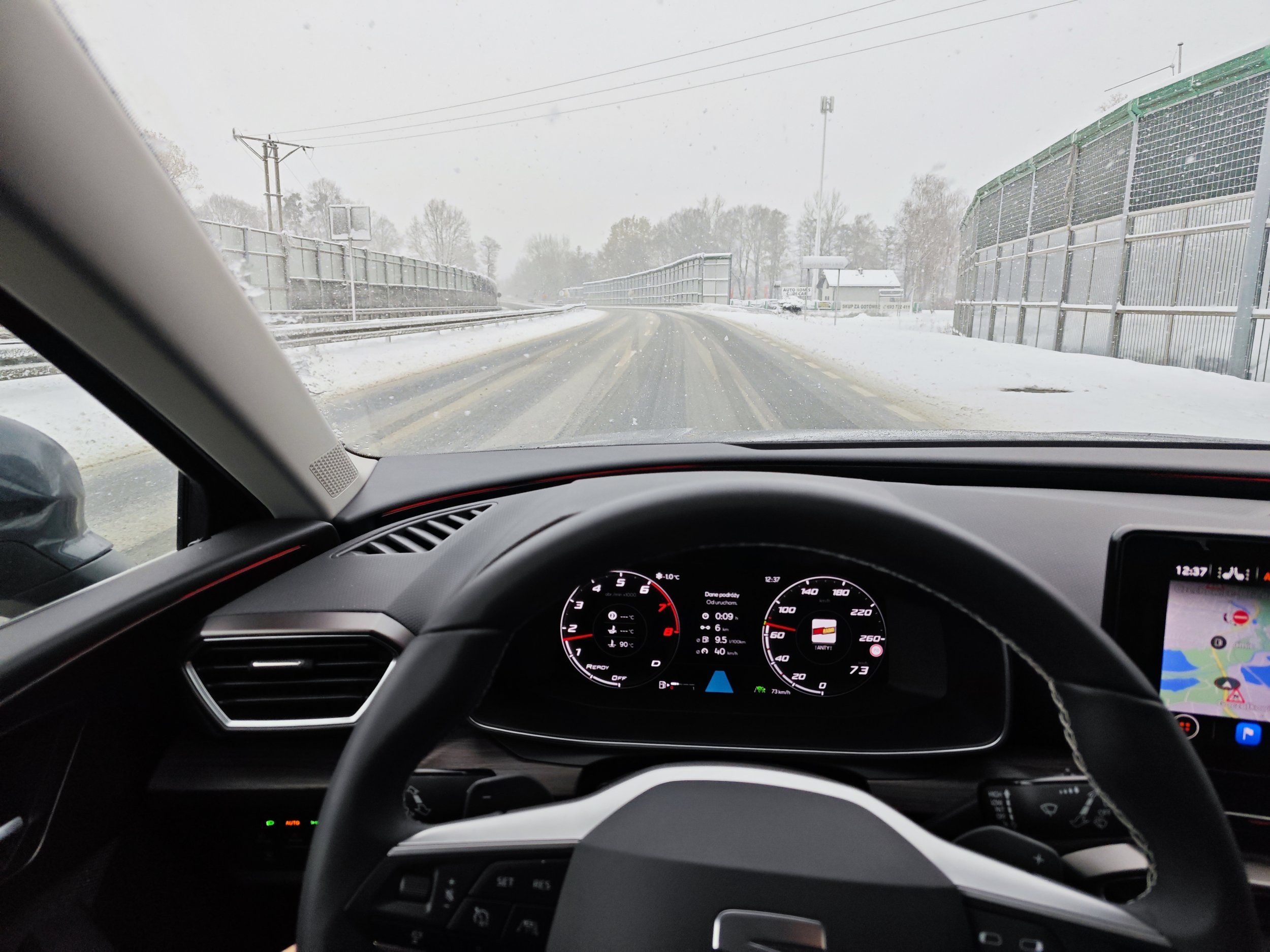

@simoammi for me this module works perfectly. Yesterday I drove 30 km without touching the steering wheel. there were 4 red traffic lights and some traffic jam. the rest of the way about 90 km/h.

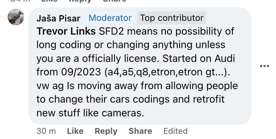

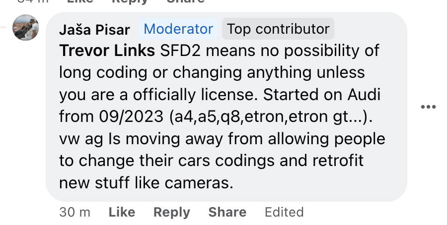

Just seen this today looks like in the Audi on the latest cars no coding is possible only a matter of time before the rest of the group are impacted.
also seen on https://www.myaudiq5.com/threads/vcds-odis-etc-and-my24-models.81382/
I guess OBD11 Saw this coming when they spent all the money and time building the SFD Interface, I wonder if Ross Tech will carry on with development now
They only introduced SFD (or as Google correct says STD?) to earn money so it appears from coding device companies and punters by costs passed on. Imagine with SFD2 it's another income stream for Vag. Wouldn't get too excite, just know you got to cough up more.
Don't get excited about this stuff as i have an old car that is fully open but just sharing that once again things are changing.
I suspect what this actually means is that you will only be able to code using Licensed products (so VCDS are currently going through that process) and obviously Voltas, As you say they will pass on the charges which are not cheap and you wont be able to buy tokens for tools like VCP but time will tell and this is all supposition on my part. .
I also saw a comment that also makes sense with the way cars are going that if you make changes to your car (not using a Licensed VAG Agent) and there is a problem then any law suite (think driver-less car world) VAG Can just say User has been playing with the setup and they signed an agreement that means its there fault. So I think there are two reasons and as VAG Are going through a restructure I expect to see more things on offer via the Shop and the ability to code it off being removed.

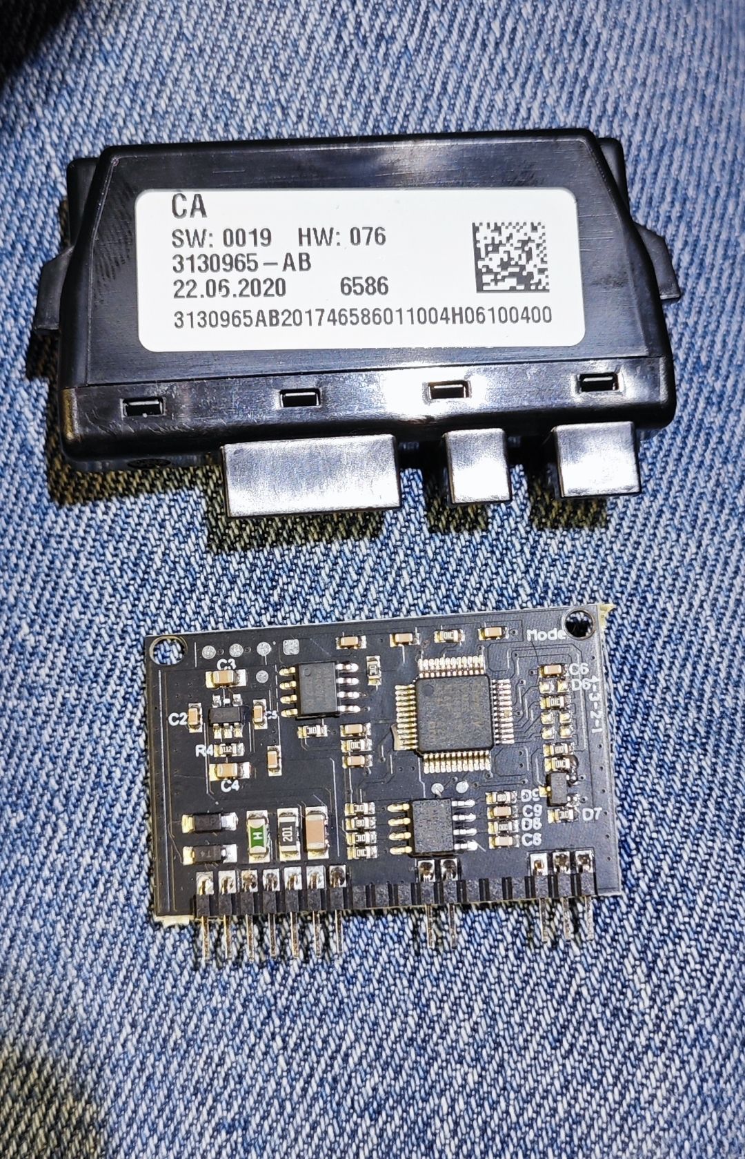

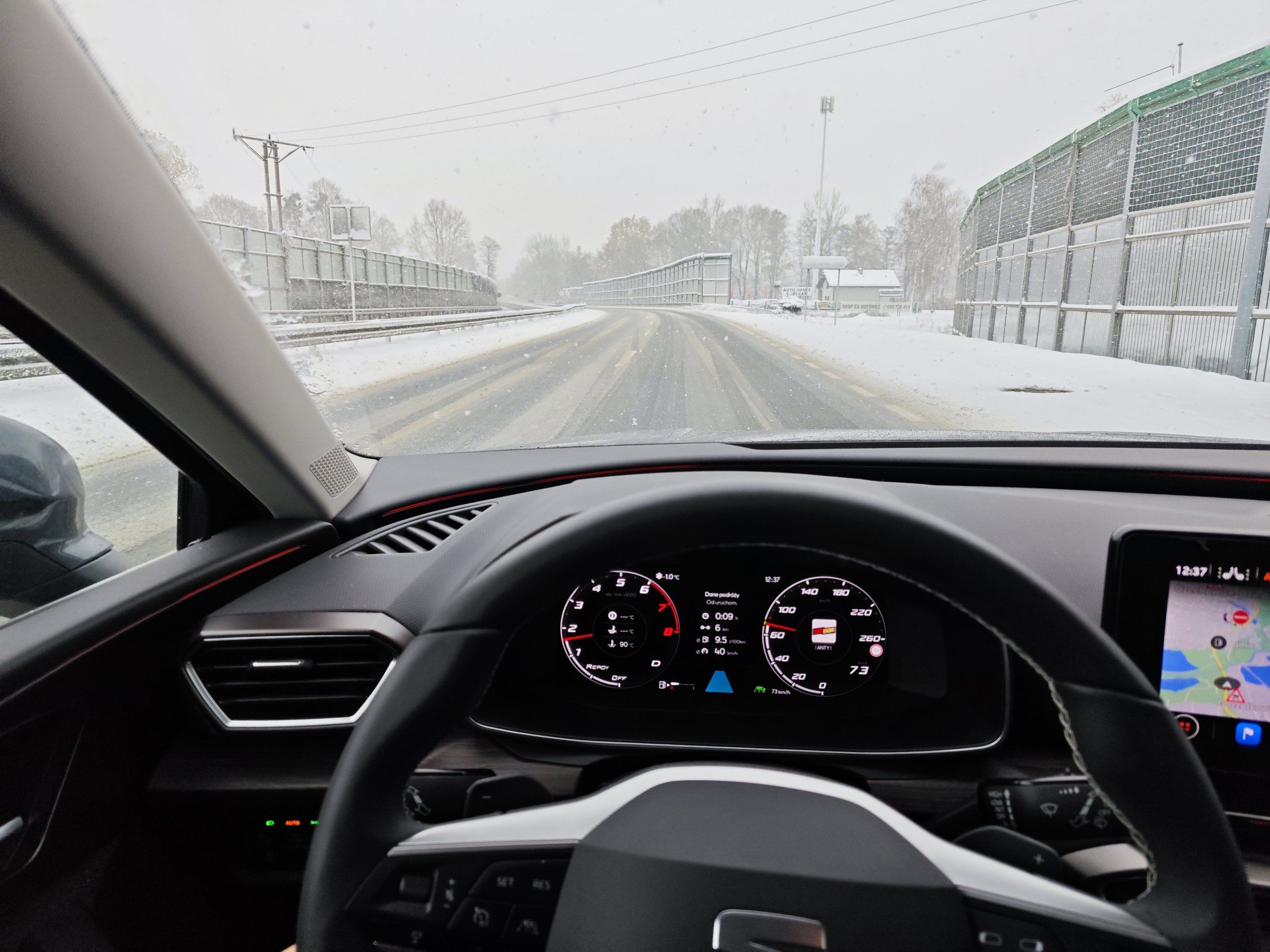

I have 1.5eTSI DSG excelence from 2020y with L package. Stering wheel retrofitted from normal ACC to capacitive. After installing the module, I drove 30 km without touching the steering wheel. is great. Unfortunately, there is a problem with roundabouts and red lights :) If it doesn't work, you can return it. on Aliexpress it takes a while but you can get your money back. I can make a video tomorrow and post it as it goes

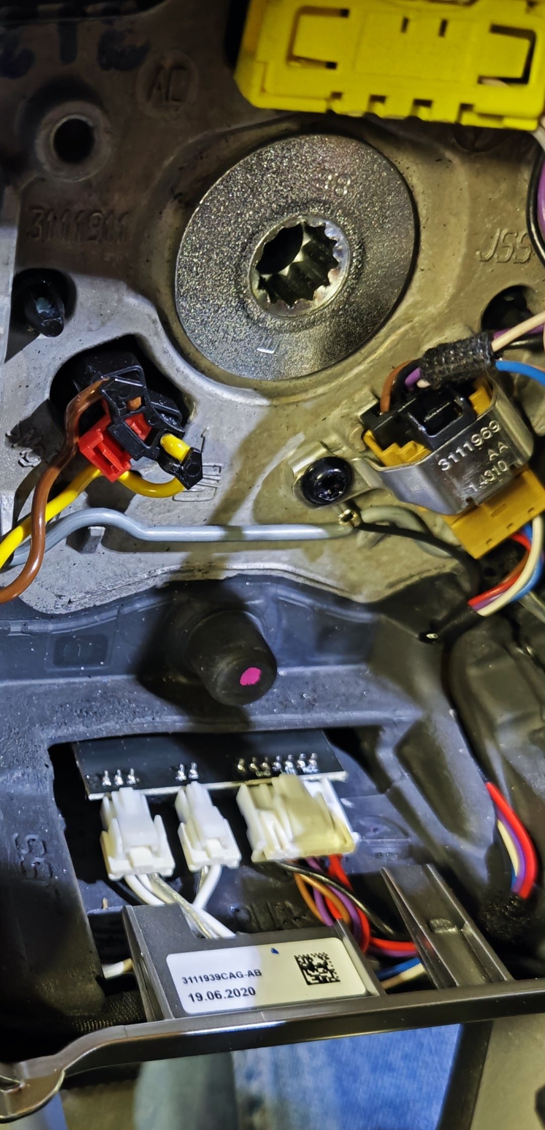

okay perfect. I'm looking forward to the video. Did you disconnect the battery with the airbag and when you plugged in the module with the 3 plugs? I have an obd 11, does anything have to be reprogrammed if you want to use it or is it really just plug and play?
Sorry for my bad english…
I use Google translate :) my English is sufficient to ask for a beer on holiday. I disconnected it when changing the steering wheel. I didn't do this when changing the module. if you have obd11, you can delete the errors. just turn off the ignition. there is no need to remove the counter frame. just hold the plastic lever up and turn the steering wheel 90 degrees. the module itself sits quite tightly. is in a rubber casing. the only thing is that when you press the airbag the horn works
@CupraRene to much snow for use TA.
