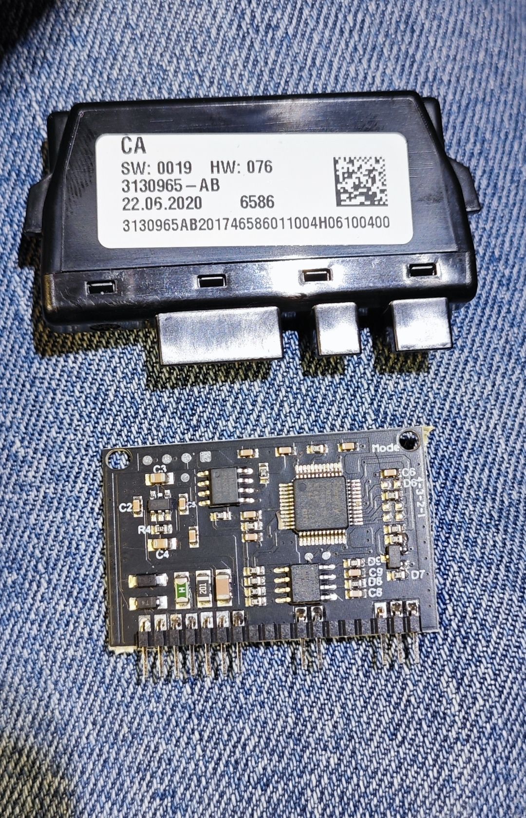

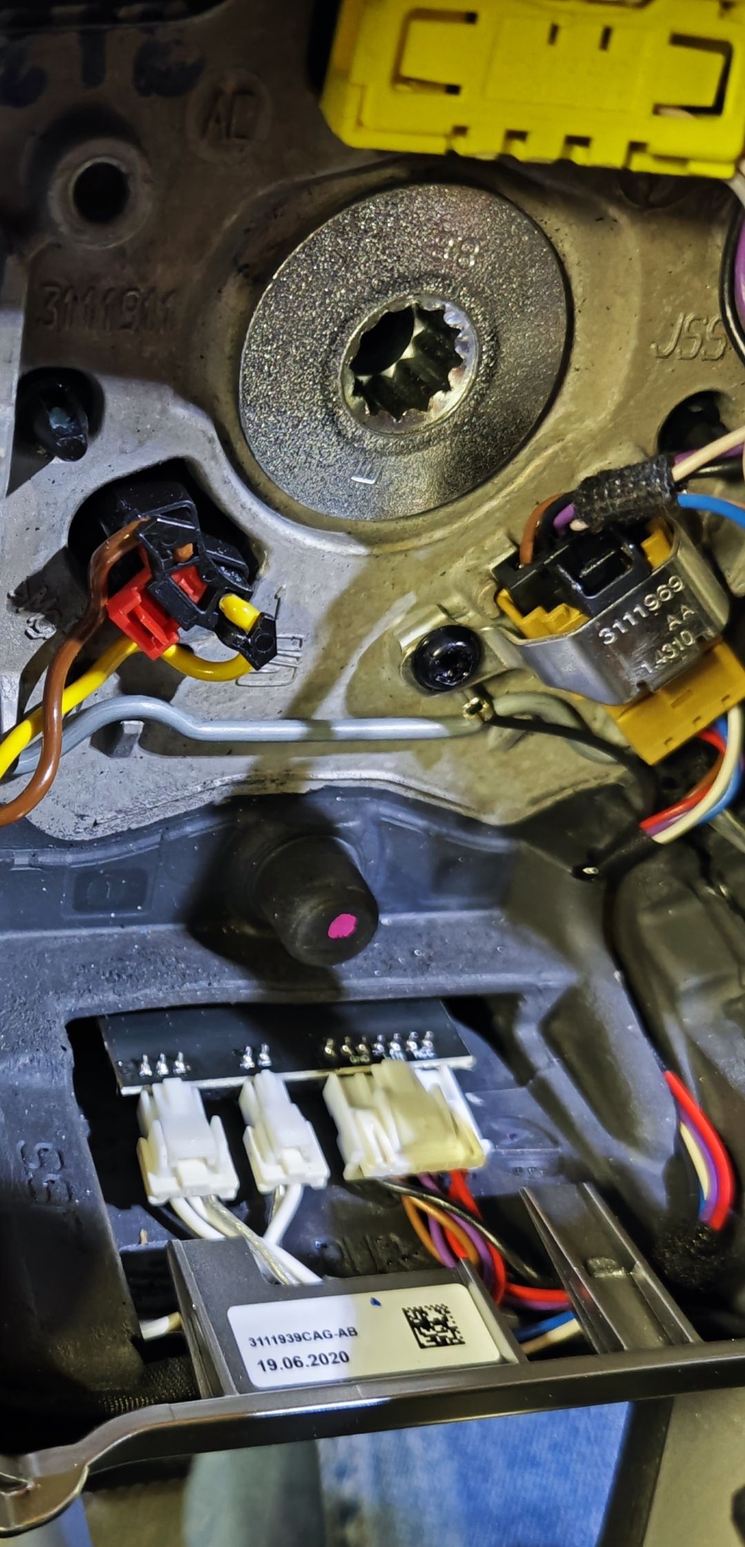

Hey,
the module arrived today. installation went well. I didn't disconnect the battery. Neither does the airbag. I simply left it plugged in and installed the module. module works perfectly. Thank you.

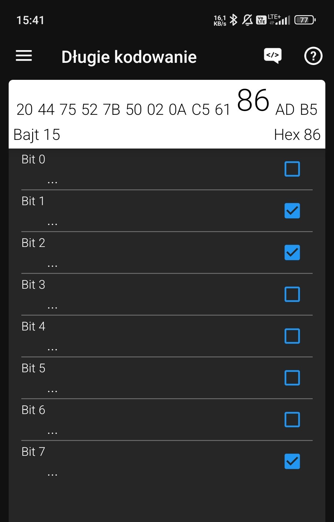

the coding is this:
control unit 03 brakes ,
long coding you move to the bytes, drawing 0101010101
you go to the bottom moving all the way to the right, count 6 going back to the left and you find an entry starting with A, mine was A2
Remove bit 01 and put in bit 02 - the entry becomes A4 .
Scroll to activate.
finished

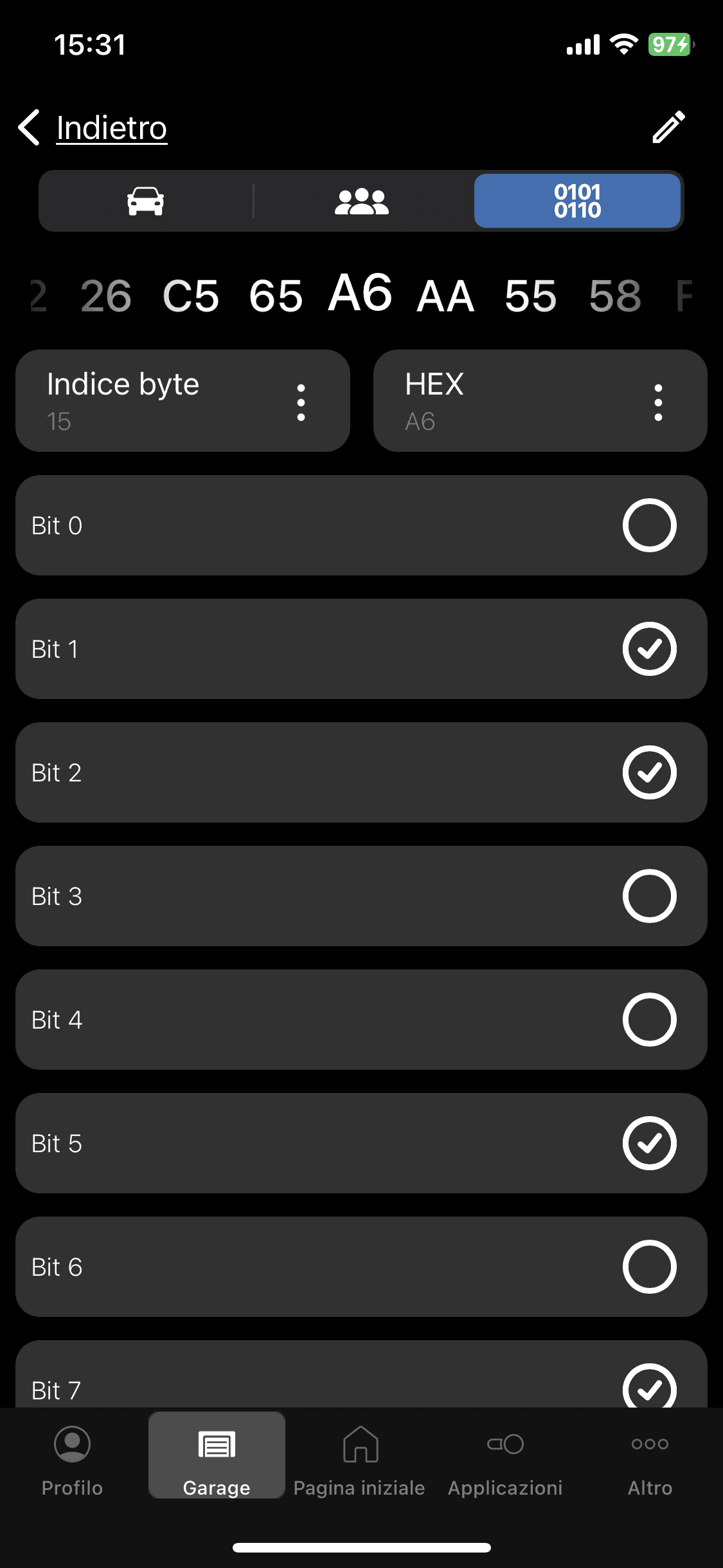

the byte with the letter “A” followed by the number is in position 15 for me; can you confirm it is byte 15?
Su quale byte devo spostarmi e quale bit devo modificare per attivare il menu TCS, ESP ecc.?
Cupra formentor
Scroll to activate.
finished
Now my A4 is on byte 26. I dont remember on which was A2 earlier.

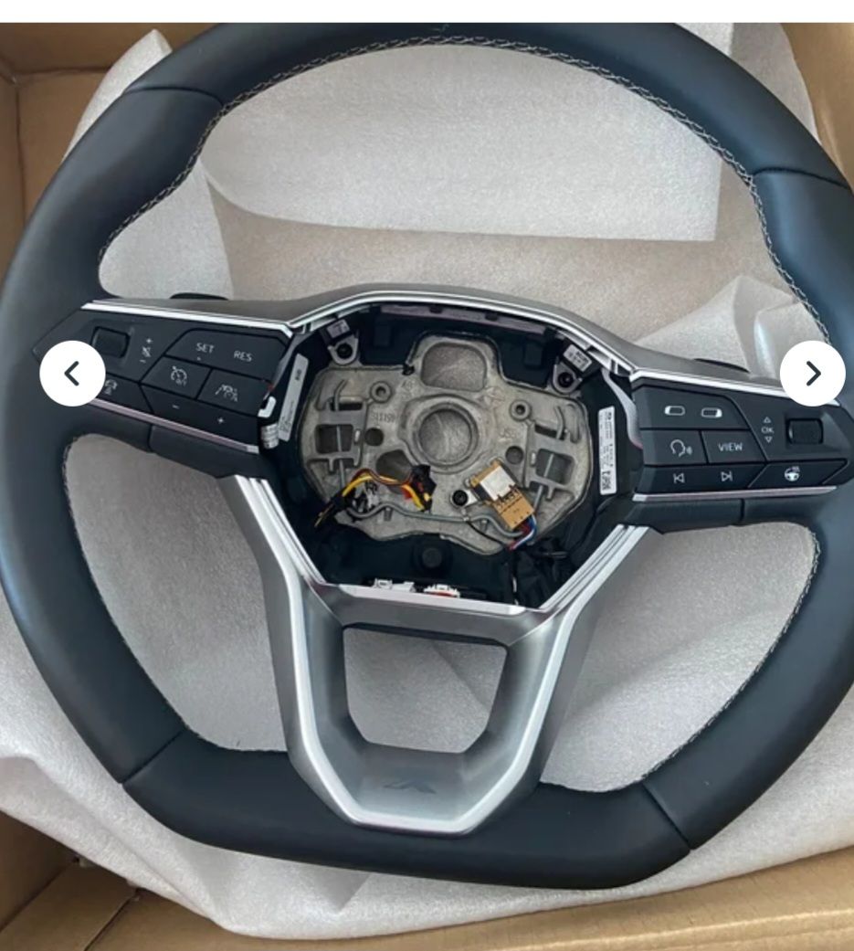

la referencia es 5FA959542

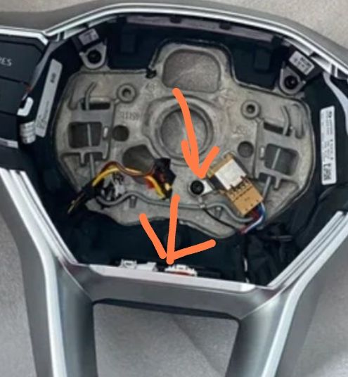

The seller tells me that he believes it is capacitive. But I would like to know your opinion, because it is not fr, it is x, and I don't know about the subject. thank you

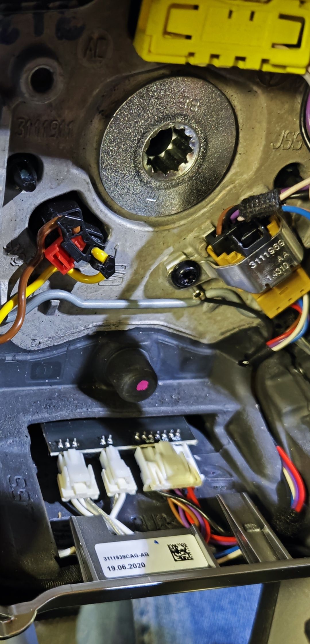

Hmmm. I have xcelence capacitive 5FA419091EL. but yours also looks capacitive. has a cable and plugs for the KLR module.

mounted. Unfortunately, the percentages do not allow me to take the test today. the errors were cleared and nothing came back. We'll see.

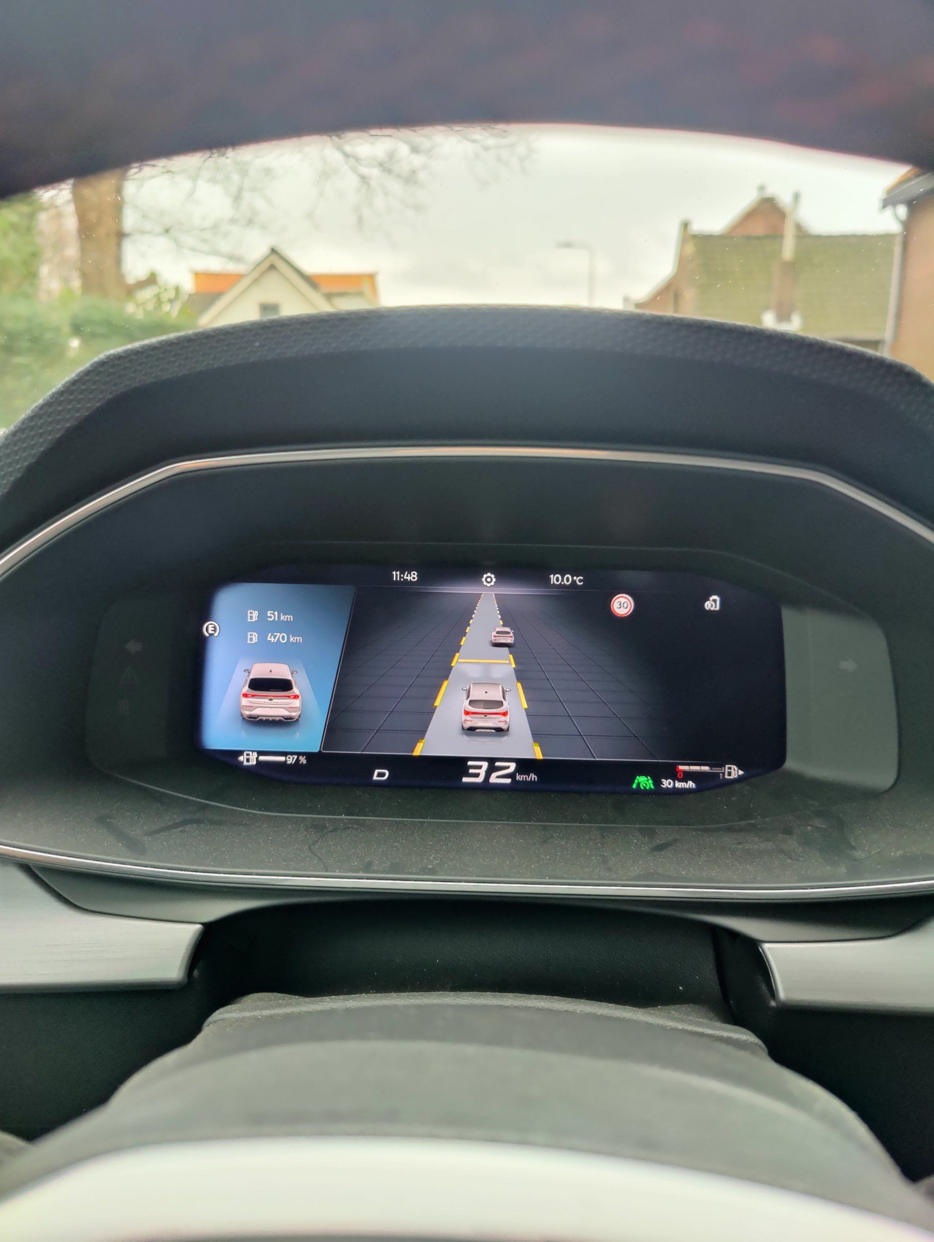

@simoammi for me this module works perfectly. Yesterday I drove 30 km without touching the steering wheel. there were 4 red traffic lights and some traffic jam. the rest of the way about 90 km/h.
