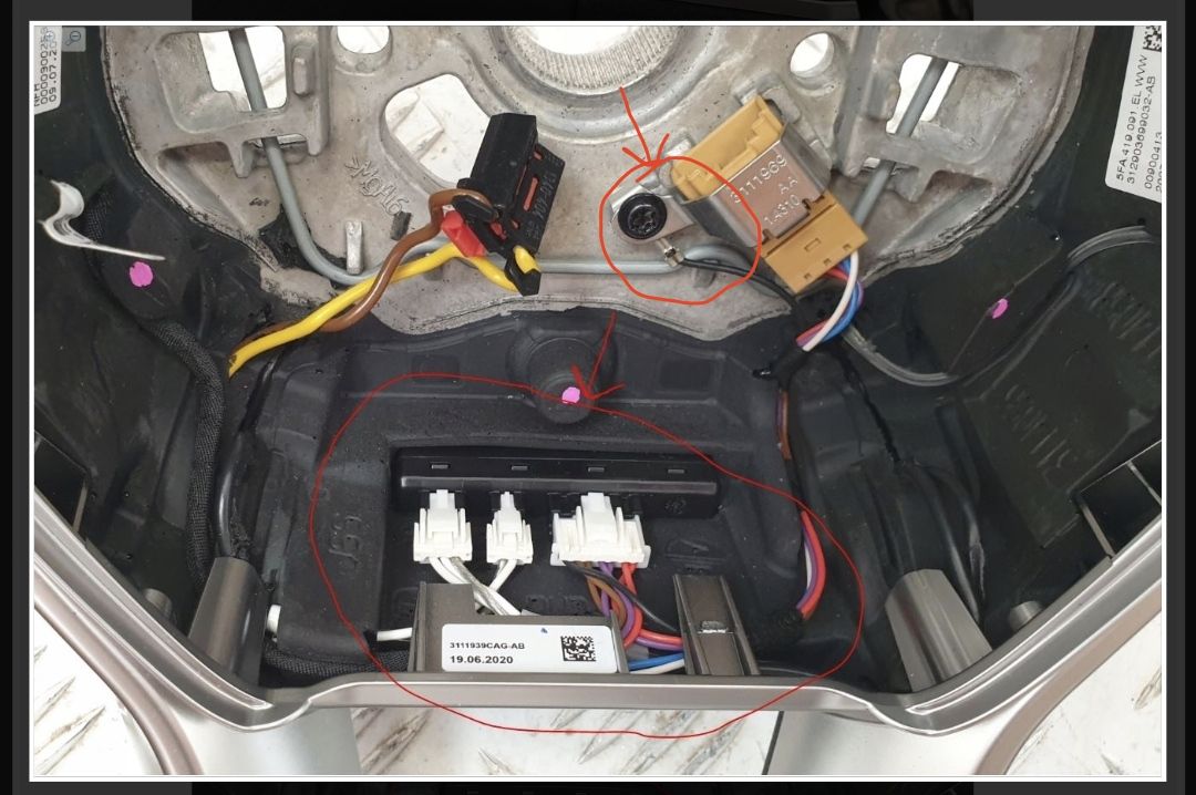

No you really need to have the capacitive steering wheel
If I understood correctly, does the module imitate the hand placed on the steering wheel? But he doesn't imitate moving the steering wheel? If I want to remove the message from the LANE ASSIST it won't work? Thank you!

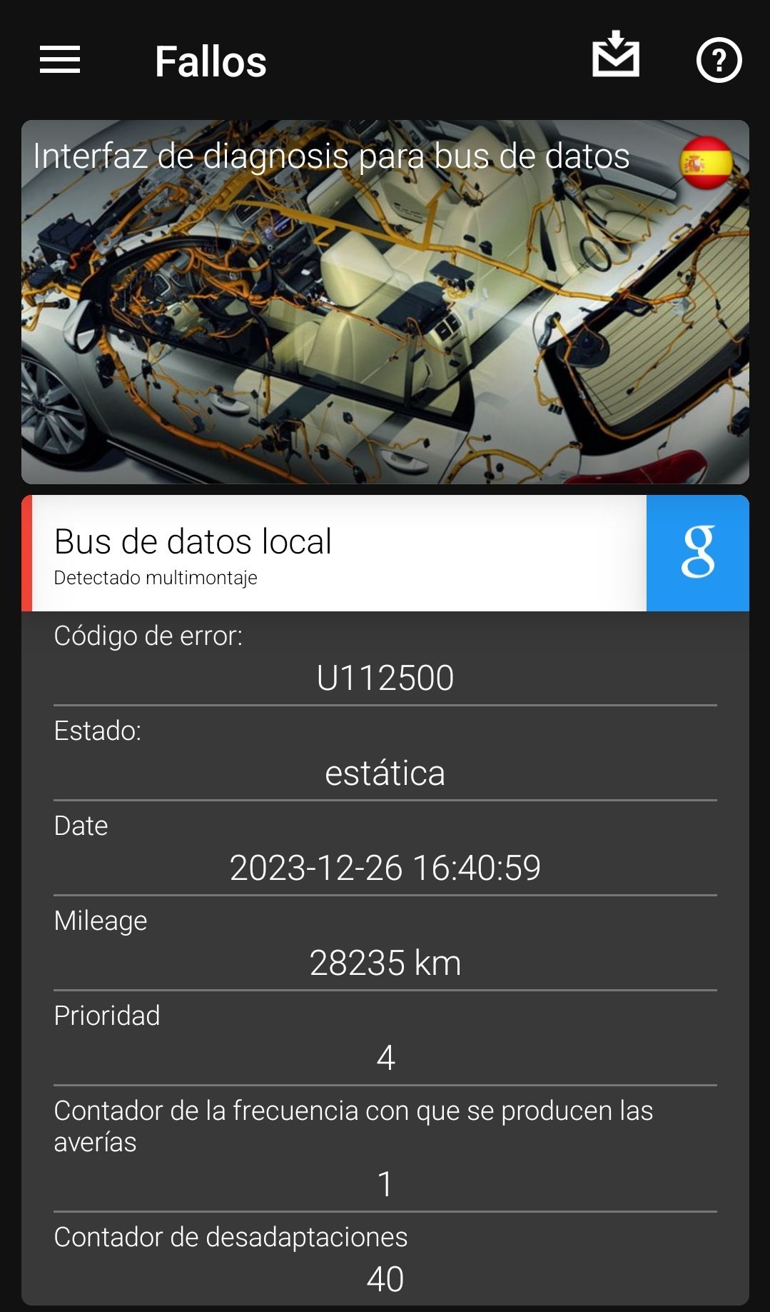

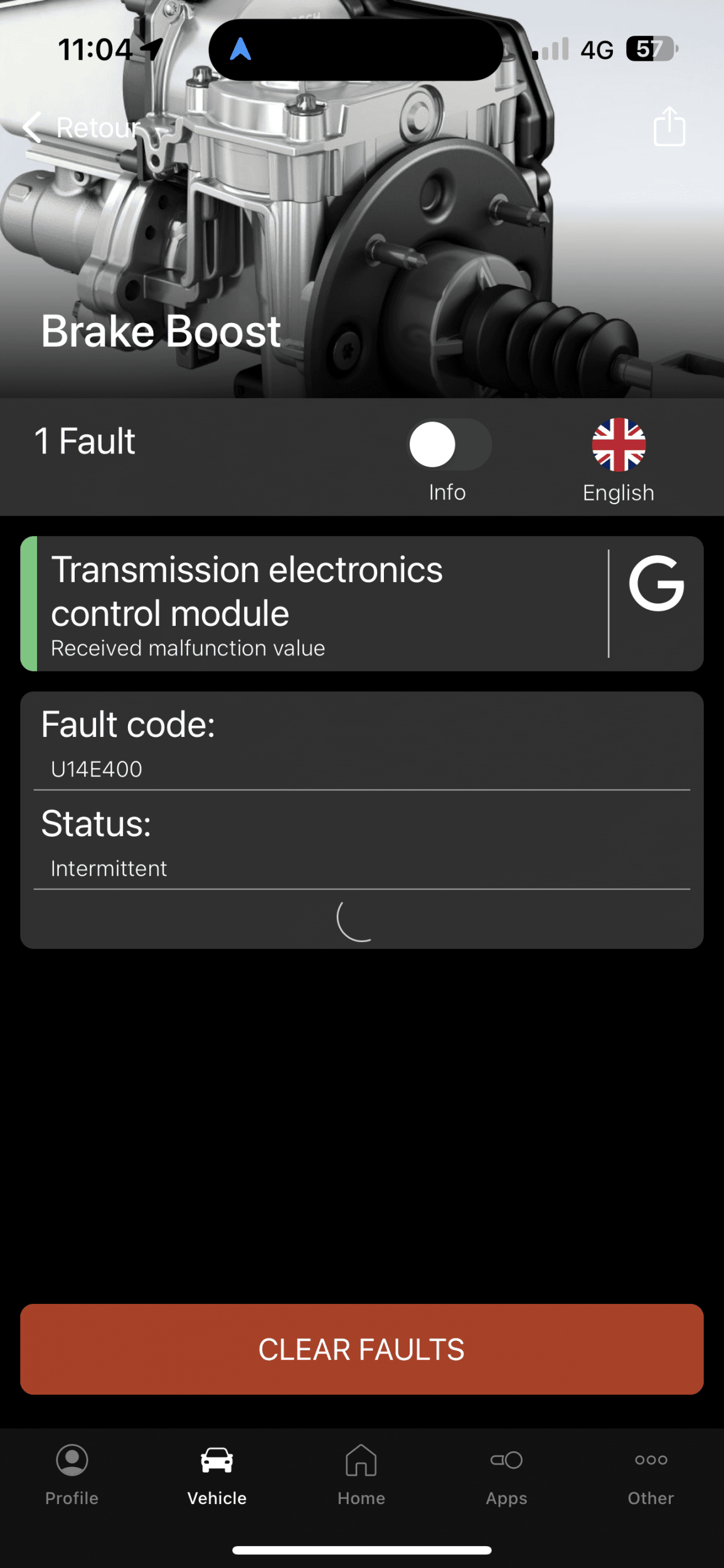

Gracias por la aclaracion. Ahora tengo otro problema. En la unidad de control 19 (interfaz de diagnosis para bus de datos) ahora tengo este fallo
¿Esto puede suceder por el volante con las levas? Mi anterior volante tampoco tenia calefaccion, pero entiendo que al no estar conectada la clema, no deberia suceder nada.

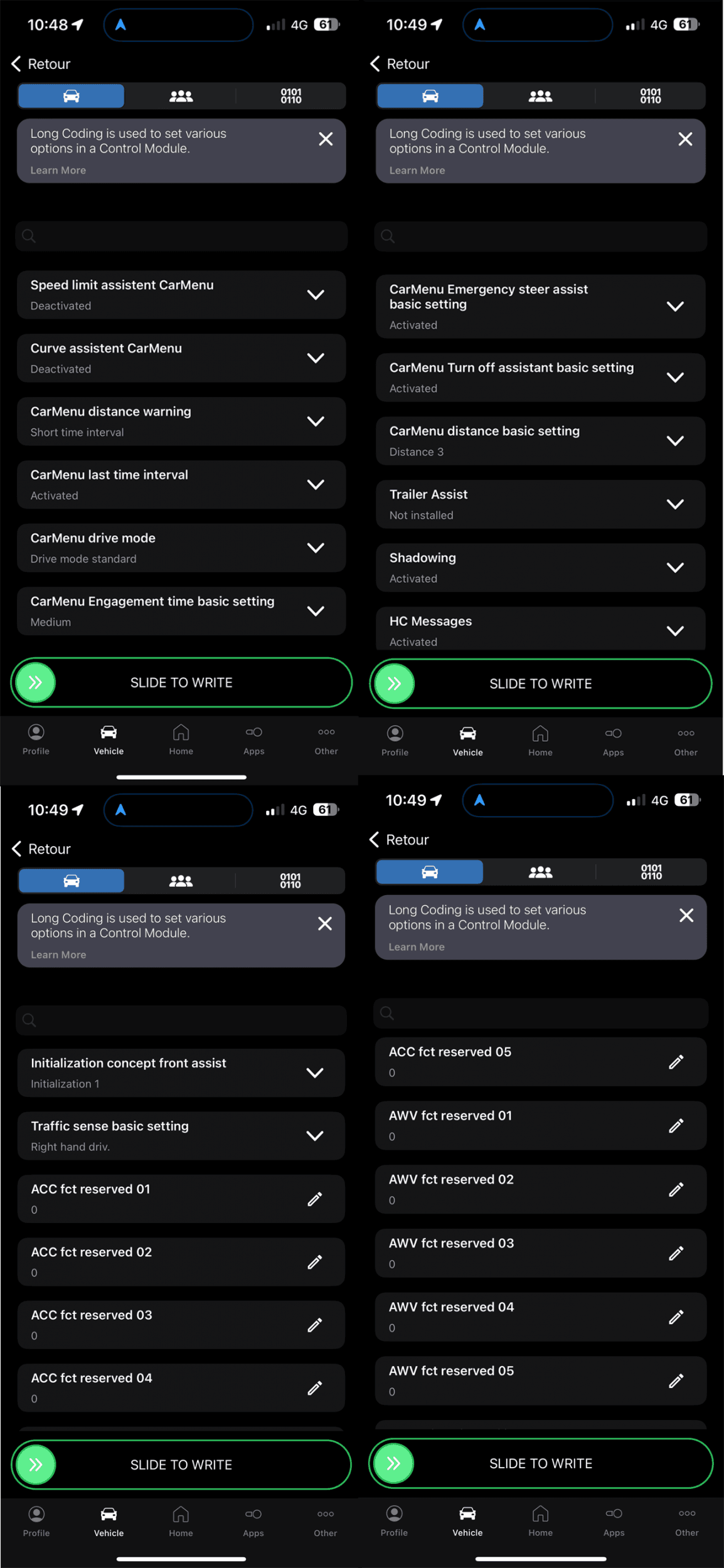

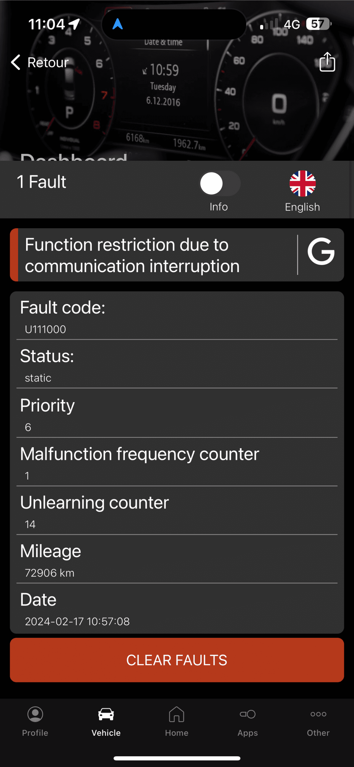

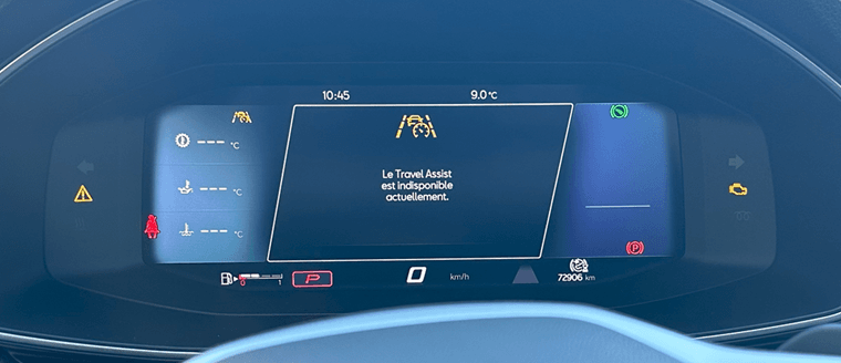

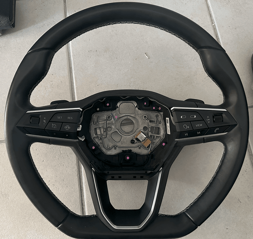

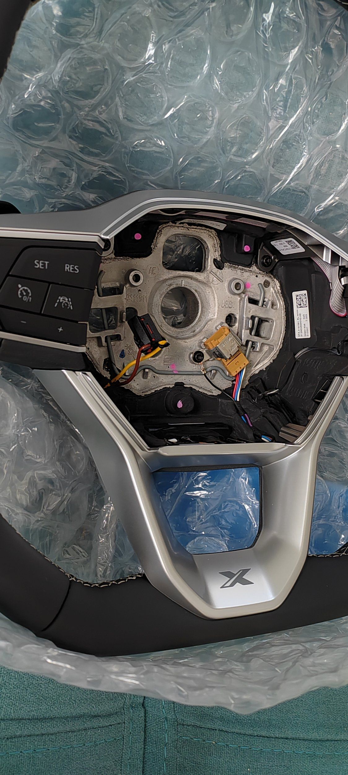

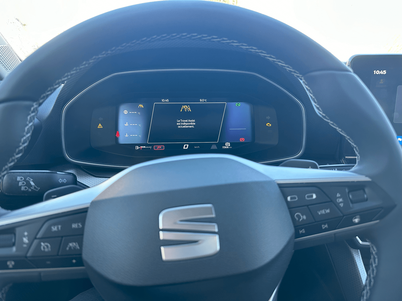

Hello everyone,
I would like to introduce myself, my name is Guillaume, I am French and recently bought a 2021 Seat Leon KL in the Urban trim.
I have made various codings on it (for example, the Scandinavian light), but I am very interested in the Travel Assist.

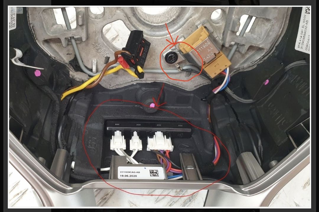

That's why I ordered a steering wheel from 4drive.de, which compared to the old one, which didn't have capacitive function, is very good. I didn't have any particular problems with the installation and removal.

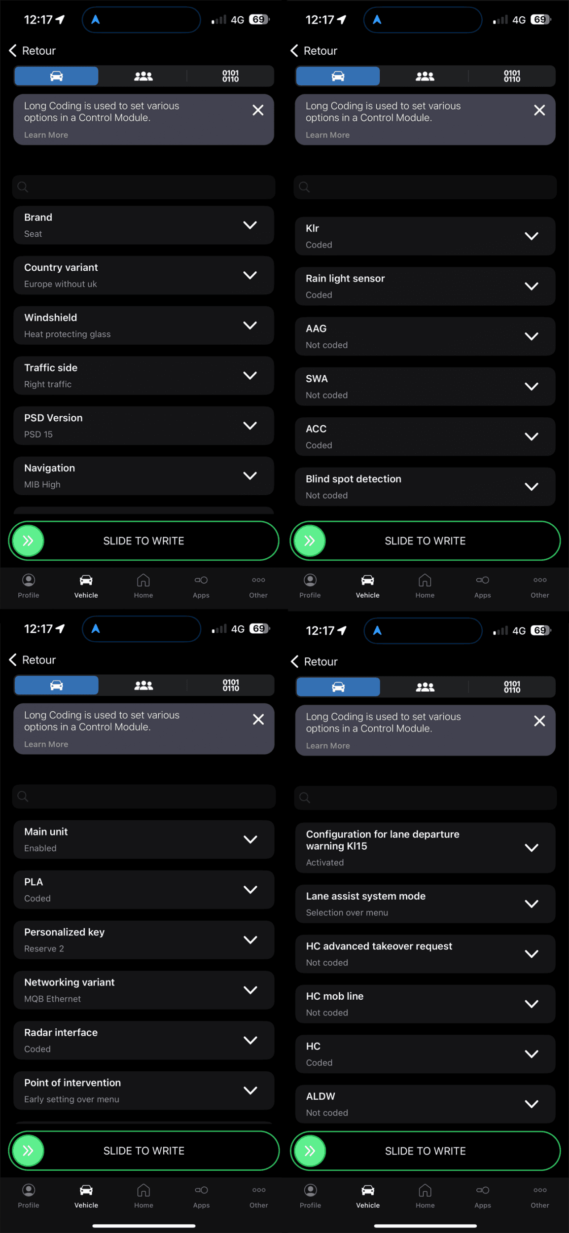

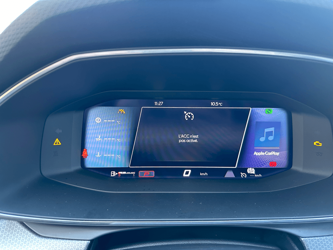

It seems that despite coding HC_VARIANT to 2, you still have an error on the dashboard. I have the same problem with the other variants except 0 and 1.
For now, I leave it on 1 and it works more or less. I don't get an error message, but the ACC doesn't work and the TRAVEL ASSIST button does nothing. From what I've read, it's a kind of variant of Travel Assist.
You can see the various codings of the car in the attachment.
There are two error messages that appear and don't seem directly related to the Travel Assist.
I'm despairing of getting this to work. I don't understand. Do you have any idea what I might have forgotten?
Thank you for your help.

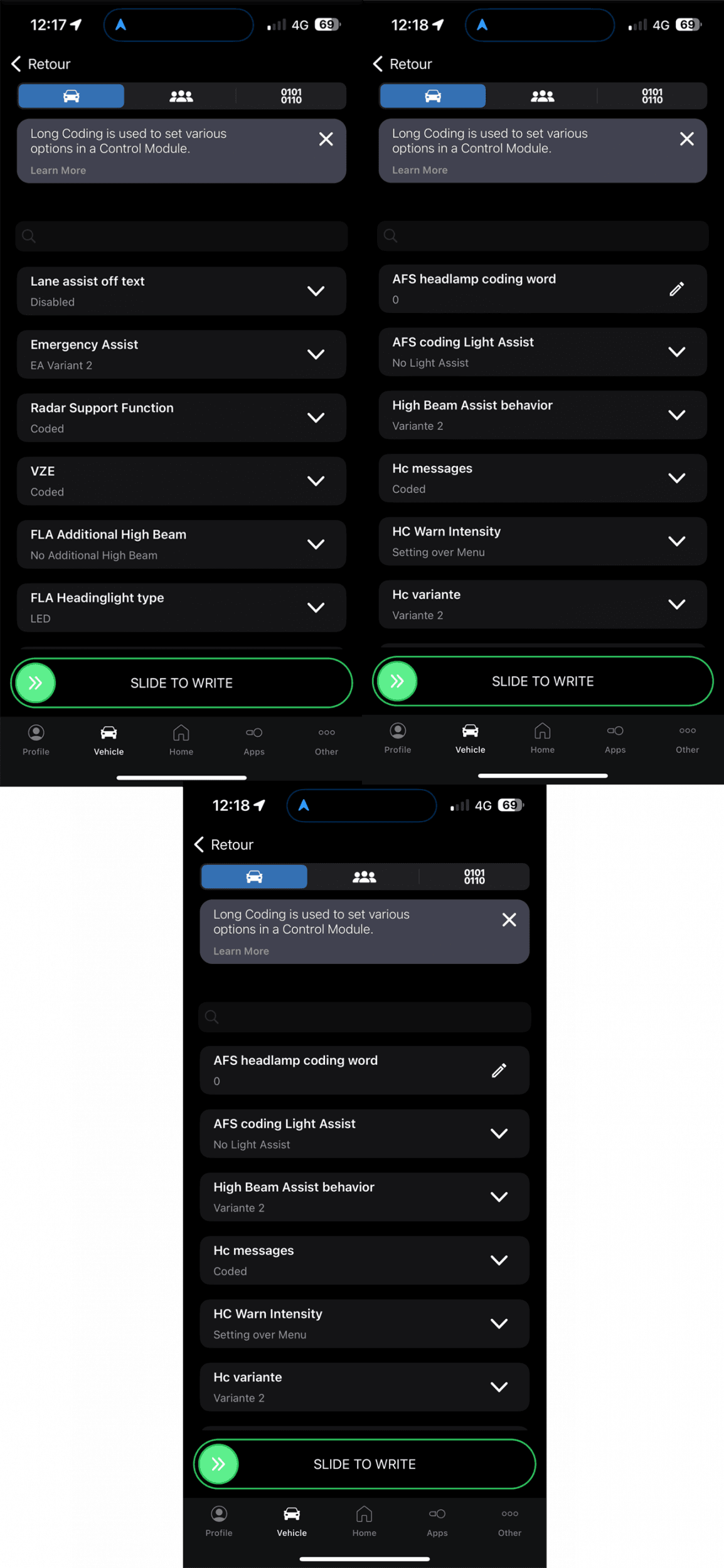

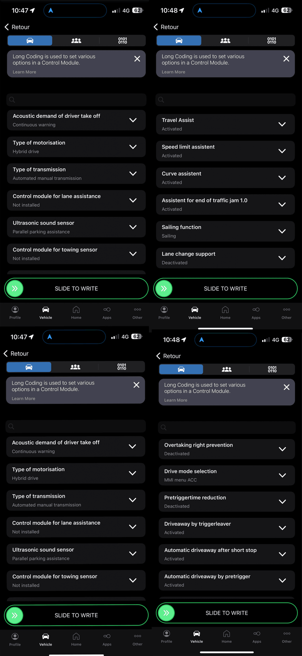

This is full coding list to do. For me is working. Do you have capacitive steering wheel or only with ta button ?
Select Driver Assistance A5
- Select Long coding
- Select KLR
- Set to Coded
- Select Point of intervention
- Set to Early
- Select HC Warn Intensity
- Set to Setting_over_menu
- Select HC variante
- Set to Variante_2

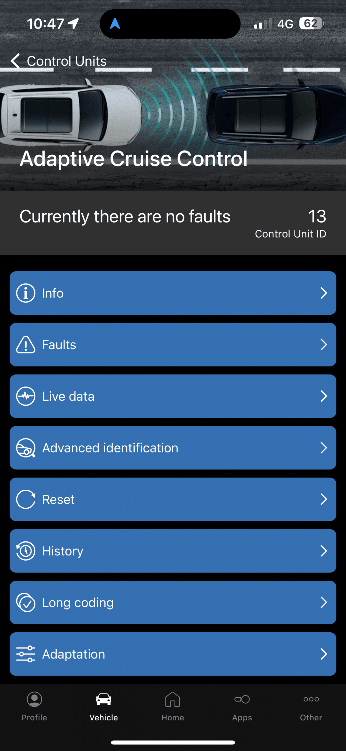

- Select Adaptive cruise control 13
- Select Capacitive_sterring_whell
- Set to Installed
- Select Travel Assist
- Set to Activated
- Select Gateway 19
- Select Adaptation
- Select Specified installation of sub-bus users
- Select Control module for sterring whell touch reconition
- Set to Yes
EMERGENCY BRAKE SYSTEM
- Select Module A5 (Driver Assistance)
- Select Long Coding
- Select Emengecy Assist
- Set To EA Variant 4
- Select Control Unit 09
- Select Adaptation
- Flashing
- Fahrerassistenz Blinkenfunktionen
- Set to Wechselblinken Warnblinken Bremsblinken
- Warnblinken durch Fahrerassistenz
- Set to Active
- Hupen durch Fahrerassistenz
- Set to Active
- Travel Assist
- Set to Active
- Innenlicht durch_Fahrerassistenz
- Set to Active
Alternative
- Select Adaptation
- Interior light general setting
- Set to active
Clear codes

"Thank you for your response, I just checked on the car and I have exactly the same coding as you, except for:
"Alternative:
Select Adaptation
Set to active'"
I just coded it and it's still the same. This car is going to drive me crazy, haha.
