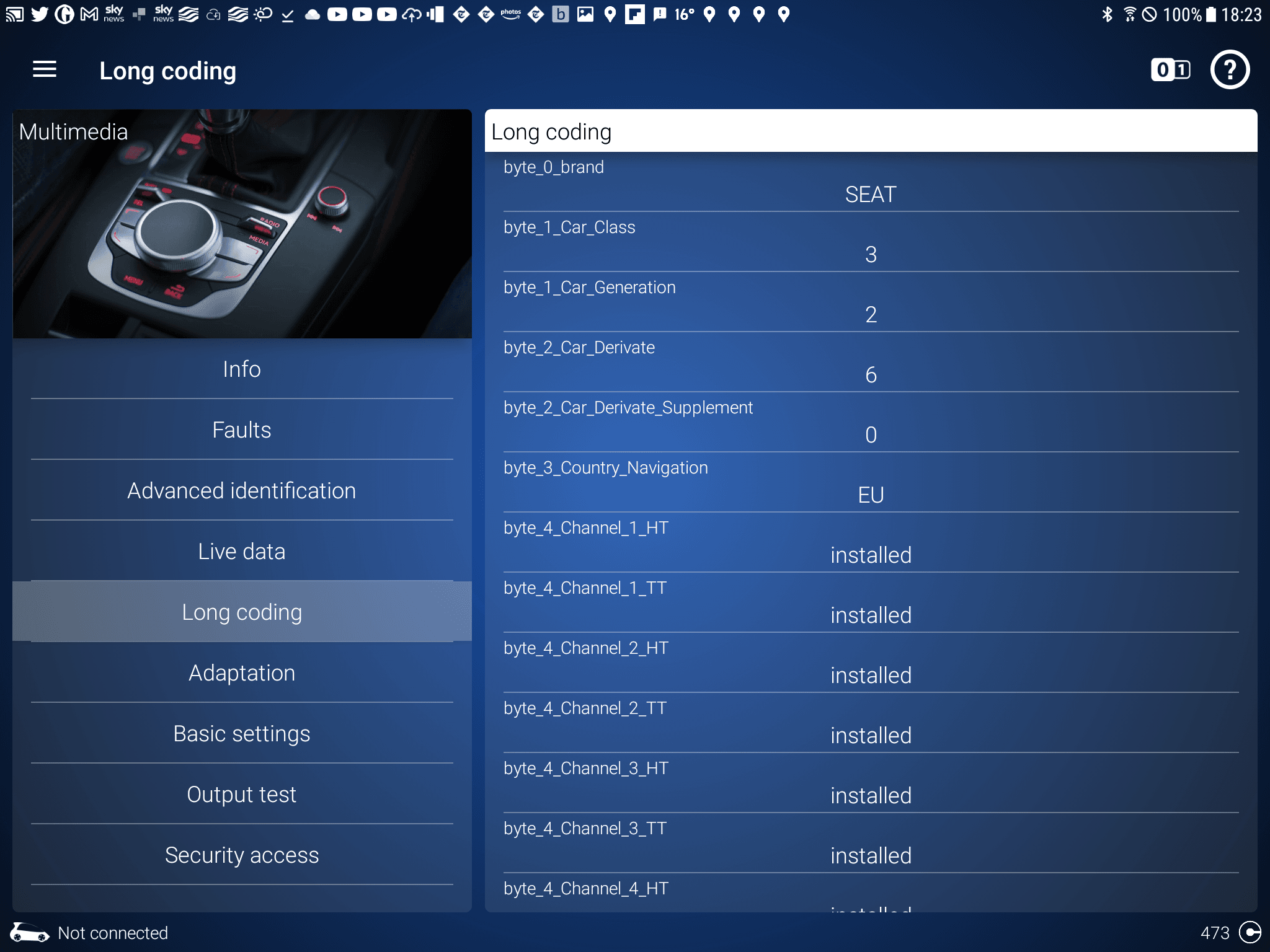

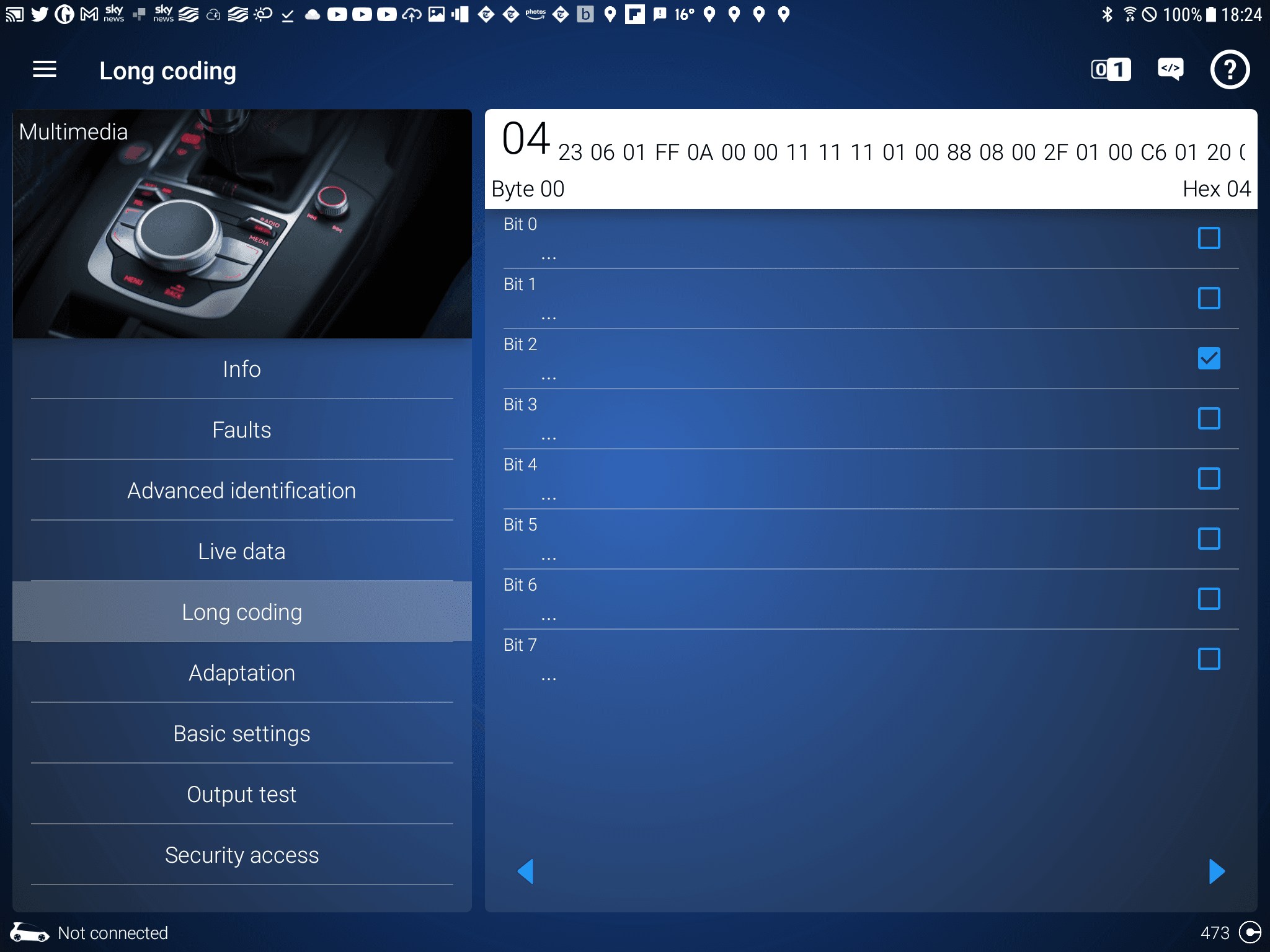

No it's not difficult to do the long coding. The long code is passed into readable string by hitting 0-1 Top right. It's the passed ones which saves the sweat but quite a few things are done via the Adaptations menu.
Example of the long string being passed into meaningful stuff (Ateca btw):
Passed into text (based on user feed back):
In Deano's example above Obdeleven people have populated the long string for control unit 13 in the right place with the text "overtaking_right_prevention" to make it easy.
Basically whether it's VCDS / Ross or Obdeleven they use the flags to program the bytes and bits. The one click apps combine all of this into a macro but you can't see what's happening or what it did. The long string is the machine code that populates the control unit. The screens are a bit like Microsoft's Object orientated programming, the code is behind the click. Nothing to worry about if you are reversing it, unclick it. One click apps on the other hand you don't know what they are doing running a set of commands or whether unwinding correctly.

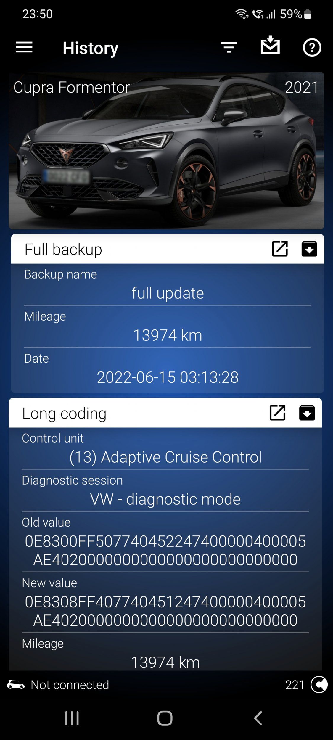

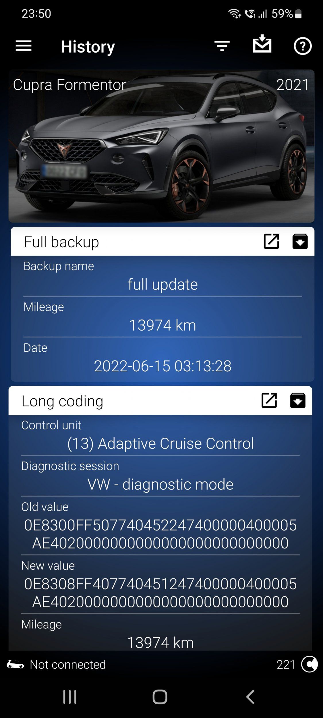

Hello. Tool my car to the dealership for the update. When it came back I did a backup with obdeleven. I checked up the update in history and found this modification that I didn't make myself. Is that normal?

Hello. Tool my car to the dealership for the update. When it came back I did a backup with obdeleven. I checked up the update in history and found this modification that I didn't make myself. Is that normal? View attachment 32420
Sometimes when you alter the settings on the Ateca they get reflected in the long string. Least how I remember it.
If you have the Pro, when not plugged in, if you bring up that module, tap long coding and tap <0-1> icon. It may well have text around the settings. Then scroll thru the bytes to see what those are. I think you can bring up the old string and do the same. Comparison of the two may give you a clue of what the difference is. Whether they programmed it or just hit an option on the cars stick etc. Main thing is not to have the dongle in since you don't want to change anything by accident. You can look at these settings off line in Obdeleven with the Pro (least on my car prior to SFD).
That's how you discover what was changed... assumes the long string is annotated in the <0-1> screen for you to read off.
