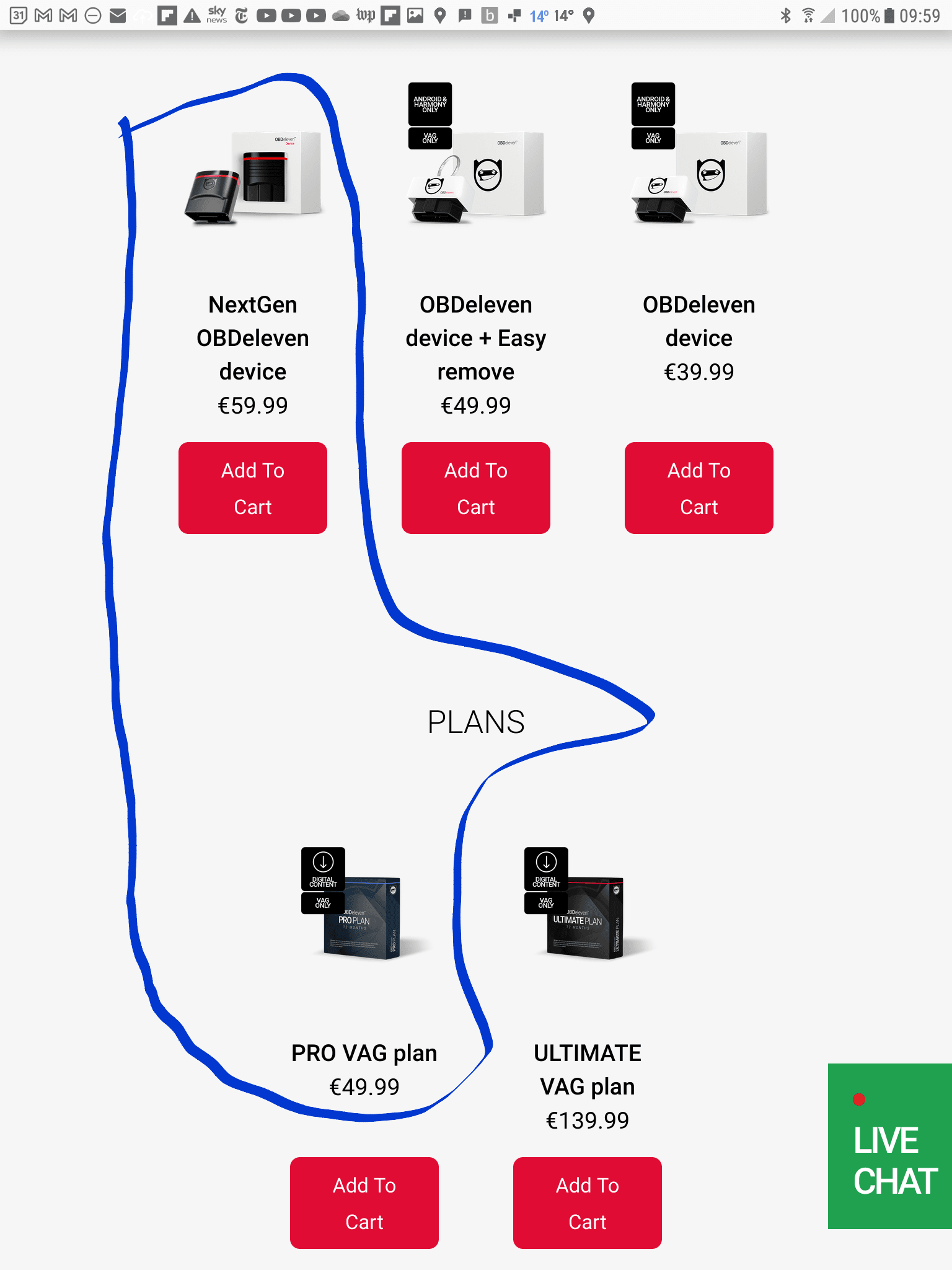

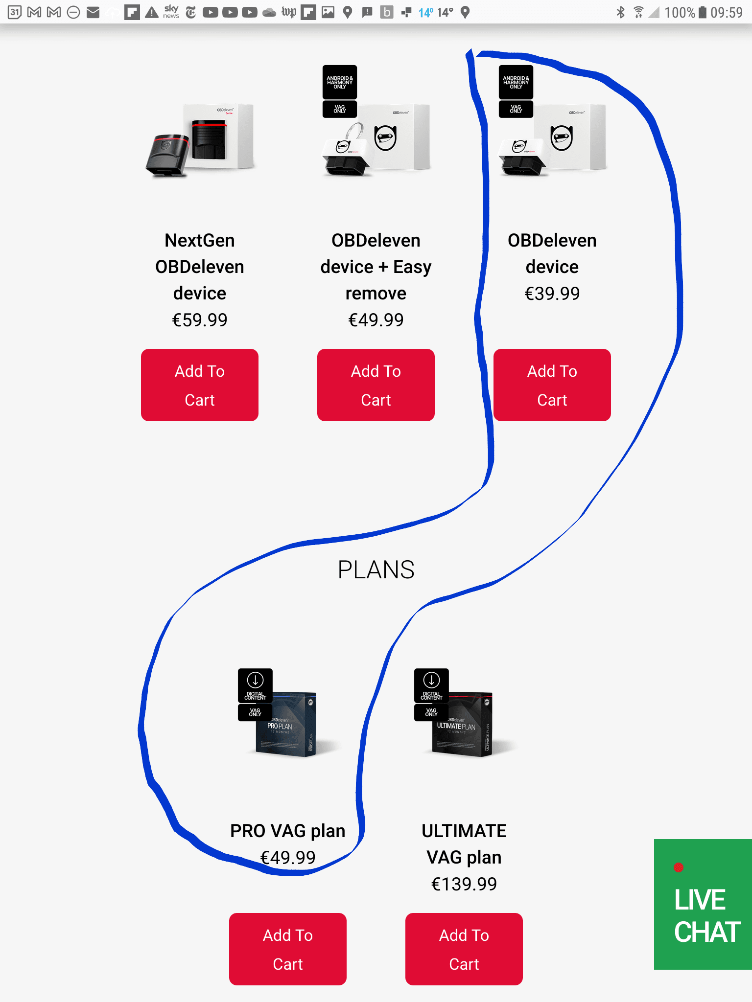

Jul 4, 2022

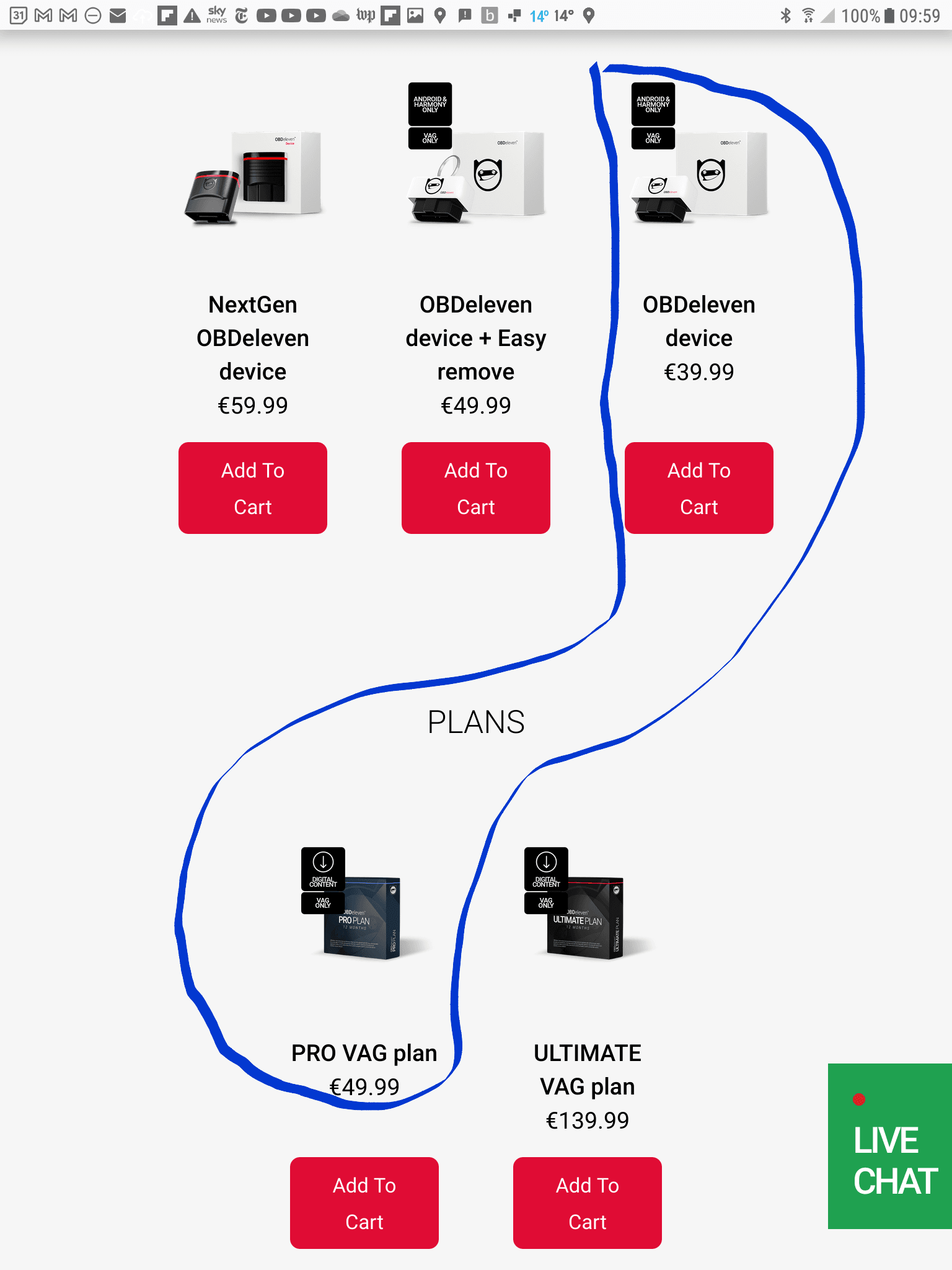

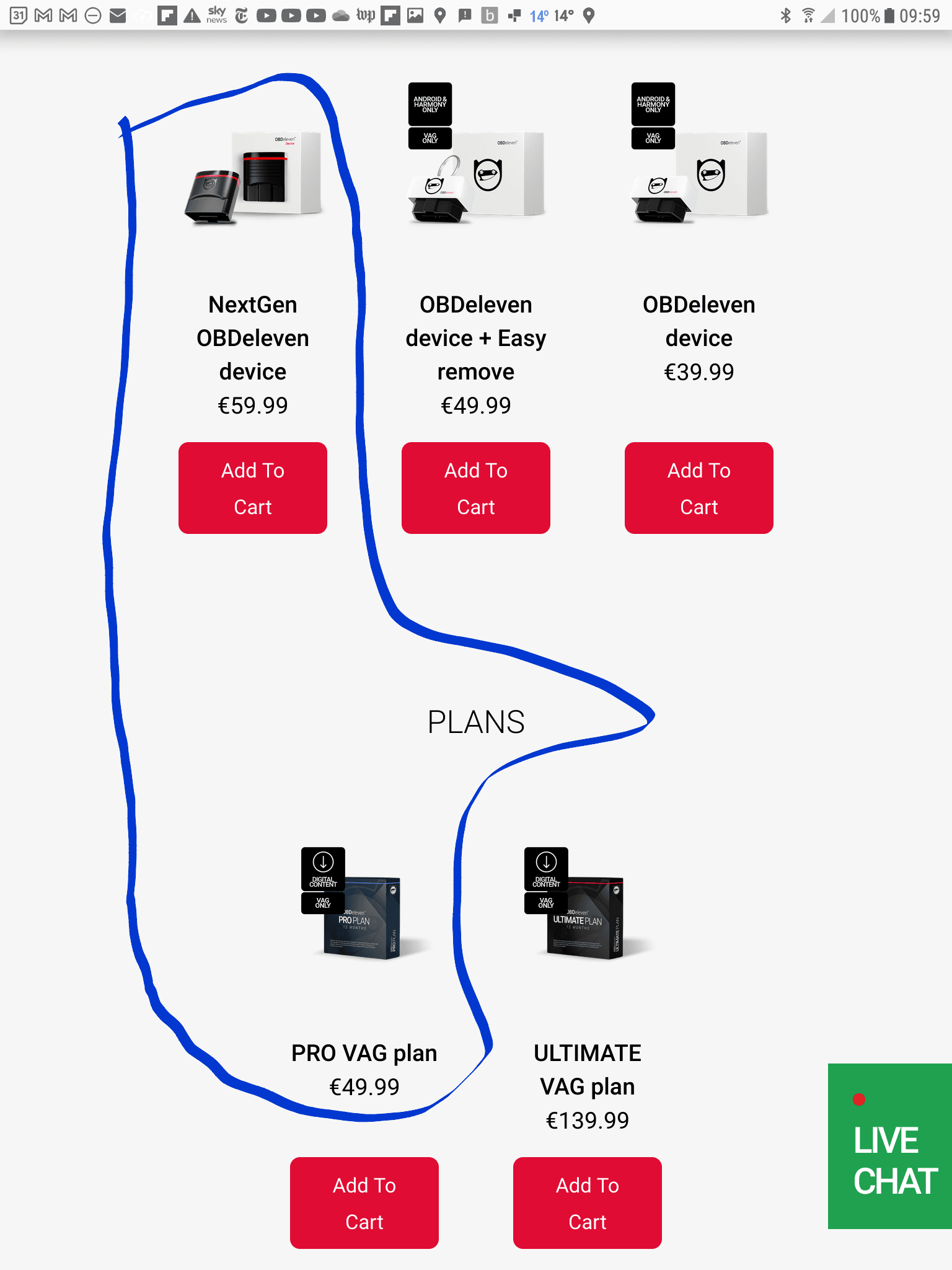

Is it worth buying the winter pack they have at the moment? Works out at £75 and comes with phone holder and 100 credits
Tell
Full Member
That excludes the Pro license so I would say no. You can always add the Pro license online.
All you need is the dongle original for Android only, Next-gen works with Android or iPhone and the Pro license. I use the jiffi bag it it came in for storage. Nothing special.
They do have Xmas sales, black Friday deals etc. Amazon Prime you can get next day delivery and buy the Pro license online so you can get up and running in less than 24 hours. Depends how the costs of the dongle from their website compare with elsewhere and how long you want to wait for delivery v cost.
The products off their website
The Pro Pack is €49-99 in addition runs for a year then reverts back to just the dongle micropayment 1-click apps. You don't need any credits if you have the Pro since you aren't using the 1-click apps.
For Android only with Pro license:
For Android and iPhone with Pro license:
The Ultimate gives you the developers 1-click where with all, you pay a premium to be a 1 click developer.
What has been done on the thread is with the Pro license. The crowd sourcing guys who fancy themselves as developers read the threads and produce one click apps that may or may not work correctly submitting those to OBDEleven for publication.
You can look at what is currently published as 1-click apps by downloading the Obdeleven app without buying the dongle putting in the car and seeing what 1-click app exist then compare with what is on the thread. By far more educational is to code with the Pro license since you know what you did and how to undo it. 1-click is for novices and risk takers.

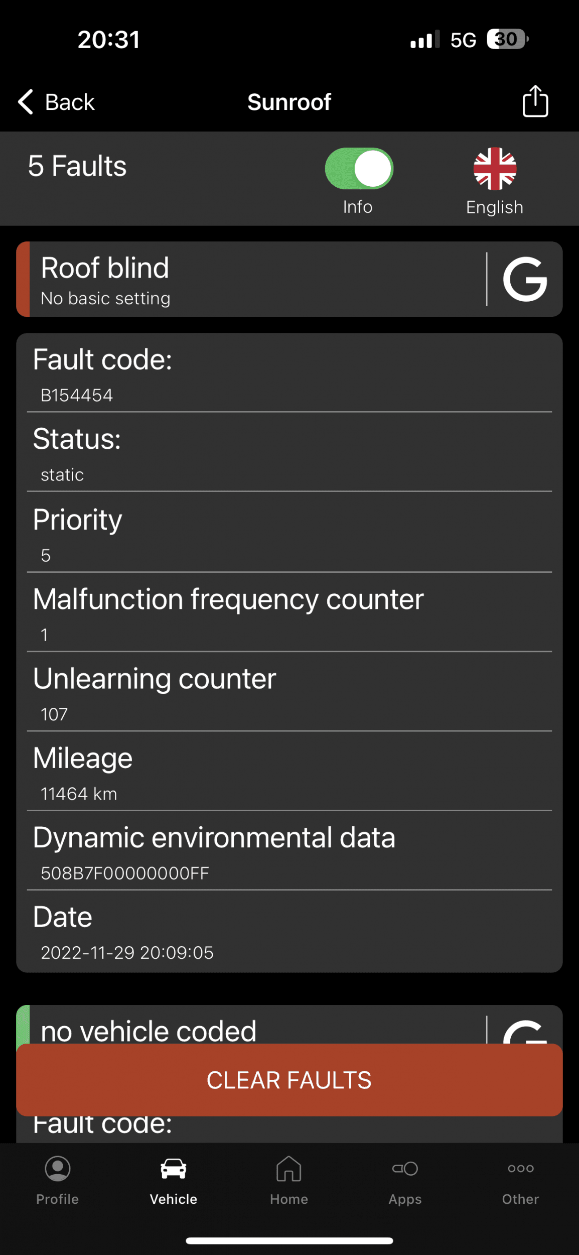

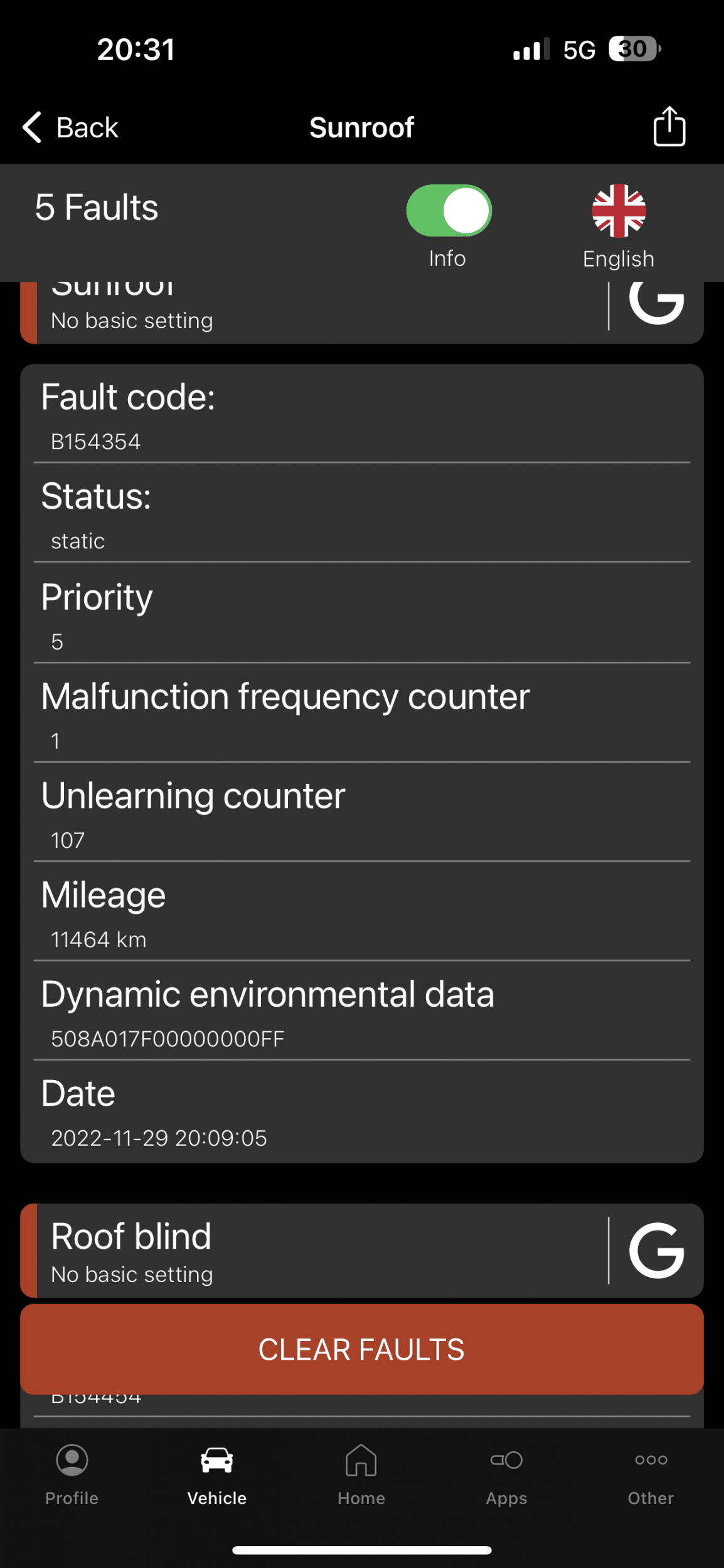

Nov 29, 2022

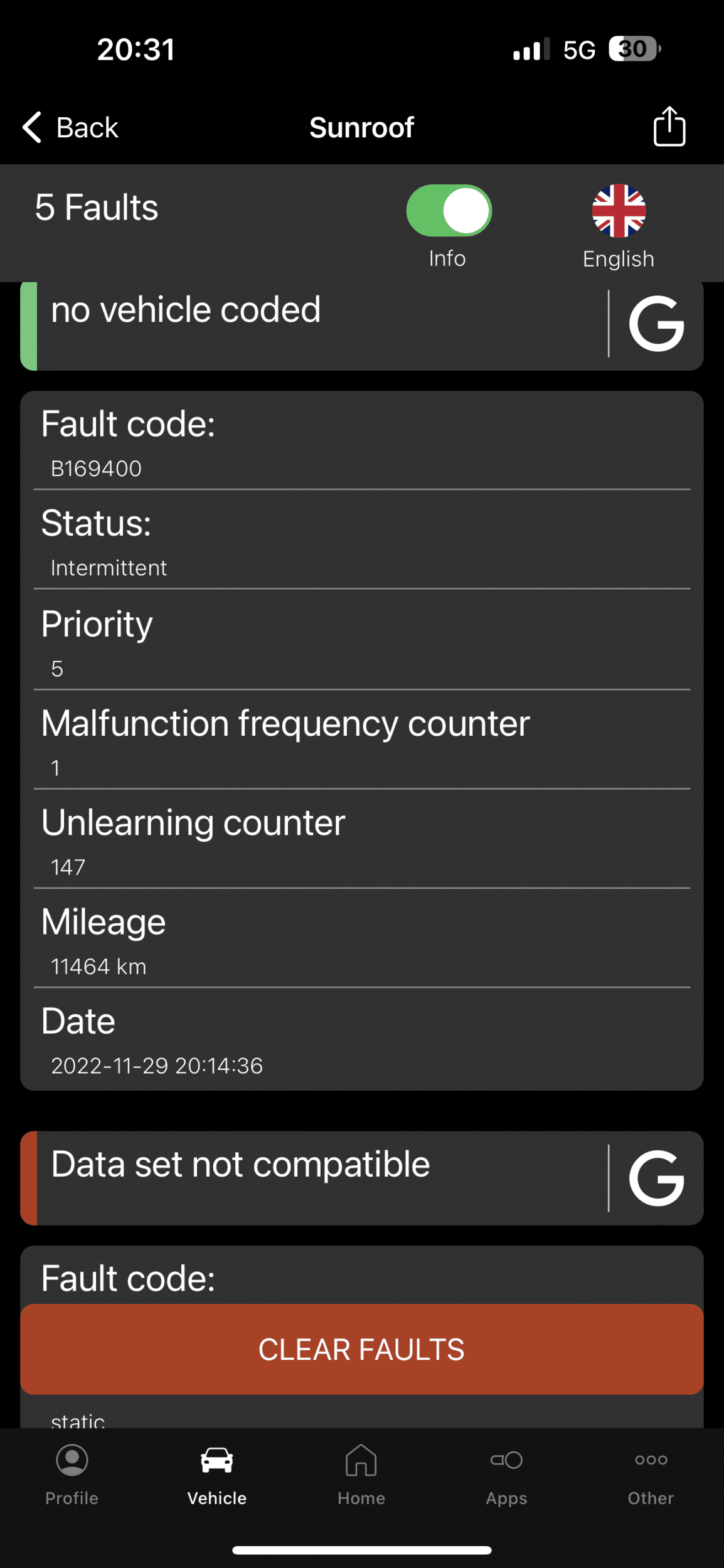

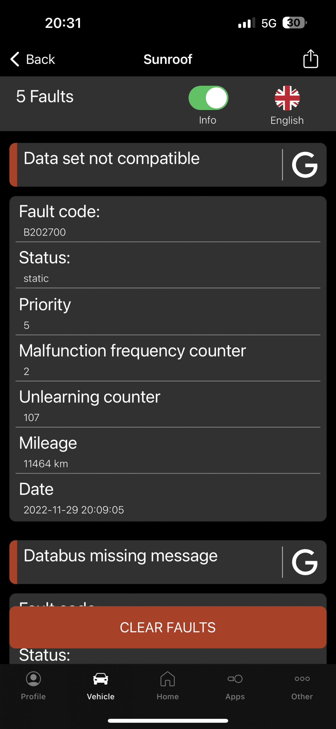

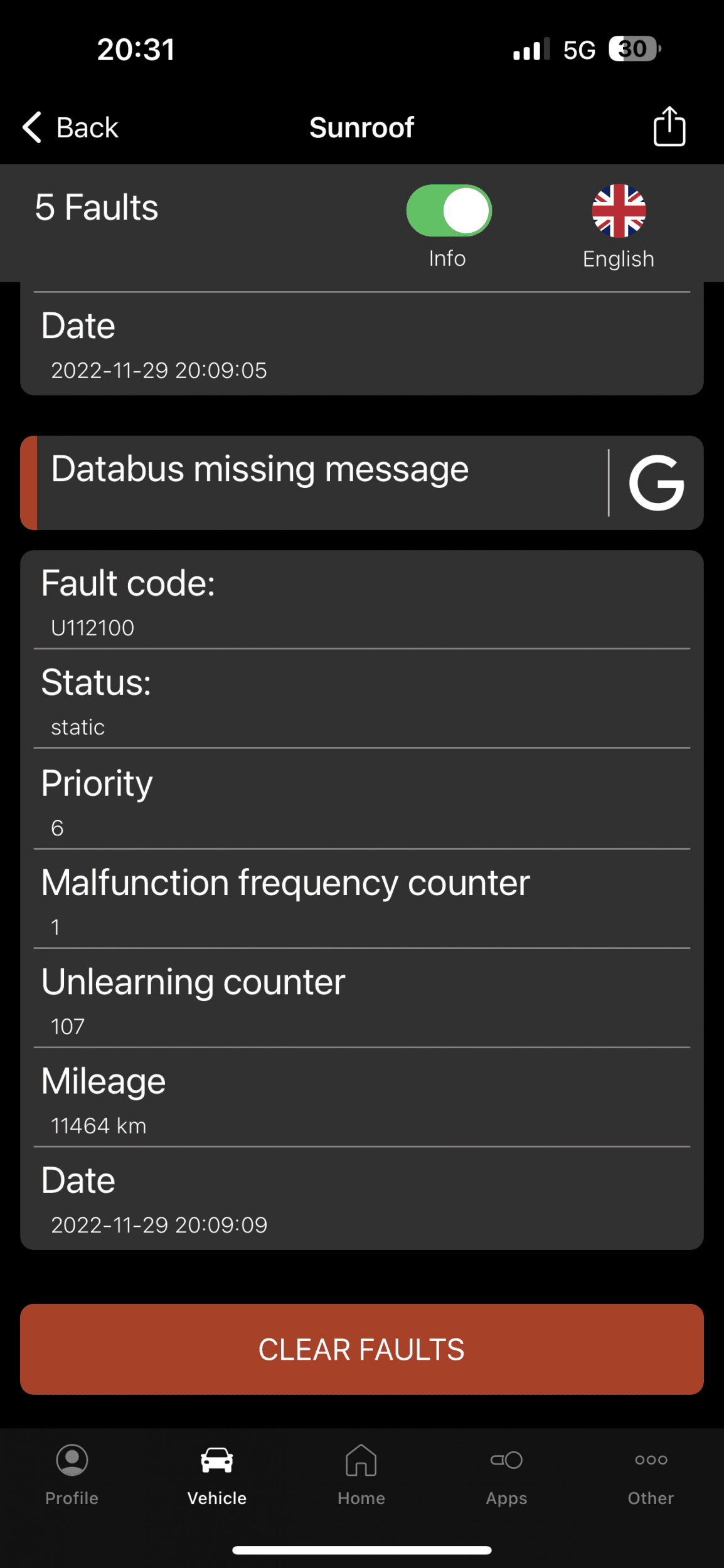

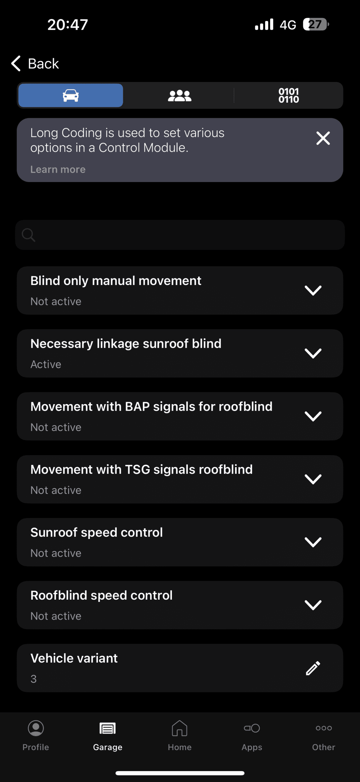

Hey guys! Can u help a friend in need? So, on my 2.0 vz 310 the sunroof and sunshade only open for about 1/3, and obd eleven shows the next errors. I think it might be something wrong with the vehicle variant in long conding from the sunroof module, can u help me with that?
