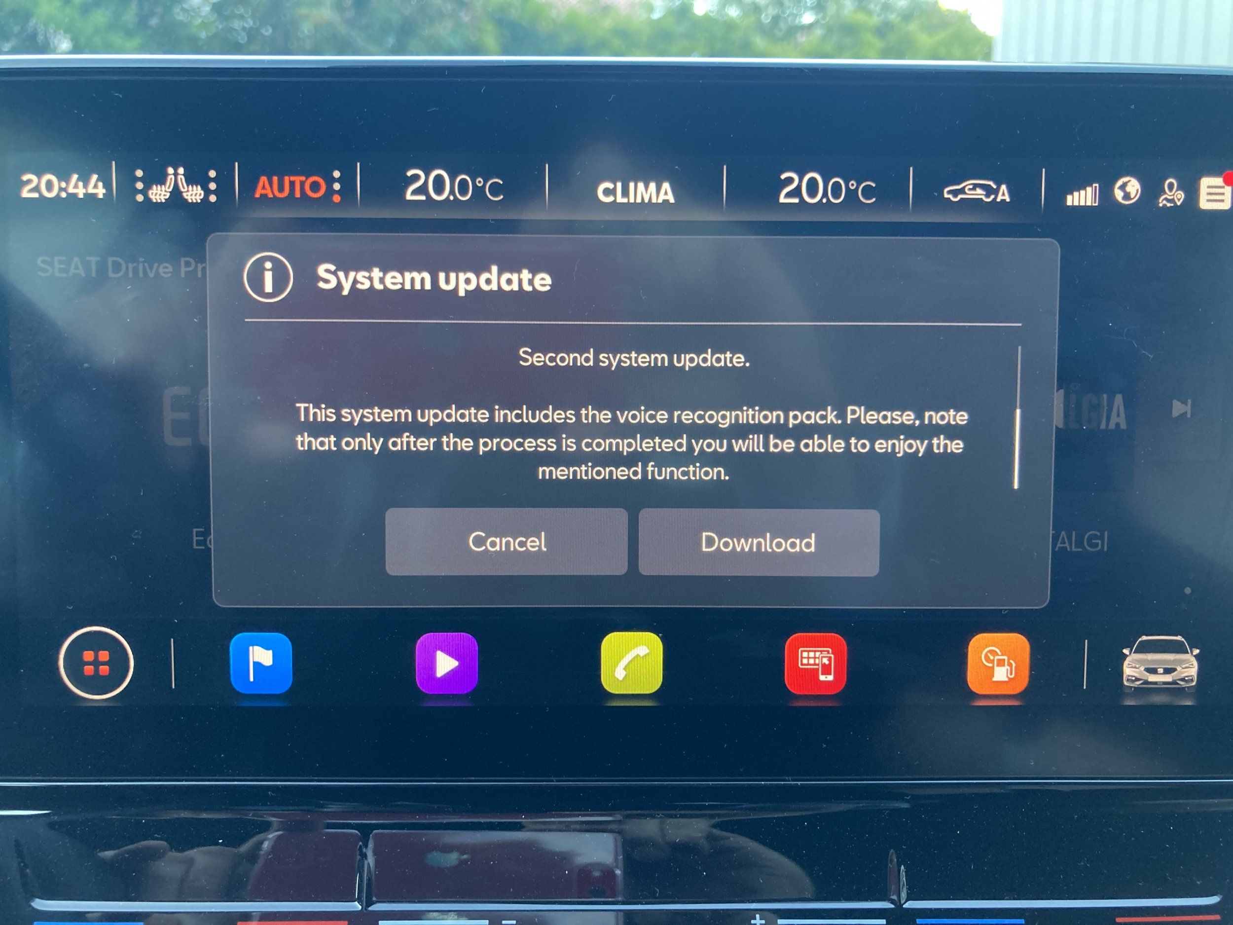

Still waiting for the second update after the A896 as well.
Indeed, voice control is not working.
Voice control is back after second update but with a male not female voice. Now on the wake word(s) the screen shows a "what can I do for you" line instead of speaking it as before.

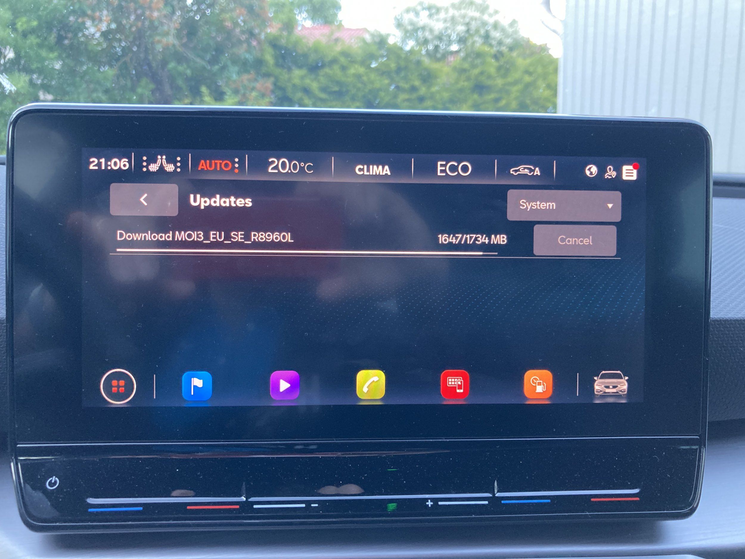

The second part of the update came yesterday, 1,7 gb. It went nicely through. I am still running A896 though.
Got the update as well.
