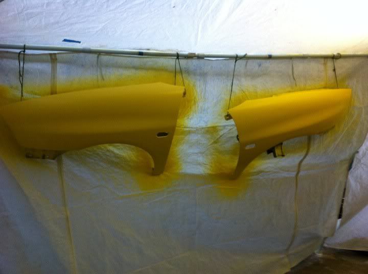

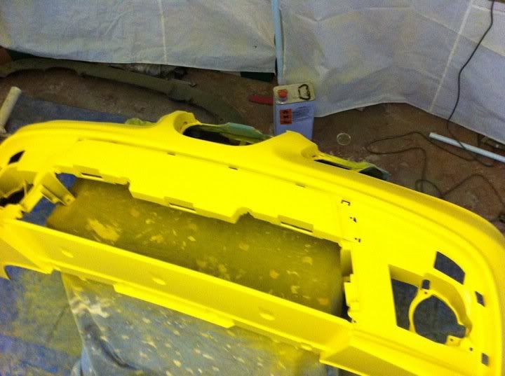

3 coats of base including each wetsanded.and 3 coats of laquer. Ive got the bonnet and boot nice and shiny but doors are alot duller.... still abit of orange peel in it. I only used 3000 grit all over the car mind you, you think the doors need another light run over with 2000 and a polish with g6 then final polish with foam pad ?
