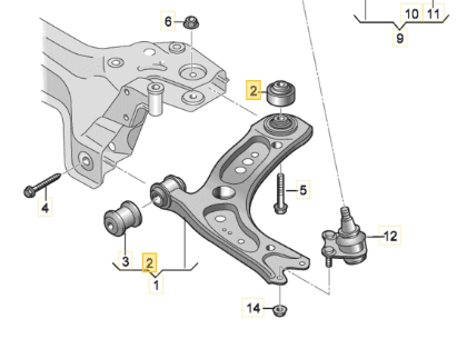

Presuming it's number 2 which is delaminating?
From your VIN - They are available separately = bush No2 = 5Q0407183E which is around £15 superseded to 5Q0407183L which is around £20.
The whole arm (LH) is 5Q0407151L which was around £110 & (RH) 5Q0407152R is around £135 (don't know why price different the the LH!!!
LH now superseded to 5WA407151 at around £135
RH now superseded to 5WA407152 at around £135
If you just replace the bush - obviously need to factor in more labor to press out the old bush - and press in the new one.
Need to also factor in a full alignment afterwards and ADAS calibration if you have radar cruise?
Are they also including a new ball joint? - as these are about £45, and probably new hardware.

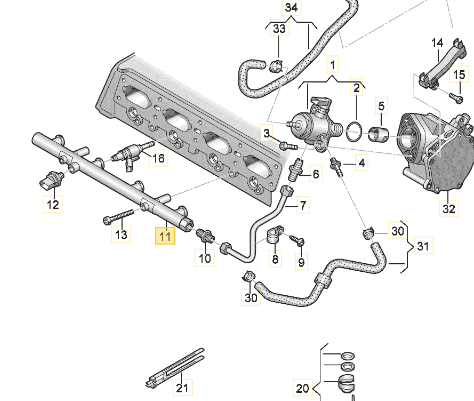

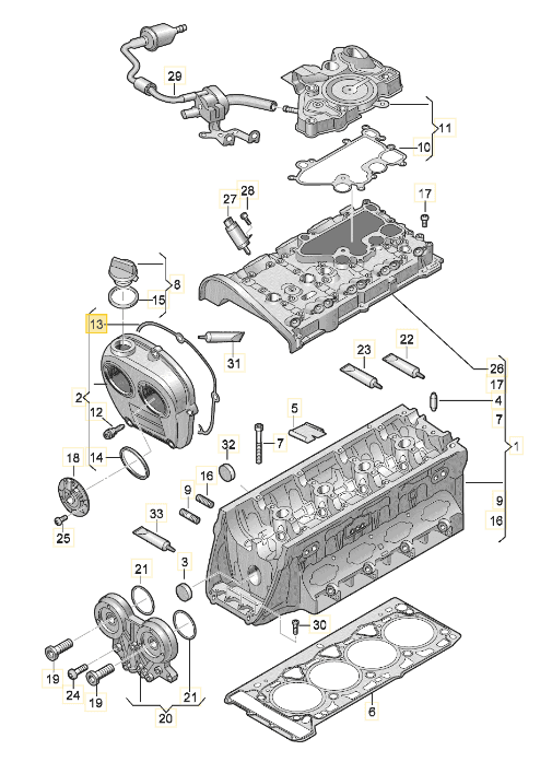

The injectors have to come out to do the rocker cover and is a bigish job as all the seals have to come out and the the injectors have to be adapted for smooth running control. So at seat prices this about right. You want cars that run right this is the price if done correctly.
Would you really need to adapt the injectors if you just take them out and put them back in the same place?
EDIT~ you don't need to remove the injectors Number 16 - for a rocker cover leak as they mount much lower on the cylinder head - below the oval air inlet.
If number 26 is leaking looks like there isn't a separate seal - just tube 23 & 22 - and relying on the 'expect' hand of the technician to perfectly clean and apply new sealant! (don't cut corners here unless you want to do it again)
Number 23 = D154103A1 sealant 100g believe it or not is listed at £95!
10 & 13 are around £22 each.
