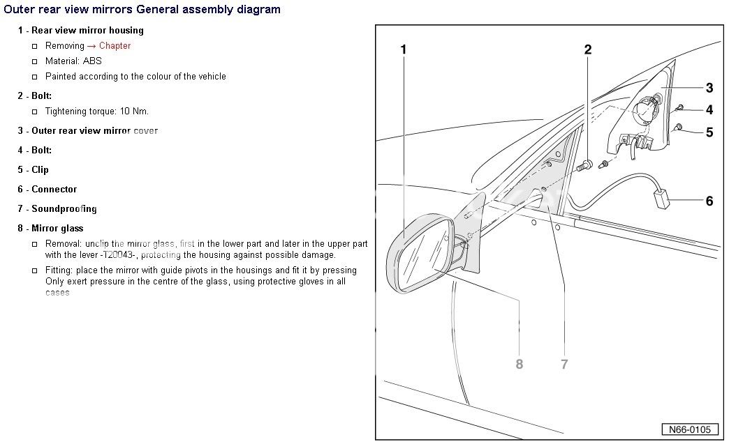

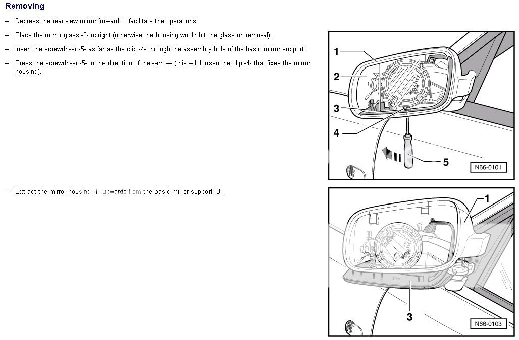

does any1 have any exploded diagrams of the wing mirrors or know which manual is best as there aint a haynes?
Pull the mirror lense out; then you will see the clips holding the plastic covers on; take this off and all is exposed :)
