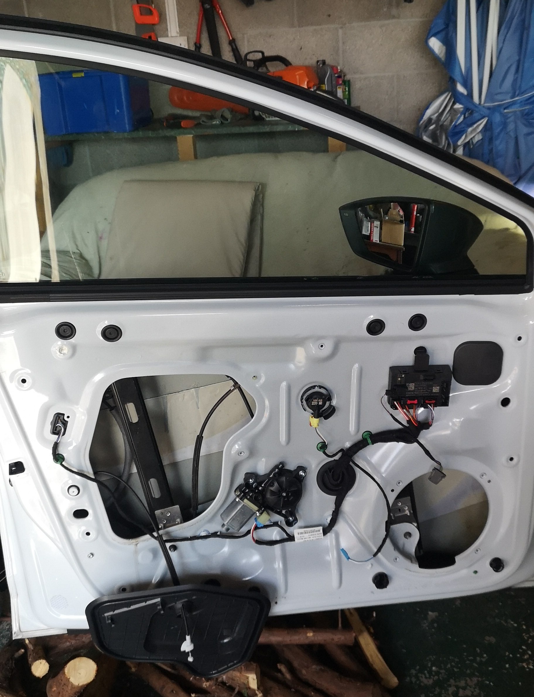

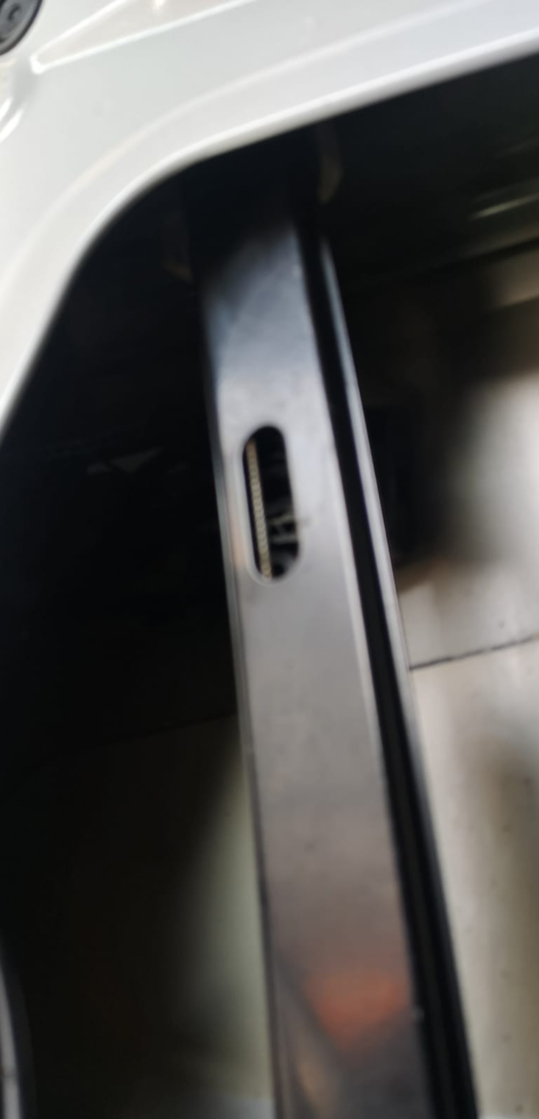

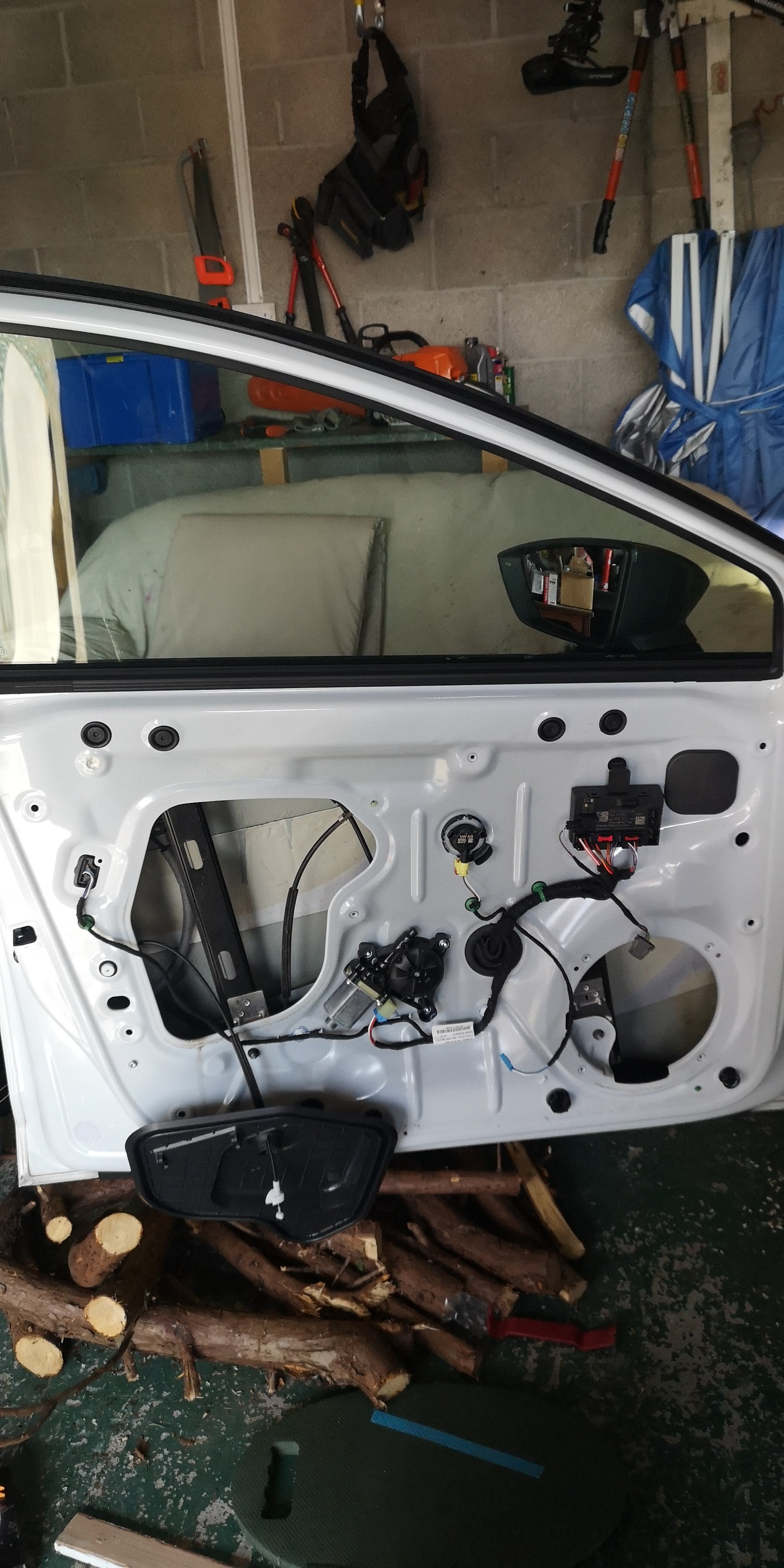

So I managed to get it all off

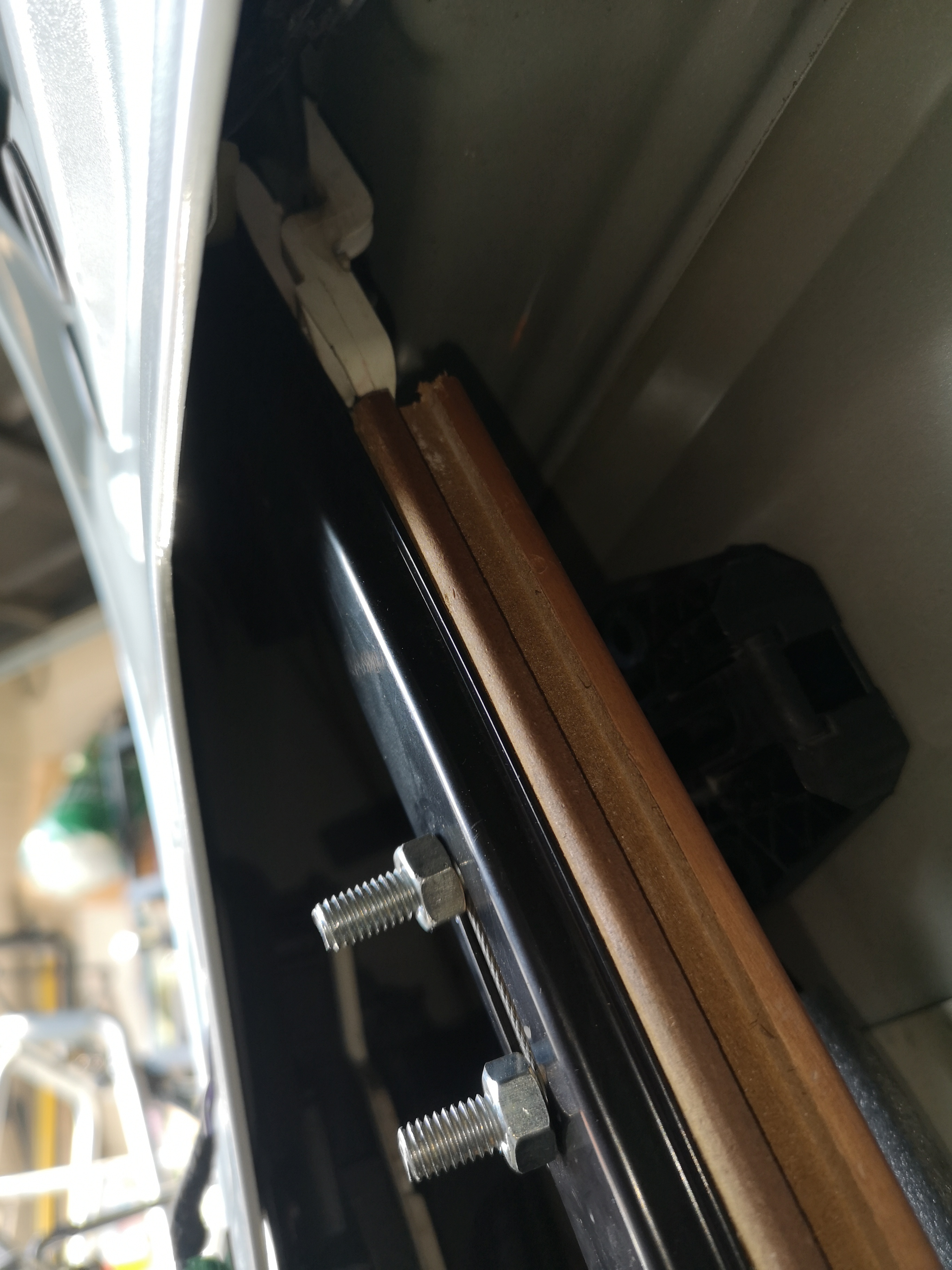

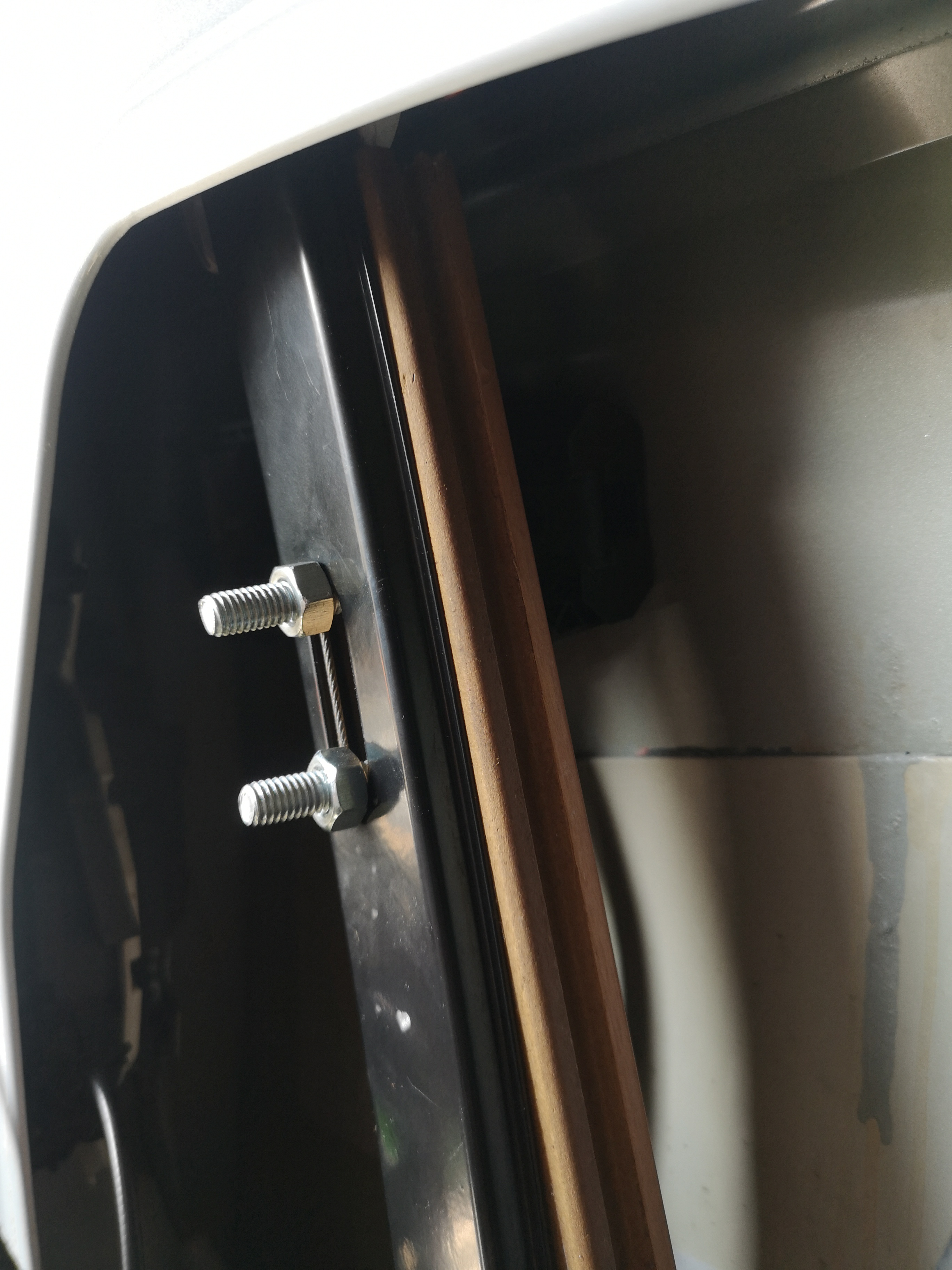

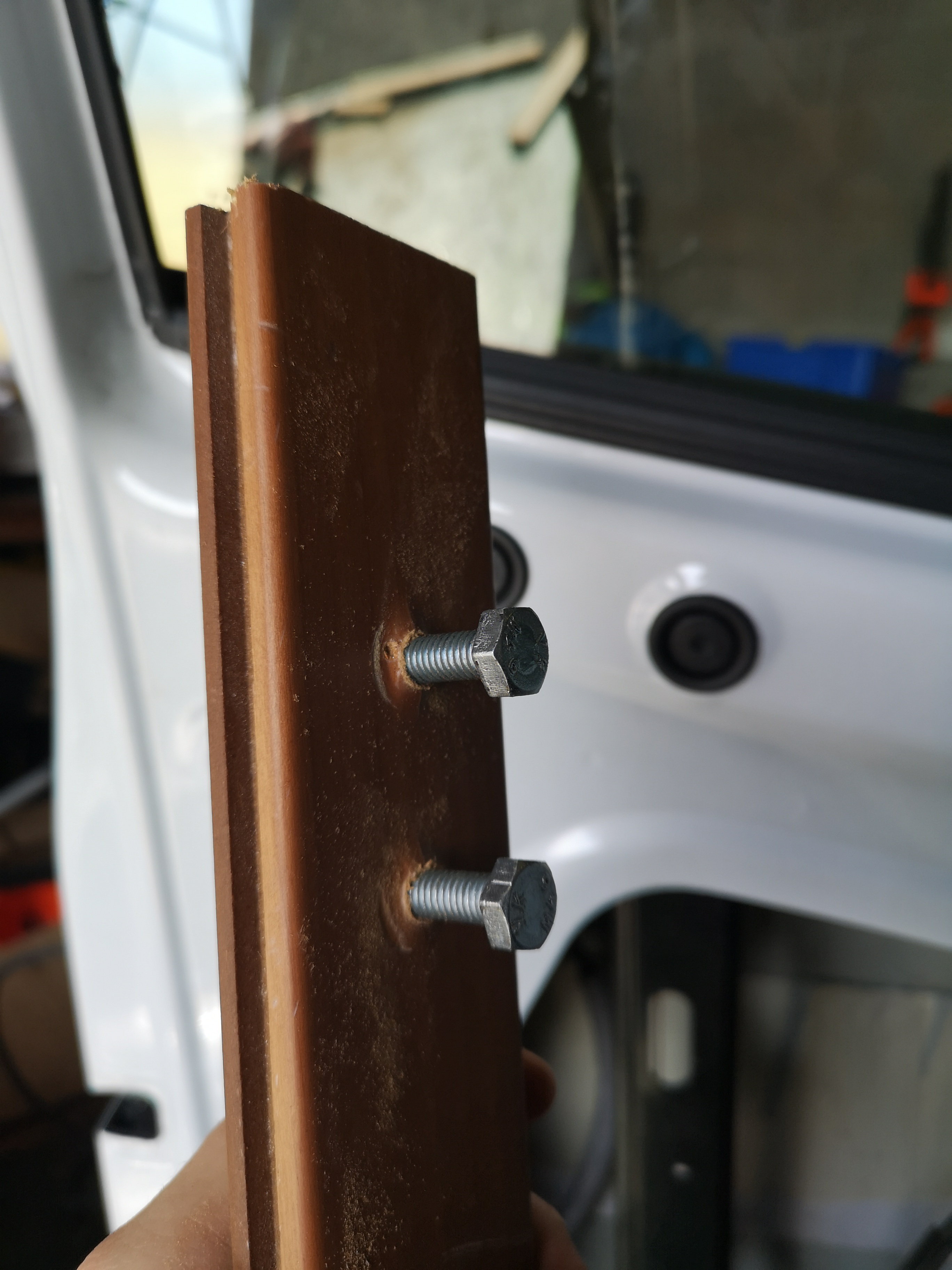

Waiting for the regulator to be delivered but in the mean time so I can use my car, I managed to prop the window closed
Used a bit of wood and then used the existing regulator track holes as a way to bolt it in place. The wood is pressed right up against the clips which hold the window in place.

Great improvisation with the wood.
Once you have your regulator it should be all good.
May need to get an extra pair of hands to help you lower and raise the window and hold it at the correct height then you can put the trim removal tool into the clips holding the window from the top like the video to unclip and remove the glass.
