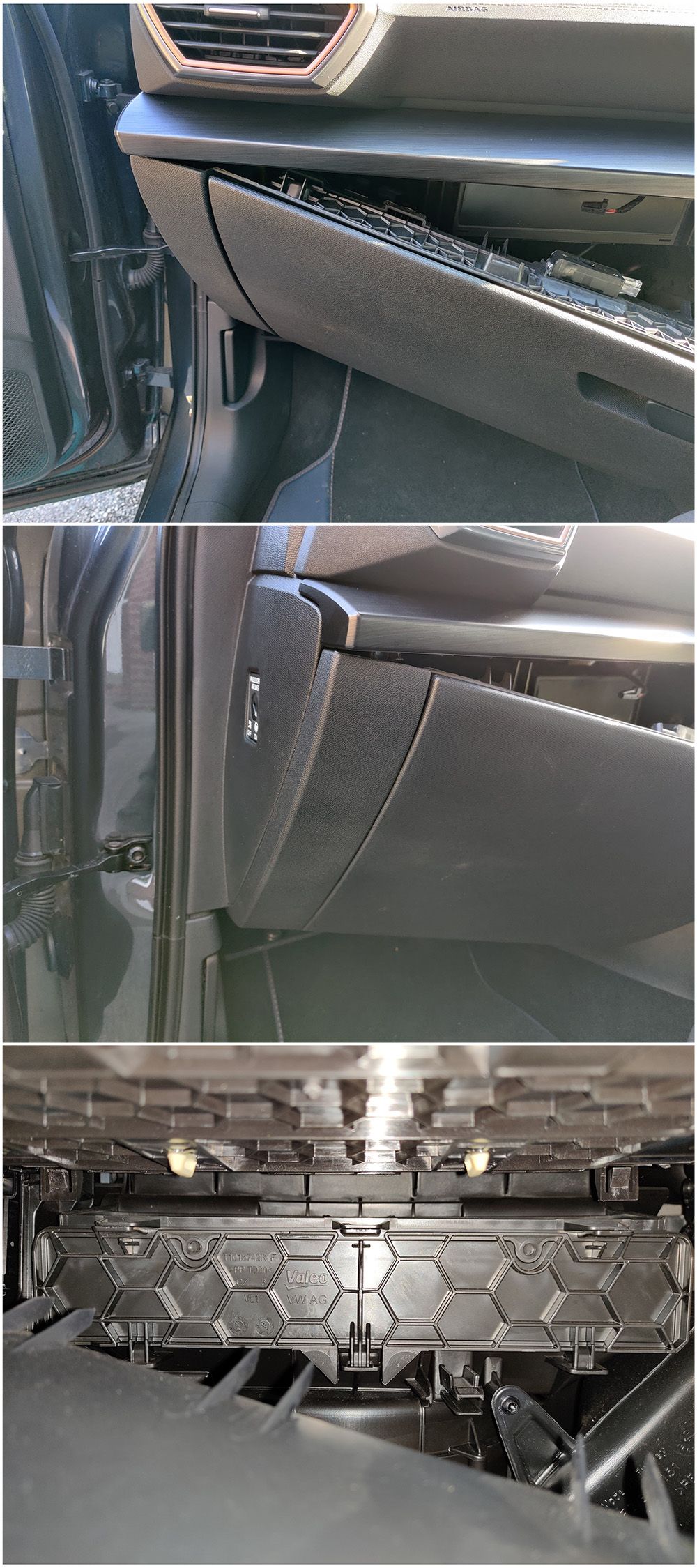

This is my 2nd attempt at servicing the pollen / cabin air filter on a UK Cupra Formentor.
Never have I had such trouble in all my cars, it gets worse every generation. I even purchased a quality stubby Torx 20 so I could get in without any witness marks but I'm stuck with the trim now.
Step 1. Remove engine :rolleyes:
It may be possible to extract the air filter while bending the glovebox out of the way. But there is barely enough space to squeeze 1 hand in there - the filter would need to be bent through the tight space - which is why I would prefer to get the glovebox out of the way.
However from looking at salvage parts I believe there is another clip holding the glovebox on which is underneath the side trim (behind the airbag deactivation switch).
The side trim sits underneath the door seal, which means prizing the rubber seal off partially, then prizing off the side trim, somehow without breaking anything.
I deemed risk of damage too high, so I aborted. I don't have good trim tools to proceed safely.
Posting here anyway as I have no plans to progress. But so far, the uprated filter I want to fit and tools I purchased are a waste of money. The filter in there should be 3 years old at this point. It's a shame what modern cars have become.

Good effort so far, looks like a small child could get an arm in there no problem, recruit a local 10 year old - that must be what the main dealers do!!
Good post/photos!
I checked my Cupra 310 V2 (2023) to see what access there is to the cabin filter and see if it’s the same as yours -it is! What a ridiculous place to put a filter! I had a BMW before this Cupra and it was very straightforward to change under the bonnet.
There must be an easy way to remove that side panel and release the left hand side of the glovebox but it’s not obvious. You mentioned a clip near the air bag, so it’s going to be case of working out how it releases from this clip without causing any damage. I will have another go at some point as I have all the tools to hand.
If I figure it out, I will post back with some photos as it may help others who have this newer style of filter housing.

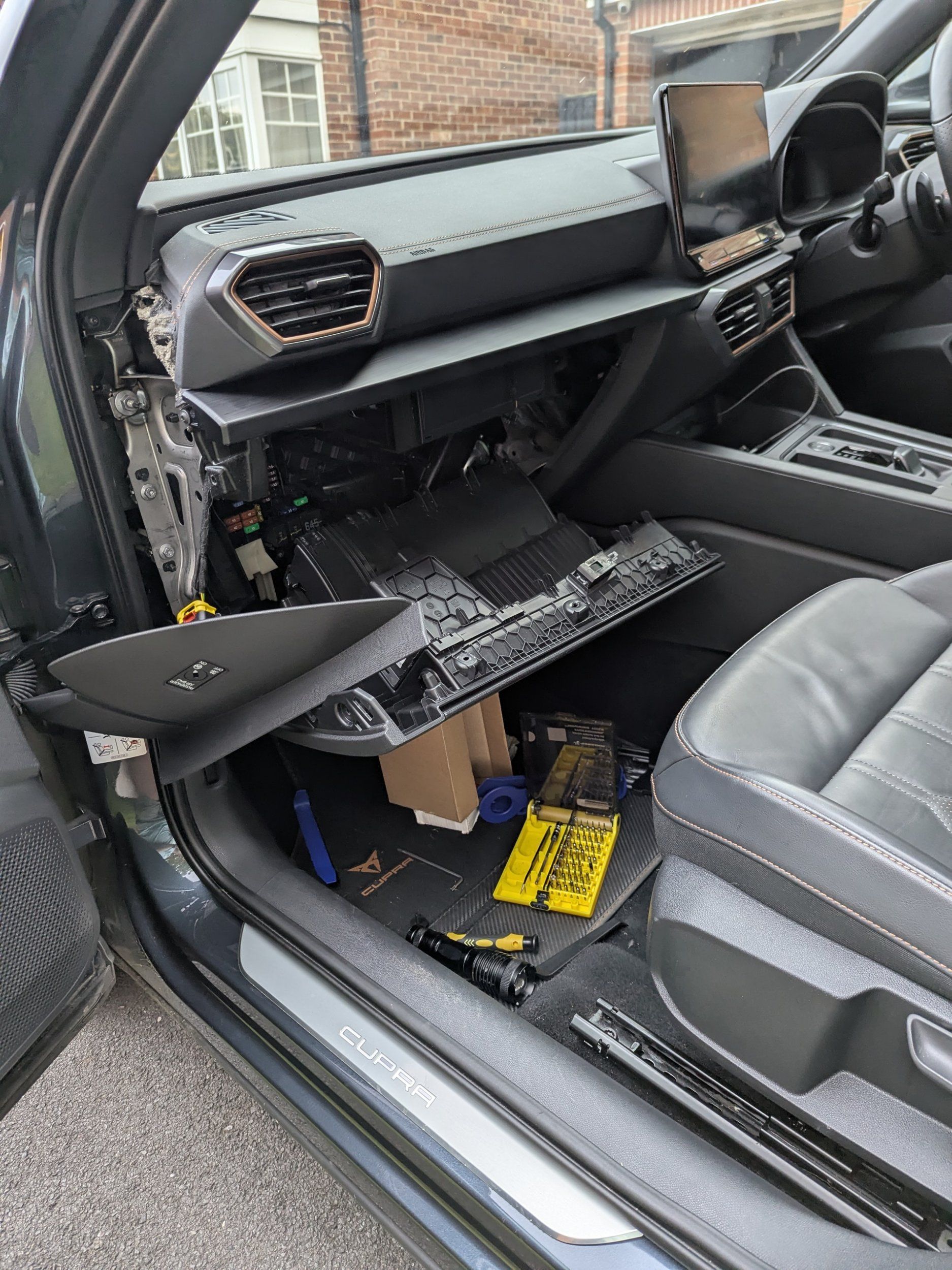

The side panel can be removed easily with a plastic trim tool, if you pry gently from the part nearest the glove box door it comes out easily. I found the airbag cable did not need to be unplugged and it didn't get in the way too much. It was also easy to put back in by pushing the trim piece behind the door rubber first. The instructions here were perfect - https://www.seatcupra.net/forums/threads/pollen-filter.465807/
I have a 2021 model and the filter was desperately in need of changing after taking it out.
Andy, thanks for the follow up post, some really useful tips in there and the link you provided is excellent. This encourages me to take another look, as I would really like to check that the air filter was actually changed on my last service and for changing it myself in future.

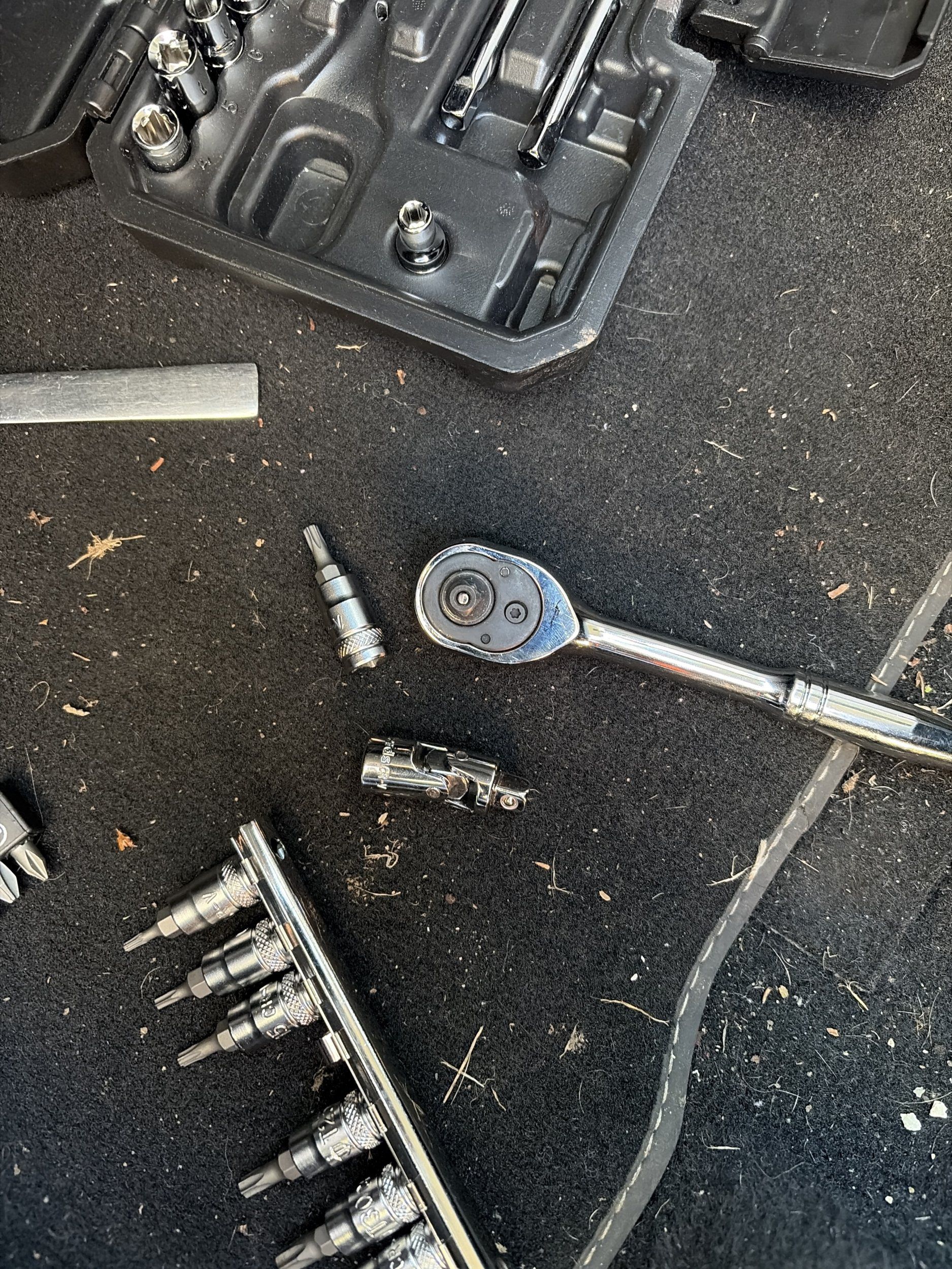

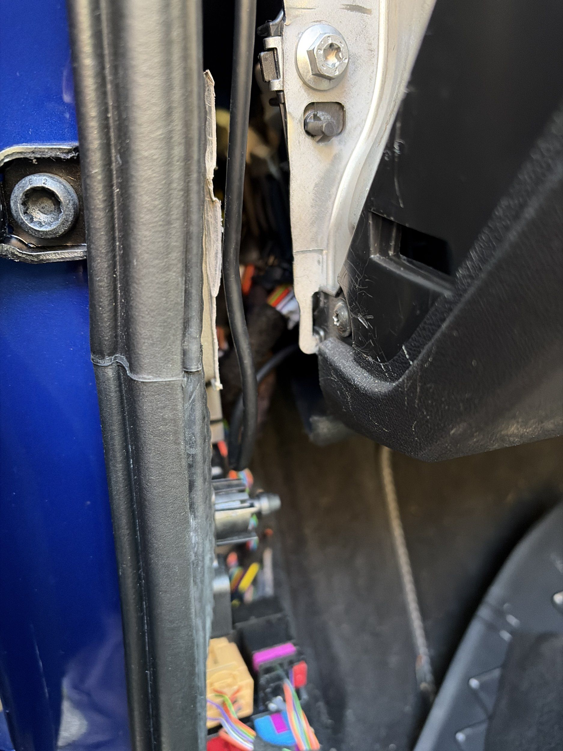

Managed to take of the plastic trim on the side to have a bigger gap for my T20 but the gap is still to small is their anywhere I can get a smaller bit T20?
Could you clamp your T20 bit into a pair of molegrips and use the grips as the handle/lever?
