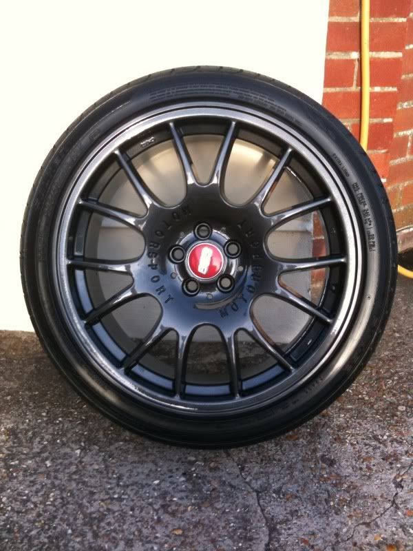

I've had a set powder coated by The Wheel Specialist.
Personally I thought that the finish was superb I think in terms of durability the powder coat seems to resist stone chips better because it's softer it just makes a little mark rather than chips off, these were my old wheels I had done so you can get an idea finish is really glossy.

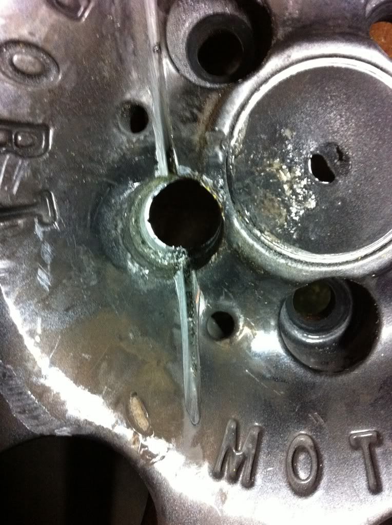

Now the bad bit...... Now why is still a mystery but I think the powder coat had something to do with it, I had a slight bump to this wheel in the snow I tried removing it and the locking nut despite being torqued correctly had welded itself the the wheel lug seat we tried everything for 4 hours, it would not budge, the wheel was gash and bent anyway, the culprit I think is powdercoat in the lug holes, I've read also with powder coated wheels and track days wheel nuts can work loose, how true this is I'm not sure? We had to hole saw around the nut and remove the nut after that to get the wheel off!! Not exactly great, trust me I did everything to avoid this I don't give up easily!!
Yuk
As you can see, tried blow torch, cutting a groove in the bolt head, wanging a socket on, specialist nut removal tools! Nada would not move!
So I'm never going power coat again!
