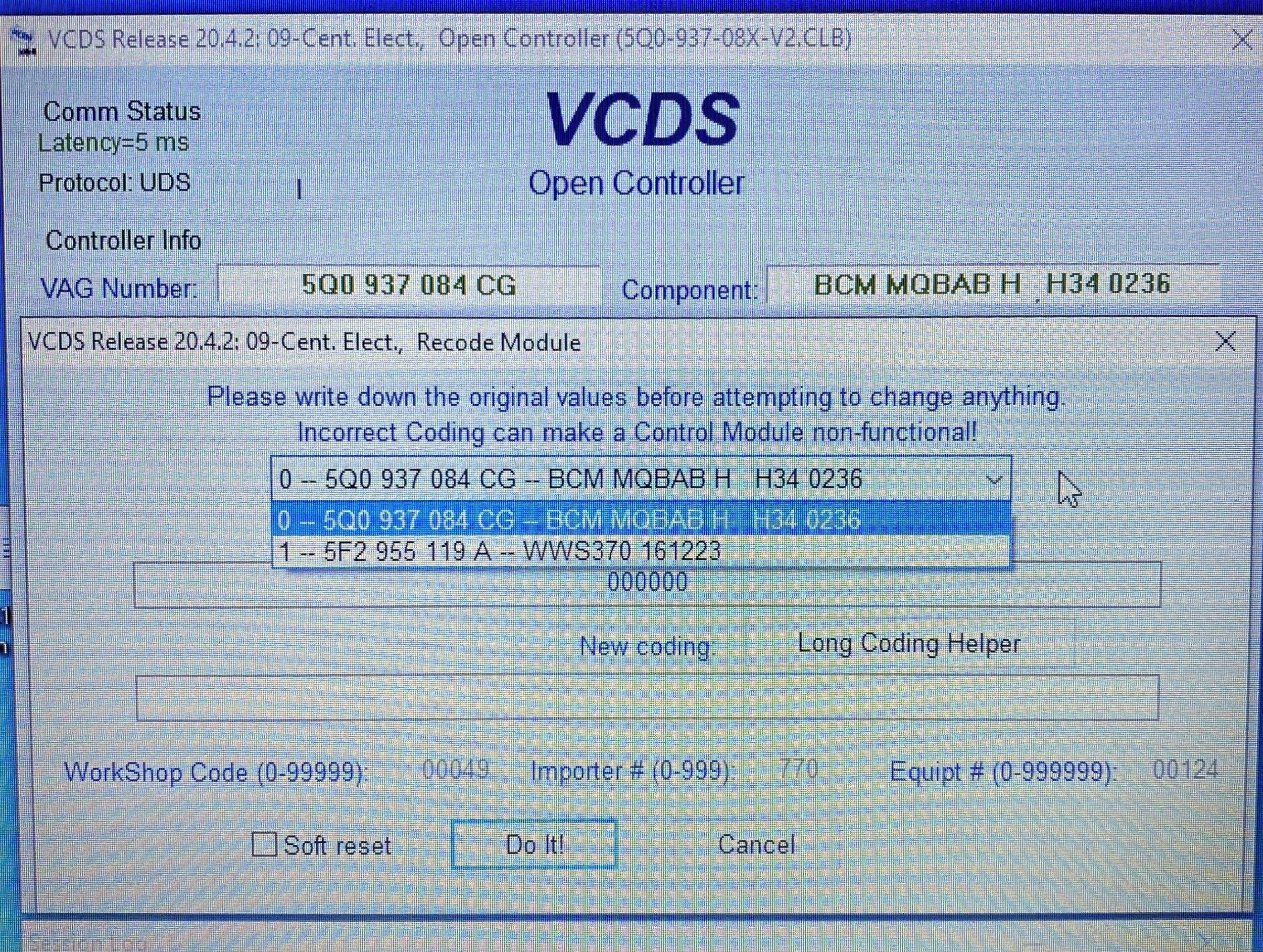

VCDS Coding
you need the RLHS sensor to show in the drop down as below:
if its not there, this is how to enable it.

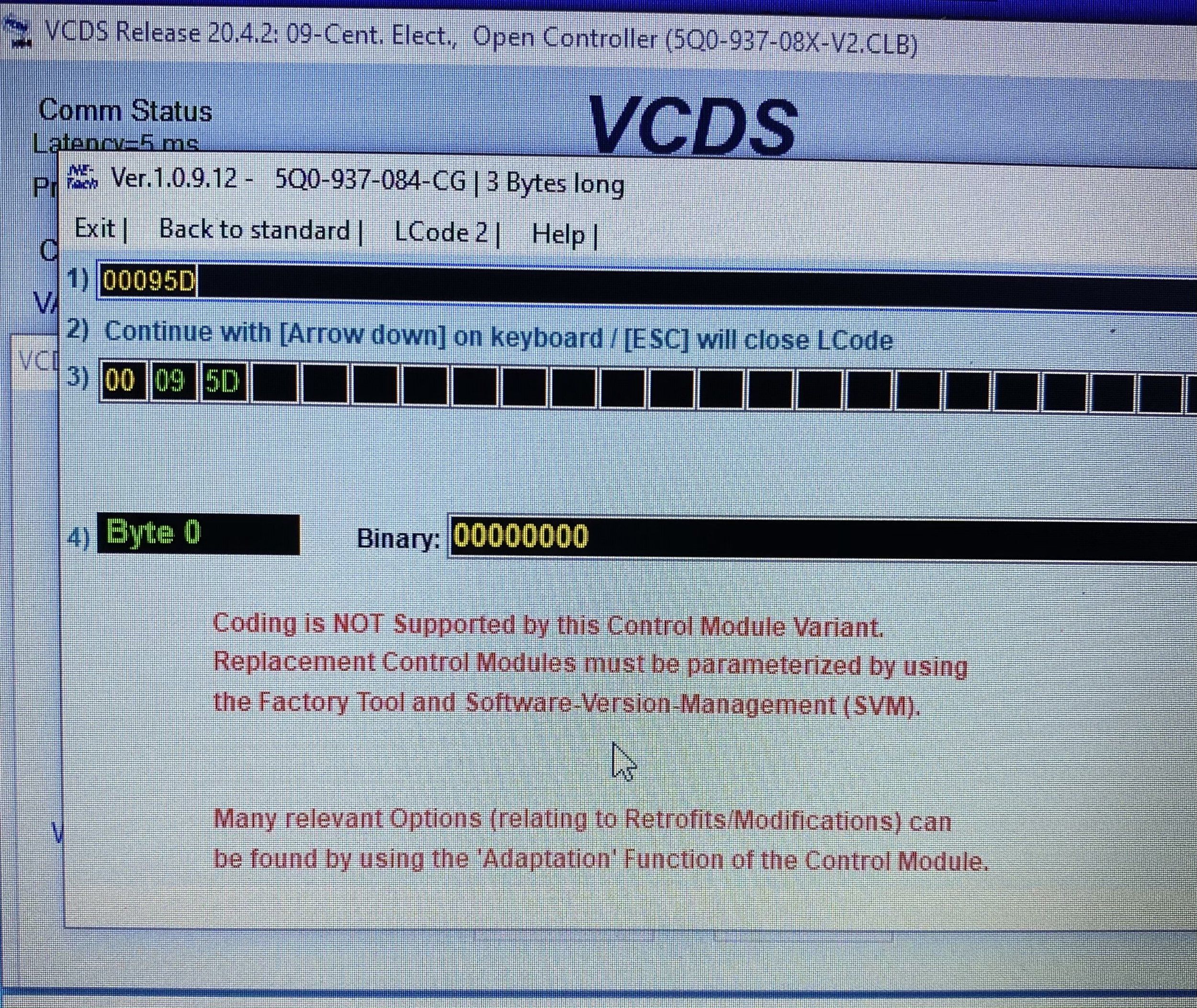

Hi,
Thanks for the great guide! After going through the hardware steps, I plugged in VCDS and was ready to add the coding onto the new sensor as per your guide. I will add some pictures to show the modules listed in the Centr. Elect. However, as you can see from the pictures there is a slight variance between my module (5Q0 937 084 CG) and your module from the pictures within your guide (5Q0 937 084 AJ).
(PICTURE)
After some digging, I found that I have installed the wrong RHLS. I have installed a (5Q0 955 547 C) and not a (5Q0 955 547 A) as per your guide. A small mistake but I assume this is why the module codes are wrong. I have tried the code the wrong module (5Q0 937 084 CG) as per your guide however, I receive this error message
  • Coding is NOT supported by this control module Variant.
  • Replacement Control Modules must be parameterized by using
  • be found by using the ‘Adaptation’ Function of the Control Module.
(PICTURE)
I believe I may have to change the sensor to (5Q0 937 084 AJ). However, I was wondering if you would know any work around’s or possible ways, I could still use the current sensor installed?
Thanks,

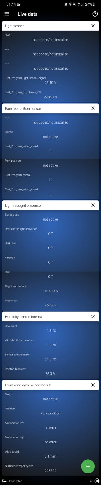

Yesterday i changed the adaptation of the sunlight sensor from deactivated to activated. The fault was still there. I changed it again to deactivated.
Today my auto rain sensor, doesn't work properly.
