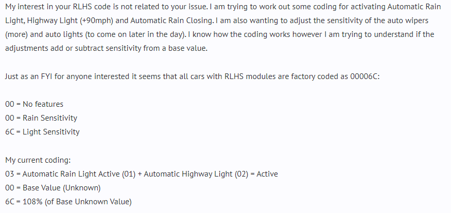

Hi all,
I'm new here because I have searched hi and low to find an answer to this.
Does anybody know what the bytes mean in the light/rain sensor ? In the first post they are speaking about 00095D. My car has 0018DD.
In some other thread I found (vcds), someone said :
Is this true ? Can someone confirm this ?
