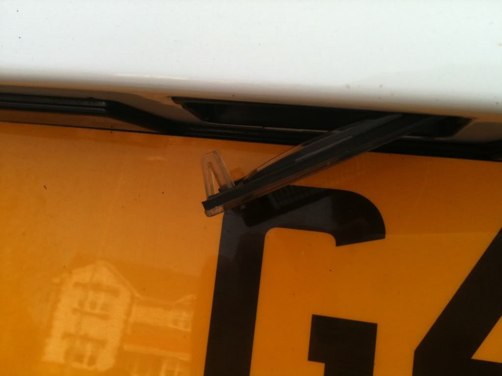

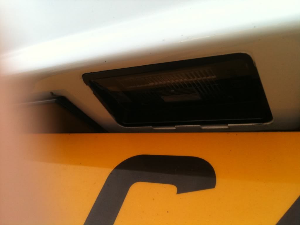

Went out and took a couple of pictures for you. Just on my phone so there're not great.
There should be a black surround and then a clear plastic cover. You shouldn't be near the paintwork because of the black surround.
This was the passenger side one and the catch thing is on the left. I used a breadknife to open the catch. It's just sort of like the battery cover on a tv remote.
Once unclipped it should come down easy
This is the cover off
If you just have a look up at it you should see it all.
Hope that helps.

After much concentration and determination I finally did it! The clips were really dug into the black plastic cover, thats why I couldnt see it, it was just a gap for me. I had to angle my head in such a funny way to see what was going on!
Thanks for your time and taking pictures!
