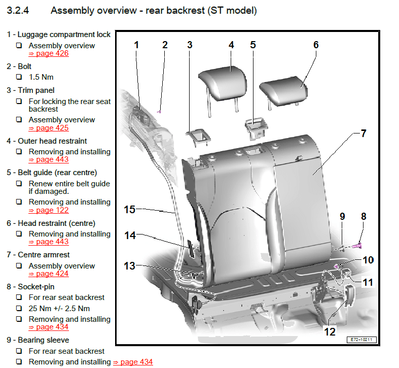

I was expecting to see a spring somewhere - but there is nothing noted in the assembly overview - so maybe it is within the hinge or somewhere in the bowden cable/lock number 15 & 1?

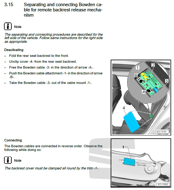

I've had a look in the bowden access port on the side of the seat (14) and the cable appears to be actuating correctly, and if you take the cable out and pull the actual mechanism it releases correctly, but I cant see that it's attached to a spring.

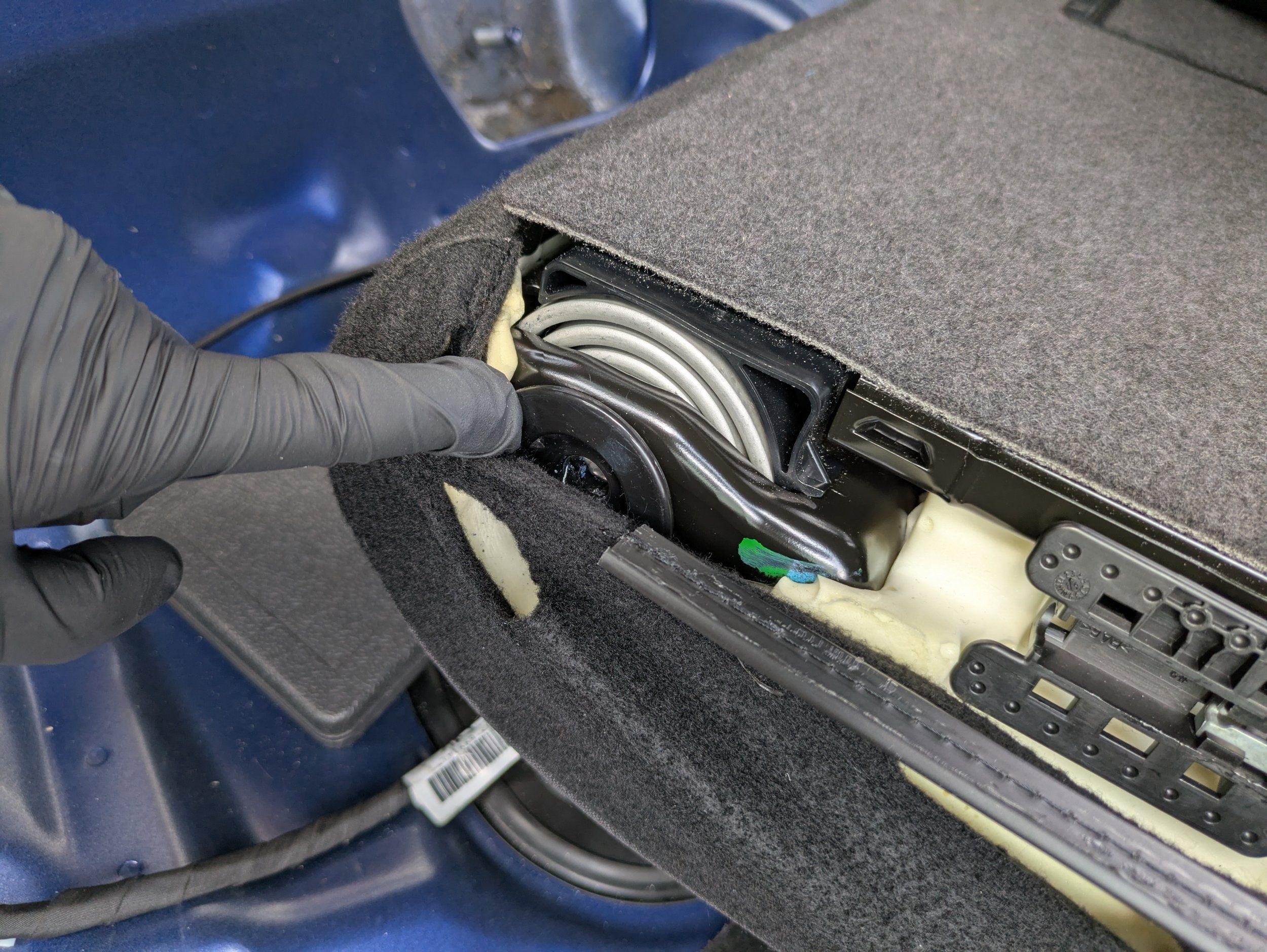

I've had my rear seats off recently to swap them. I have an st but swapped the seats to ones from a hatch. Unfortunately the spring mechanism is built in to the frame of the seat, wrapped around the hinge point. Maybe if you take the seats out and spray some wd40 in to the spring, or at least inspect. If the spring is somehow broken I don't know how you'd replace it...would probably need to do the entire seat itself.

Thanks for that Frostybear, that's incredibly helpful! I can only assume the spring has become detached from where its anchored has gotten bunched up and is now giving more tension than it should. Looking at the picture it doesn't look like the attachment point is easily accessible, unless you can see it if you pull the fabric in that picture down? If its totally accessible, and the spring only helps to lift the seat back into position, I'm tempted to take a dremel to it and just remove the spring....unless this would somehow make the seat unsafe / invalidate insurance?!
I took the picture a while ago...but I remember it being very difficult to get at. I'll be able to have another look for you tomorrow evening!
If you do remove it, you only lose the seats folding down automatically when you pull the release handle in the boot or on the seat itself. My seats don't have the spring because they're from a hatchback, I just give them a little push from the boot and gravity does its thing.

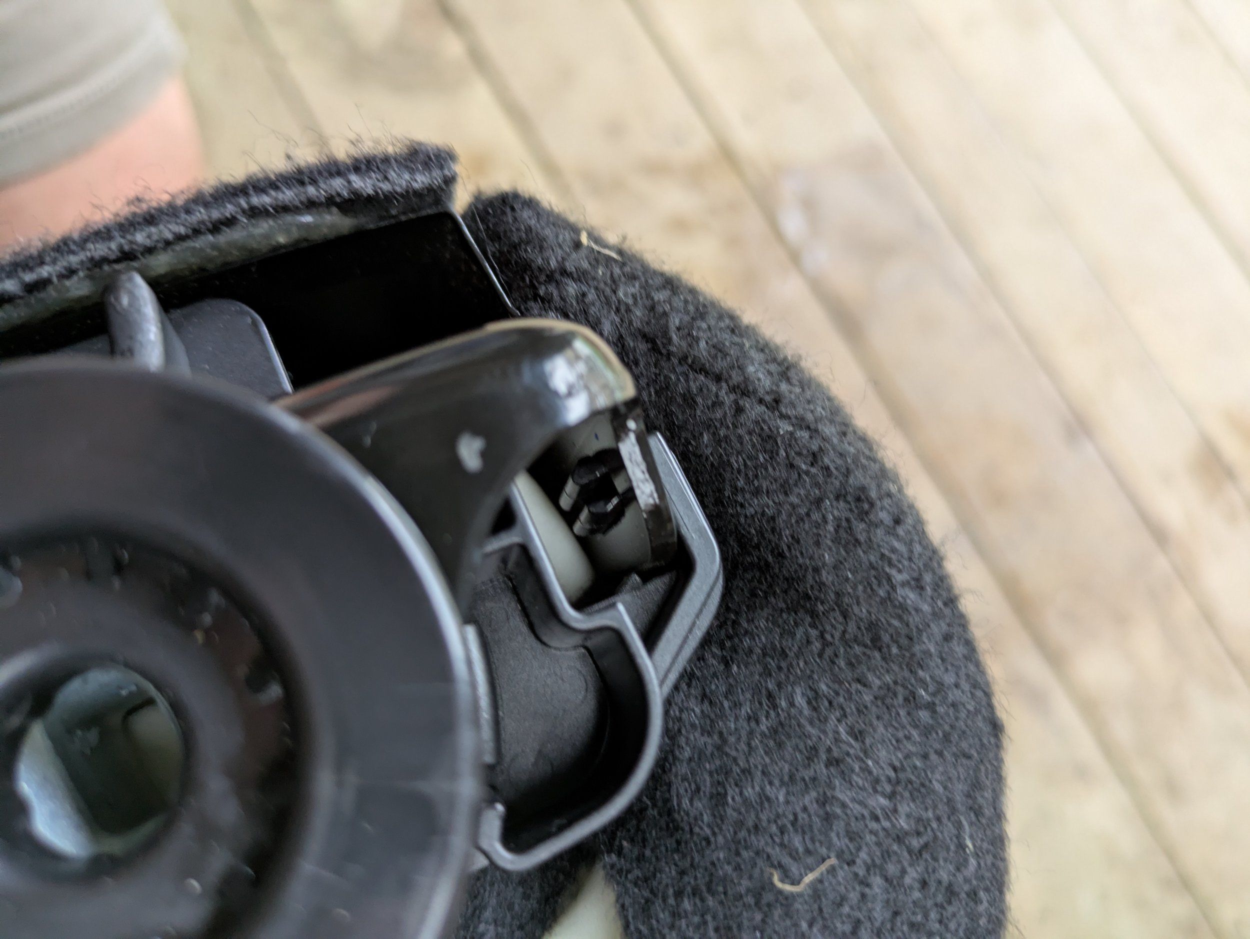

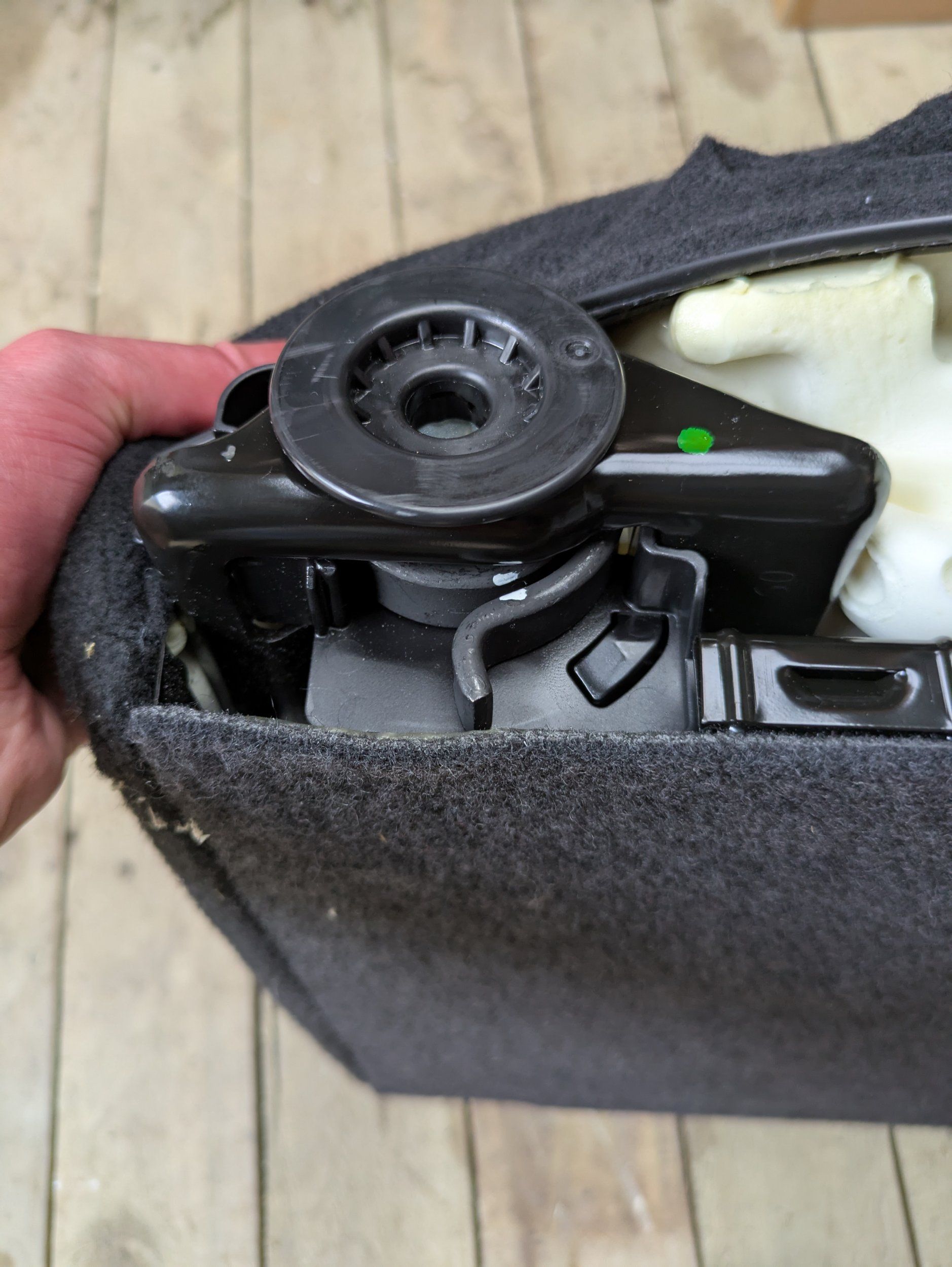

So, I actually spoke too soon. I believe you can remove the spring and mechanism! Hard to see in those pictures but it's just a plastic bracket holding the spring, the bracket is clipped in to the metal frame of the seat.

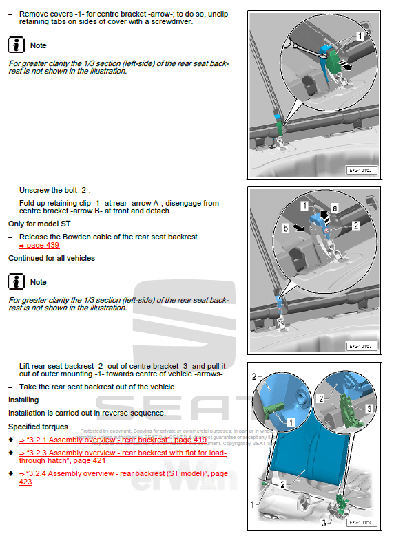

Rear seats are actually ok to take out, think there's a guide somewhere and also SuperV8s pictures above. Amazingly I found the hardest part was finding the angle that the seat slides out (seats forward at about 45 degrees)
Rear seats are, as said, very easy to take out. I bought an half leather half alcantara interior out of an FR hatch a few years ago, and this has been in both my old SE Tech hatch, which was a direct swap for swap, and currently in my ST. Once the seat squab is lifted out from the front and lifted out, you'll see a plastic cover that goes over the single bolt holding the complete backrest in place. Flip this cover off, remove the bolt and simply lift the two seat back sections up and slightly forward off the mount. Pull each section slightly to the middle of the car to release the retaining pin from the outer edge and lift the seat out. If yours is an ST then the cable for the remote releases need to be disconnected.
