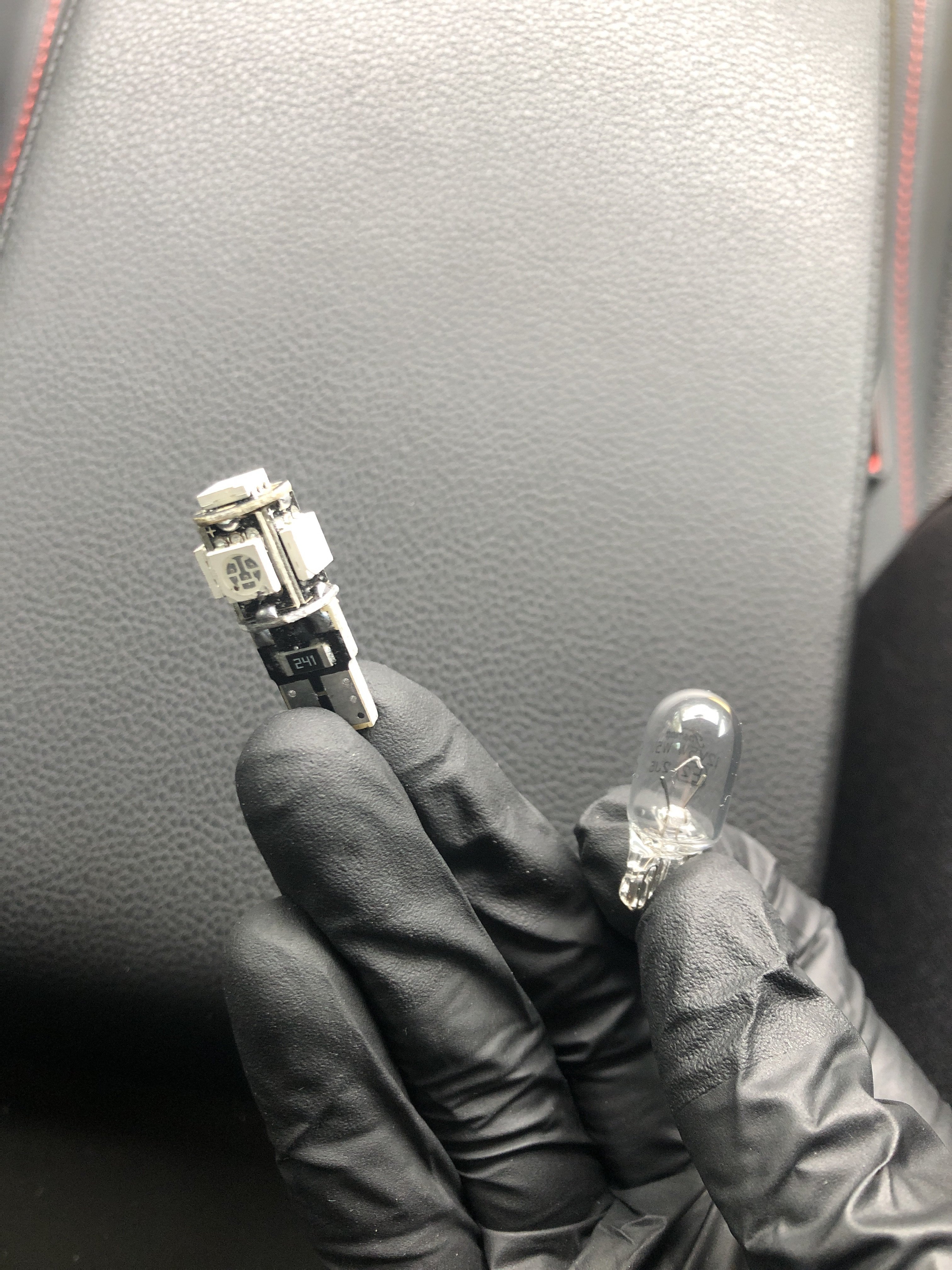

So my bulbs arrived.. they work in the above-head bit near rear view mirror, but they don’t work in the footwell??
Also one is flickering?
Why do they not work in the footwell? It’s the same LED’s. The fuse is still good because the original bulbs are working when I put them back in.

Some LEDs need the correct polarity to work - take the bulb out, rotate 180 degrees and place it back in the holder (you probably just fluked the correct polarity in the overhead console!). If flickering, it’s either a loose connection (slightly squeeze the metal connections together to clamp the bulb), or the LED is damaged.
I did try twisting them 180 but had the same results which i couldn't understand.
I will try and squeeze the contacts a bit and see if that helps.
Also tried a couple of them in each and same results.
Could be a coincidence i picked out some broken ones but i have 12 so i should hope at least 10 work!
Believe it or not there is actually two that don't work.
I've swapped some over that needed spinning 180 and now they work, however, with the ignition on but not started eventually they start to flicker. is this because they're using a lot of power?
Can the lights in the footwell be dimmed when the display is dimmed?
If so this will be the cause of the Issue, As a dimmer to dim standard filament of a bulb it send an on/off pulse to the bulb this will cause it to be on off on off at a rate faster than the human eye that it just doesnt get as bright, but with LED's as they are instant on/off then the dim feature will not work unless they are designed for a dimmer and have the components required to regulate the power to the LED's to adjust the brightness,
As we all know LED brightness is dependant on amount of power into the LED, sometimes a resistor is all thats required to get around the power flux,
But as you mentioned the more you add the more likely they are to flicker, lets not forget the power distribution is configured for standard bulbs not LED bulbs. I have a ceiling light at home that has 5 small G4 bulbs and i replaced 4 to LED and had to leave 1 halogen bulb in otherwise i got the flickering, and that one bulb is what helps to regulate the power to the others to prevent the flickering.
Please correct me on any mistakes i may have made.
Yes i'm pretty sure they dim and then turn off when doors open and close, same as the above head ones. I can probably look through the menu to turn that off, if not i'll buy some halogen ones :thumbd:
