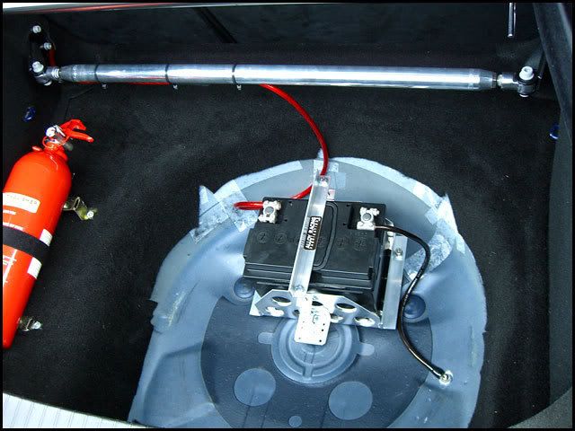

Well it's done! I relocated my battery to the boot, wasn't a very difficult job really. I have a small Enersys Odyssey PC680 which I will try soon, but for now the standard battery is in there, works as normal and fires up no problem.
http://www.active-robots.com/products/power-supplies/odyssey-batteries.shtml
I ran 4-gauge power wire through the car behind the sill trim from bay to boot, only 3 trim panels to remove. Drilled 3 holes in the boot (checked underneath first!), one for an earth point and 2 for securing the tray, the 3rd tray bolt went into the spare wheel bolt hole and through a sturdy bracket, feels solid enough. Once bolted in I treated all holes and bolts under the car with underseal to prevent any water ingress and corrosion.
http://i112.photobucket.com/albums/n191/robd67/battrel1.jpg
Once old factory tray was out I chopped the negative terminal off and fitted an 'O' connector then bolted it to the chassis. I used a wire brush attachment on the drill to take the metal back to bare on both the chassis holes to ensure a good signal, then smeared underseal on the bolt to seal it up.
http://i112.photobucket.com/albums/n191/robd67/battrel2.jpg
I will convert the + leads in the engine bay into a distribution block once it arrives, but they are taped up for now. Overall a pretty easy job really, I will sort the boot carpet out soon so it looks alot nicer with carpet round the tray etc.

looks good rob so all the original + wires are chop blocked together then the new wire run to that? im just asking as im not sure about all them that are on top of the battery?

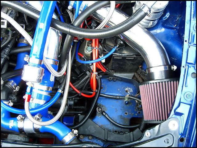

Yep, only one wire runs to the power pack that sits on top of the battery, I extended it so I could tuck it away. So all there is to connect is the main battery cable, the one from the pack and the new one from the boot. The main negative terminal is now bolted to the chassis on a new ring connector.
I used 4-AWG audio power cable for both + and -, I got a kit off ebay for £15 which had 5m of power and 1m of negative 4-gauge cable.
