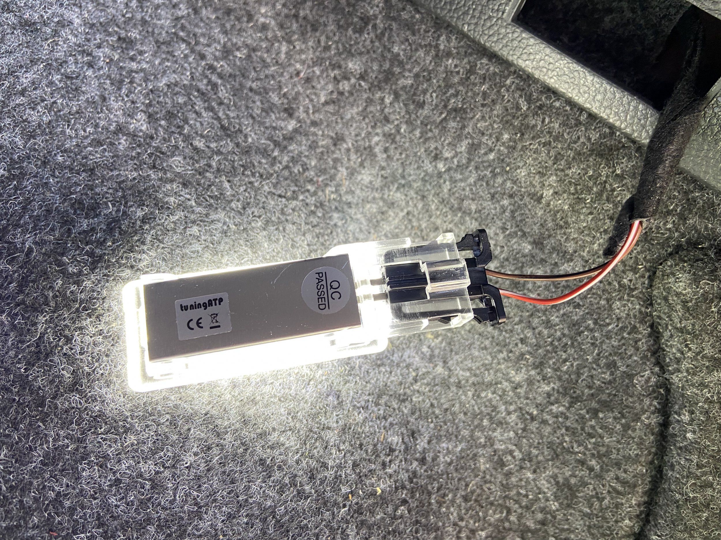

There is a chance it's the same unit. @Bedlam upgraded their Ateca one to a four LED unit. Just dont loose the lead inside the body when you pull it out. I recall I just used a screwdriver to pull it forward for the picture. That is the service point to get at it so the lead shouldn't fall off since its clipped to it.
I believe the company Bedlam recommends had the units fabricated to the standard (they say that), but I might have got the wrong end of the stick. You might need to take the housing apart and put the unit in that or it comes in its own housing. Bedlam would know since he replaced his. Worth extracting out of the panel, checking the serial number printed on it and taking a possible punt if it's the same. 4 LED unit Bedlam recommends if that's the case.

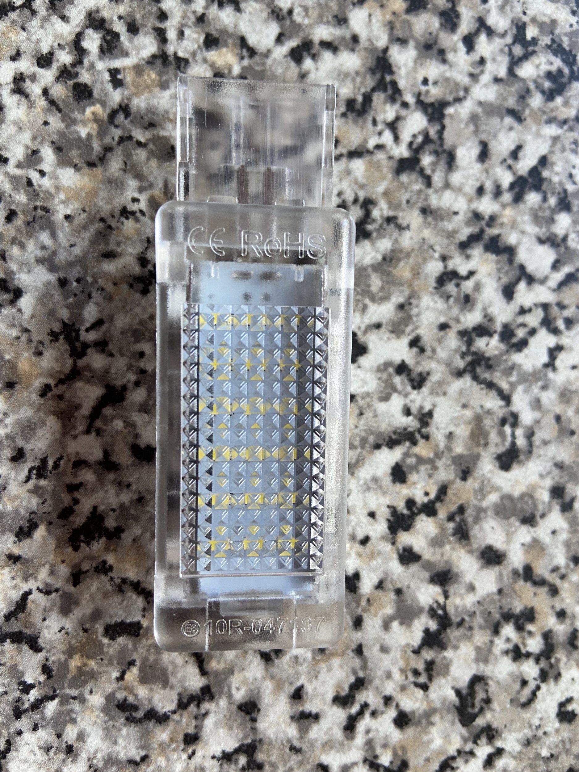

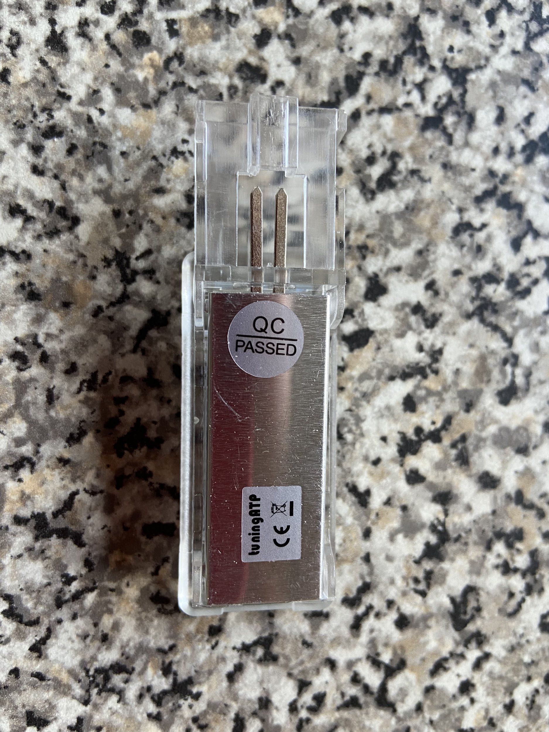

I see 18 of those light emitting diode pads so it should be bright. The printing on the plastic cover suggests equivalent to 20w. I guess the normal bulb is equivalent to 5w. Might have to revisit my Ateca boot bulb project. Think they are interchangeable. Good find.

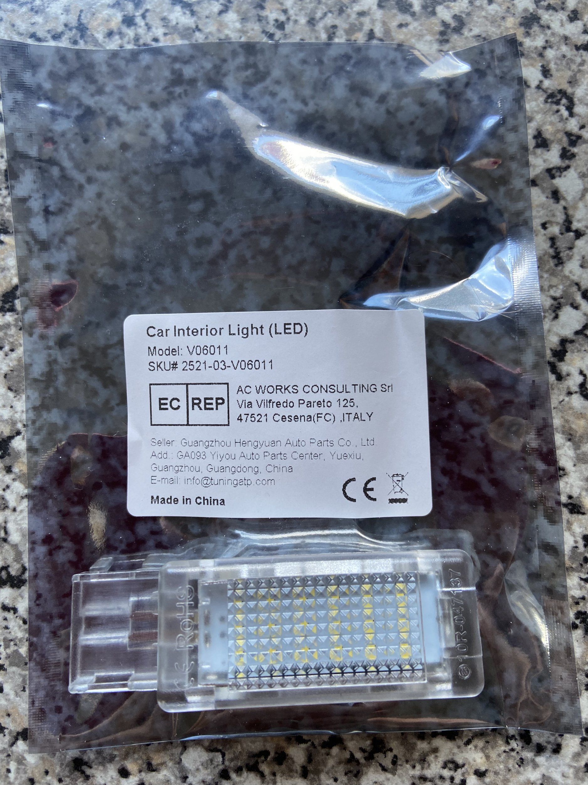

I'm sure that was a Dutch site for the device. All hail the Chinese communist party... just have to check whether they are a sponsor of the board ?.
Didn't get my discount but wasn't a new Aliexpress member. They already know everything about me since I use ES Explorer.... modded and not modded.

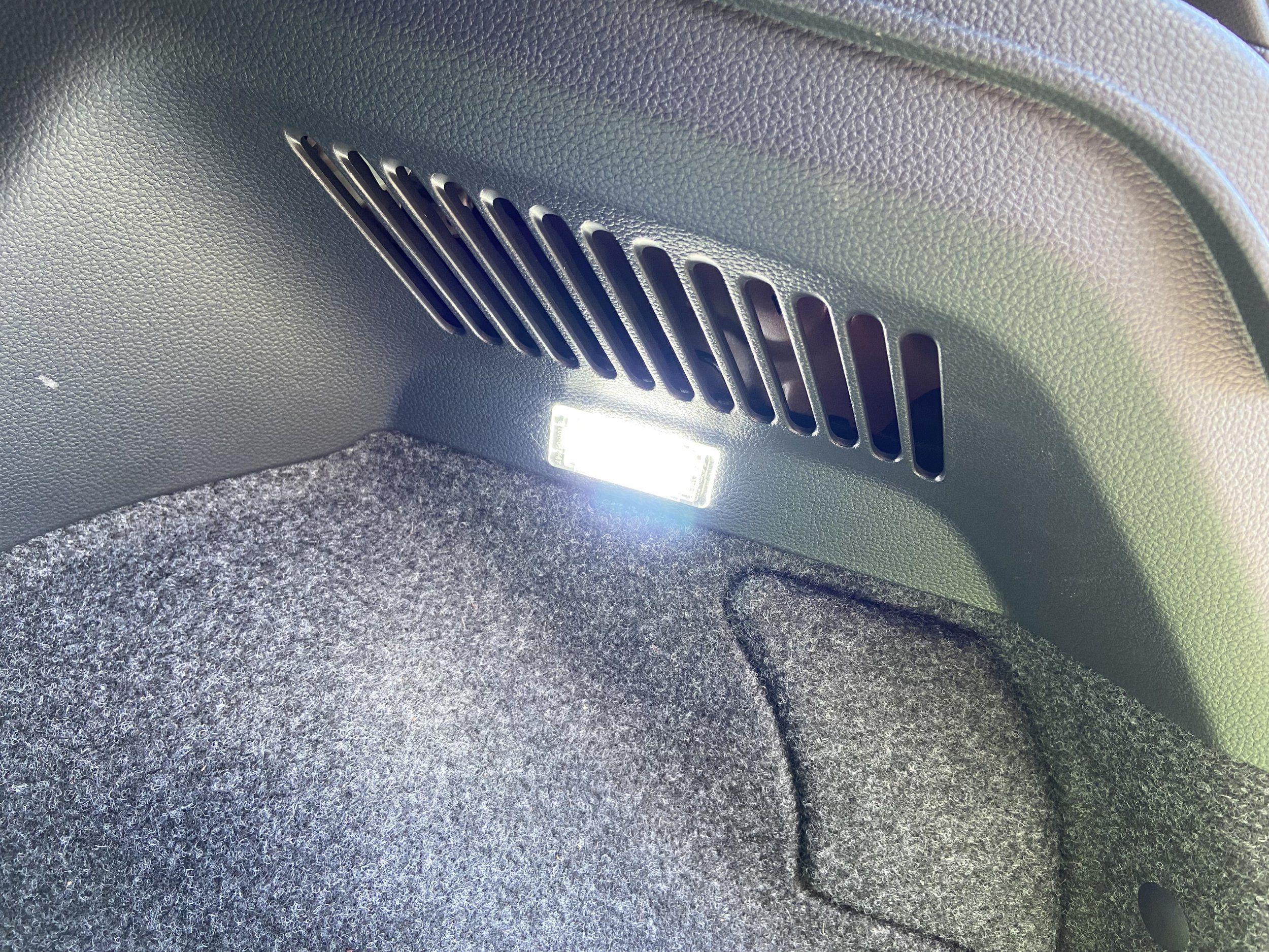

I'm sure the LEDs will be fine the rear indicators and high intensity reversing lights work fine after 4 years.... all that rare earth they buy from Australia and Africa ?.

I've got two on the way but a day or so later than yours I guess. I took your cue. I didn't fancy the solution that Bedlam had which was opening up and putting in that circuit board.
Those light pads are SMBs. The more the merrier.
SMD stands for Surface Mounted Devices, a special type of high power LED lights. With no wires, these devices provide less fuss and with seamless application. Instead, SMDs have tiny metallic contacts that can be directly soldered to circuit boards.
Think I'll take a clothes peg out when I fit them just to hold the cable so it doesn't drop down the back whilst the light is off. A person with a demo Ateca Cupra has a light with no cable... Think we can guess where that is.
