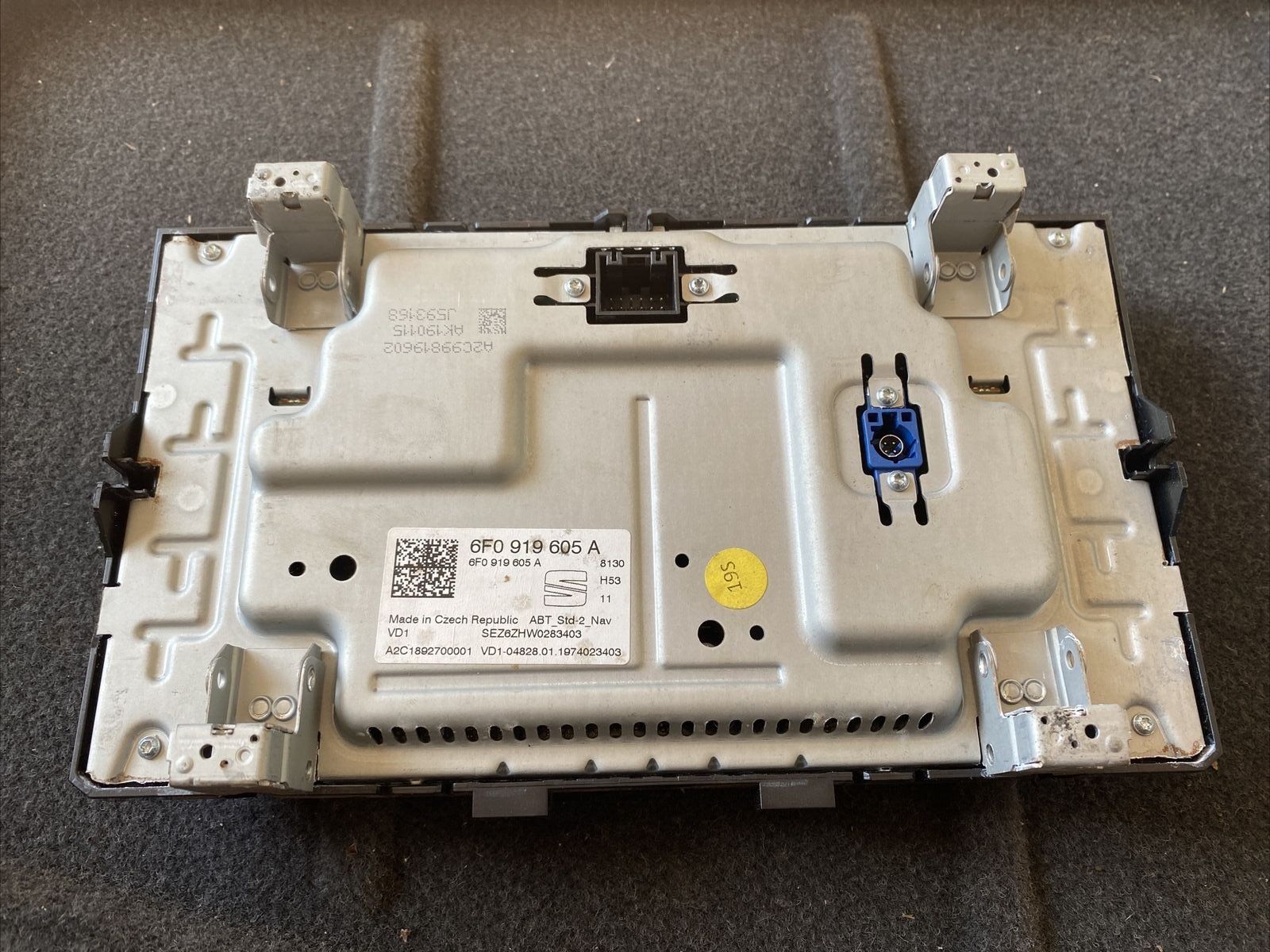

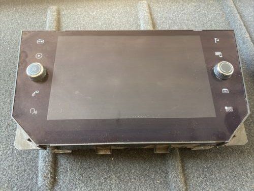

SatNav Media System (6F0919605A) pic:

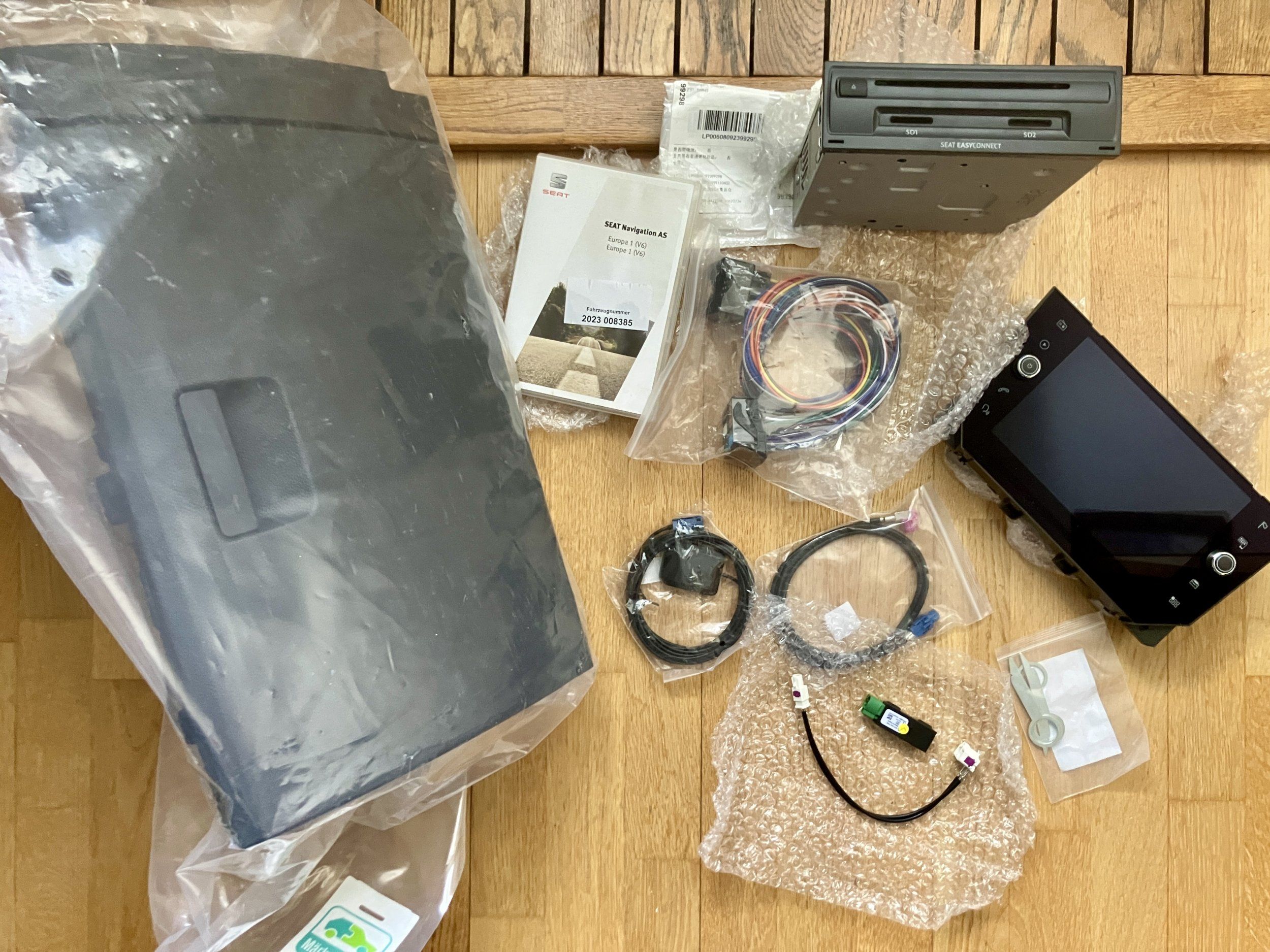

I bought everything needed for this project for my Ibiza and then switched to a León before I found time to do attempt the switch. So, i have everything here that I don't need anymore, it is ready to post to someone if they give me a reasonable offer for it.
How much do you want for this ?
Ok, again some questions:)
- are you prepared to send it to the Netherlands
- do you have some pictures from the set
- are you convinced that it works
