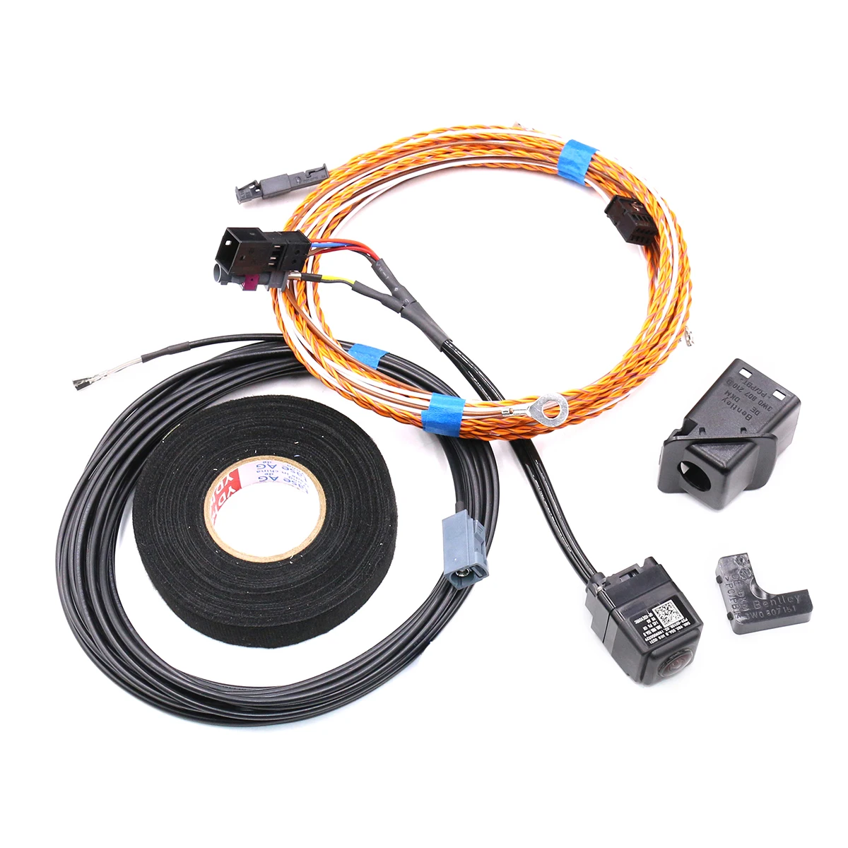

Why don't you get the oem camera for the same money? This kit is all you need.
https://www.aliexpress.com/item/400...68#1000022185#1000066056#0_668#3422#15392#547
I saw a lot of variants:
1. this one mentioned by you which according me is connected to 6 a 12pin (video signal) and another wires are data CAN, which can be identified by system without Fault codes in obd diagnostics
2. only CCD camera connected to 6 a 12pin - probably errors in obd? for eg.
3. additional INTERFACE UNIT A)
https://www.car-interface.com/vendi...hstandard-reverse-camera-input-interface.html
it looks like it adds CAN wires and CAN identification of camera (generic values?)
4. additional INTERFACE UNIT B)
it is using LVDS cable so it servers like convertor for LCD screen directly or what?
Can anybody explain this problematic? dont know which works fine, or if it is sufficient to only feed camera to 6 a 12pin and it will work on my Leon 2015 MHI2 Navi Plus, HDD, GPS, front and rear parking sensors. Thanks

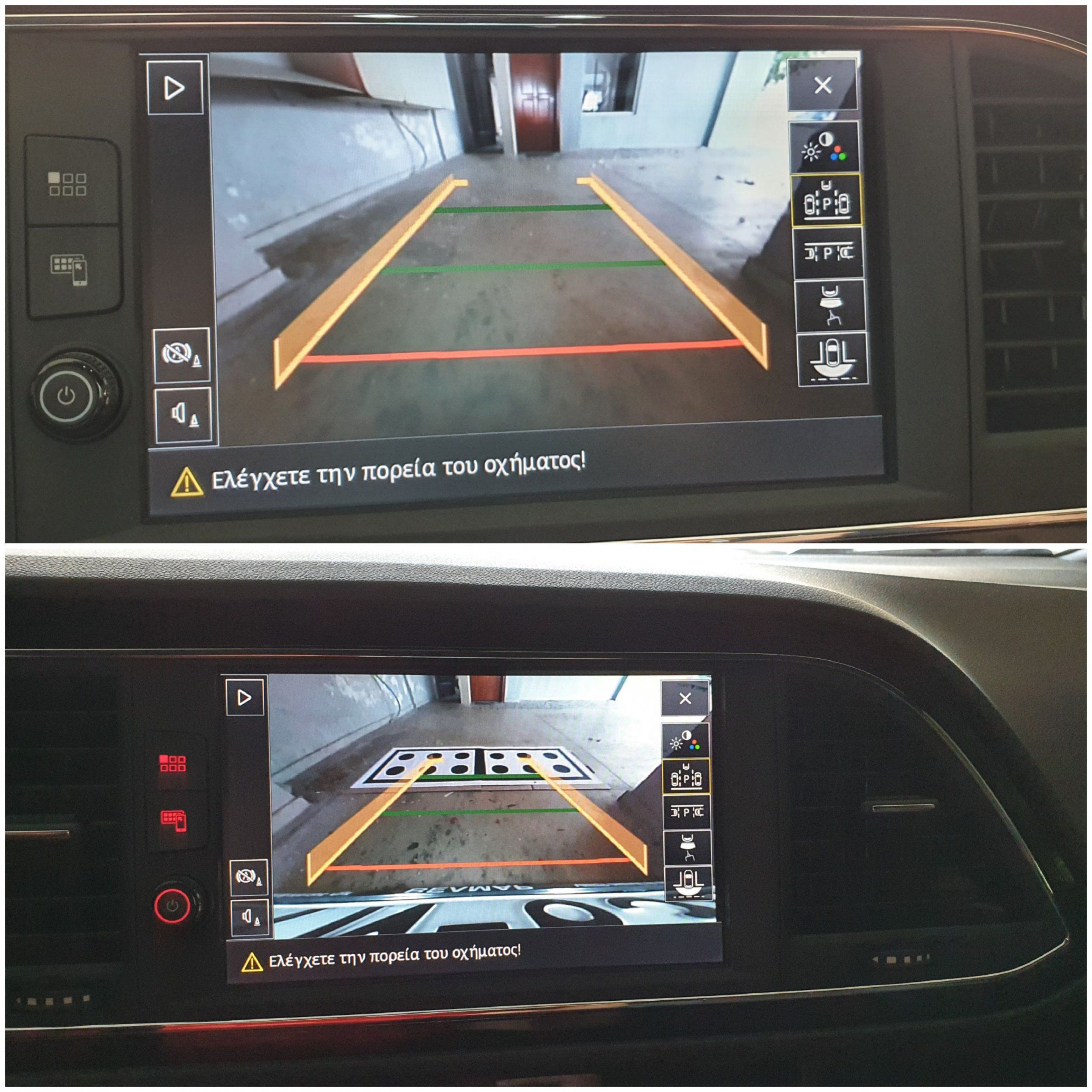

Unfortunately not. You could ask the seller if they can at least upload the Octavia parameters for you. If the camera comes with no parameters at all then it will point very low and you will lose a lot of what it can show. I could show you a picture of the camera with and without parameters...it's day and night.
Calibration is the least of your problems as it will never be 100% right since this camera was never offered for the Leon.
For example this is a camera with no parameters. Look how low it points. 1/3 of your screen displays your license plate.
cam1-jpg.8417

ok so I think you forgot to attach picture when it is parametrized, in order to compare to non-parametrized camera... isnt it ?

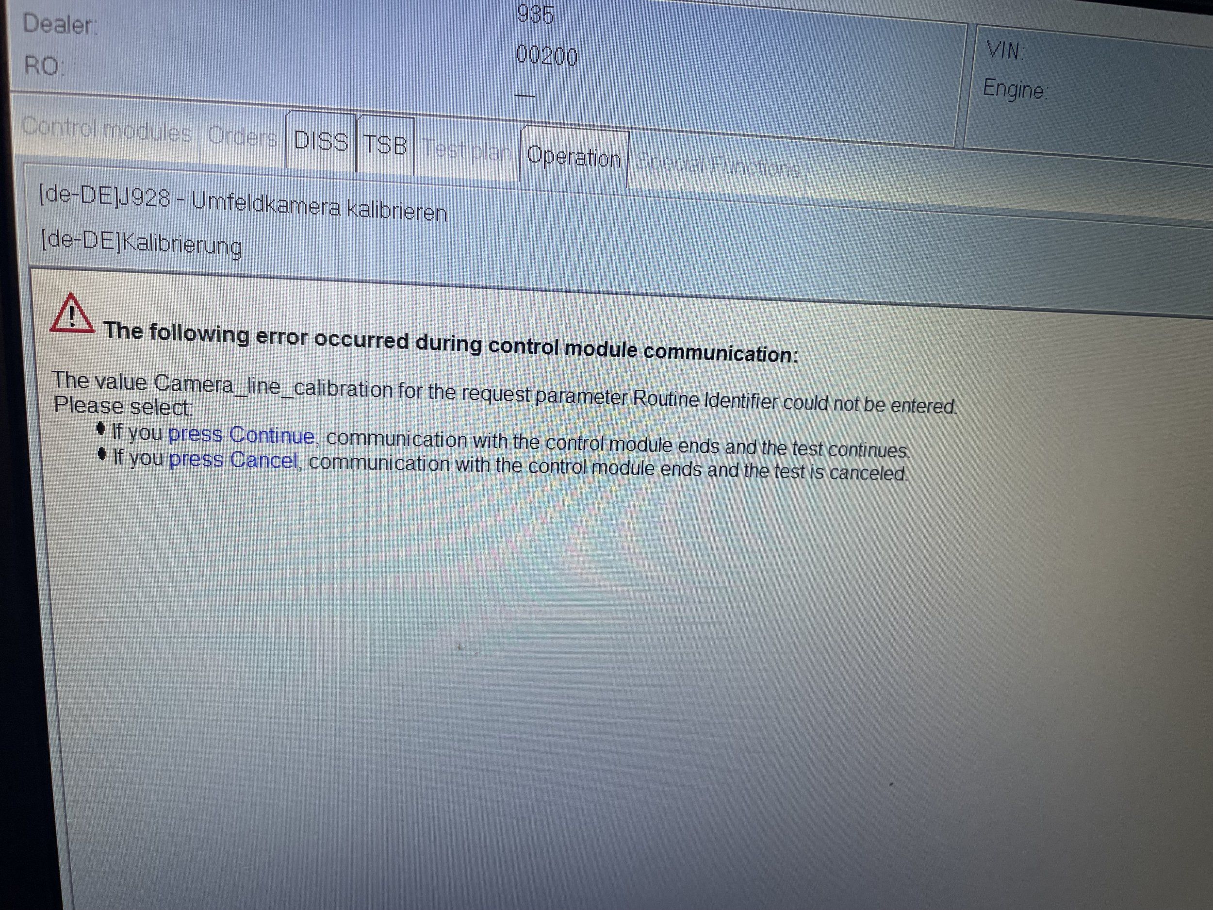

Tried doing a calibration with the domino pattern and measured distances between the axles and the board, and from camera to axles, but the camera refuses to calibrate.
