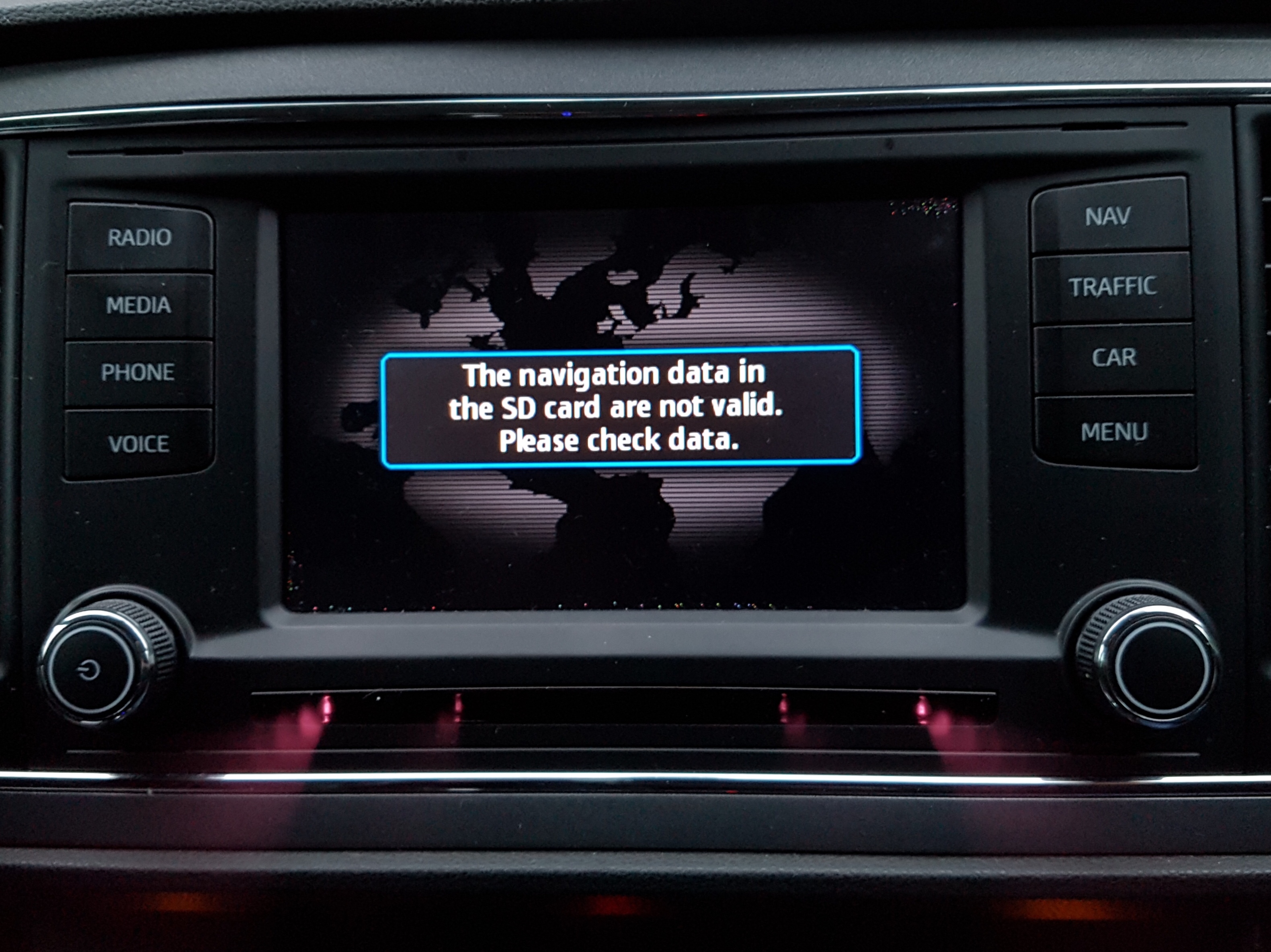

Hopefully that works out better for you than when I tried to install my new SD card earlier this year, only to be confronted with this error message...
View attachment 10337 View attachment 10338
https://forums.seatcupra.net/index.php?threads/navigation-system-updates.388586/page-71#post-4819375
Perhaps the dealers don't know themselves refreshing myself on that thread link. I think as I said in 2016 further up why some people had success could have been they had bought of ebay self starter cards whilst other people bought the upgrade card which is based on having Mapcare for mib1 and doing a card swap rather than the download route. I did read of these two types of cards on a German board in my search for the software pack to get Mapcare on a mib2 Plus unit (That which would cost £600 abroad but not sold in the UK, opted for the retrofit firmware update for half the price). A period of heavy Googling.
If someone does achieve this without dealer activation, publishing the part number would be very useful for those that still have mib1... failing that I'll still keep saying it's a problem. Then they need to test it to see whether they then have unlimited update possibility which is what TomST supplier was saying which is navana.
