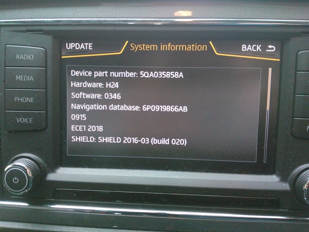

Stevan
Apr 8, 2017
96
6
Musselburgh
Sorry for being dumb! Would I be able to update mine then? What’s the diff between MIB 1 and MIB 2??
Yep MIB2. You can do the overall.nds hack to get latest (6 monthly) maps using the existing card.
First download the new maps from http://webspecial.volkswagen.de/maps/int/en/index.html, select Golf, then Golf from 2015, then Discover Media, scroll down a bit and download the map you need (for me Europe bundle 1).
Copy everything off your sdcard to your PC (backup, don't lose), hunt out and keep aside a separate copy of your overall.nds (\MAPS\EEC\EEC_WLD\OVERALL.NDS), quick format the sdcard, copy the new map files you downloaded (unzip them first, if Windows doesn't like .7z files try WinRAR, if you're apple then just stump up the cash for a card from the dealer (sorry, not sure what to use on a Mac for zipped files), then just drag and drop the 'MAPS' folder to the root of your blank sdcard), then overwrite \MAPS\EEC\EEC_WLD\OVERALL.NDS with the copy from your original copy of the card.
Full info in this thread:
https://forums.seatcupra.net/index.php?threads/navigation-system-updates.388586/
If you are feeling really brave, there's also a software update for that system 245->330->346. See:
https://forums.seatcupra.net/index.php?threads/sw-update-for-mib2-infotainment-system.427280/
This version of the Infotainment / SatNav seems to be the best for hackability, I feel lucky...
Mine did say same as yours, now says:
