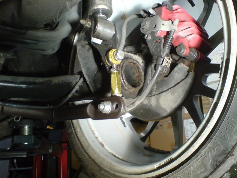

Yeah they are the kiddies, not cheap are they.
Ok, the options are...
1. Neuspeed ARB fitting kit - 60+vat and p+p from Awesome
http://img.photobucket.com/albums/v260/forbez/100_0990.jpg
Which includes the beam bracket you can see, which i dont know will fit mine.
2. Whiteline Universal ARB drop link - £80 all in delivered....
http://img.photobucket.com/albums/v489/fordkaracing/Ibiza/DSC00224.jpg As used on Alex @ TTS ibiza with what looks like a H+R ARB.
