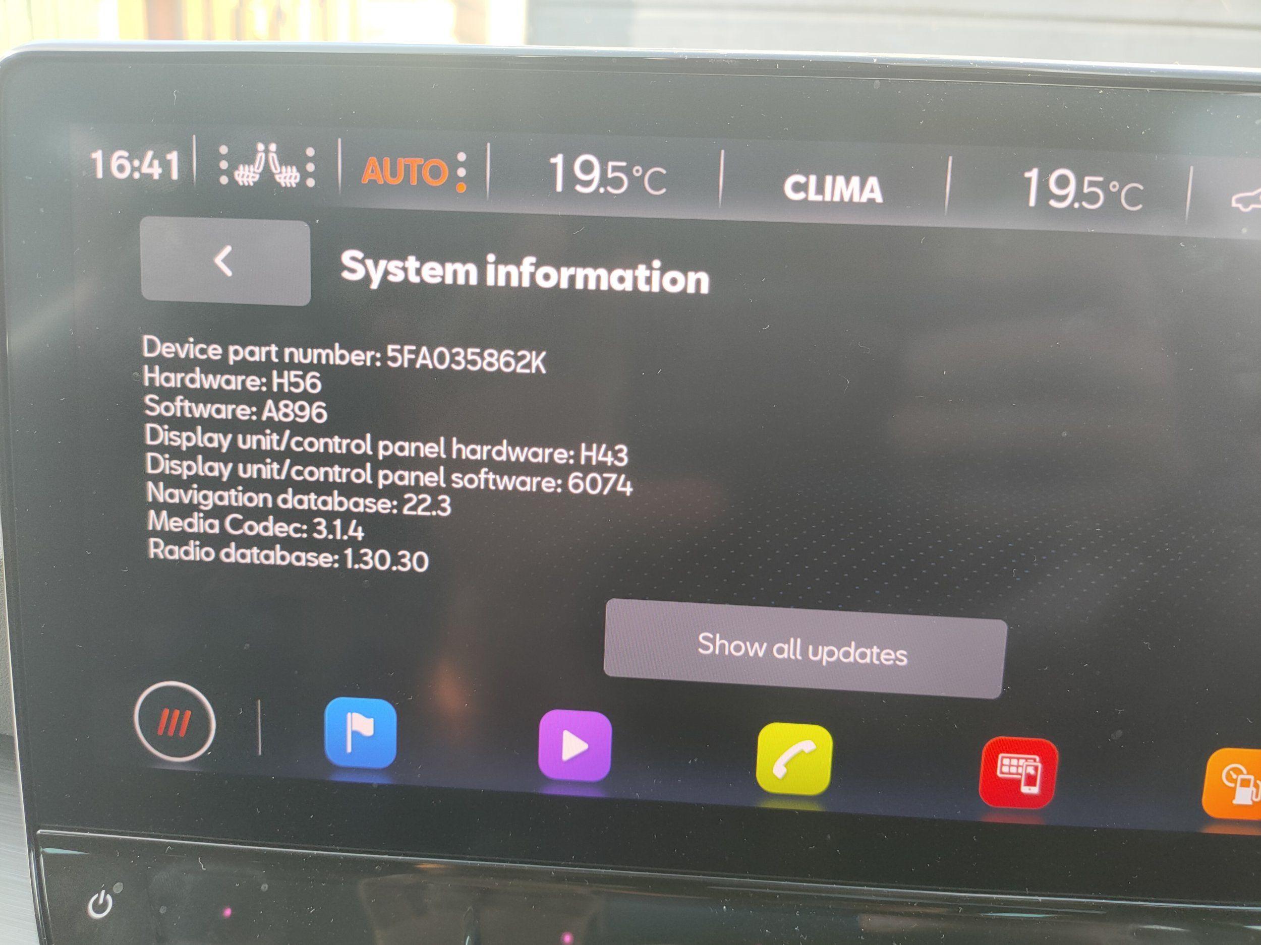

I’ve found a place to check status of the download (after thinking an update disappeared).
System settings > system information >show all updates. We know watch the download during every journey (apologies if people already knew this!)

Not sure your second point is correct (about it being 1896 when fully updated OTA). I have version A896 and voice control back after second update - see below photo
It's been 3 days now with no further updates and still on A896 *with* voice control back again.
Have had first update, no voice control .. but now been 2-3 days and no second update
I do wonder if they have stopped the OTA rollout a few days ago. I had two updates:
3400 megabytes which removed the voice control
1700 megabytes which brought it back again
I'm reading about a third part I am missing that takes A896 to 1896. Haven't had that though.
My point above is that it's not 1896 that brings back voice control. It's "Part two of A896".
