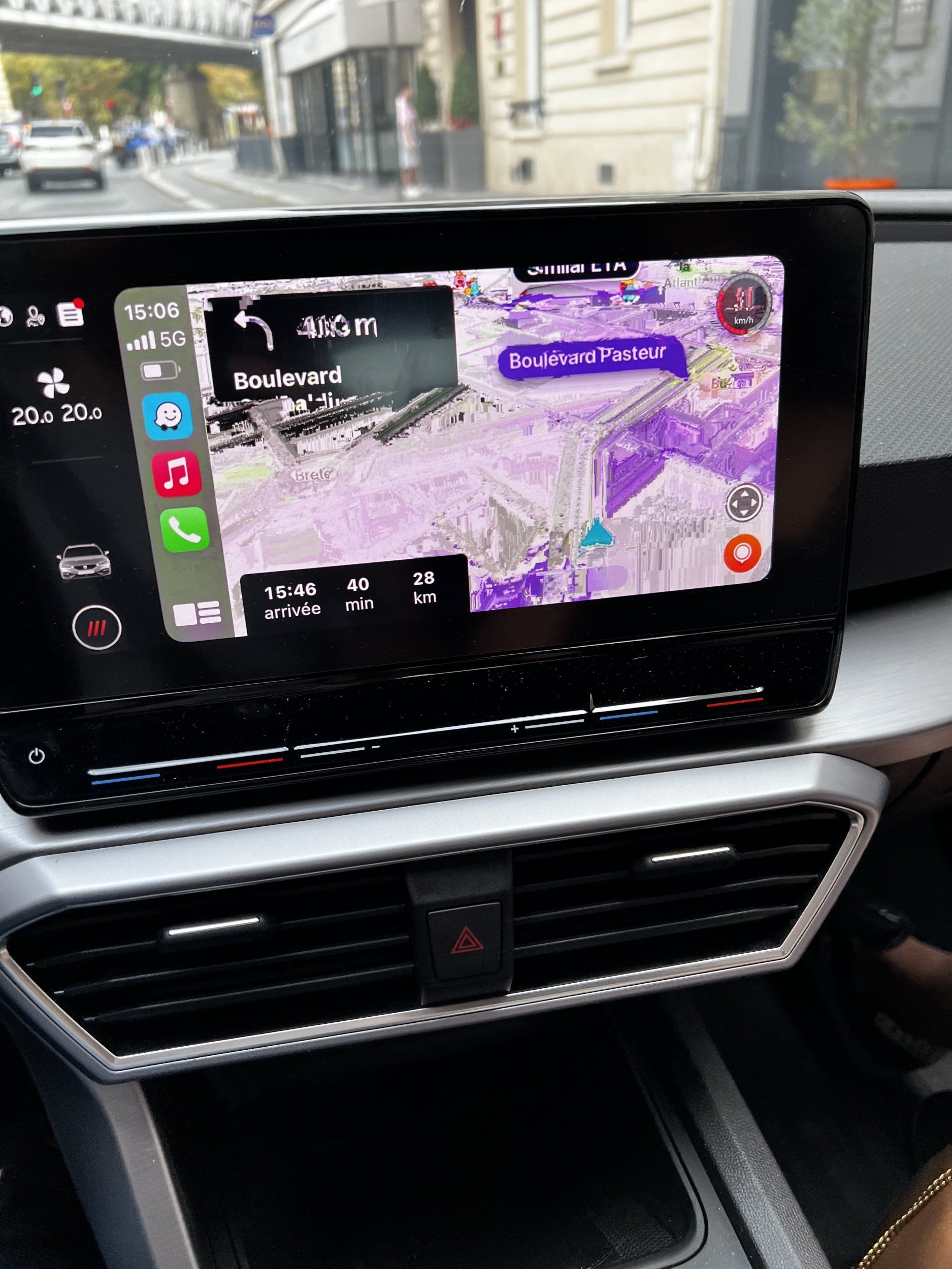

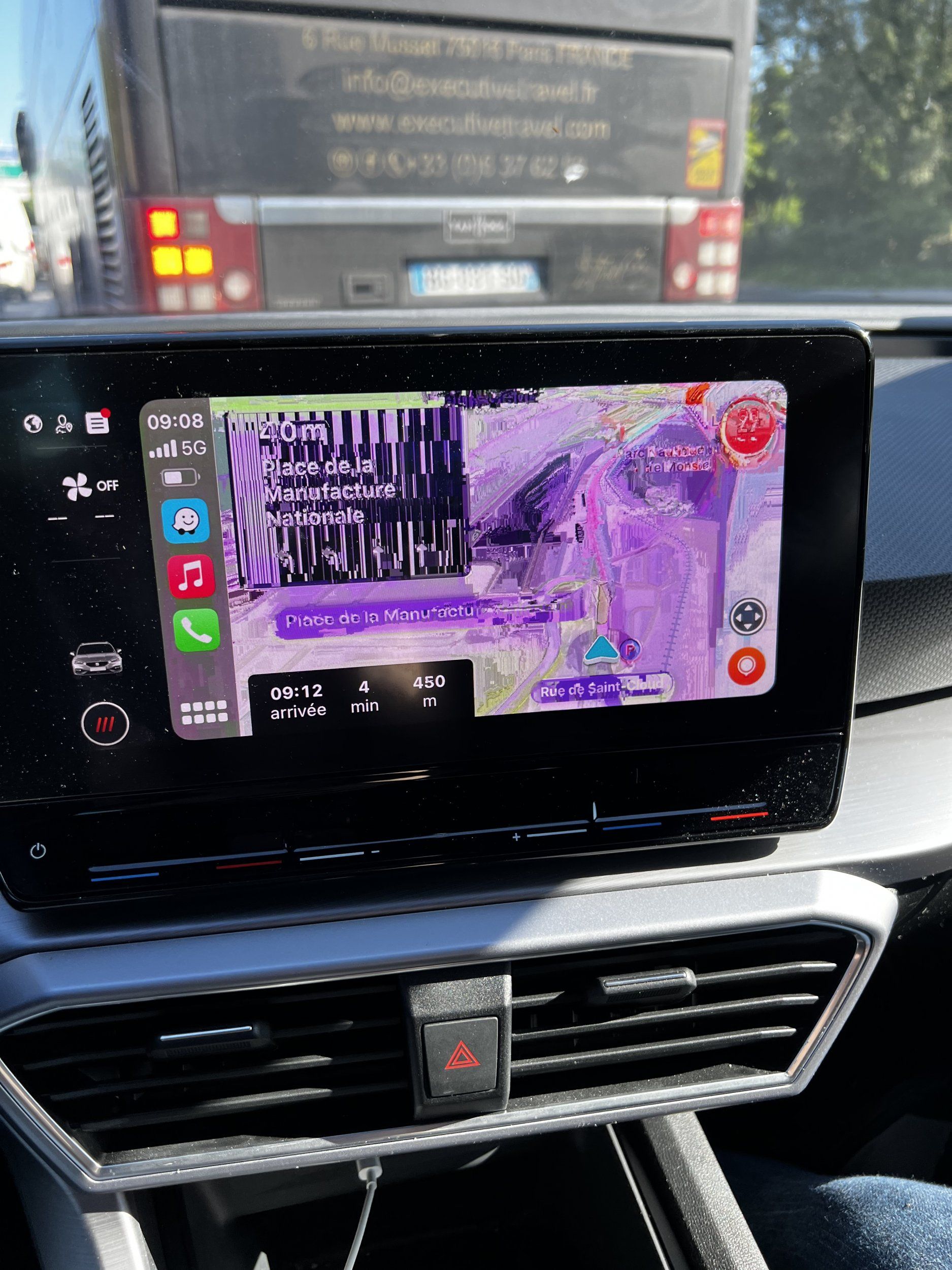

very interesting topic here. Have a lot of bug with my car. The gps cannot locate me a the correct position sometime, and impact android auto and CarPlay (because they based on car gps). Have a lot of bug with CarPlay and Waze (see screenshot). I’m currently on 1804. VW reseller told me that the new update (probably 1896) can be resolved my problem. I let my car during 2 days and they said me that the update was successful. However, the version is still 1804, only the map has change to 22.6. I’m very tired with them, 4 time I kept the car to the garage for nothing. Is anyone has the zip file? I know the procedure, it’s very easy. Have no notification for a year to have OTA update…

I have a new 2022 Arona and a May 2021 Formentor. My Arona would often struggle to know where it was or. Which direction it was traveling in so ended up havi the online control unit (OCU) replaced to fix it. The dealer couldn’t find the problem at first until I went to leave the garage so went straight back and took their master technician for a drive and showed him some photos I had of it playing up some he sent them to Seat who told him to replace the OCU. I hope it helps?
