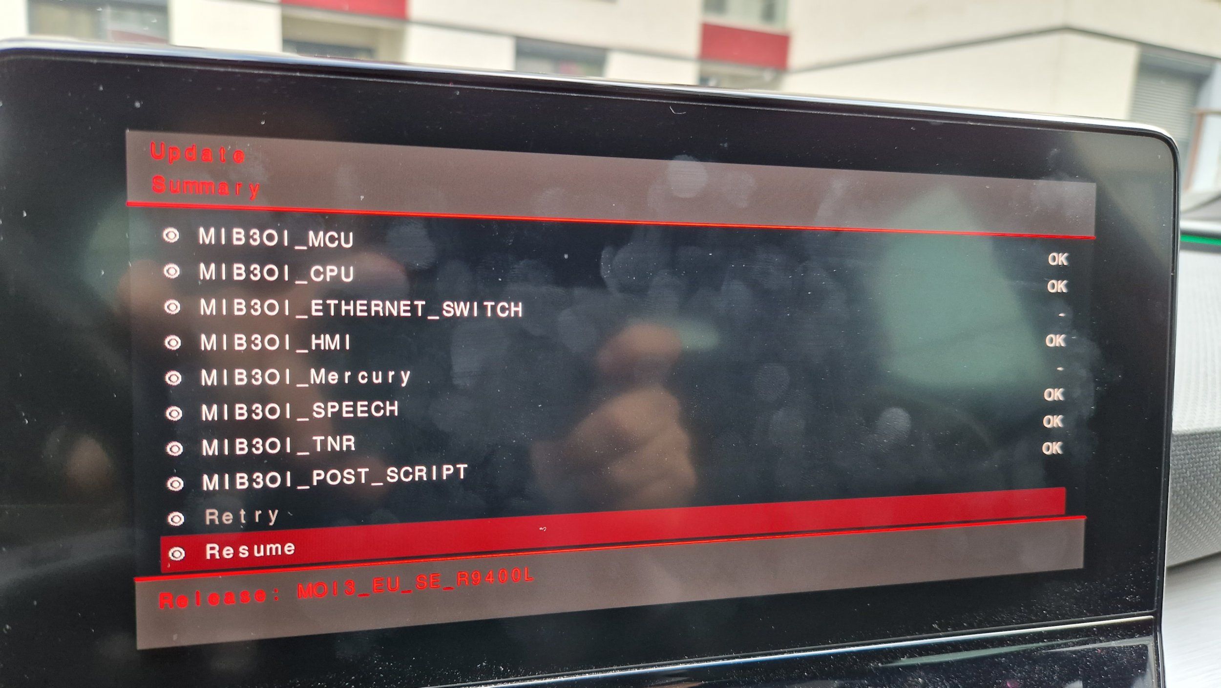

So I installed this on my car and went from 1896 to 1940. So far I don't see anything new except a faster startup. I'll have to try it a few more times to be sure.
In the day after tomorrow I'll be on a 500km trip and for sure I'll keep my eye on the infotainment. Also, I'll go through every single menu option/app/feature to see if anything is changed.
I attached a pic with all parts that were updated by this version.

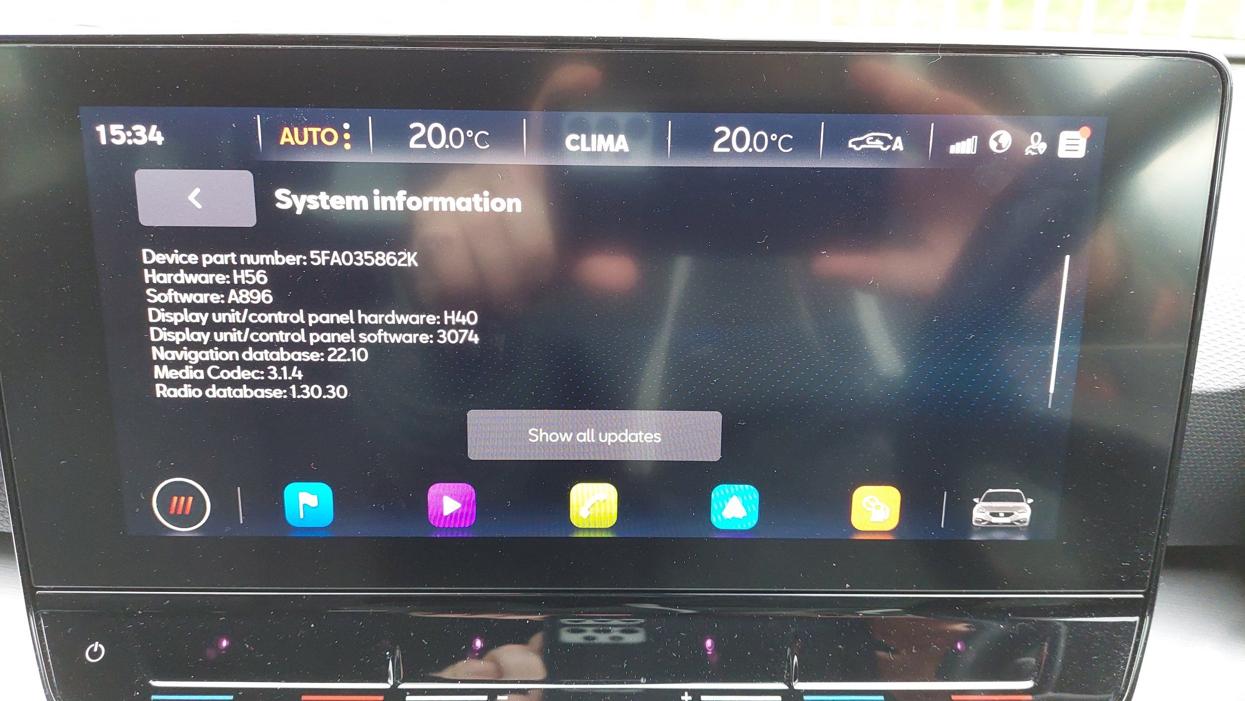

Can you get this update OTA? The random reboots are doing my head in. My SW version is A896 and I have CLIMA at the top of the display.

Mine is booked in to the dealers in a few weeks, list of faults are
Sos warning.
Popping/crackle from radio.
Intermittent fault with the heating screen where nothing works on it including the touch pad buttons below the screen.
Autohold is sticking on when I pull away if the car is on even the tiniest incline.
So we'll see what happens here, receptionist said it all sounds like software stuff. Currently on version 1760

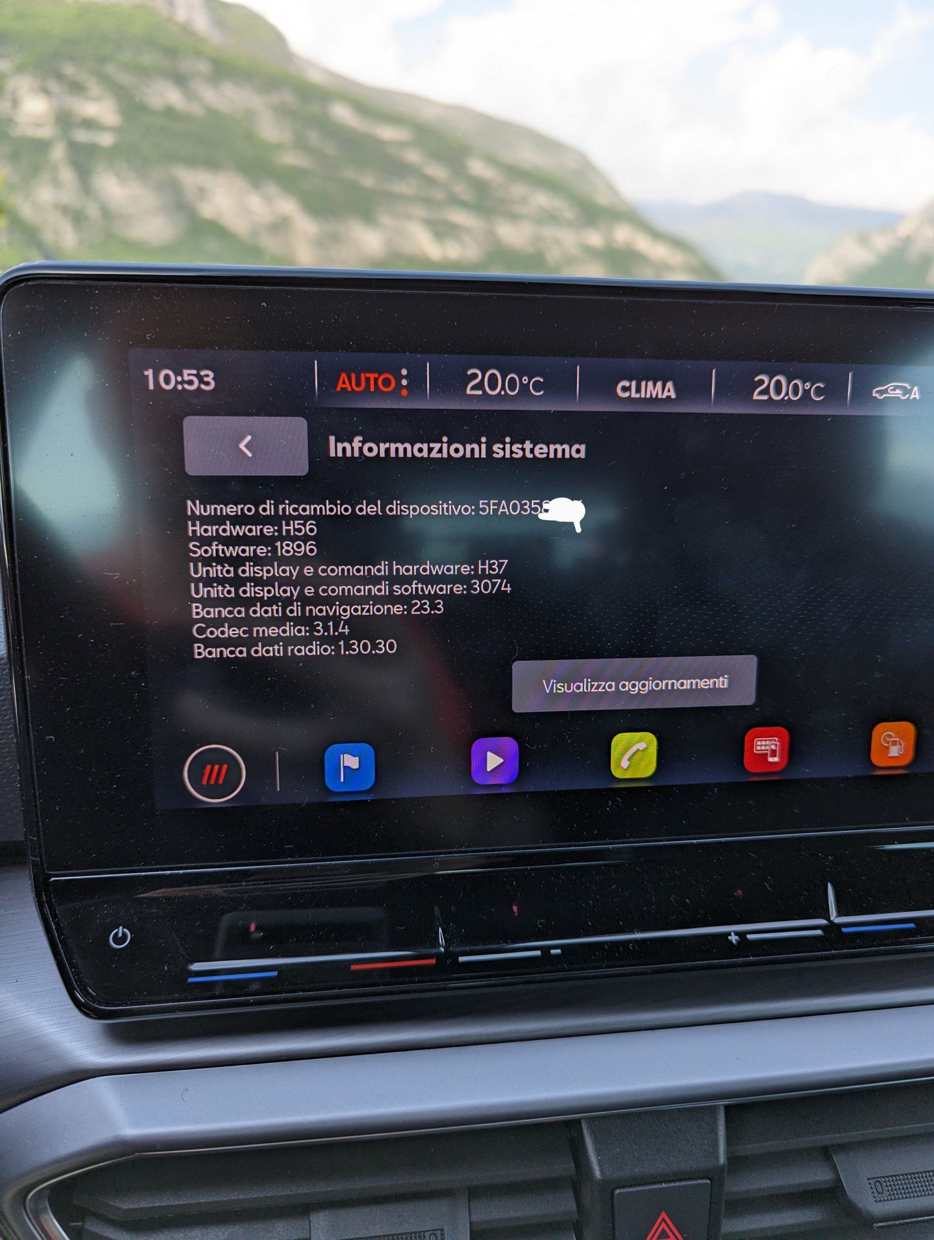

Hello, I want to upgrade my infosystem too. From version 1896 to 1940. Attached the info of my system. Tomorrow I will buy the update from the site indicated in the previous post. Do you know possible problem to pay attention? If I will follow the guide all should work well, you don t know about other problems? I don t want to broke the infotainment.
