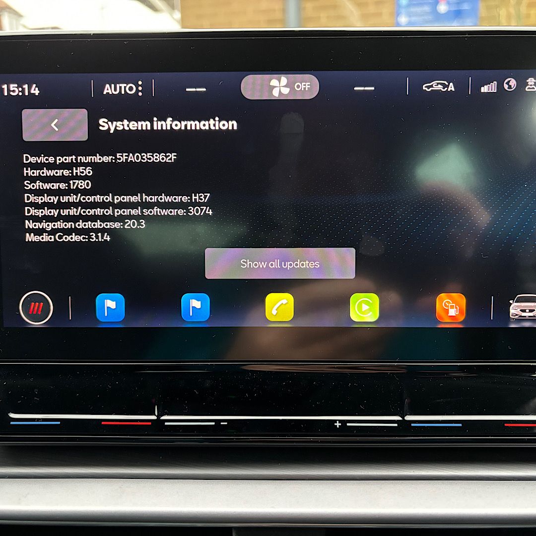

I bit the bullet and bough a Leon eHybrid yesterday. Just getting to grips with it, looks fun. These are my software versions - which ones can I and should I update? thank you.

1780 is way out of date. The newest version 1969 but I'm not sure 1780 can update over the air - you may need to take it to a dealer.r
