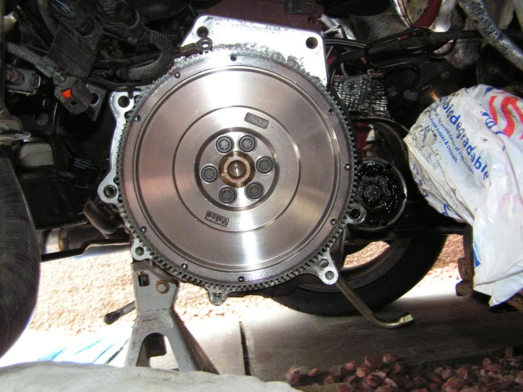

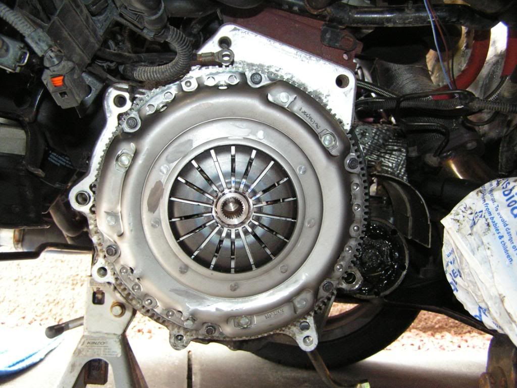

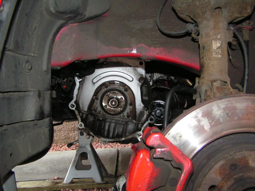

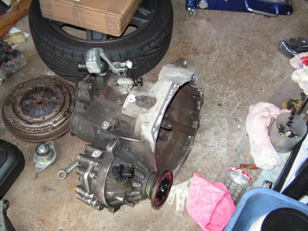

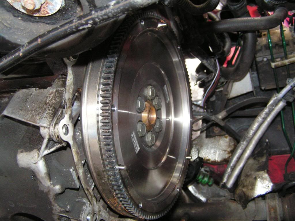

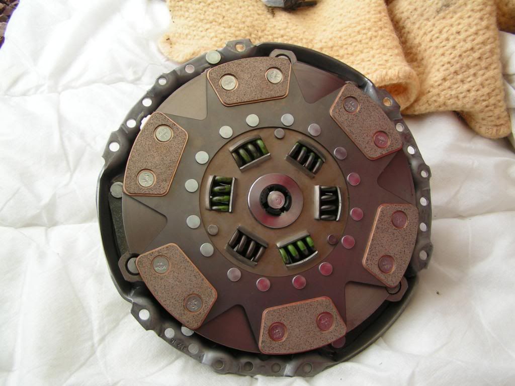

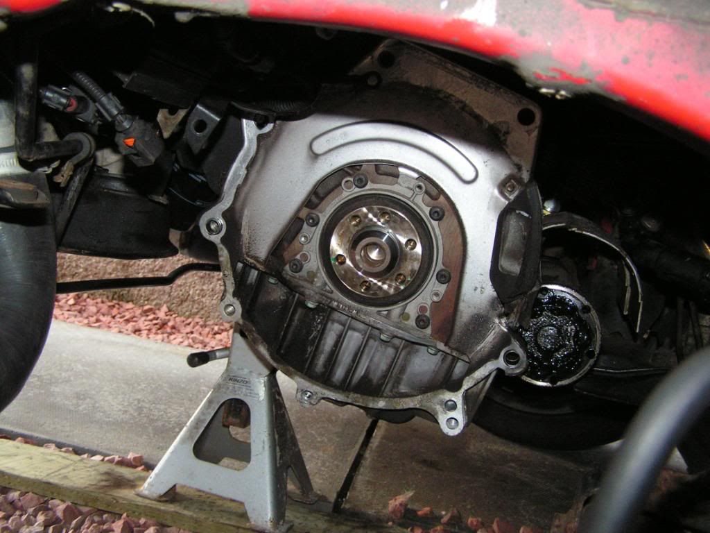

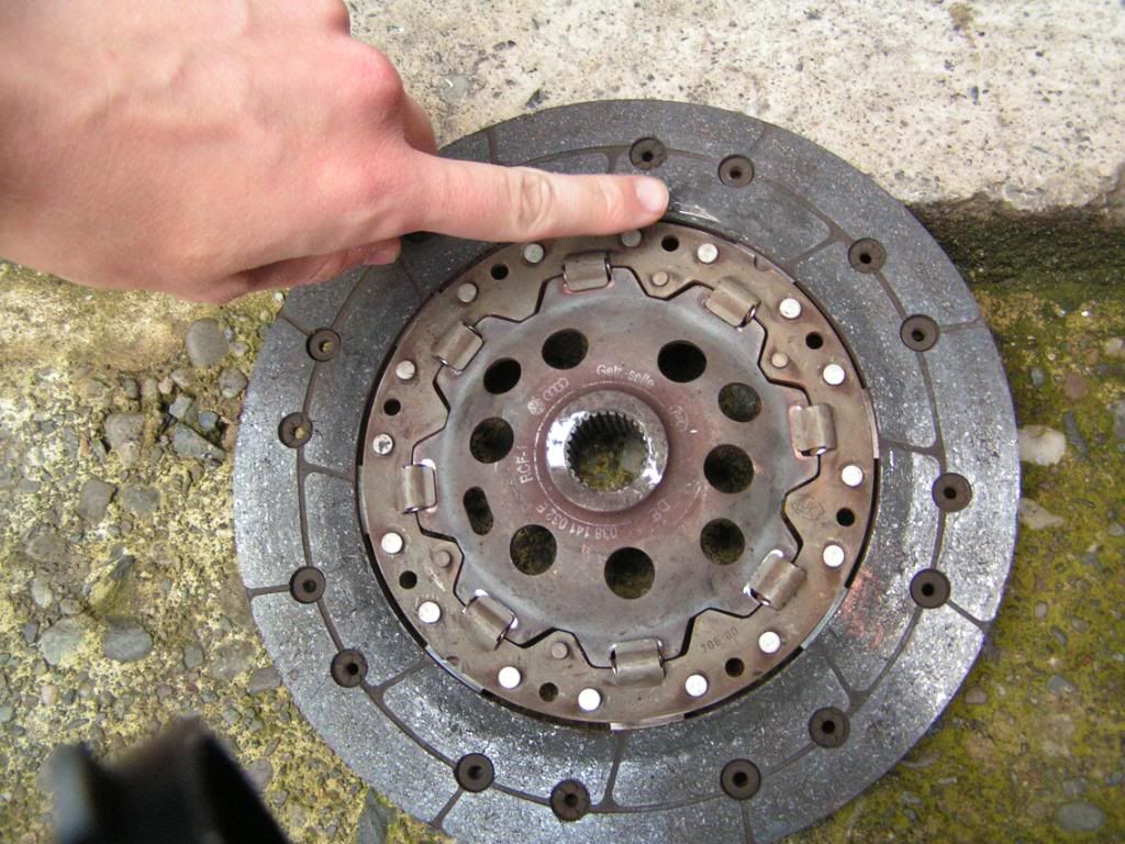

Thought I'd post an update even tho this is old news now, did the clutch last year after inters 09' clutch was slipping once boost was 'upped' to 1.5Bar and this is the pics from the clutch job. Later my work fitted two new gear cables as one got crushed taking the box out, and ground the clutch fork as it was catching on the new clutch plate.
Car Jacked up, In progress...
Clutch/flywheel off
Old Clutch, Duel mass Flywheel and G'box off in my garage
Worn clutch at all?
G60 Single mass flywheel on

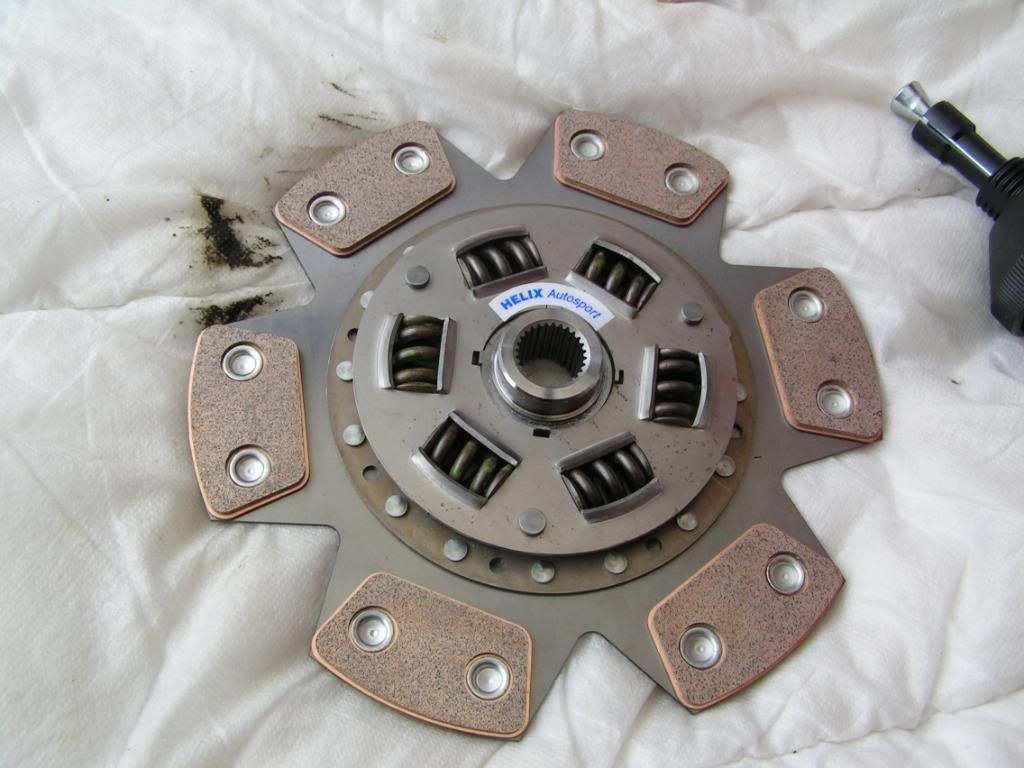

New clutch plate

Clutch on
Job Done!

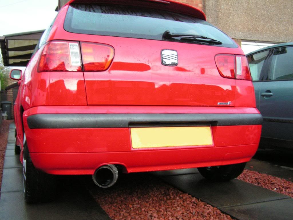

Pic of change of backbox setup and tailpipe

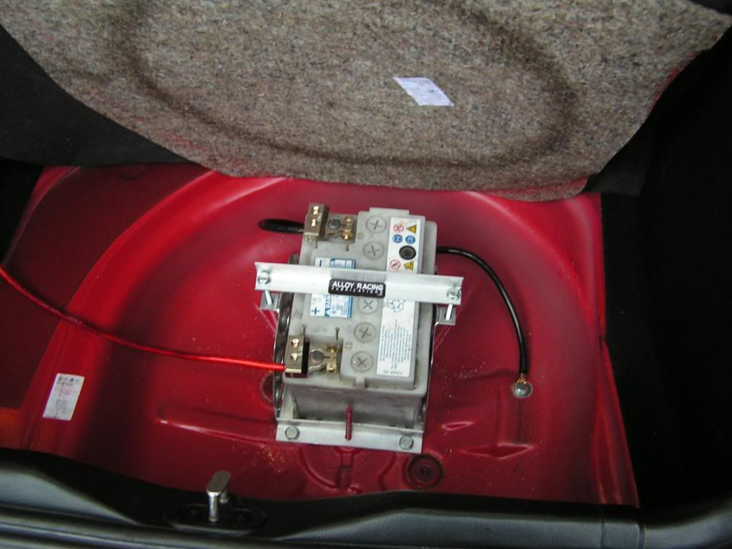

Another job from last year...
Battery mounted in boot
