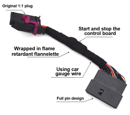

I recently bought a Seat Leon ST 2020 FR and would love to have more control over the start/stop system.
Therefore I checked a few forums, where they recommended a start/stop adapter (memory).

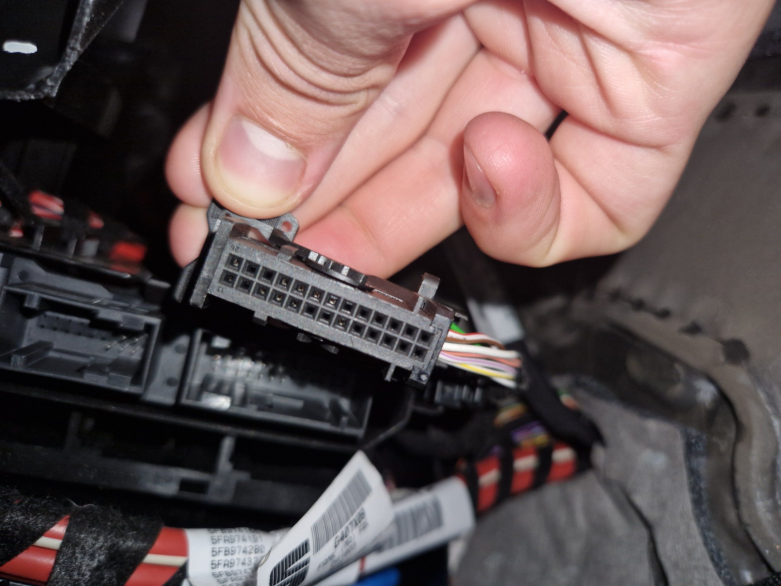

I bought it and tried to install it - but I quickly discovered that this is a 32-pin adapter, which is not compatible with the 26-pin plug under the steering wheel.
Is a 32-pin plug available somewhere else in the car, probably in the middle console?
