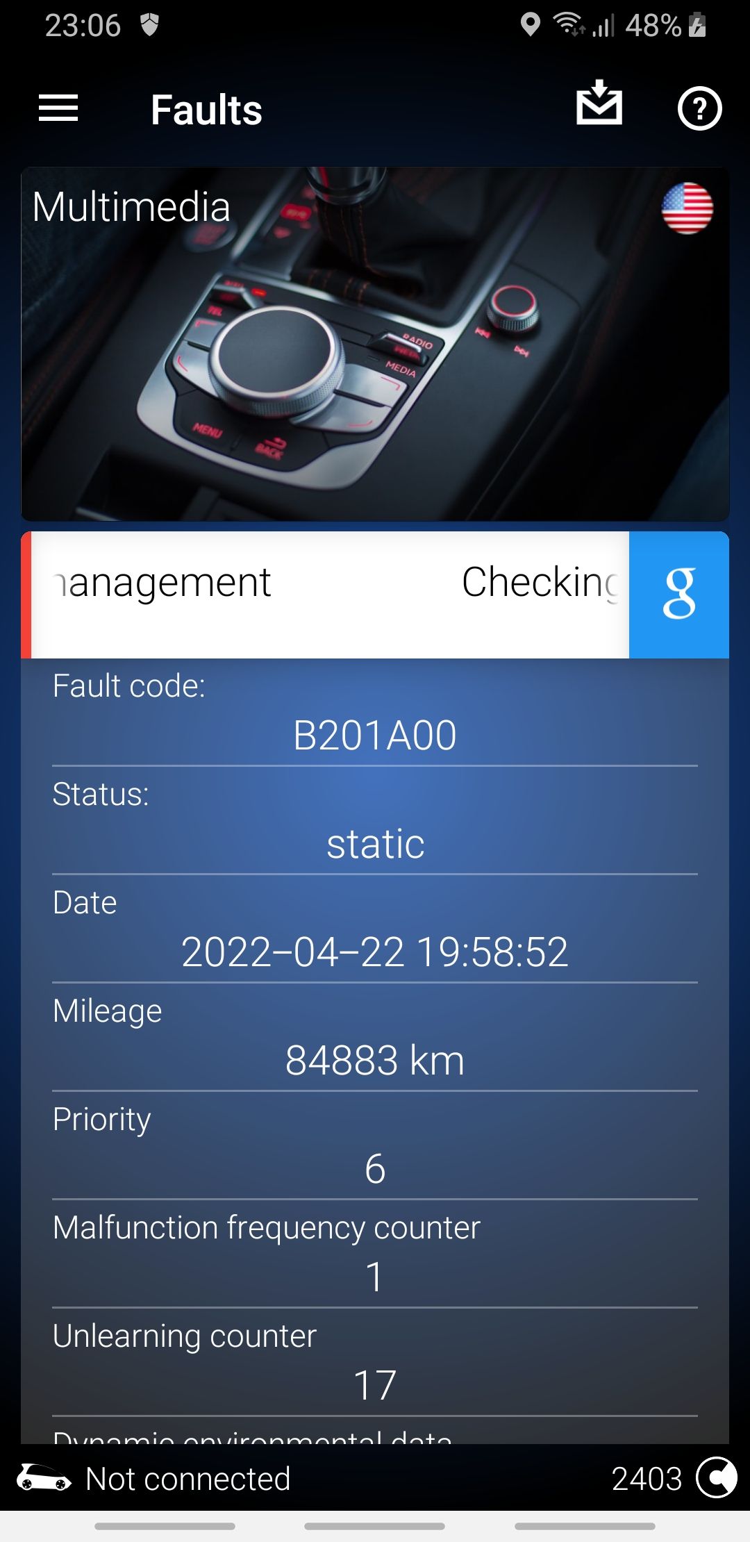

I still have to delete this error tomorrow with obdeleven ! I've already entered the new key, now I just need to delete it ?

That is the SVM error.
You can get them nested so you have to keep looping round into the decode im so xory to clear etc, you can get a different clear code each time. The mib tool high toolbox does have a function that automates clearing them. It did get rid of my difficult one. Recomputes the clear value itself, does a reboot... may be more than once as I recall.
Saving that I got one back again from somewhere, haven't bothered to clear it. The unit works quite happily with it if you can't get it to go away.
Yes I know, I already entered the new key yesterday I just didn't clear the error. I'll do that today when I see my son and his Cupra again. Thanks again to everyone here for your help you are the best ???
