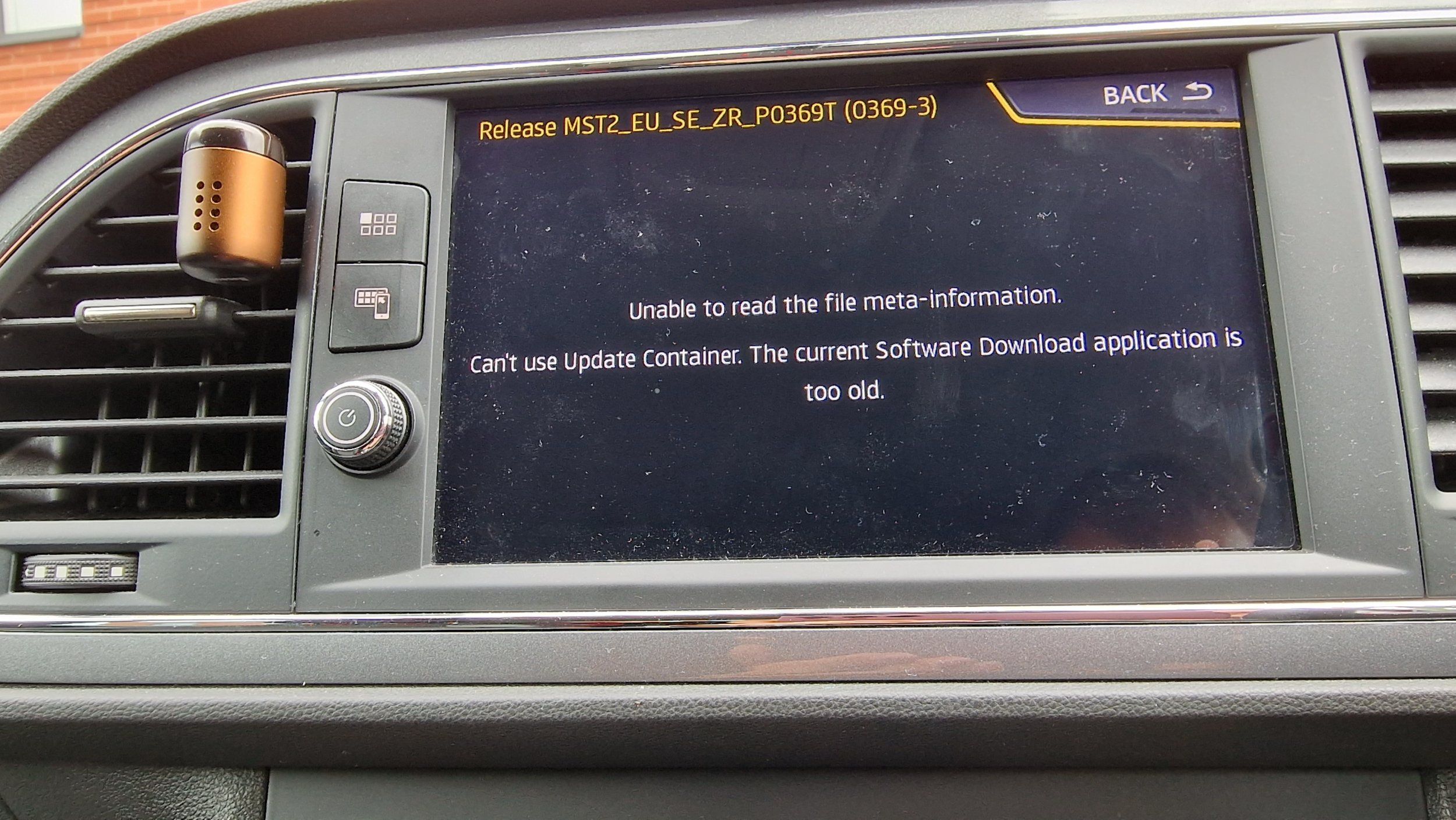

Hi, does anyone knows why I have the message "Unable to read the file meta-information. Can't use Update Container. The current Software Download application is too old." ?
I have the 0345 version, should be 0369 the next update.

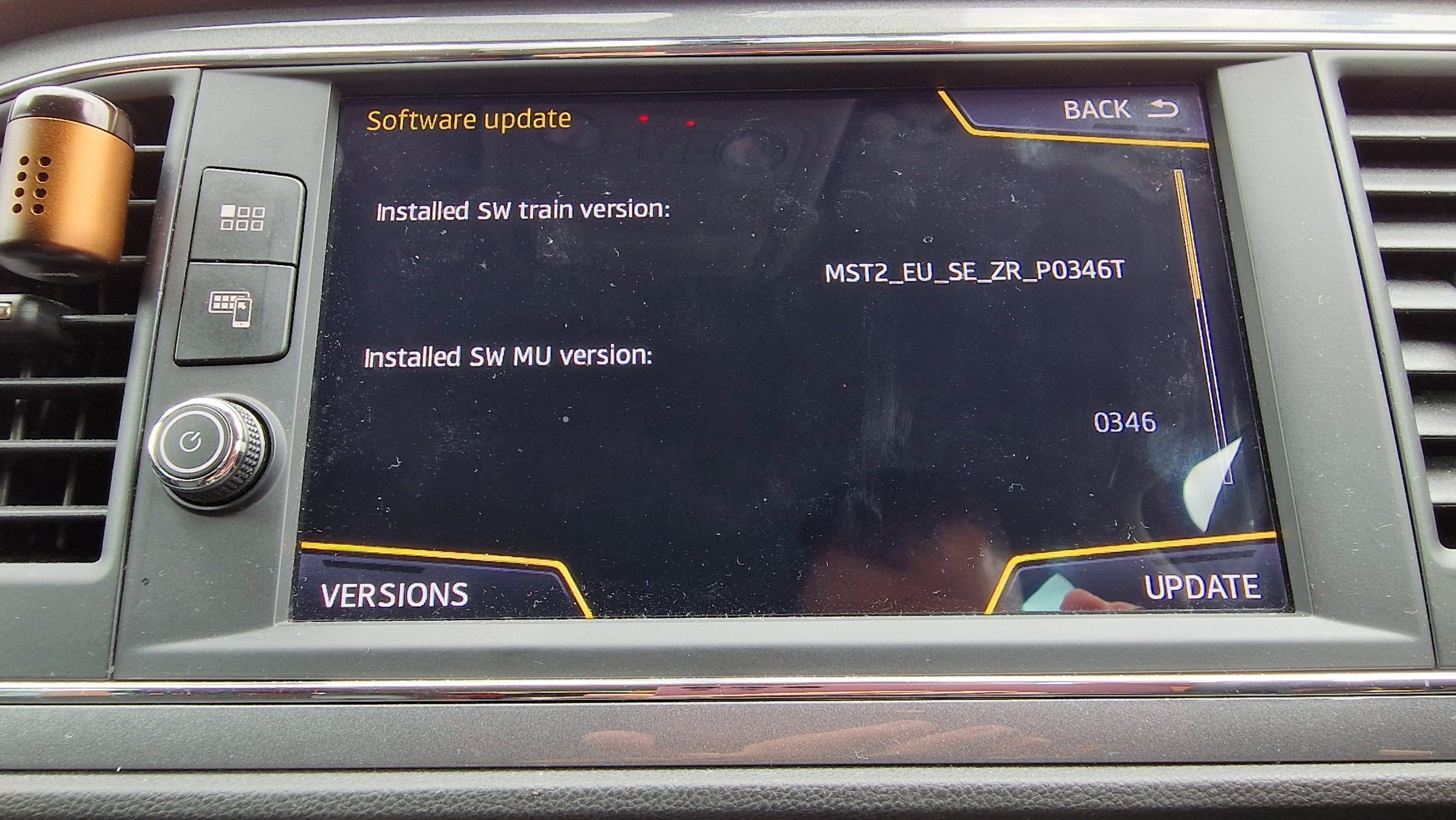

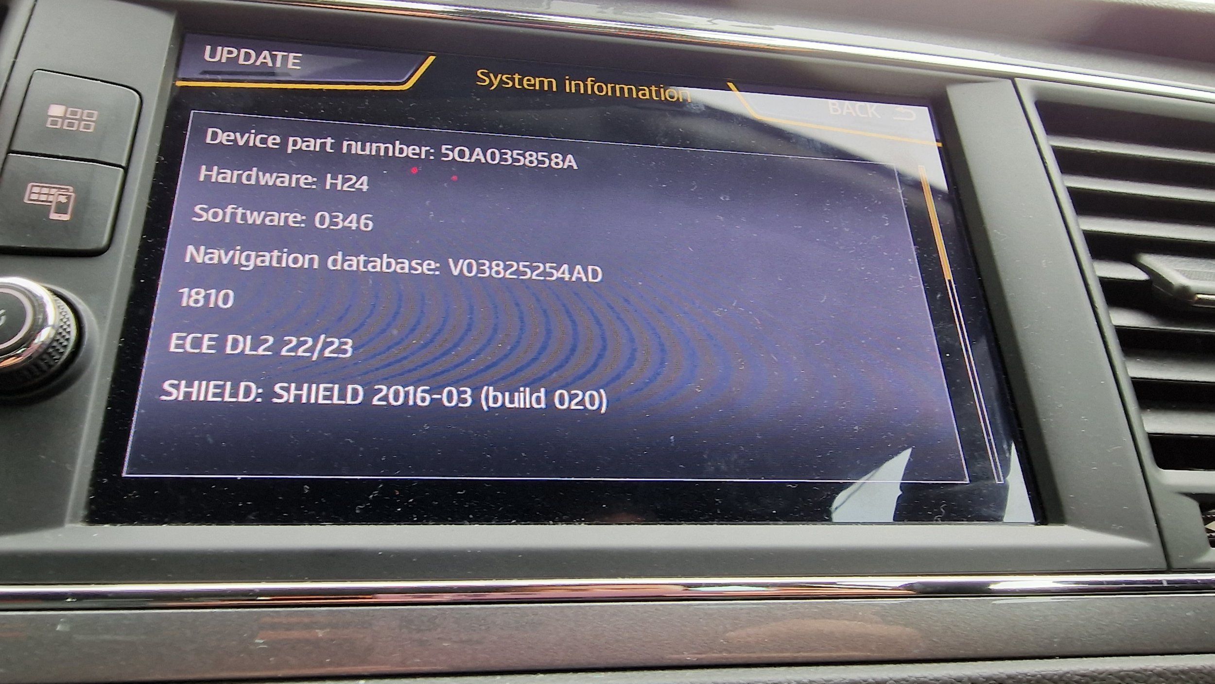

I have the 0345 version, should be 0369 the next update. View attachment 31591
Just taking a guess. The Hardware version is H24 so the Software should be 2xx. This to me looks like someone's done the Spanish update from 2xx to 3xx. Maybe it's something to do with that. Some retrofitting has definitely happened as the screen is now the 8".
Hi, yes the software has been updated from 0245 to 0330 and 0345 in 2017 (Spanish update) and also display has been changed from "6.5 to "8. Did anyone updated software to 0369 and worked?

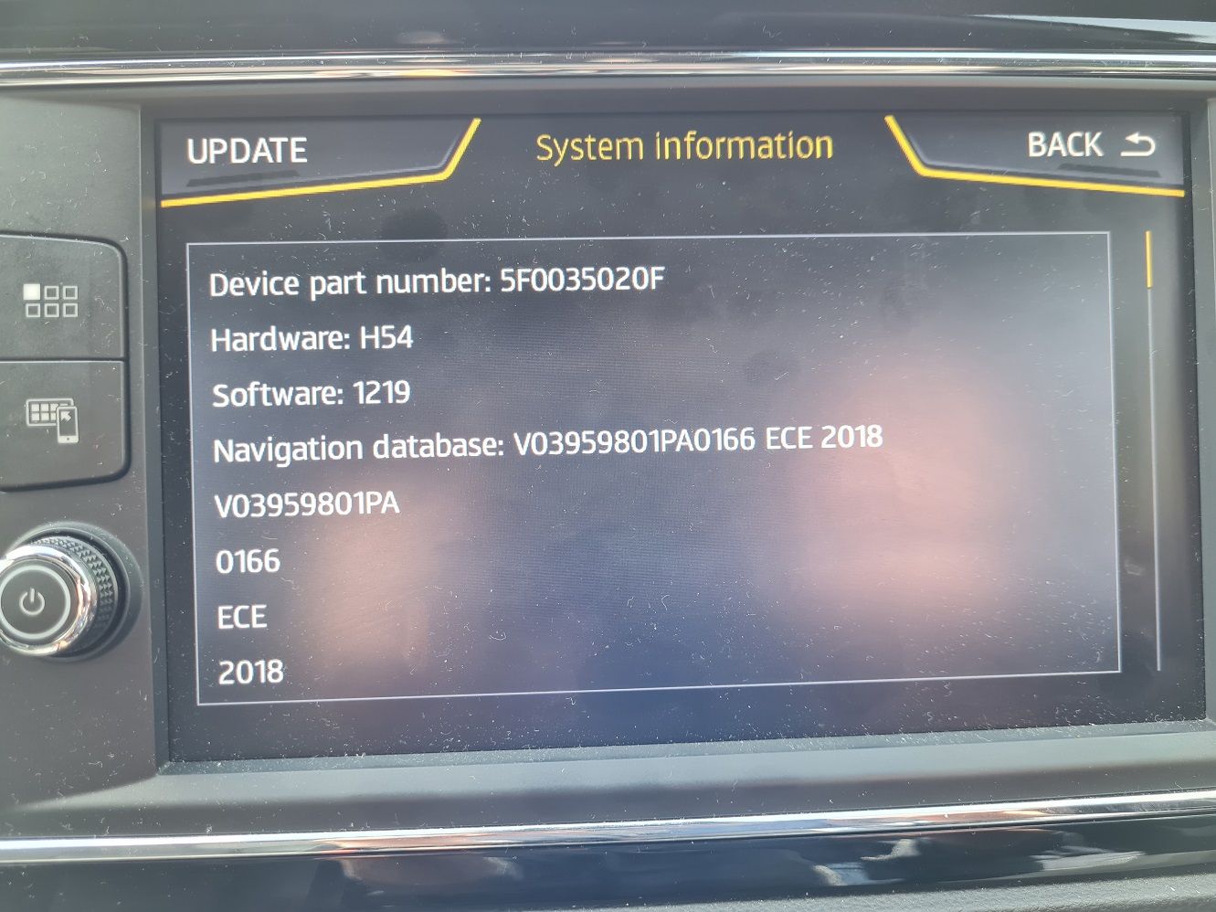

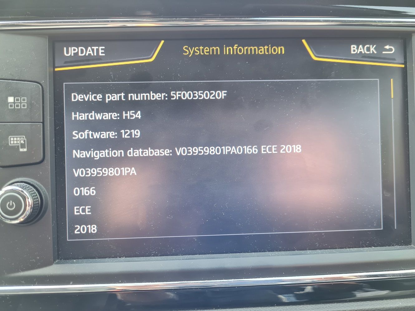

Forgive me for brain dumping here but I've spent the last few days going through this thread in an attempt to figure it out for myself but I'm a bit lost.
I've got a 2018 Cupra 300 with MIB2.5, looking to upgrade both the MIB software and maps.
I'll need to update the FEC code to support newer maps, is there a procedure for this somewhere?
I also can't work out what software version I can upgrade to and if there is a certain path I should follow.
This is what I currently have installed.
Would appreciate any guidance.

You want 1447 AIO that does the FeCs all in one:
The link is here, it had moved:
That's the one being talked about recently is working. Given yiu are on the 1xxx firmware at the minute it should just install fine. People coming from much earlier firmware didn't have the cockpit displays to match. Yours has the themed colour surround so I guess you won't have the issue.
The other is Mib Tool option. You are on 1219 so the Mib Tool option is available. That's a FeC addition to what you have. That's covered in this post if you can find the current Mib Tool in the database. Things move about on the lobbyist maintained software library. I'm still on 1338 and but used Mib Tool. The issue then was 1447 was tricky to install but with 1447 AIO it's easier. So at the time I opted to get help from the technical folk here to do a Min Tool module for 1338. There is currently a min tool module for 1219.... assuming mib tool is still in that library.
Folk after that installed 1447 the convoluted way then installed mib tool for the FeC edit. Then other have had success with 1447 AIO (All in one it stands for) where the FeCs get installed. I illuded to how that works in latter post. There is nothing above 1447 firmware. Somebody adjusted the firmware number in 1447 AIO we can assume to make it look like a newer version existed. Chillout (The VAG firmware expert) on the thread confirmed there was nothing newer tgan 1447.
Mib Tool method but not required with 1447 AIO:
After the firmware update dive into the mib2 high map update section here:
