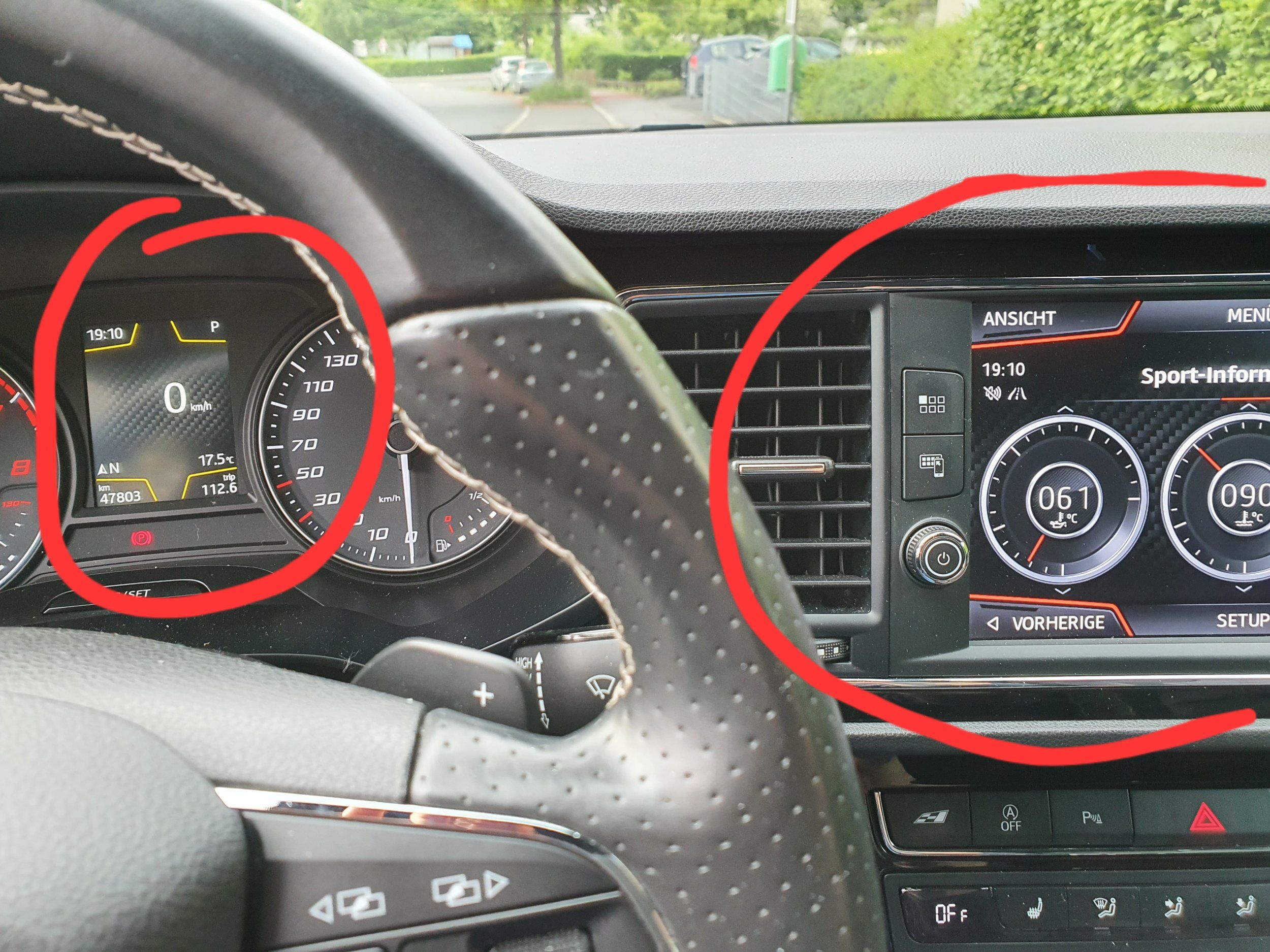

Anyone know if the Colors of the 8" screen can be matched at the Analog Cluster? Or this isn't possible at all?
TIA

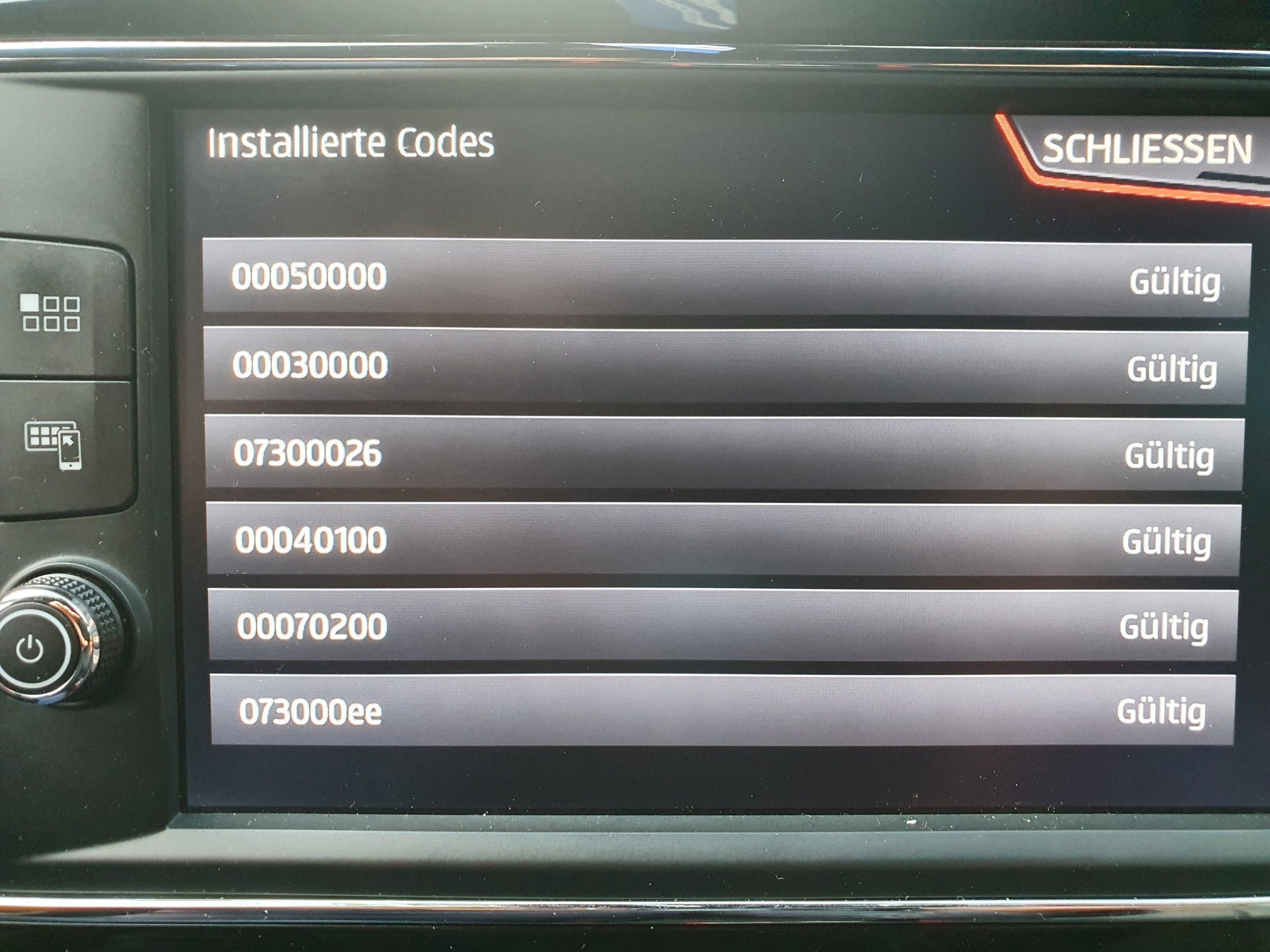

Managed to successfully get 1447 aio installed this morning, so much better now the ambient colours match. Very easy to do as already mentioned.
My only issue are the map FeC code for some reason it has remained ending in 1C not EE. Should I now install the M.I.B tools and carry out the FeC patch?
Firstly thank you to [mention]Tell [/mention] and [mention]MIB-Wiki [/mention]for sharing, altering, explaining how to install MIB2 High SW update.

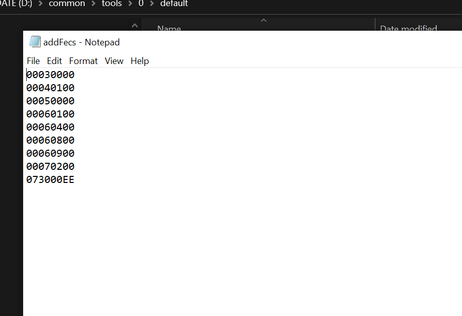

1447 AIO should have 073000ee in it... are you sure you ran the 1447 AIO rather than 1447 AIO. I've seen Billys and they are on that list. You can see a list of all FeCs with precedence given to the higher one so may be further down the FeC list if you page down.
if you install 1447 AIO then you shouldn't need Mib Tool.
On the linked list 1447 AIO is the one below 1447... just in case you picked the wrong one off.
The 1447AIO software (currently dated 30th March):
MIB Solution :: Login
guest, guest
Failing that you could install MIB Tool if for some reason it didn't take part of the process.

I didn't run the Patch or MibTools and got the EE Fec installed! Did you have any fail messages in the process?

Here is the notepad file that is on the SD I used to update
TIA
Never found anything about this... i saw that it works with the virtual cockpit, but never see if it works with de analog cluster... If you found something it interrest me also :cool:

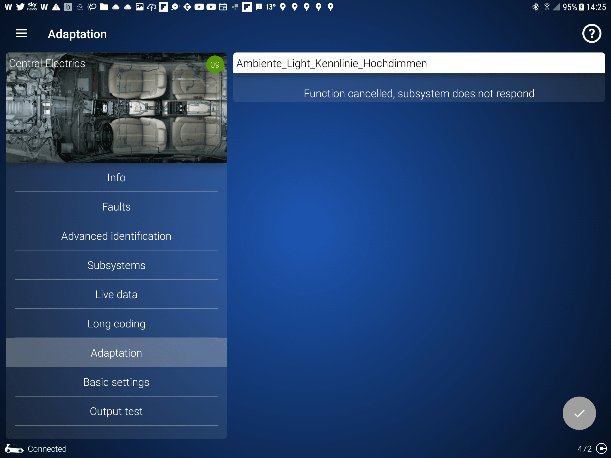

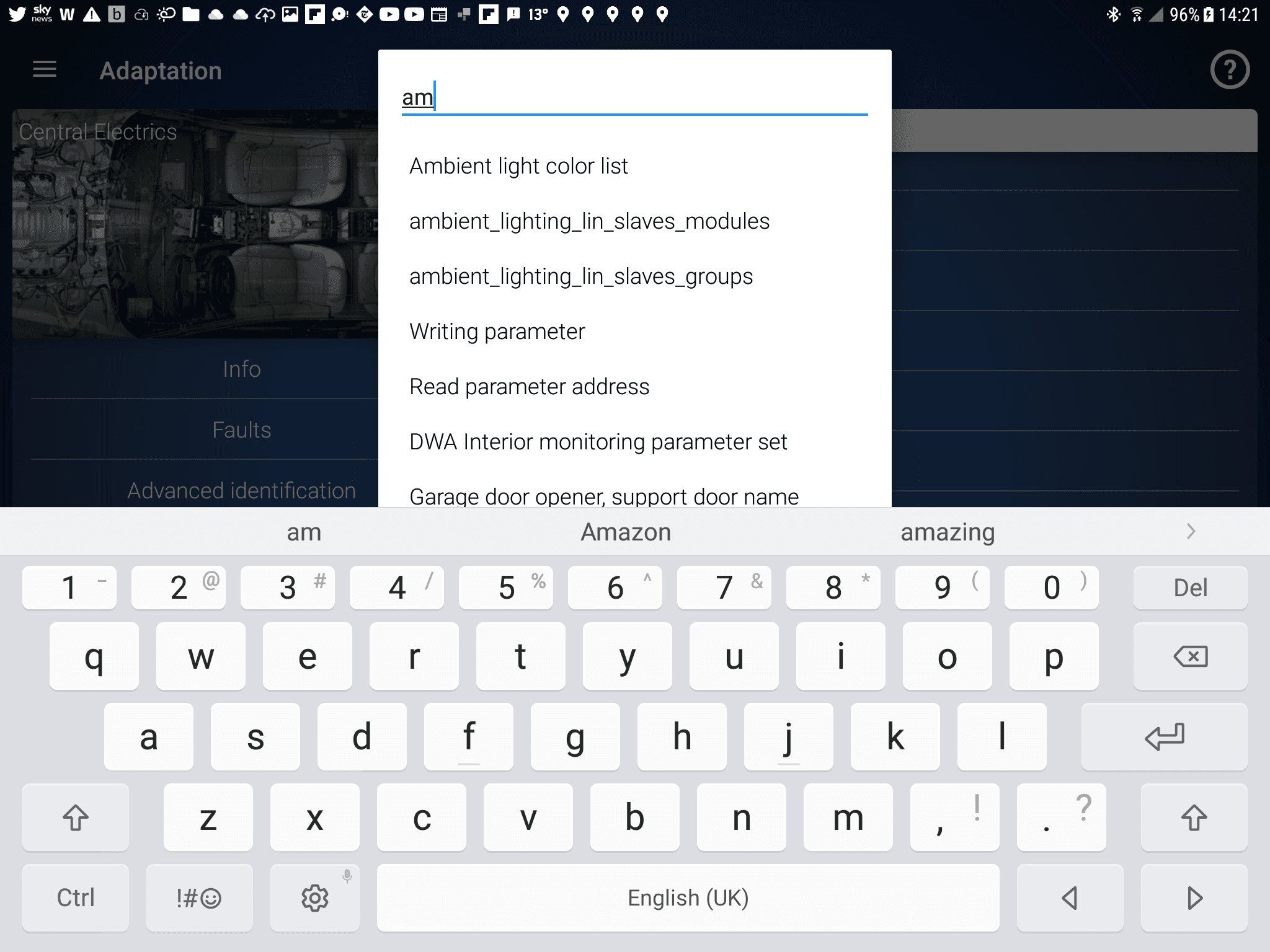

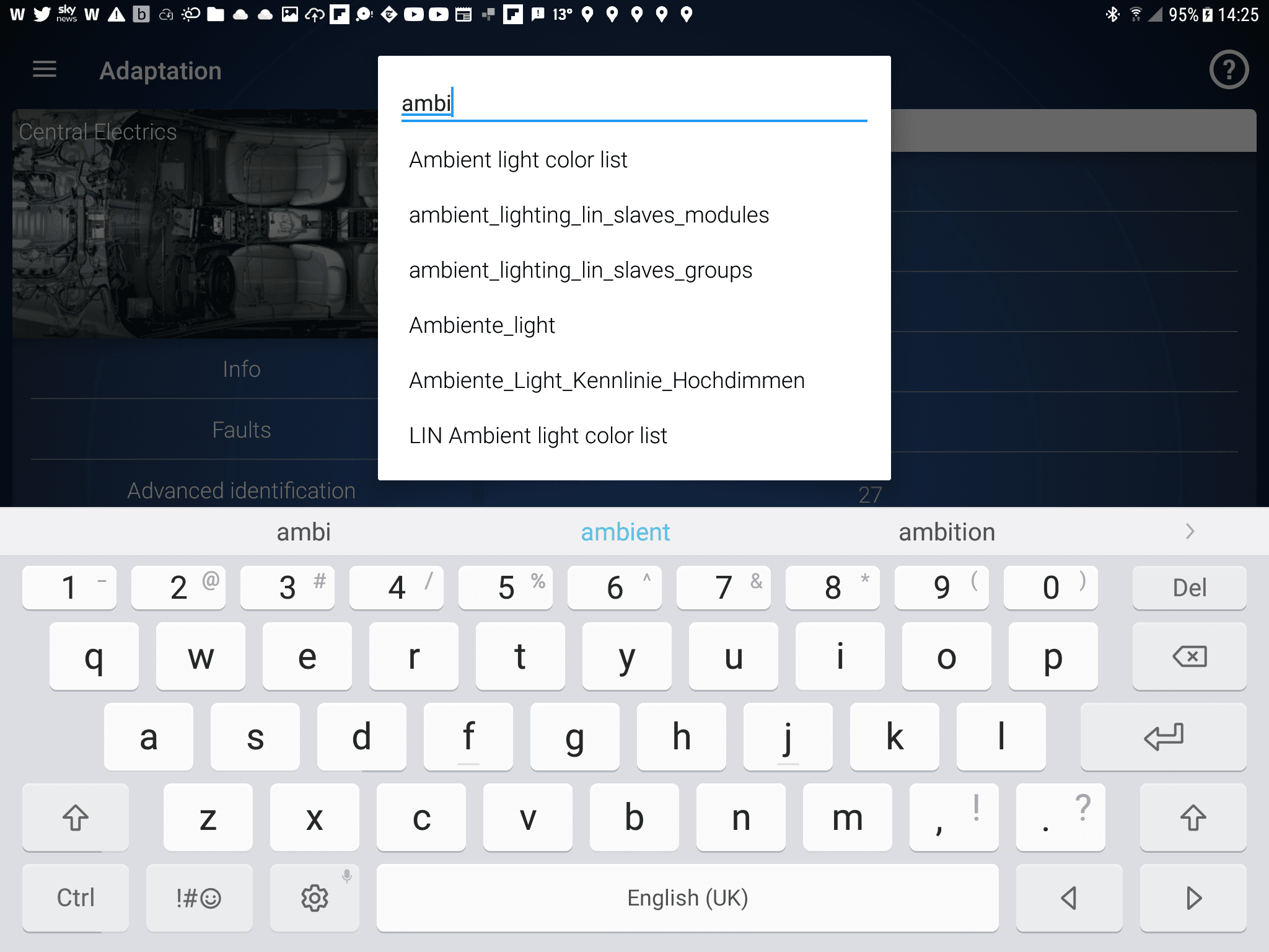

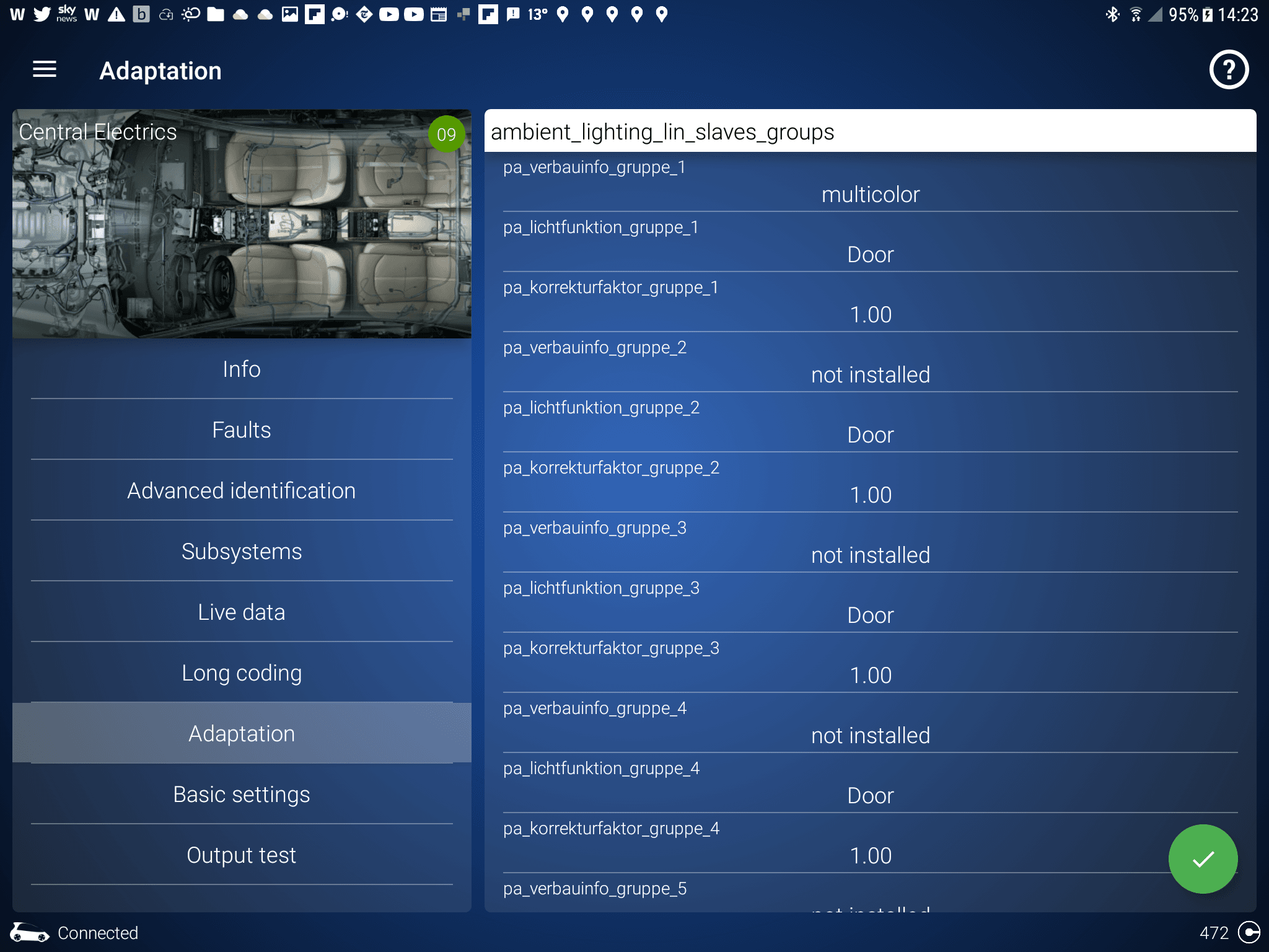

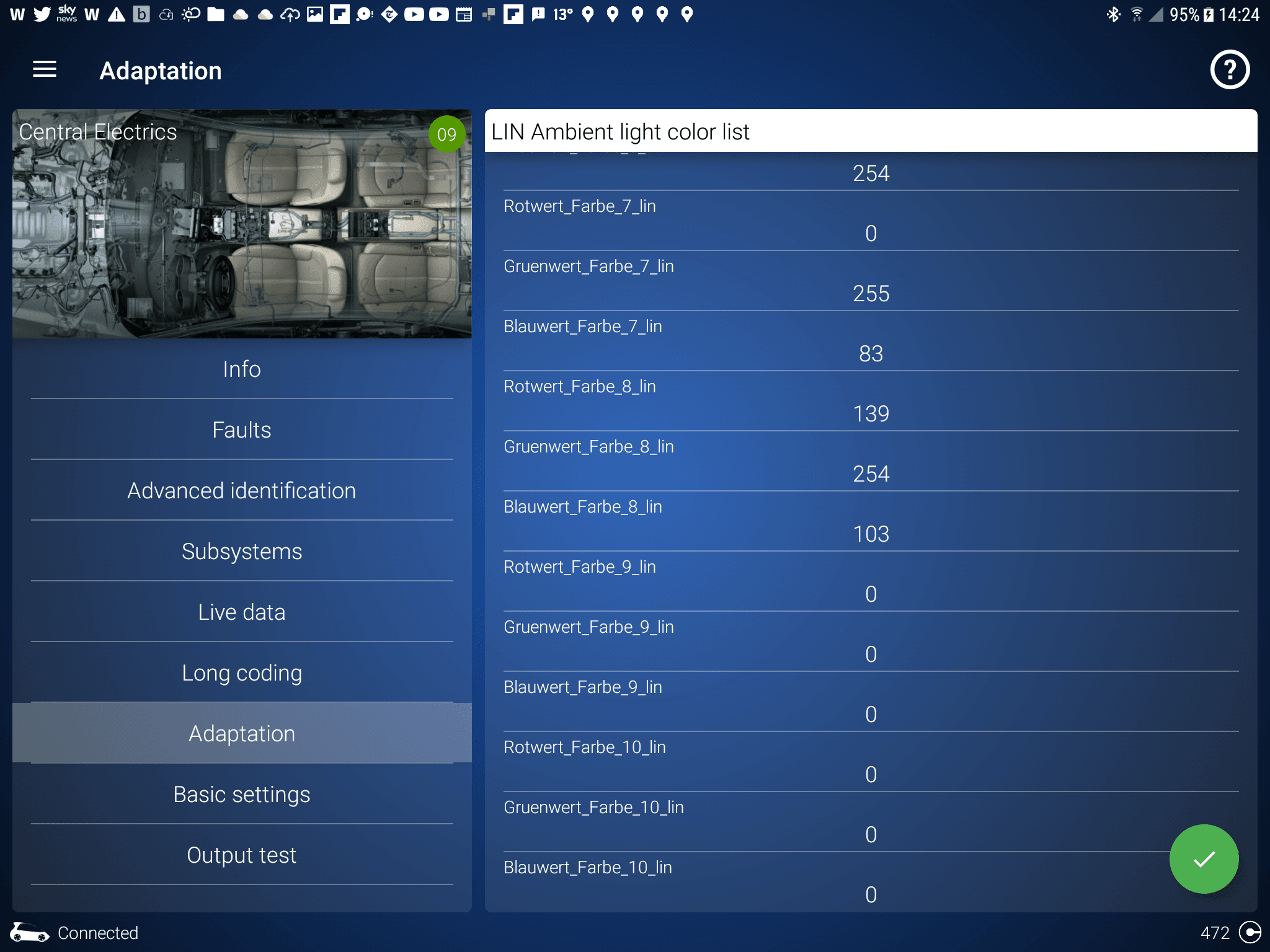

Billy's getting me to screen image my settings which Im passing on. 1338 all fine. Original was done by s retrofitter, Jpmedia assisted me with the life long FeC. Unless 1447 is different from 1338 it can be done. Mines on the ~14 colour one (factory set as delivered). I'm no expert on Ambient light screen. The range of colours is what it came with on those units and ambient light system. Have no real wish for many hues.
Basically the retrofitter at the time took a dump of the cars setting and then manufactured the 5f upload, then tuned up the settings. It went from a very early firmware prior to the 1xxx to 1338.
Well I reckon the screen colours of the front unit and pre digital cockpit are set in these screens.... I guess, get that right and it works or something like that.

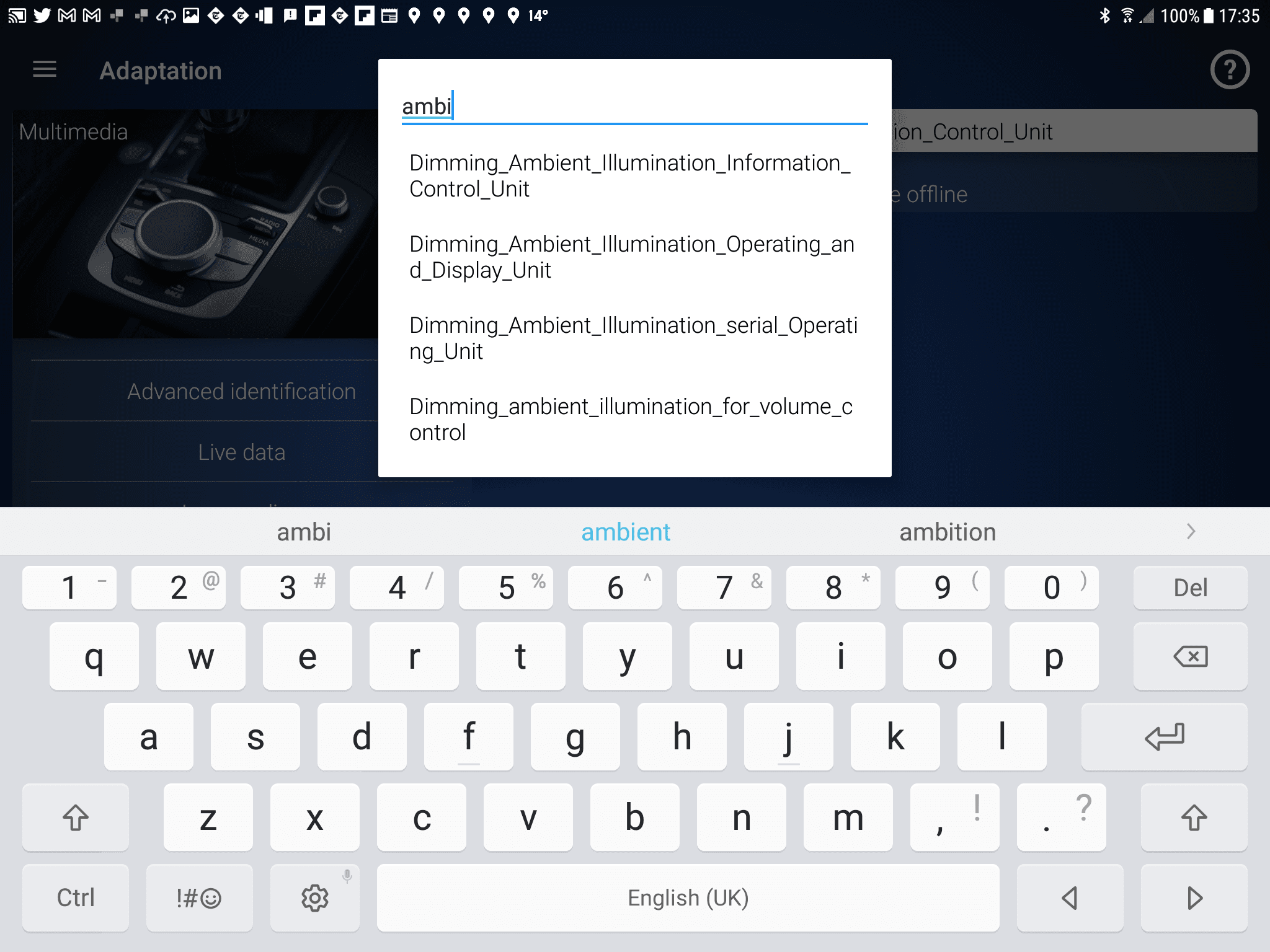

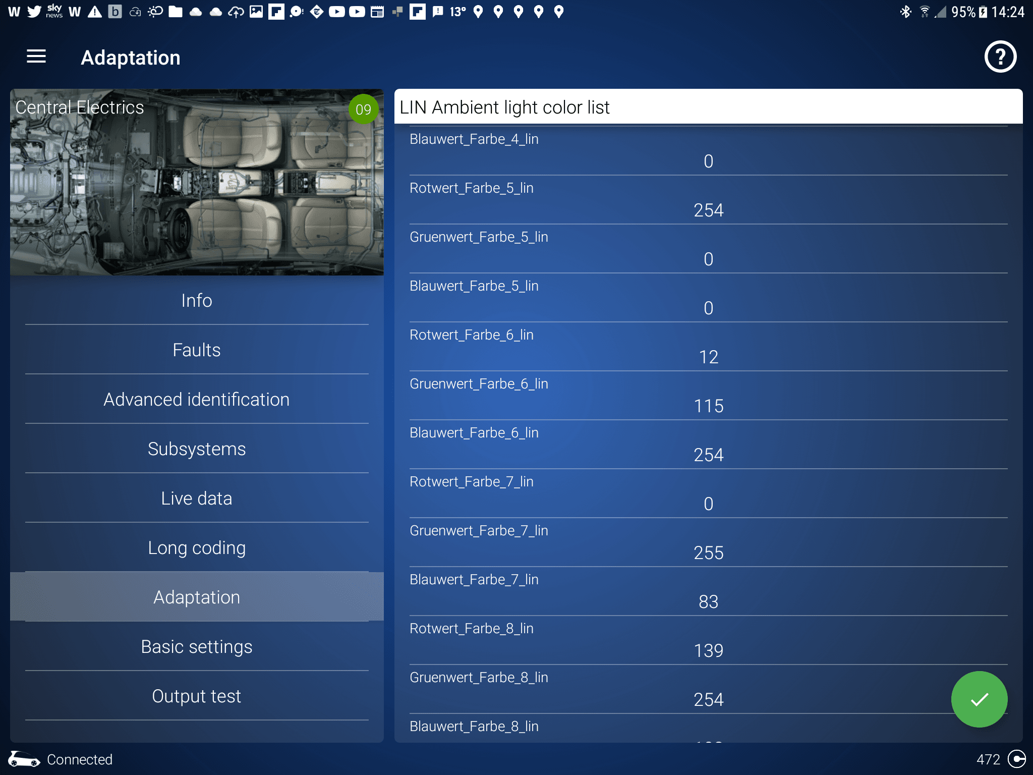

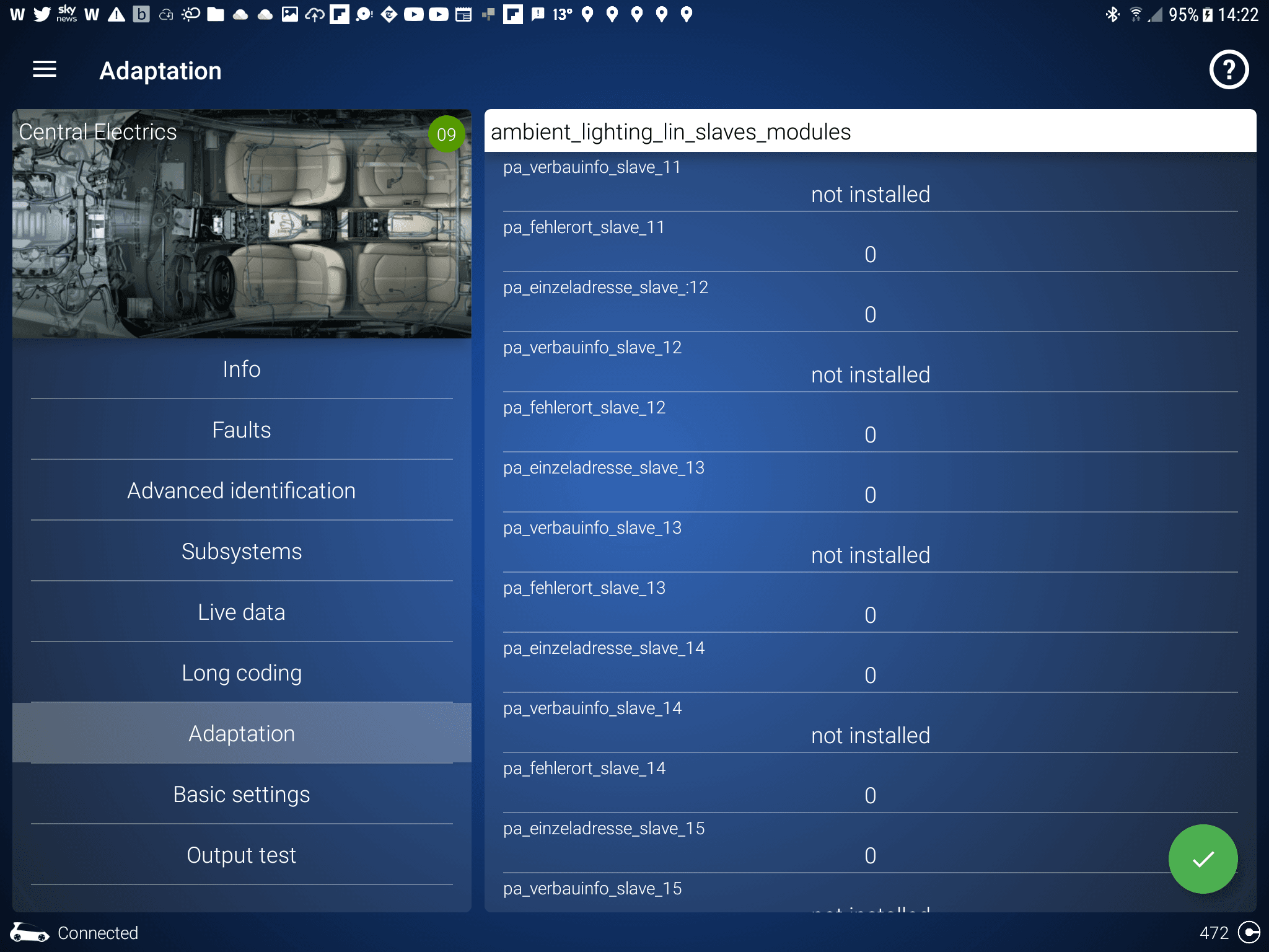

Have a dump of them. Ateca with ambeing light electric control unit 9.

I will look because i have a standart mib2 with software 516 but i can have the 30 colors on the doors and on the mib unit. Only the central part between the analog needle is always with the orginal colors. (Blue=gps, green=smartphone, red= radio, yellow= car statistic)
The LIN parameters are only for the doors (in a seat leon) the other ligth parameters are for the mib colors

Might have hit the nail on the head if different systems give you different range of hues, if you can't match them up since they aren't capable of that range then there will be odd ones out. I can't say I've ever been that interested in colour schemes in the car beyond, primary and the complimentary colours. I know some people are.
Chillout's skins is the place to go to modify the image for the mib2 high and if you follow the links talk of the standard version (these are the toolboxes as opposed to mib tool):
And Chillout came up with the solution to manually alter Mykro's issues so the conventional dash display colour matched the 8" screen (highlight colour).
Issue:
Solution:
That was the solution offered up when the conventional dash display offered up a different colour to the 8" display.
The two links to changing the skins and the highlight outline colours if they don't match.
Got a feeling the highlight colour issue comes in if you opt for more than the Seat default colours (that which I'm happy with) so it then unravels on the front display. In Mykro's case it was a big jump of the software update from below the 1xxx series to 1447 or may be not. Reckon those are the two posts in the mib2 high area on this.
