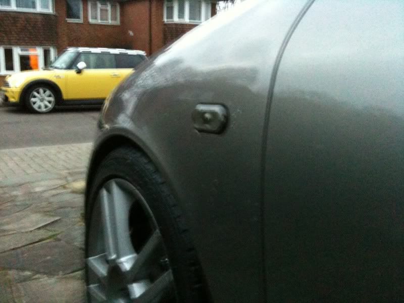

UPDATE: As above guys and girls, I've just debadged the LCR, stupidly late in the afternoon so I ran out of light more than time!!!
Pics will be up later as I'm off out to my mates to watch England vs Denmark (bound to be a load of ****) but anyway, moral of the story is I MUCH prefer the car debadged!
While I had light I could instantly see the sides look much cleaner and smoother. I like.
I have the small CUPRA and the remaining R badge to take off on the boot... Next time I will start debadging at an earlier time of the day.

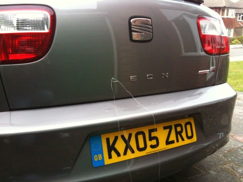

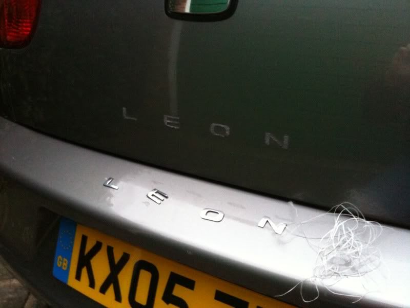

For info I used the following for the job:
Lots of dental floss.
Warm water mixed with autosmart duet which I use to clean the car to warm up the sticky muck.
White spirit to break down the remaining sticky parts.
A O'Neill store card off my desk with some elbow grease to work off the sticky muck!!
Washed back down with autosmart duet, and shammy'd!!
I will be going over all of them I have done when I do the remaining 2.
As I mentioned, pics will be up later.

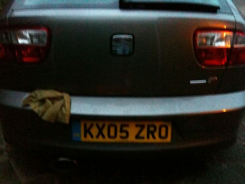

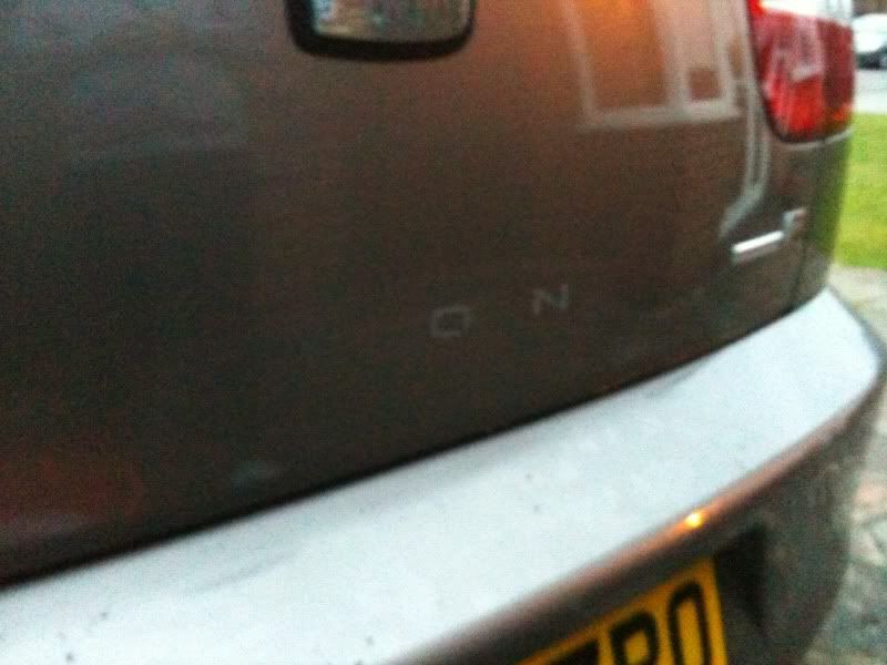

I found some of the badges come off alot easier than others mate, the O in L E O N was a pig. But the others popped straight off. Weird, but not the hardest job in the world. Just needs persistence. The most important part is now making sure the surface is clean of any remaining residue and going over it again in daylight.

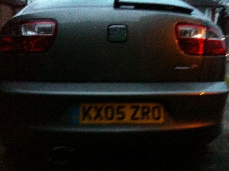

For cupramillo, here's a couple of pics of my newly installed FR Jetex cone. Very happy with it ;)
Apologies for poor light, but some pics now of the engine cover with new Forge sticker and progress pics of debadging below
Plenty of floss was used...
