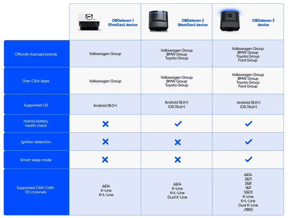

I've ordered OBD11 3 (just in case) but in my limited and short usage period I found it working the same as OBD11 NextGen in my Leon MK3 - same connection speed, same reading and writing speed, same features...
The main difference is that the Gen3 supposedly has the hardware for SFD 2 but the Gen 2 does not
Where have you found that information? That's the only table with differences that I was able to find and it does not contain anything like that. Regarding SFD2 they posted video lately stating that they are still working on it, nothing more: https://www.youtube.com/shorts/7LlLLUsH5ew
Source: https://obdeleven.com/obdeleven-3-is-here

Glad to see they have updated the table because originally it said it supported android 6 (as do the Amazon apps).
I have an open issue with OBD11 because this table says they support K-LINE but https://support.obdeleven.com/en/articles/10053429-volkswagen-group-features-in-the-obdeleven-app has the following comment
9. What vehicles will work with the OBDeleven app?
The OBDeleven app is compatible with vehicles that use CAN-bus or KWP2000 protocols, which includes most modern cars. However, vehicles that use the older K-line protocol, such as the Volkswagen Golf 4, Volkswagen Passat B5, Audi B6, and other models of similar years, are not supported.
so currently the dongle supports it but the obd11 (not vag) app does not.

Quick update OBD11 Have updated the helpfile https://support.obdeleven.com/en/articles/10053429-volkswagen-group-features-in-the-obdeleven-app
The OBDeleven app is compatible with vehicles that use CAN bus or KWP2000 protocols, which include most modern cars. However, vehicles that use the older K-line protocol, such as the Volkswagen Golf 4, Volkswagen Passat B5, Audi B6, and other models of similar years, are not supported yet. It will be supported in the near future.
